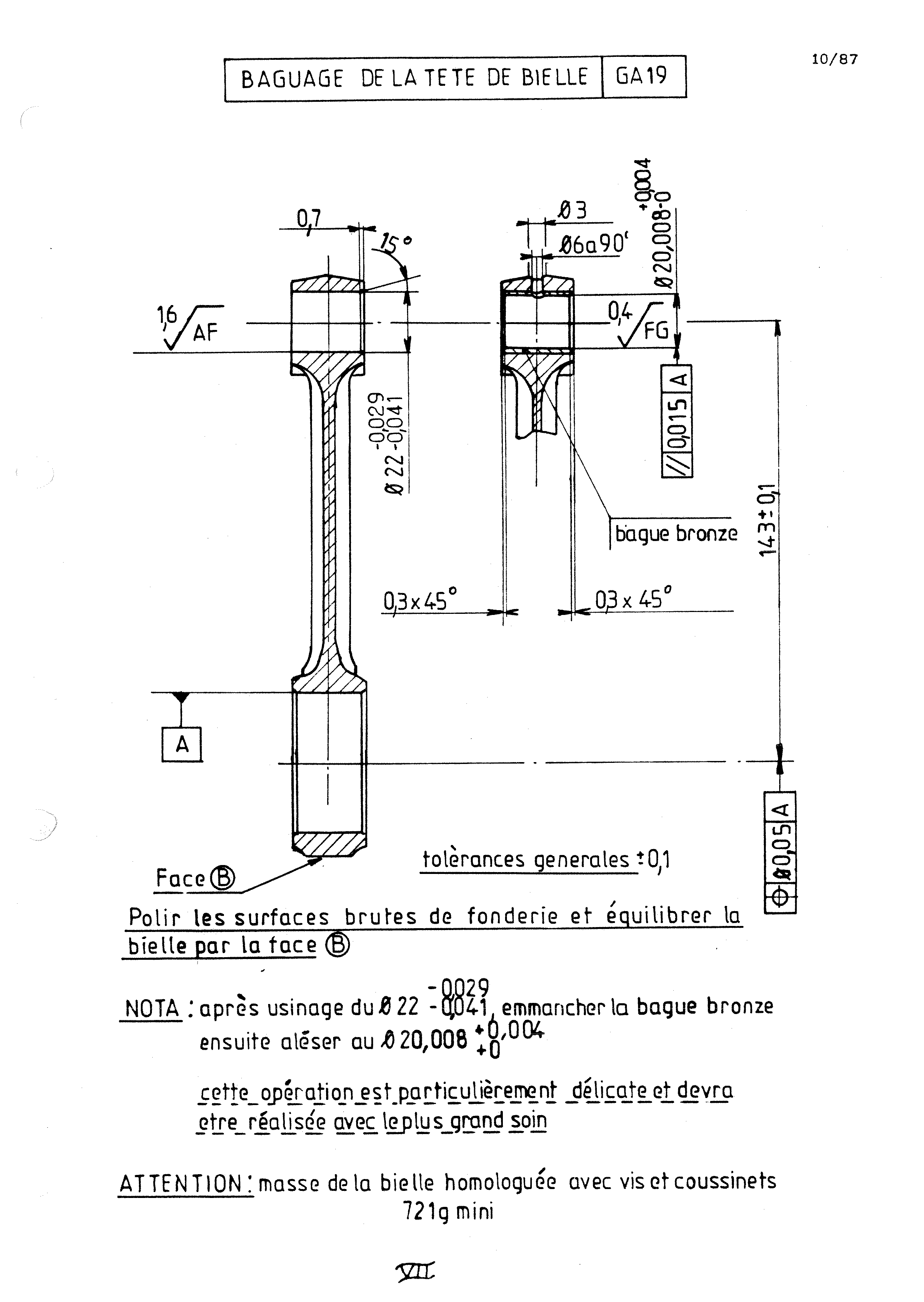

They are probably stock rods that had bushings pressed on to use forged pistons with floating 20mm pins.
image7.jpg?w=768&width=768&q=75&format=w
There is no PSA rod this size with fully floating piston pins.
Edited by SRDT

Is there any psa with 20 m pin dia? They look very factory. Not sleeved or new bushing. No drilled Hole for Oil.
SRDT
The only PSA rods with this length are from the XU10J4RS and XU10J4R (similar but drilled on the big end).
Not having the oil hole means they are probably not stock rods.

would you recommend stilling holes for better oiling ?
SRDT
On OEM applications 100%. On a race engine it depends, the rod could be "retired" before the bushing wears out and maybe that's why your rods are not drilled.
In any case Peugeot did ask to do it on the XU9JA rods for Gr.A racing.

Thanks. I’m not sure I understand your post - lost in translation. What do you mean by “retired”. It is for use in a race engine. My old rods had a 4 mm Hole - 3mm would be what I Would put into the smaller pin diameter ones.
any thoughts?
Factory XU9J4 and XU10J4 rods are drilled to supply oil to the bushings.
mmt
Asked the machine shop to drill them. They Said between 2.5 and 3 mm would do the job.
