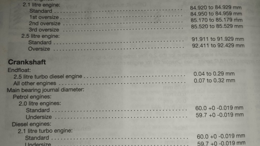

I'm still somewhat confused. According the ACL book,
XUD9TE 2T7715 1.88mm (forged)
XUD9A 2T7703 2.33mm (cast)
XU9J4 2T7703 2.33mm (cast)
XUD11ATE 2T7715 1.88mm (forged)

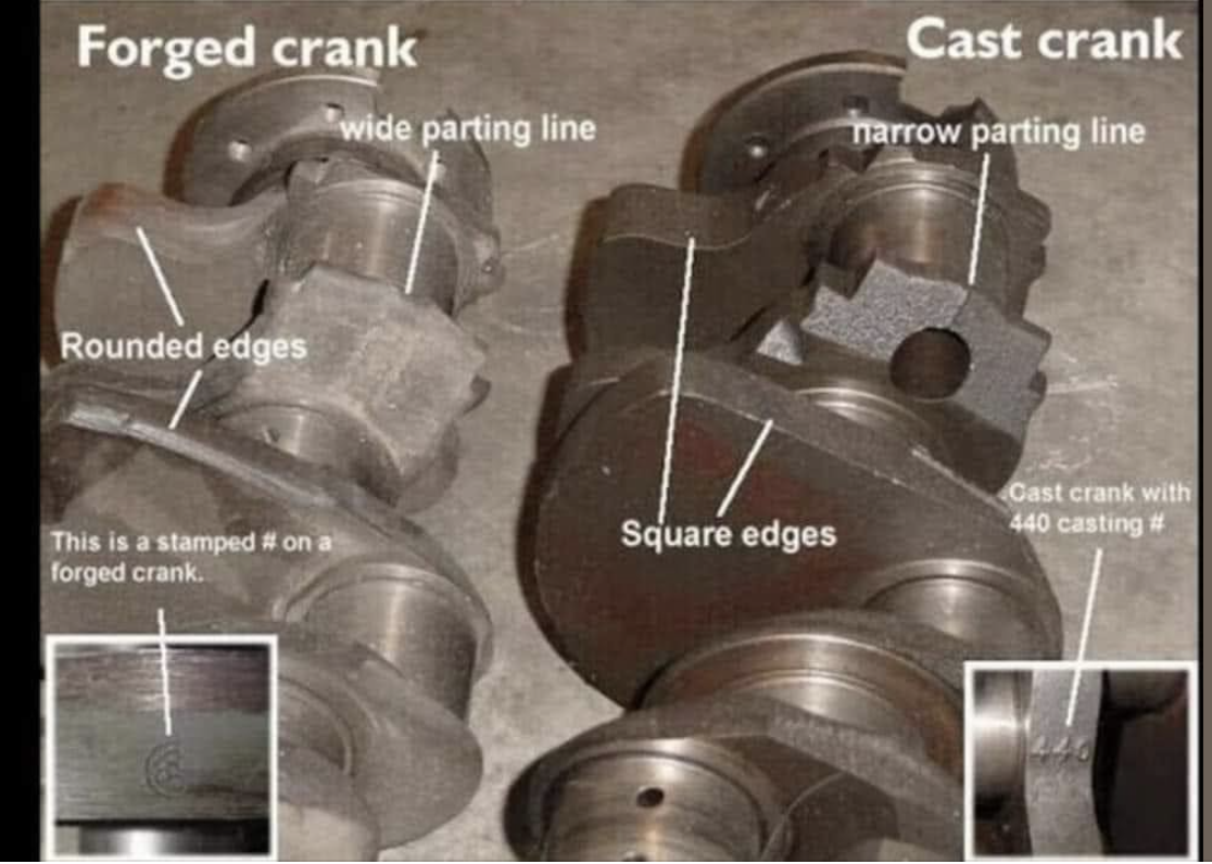

Could it be that you're trying to fit a cast diesel crank into the iron block? Send a pic of your crank.

Peter is an 88mm xud9 crank

But is it an XUD9TE crank? Does it have a wide or narrow parting line?

I think I found the spec, its +0.05/+0 so a brand new "1.83" thrust washer can go from 1.83 up to 1.88mm.

PeterT, sorry, forgot to grab a photo before I put the windage tray etc back. The crank doesn't look the same as either photo. It's got a chamfered edge to it rather than radius. Looks somewhere between the 2.
Anyway, it's a non turbo crank I know that for sure.
