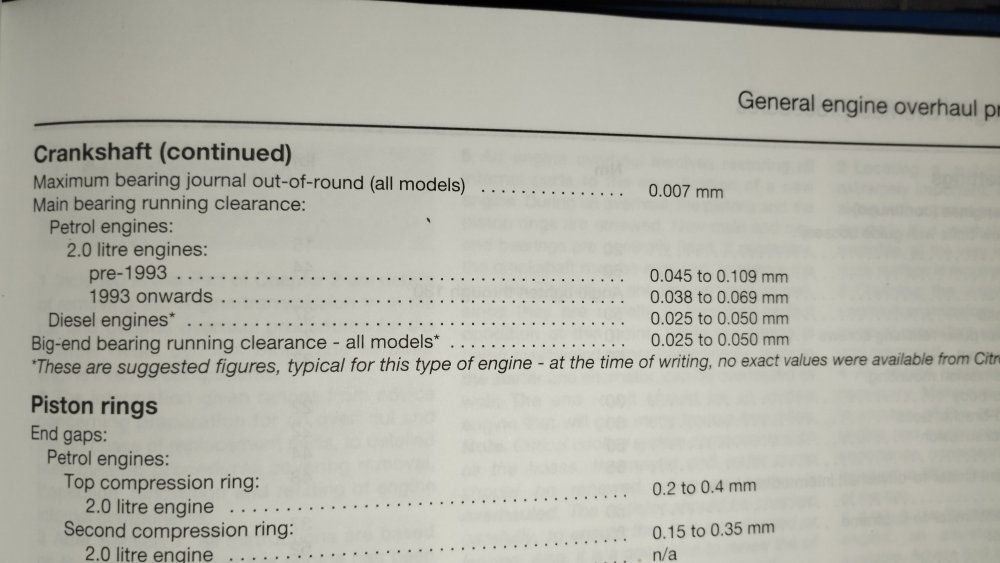

Interestingly , and no idea from where Haynes got those specs , but early engines seem to run quite a bit more clearances ?!(taken from Haynes XM manual) :

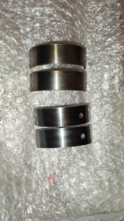

Hmm , an set of upper grooved shells looks a bit blue at the back , so seems been running hot .. lower ones look ok. .
So what do we think about that , toss the blue coloured away or still good to reuse ?
Sliding surface looks ok. and clearance also 0.050mm .

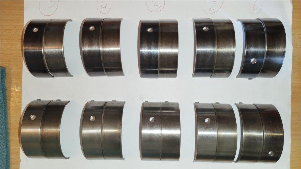

Some more pics ..
Shells numbered 1 flywheel side , top ones from 96' engine , lower from 97' both 2.0 T .
96' engine was rebuilt some time in the past , it's sleeved ..
97' went poop cause of way too much boost , overheated pretty hard , detonated cracked one piston and head .
Edited by DamirGTI
DamirGTI
There's some difference in bearing code/number for 96' and 97' .
Top row different.
Bottom same on all .
I wonder if there's difference in the material between the two or it's just different serial number ?!
Anyhow , asked at Peugeot but there's none .. can't even be ordered .

DamirGTI
Cheeky bastards ! they're selling all those XU10 bearing shells based on old pre-1993 clearance spec ..
0.041-0.103mm says so on the specs for Glyco and Mahle !! that's why they end up in the middle while measuring so about 0.063-0.076mm
And some are 20.2mm (Mahle) and others 19.4mm (King)
OE are 19.4mm
And parts catalogue lists them for all the XUD9 and XU10 petrol engines .
I wonder if the XU9 petrol bearings would work ?! lower shells at least combine with XU10 upper ..

But wait , this can't be right !
Conrods yes , they are more beefy on early engine RGY compared to RGX , but we have main bearing clearance issues here not the rod bearings !
And it's not the block either , aka housing bore dia. difference .
Im building this engine out of an old '92 RGY block which i got sleeved machined etc. , inside there was ground crank with 0.30 oversized mains and 0.50 big end shells , which i choose not to use for that very  reason , and fitted  std. crank from '97 RGX engine in that early '92 block instead .
And yet all those bearing shells in the spec for early engines intended for running on 0.041-0 103mm clearances , end up with 0.063-0.076 clearance , but with the shells from the RGX block they tighten up to the 0.050mm ?!
So where is the difference then , the early crankshaft ? or simply change in the clearances spec cause , no idea guessing thinner oil grades or something like so ..

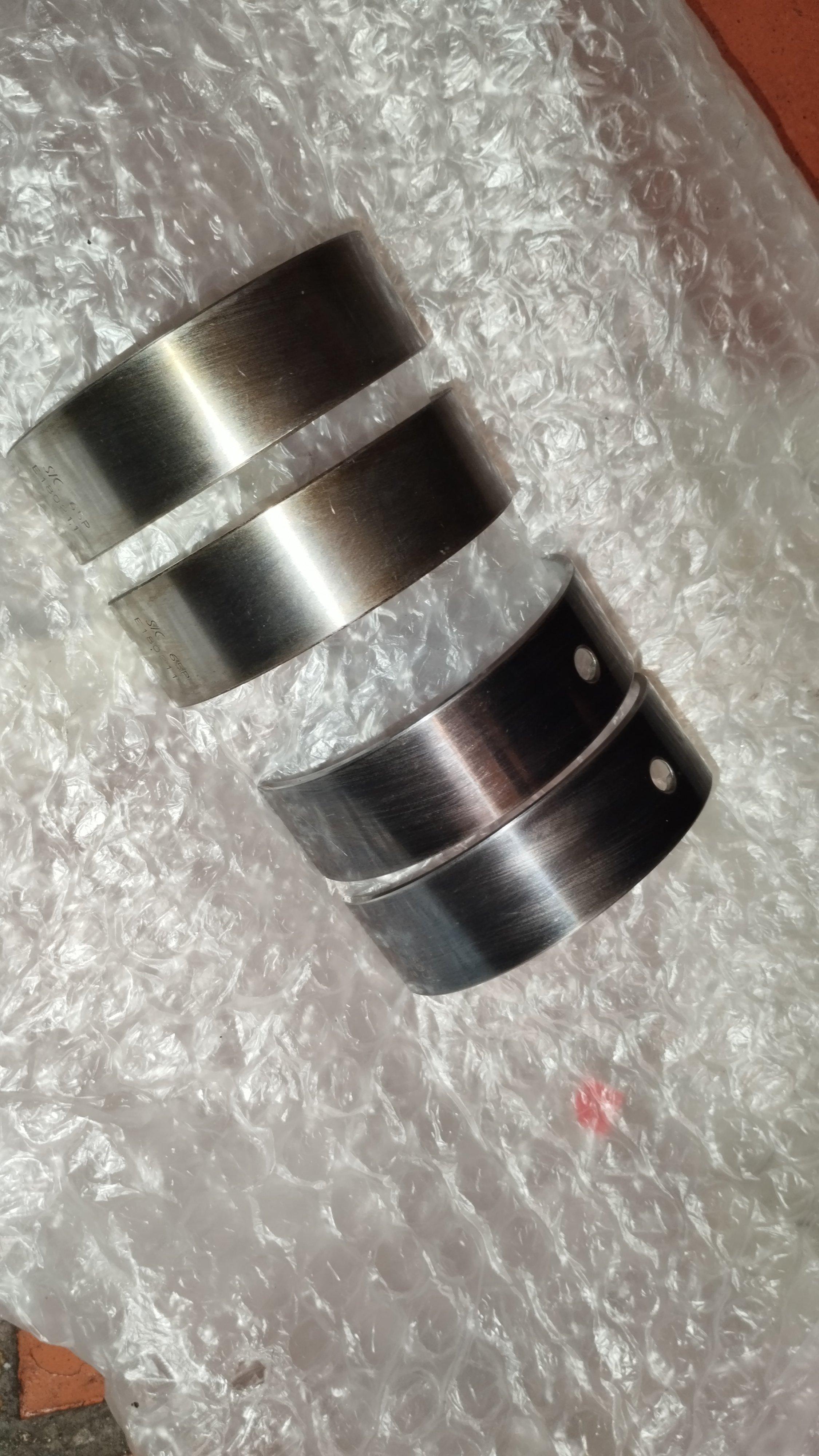

Any idea why some of those upper shells have blue/black discoloration at the back ?
That engine has been completely apart some time ago for sleeving , thus not sure if they oiled back sides of the shells , used assembly lube , chemical cleaner or something like so which made them change colour compared to the others ..
Does not look like classic overheat as the front sides are ok. , block and the crank look ok. too .
And with some scotchbrite play that discoloration goes away/rubs off .
Those are the best , so i'd reuse those or fit just the new upper grooved shells and used lower if that ends up ok. need to check with the plastigauge .

DamirGTI
Could not sleep , so took some gray scotch brite , and some kitchen paper and went experimenting ... light scrub and then polish .
That along with the alcohol removes most of the black/blue haze from the backs of the bearing shells .. interesting acetone does not work but alcohol does ! even only kitchen paper saturated with alcohol does the trick alone without scotchbrite scrub .
So looks like some kind of oxidation or reaction of the shell steel backing to the oil grease or something like so , wolfram/moly assembly lube might be used prevously during the rebuilding too by accident added at the back of the shells .
But being curious , i ordered an set of those 2.0/2.2 HDI bearings , as per the specs the thickness seems to be correct or at least very close .
Just unsure if they're harder , meant for use on forged cranks , but still i do not think it'll matter much if the clearances end up right .
Still some blue haze but i did just a few passes with the scotchbrite and the paper/alcohol :
