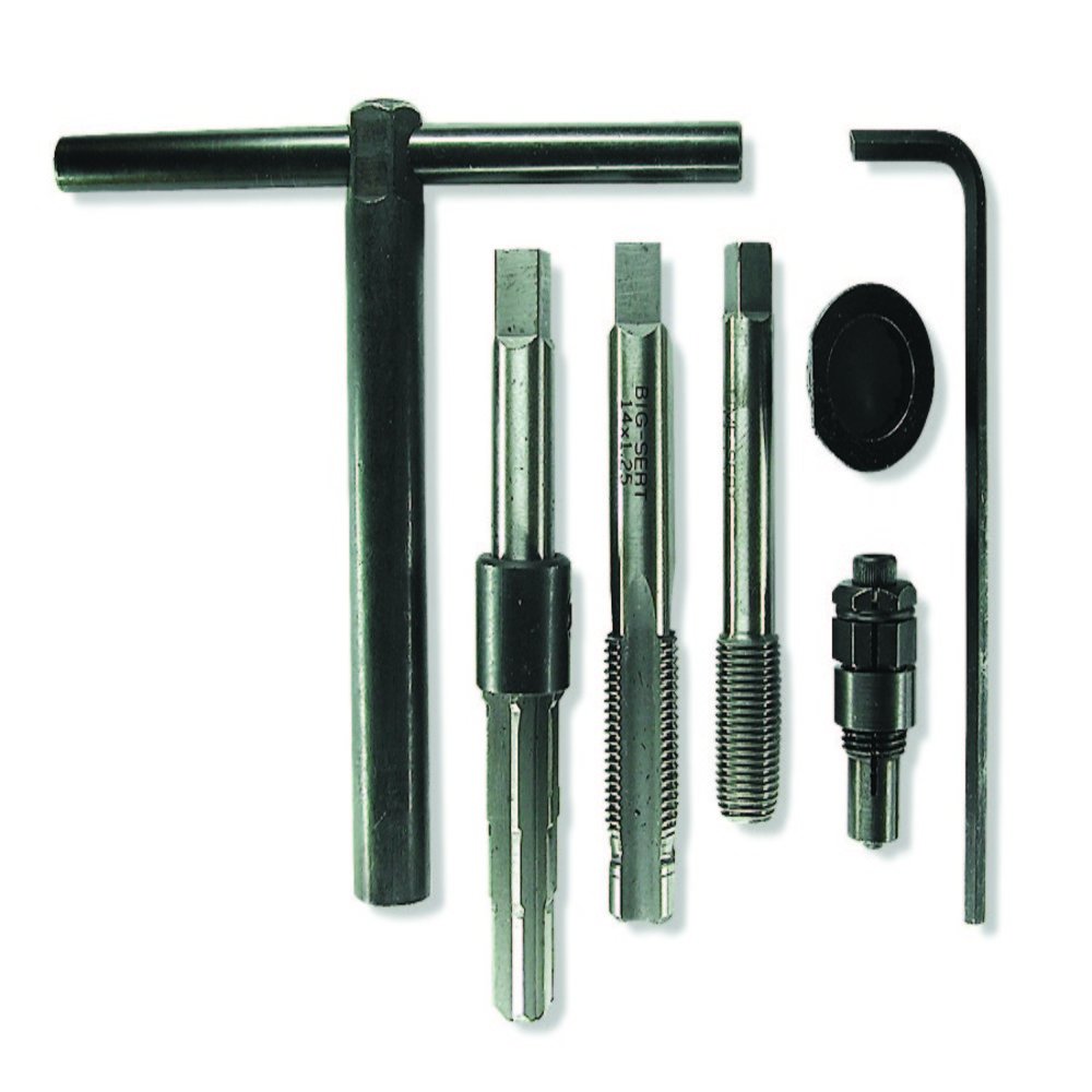

Yes that is for the "proper" time-sert system , i've seen some demo videos for those , neat solution ! but quite a bit expensive kit .

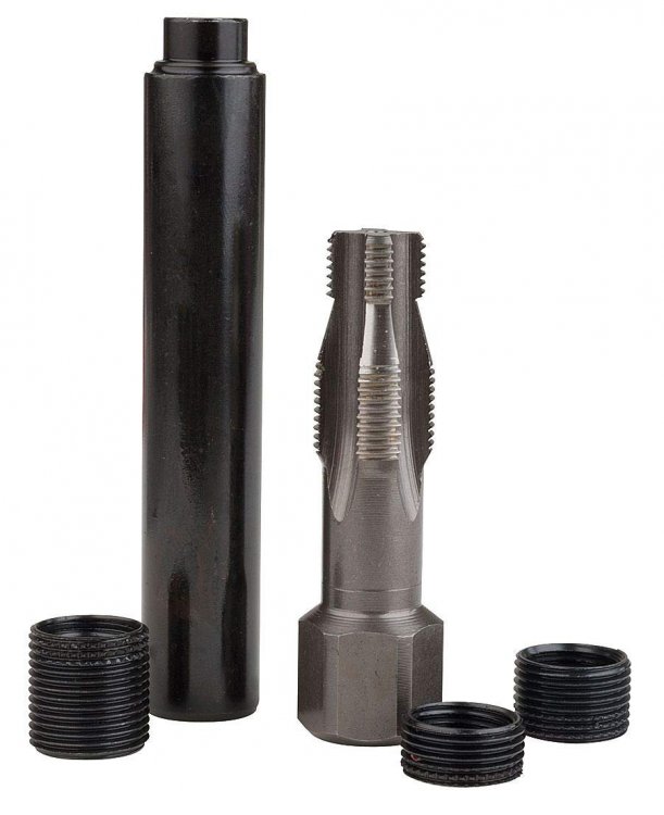

Other variations seem to be just the insert , with certain brands having knurled top side to lock them into place by taping with the tool provided in the kit , and last ones which are commonly sold all over the place now are just the inserts without any means of securing them into the head apart from the loctite seems like ?!
Like so :
1 "The real" time-sert tooling kit

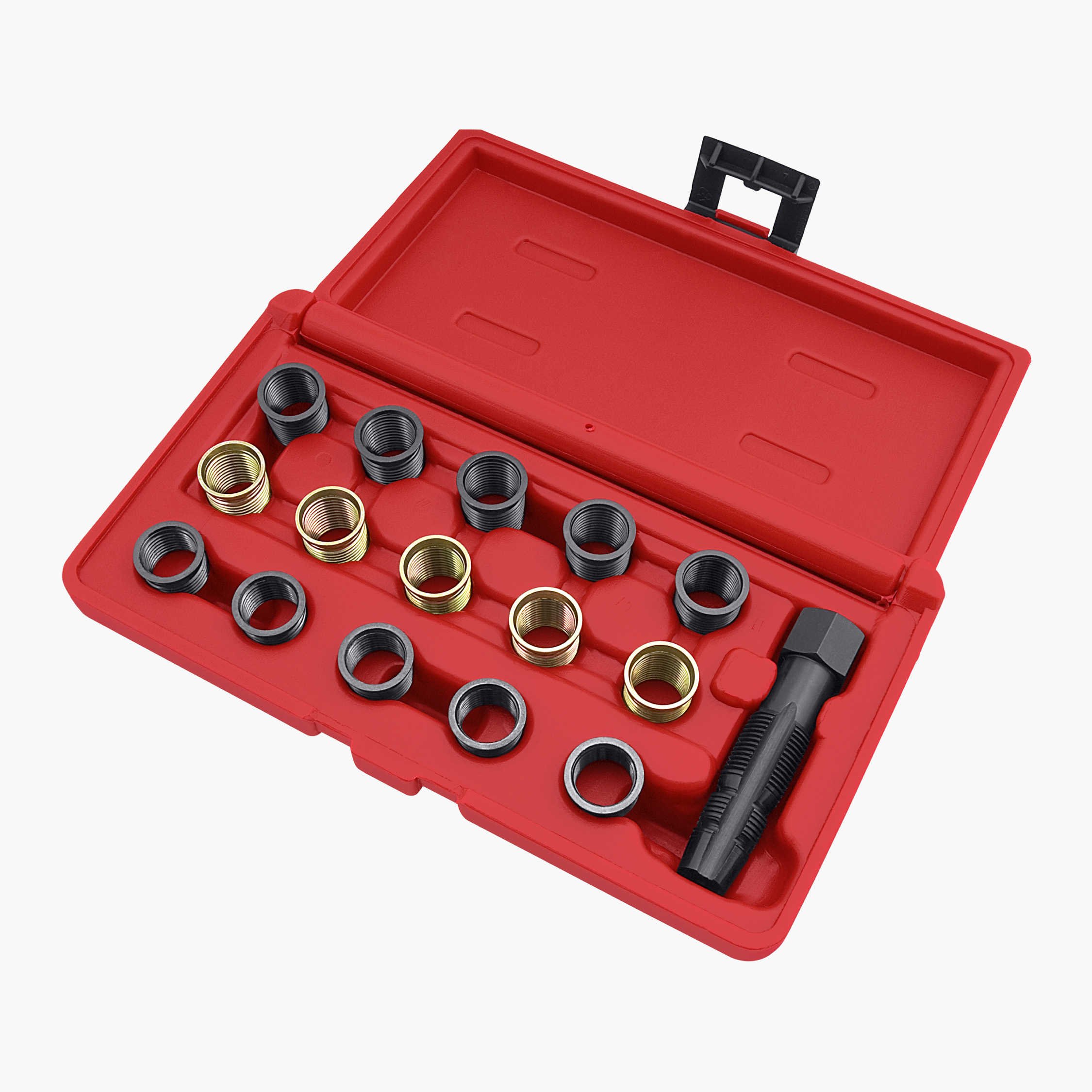

2  Some kind of USA insert system with knurled inserts
3 Chinesium variant
