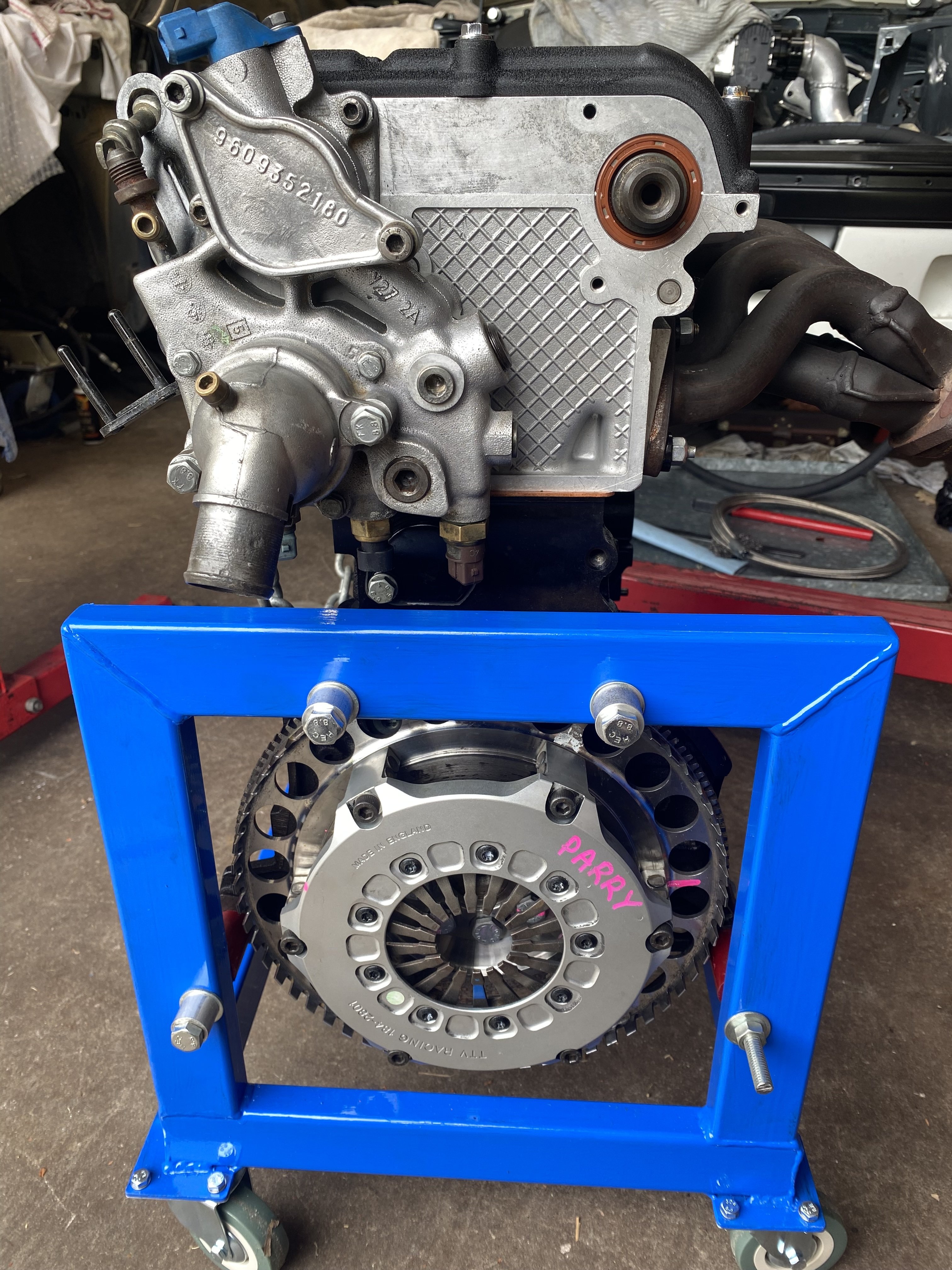

getting to the next stage with my 2.0 s16 engjne conversion
coolant system.

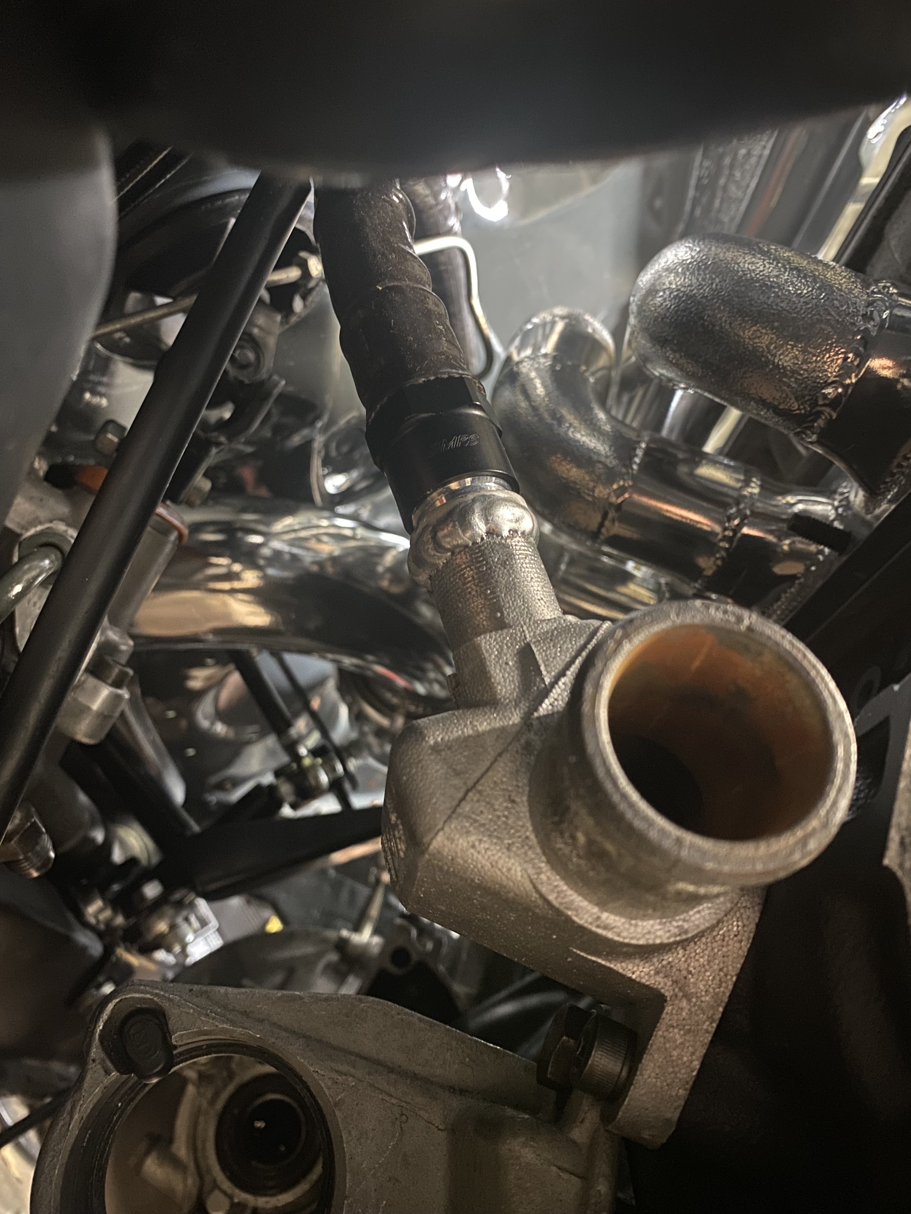

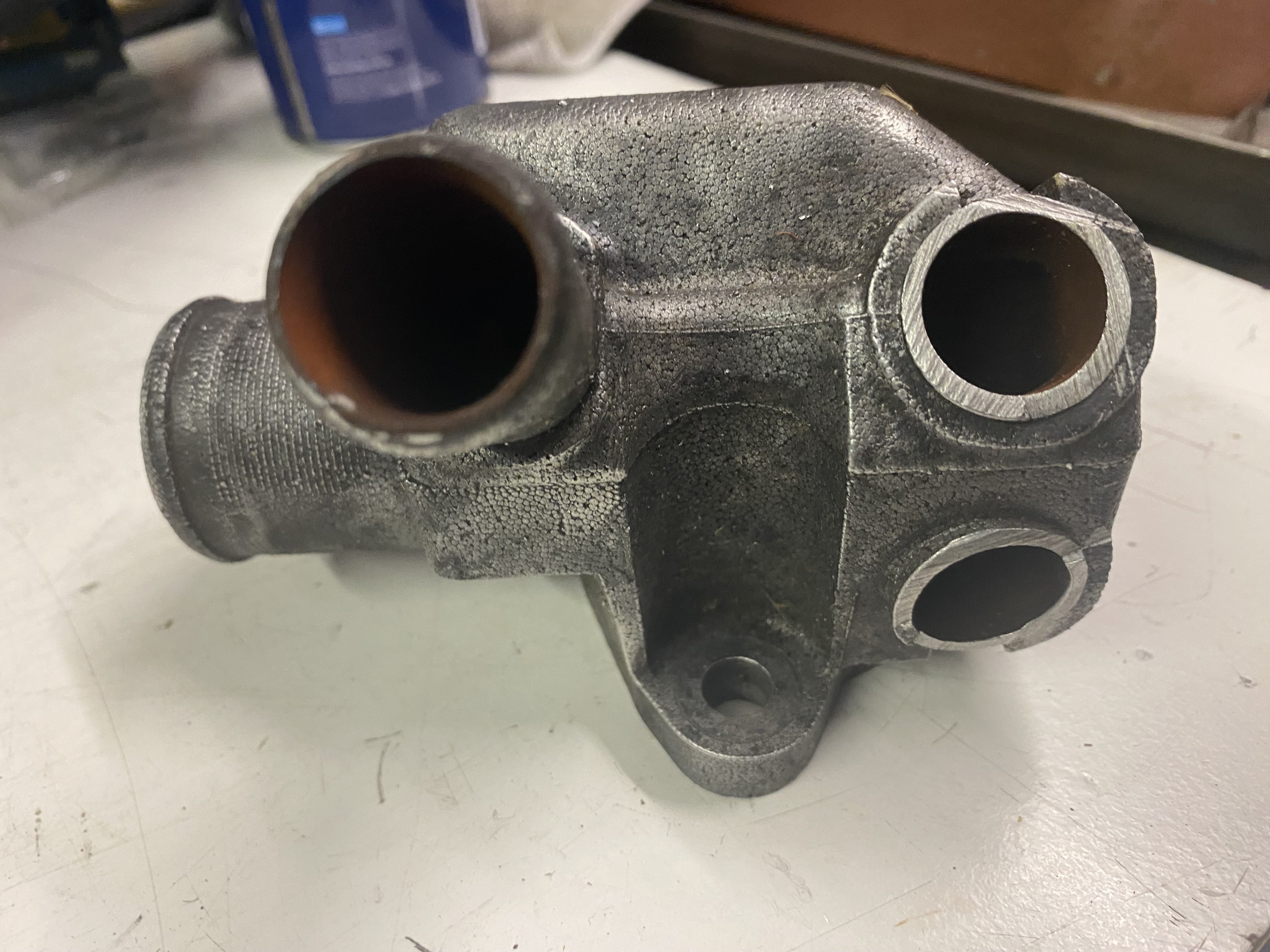

im stuck with the coolant distubion block...im looking to swap to a 205 gti one to reduce the amount of hoses (the 306 one is also in poor condition )
am i ok to do away with the metal pipes that run across the engjne (one has a bleed screw in/goes to thermostat housing) ....i know its common to blank the lower metal hose on the back

As for the 205 part I don't think it fits on the XU10J4 block.
https://www.miamistu.co.uk/pug/GB/205F/1/13E21A.HTM
https://www.miamistu.co.uk/pug/GB/205N/1/13E21A.HTM
You could have the XU10J4 outlet welded, if not try to get 1336.A6 from a XU10J2, it's made out of plastic but it has as much outlets as the 205 one.
Another potential problem is the radiator hose diameter : on the 205 it was reduced to 32mm since 12/1991, I don't know how it is on the XU10.
