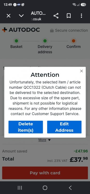

Thanks for that welshpug. It is available on that site but they won't ship to Ireland. Due to the excessive size of the part........spare me!
On the Autodoc.ie it's coming up as unavailable.

I would get in touch with them, hopefully a humans touch will help!    we get the same for large items in the uk, though I've never come across that for a clutch cable!
  they are 1500mm long which I'd imagine is where the computer says no.
I added the cable to a few other parts in my basket and it accepted my order !
how very odd :blink:
they do still have stock, it looks like my price was significantly lower than yours at £18 as well.
