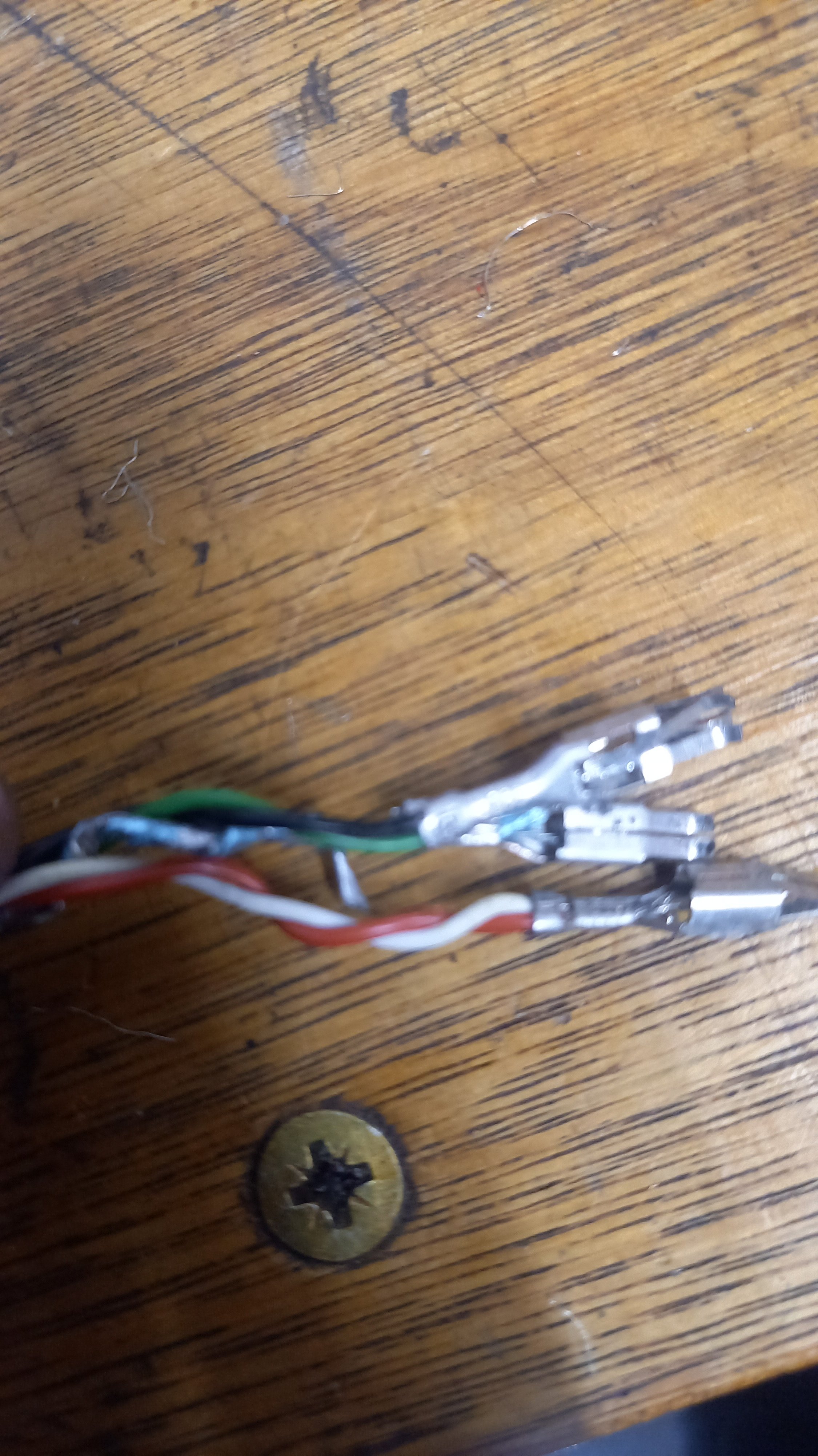

I've replace the wire with a 4 core shielded wire (doubling up on the connectors), I haven't found the right gauge 2 core shield wire yet, but the 4 core seems to work fine. The wire now also goes directly into the Ignition module, as I bought the car with the plugs missing (was twisted and taped together). So even if I bought the correct cable I'd have to find the other part for the loom.
Luckily I have a bag of new Bosch female spade connectors, so I can re-pin most plugs on the car.

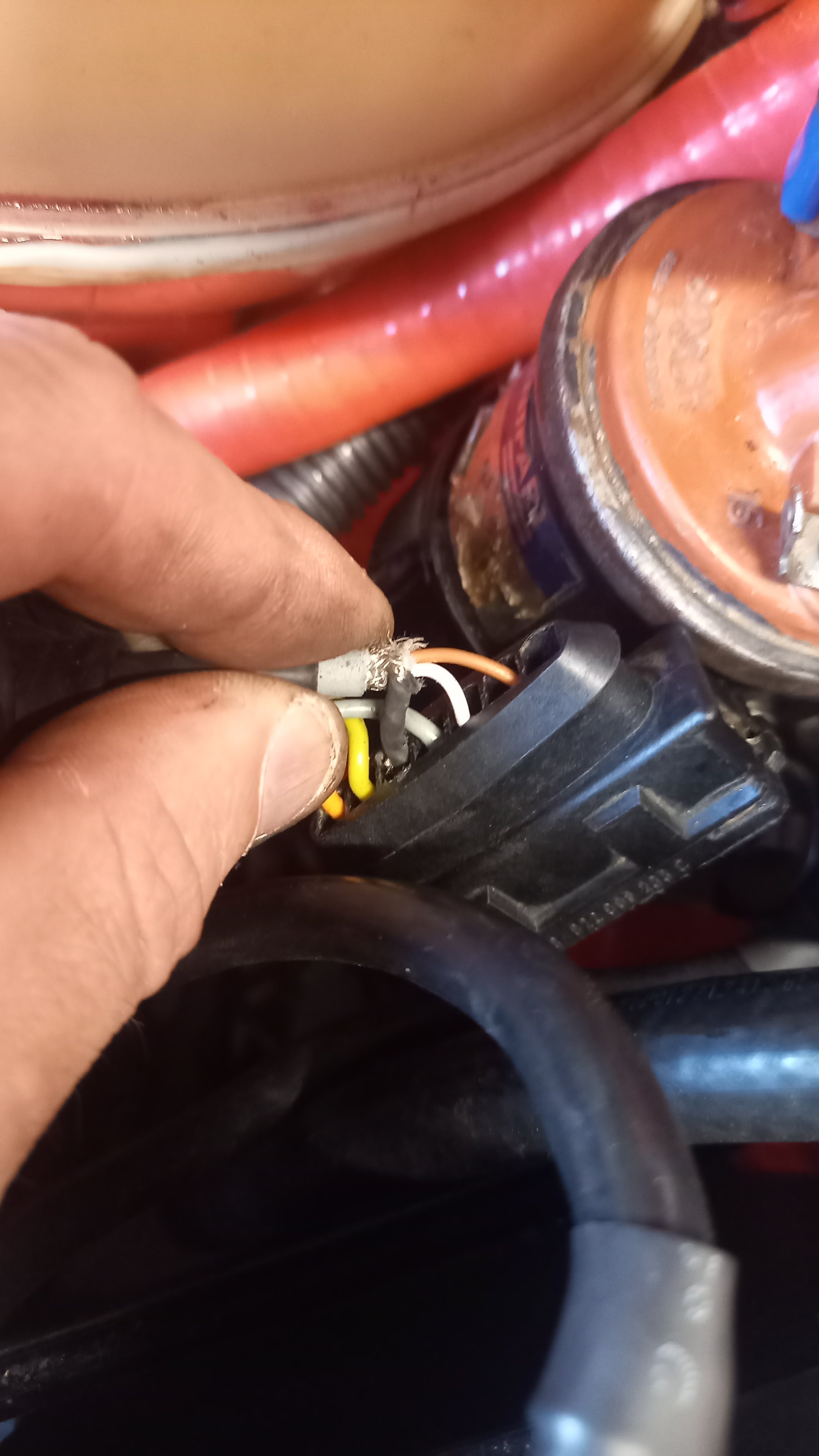

This was another 2 core shielded wire (brown and white wire) going directly into the ignition amp plug. Gauge was thinner than the original wire so I fit the 4 core (Above) back in. Didn't really need to change it as the fault I found was the Tach Relay socket (see other post)

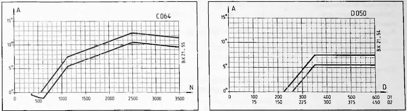

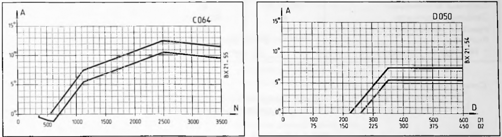

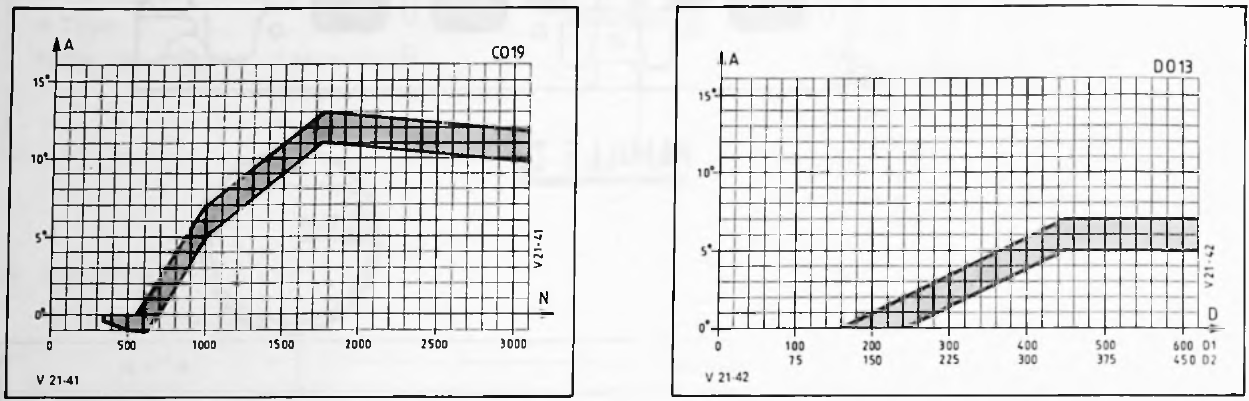

The 086 is for the XU5JAK (B6E) and the curves are not the same, instead of C019 D013 it's C064 D050 that is stamped on the side.
1629344520_XU5JAK(B6E)IgnitionCurves.thumb.png.ebf09103e85e5840061ab9cf0813f439.png1947209159_XU5JA(B6D)IgnitionCurves.thumb.png.d456b6a5339450767d024285f215271c.png

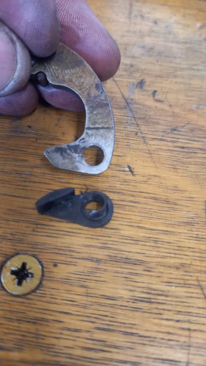

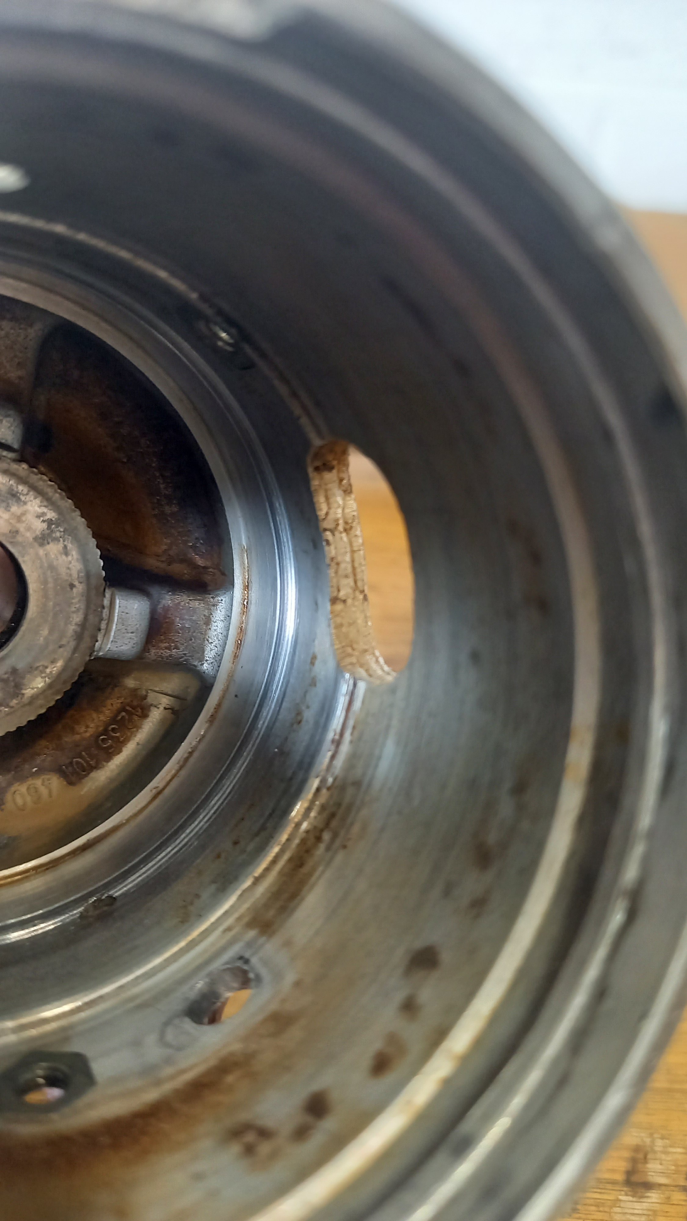

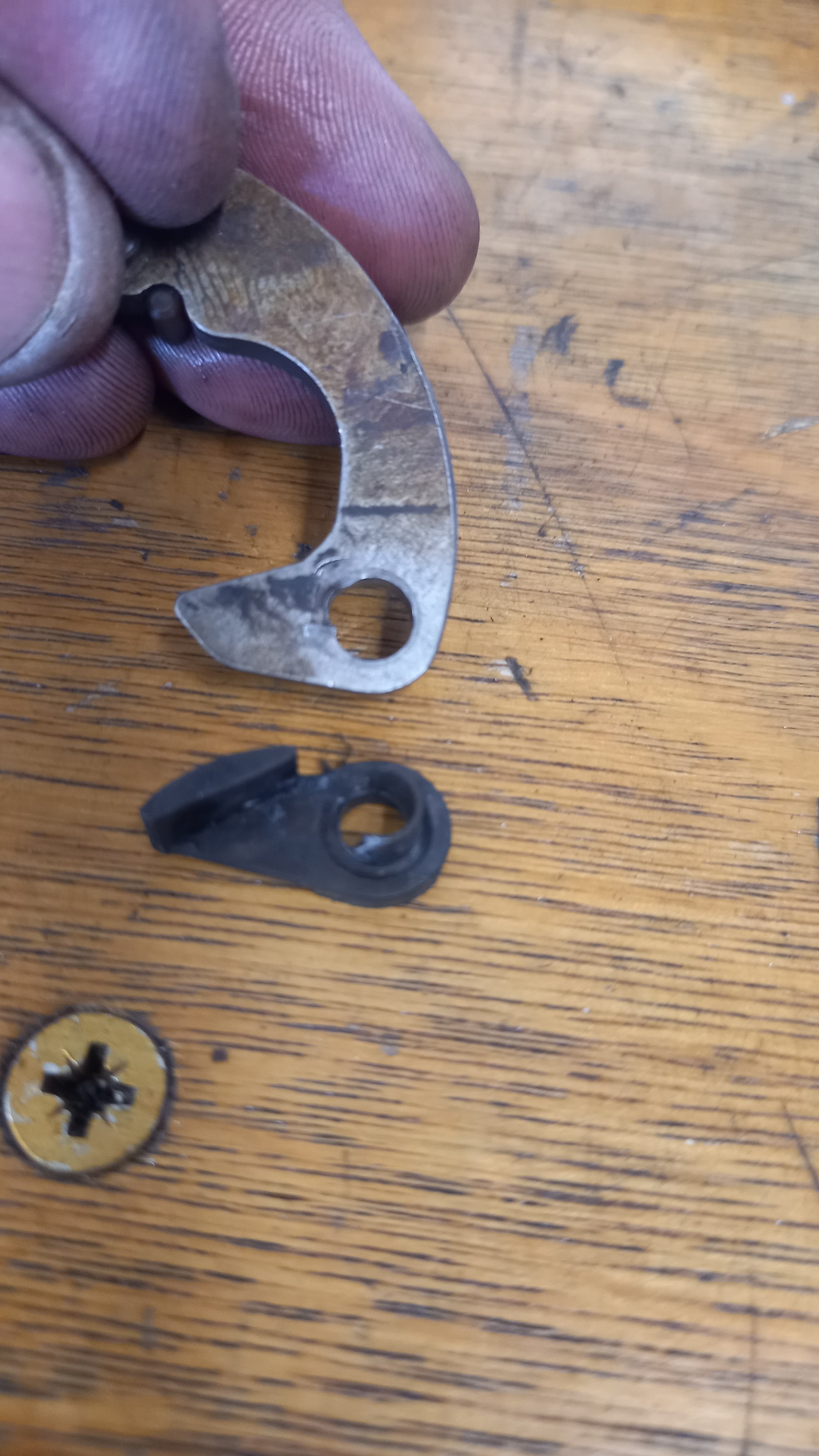

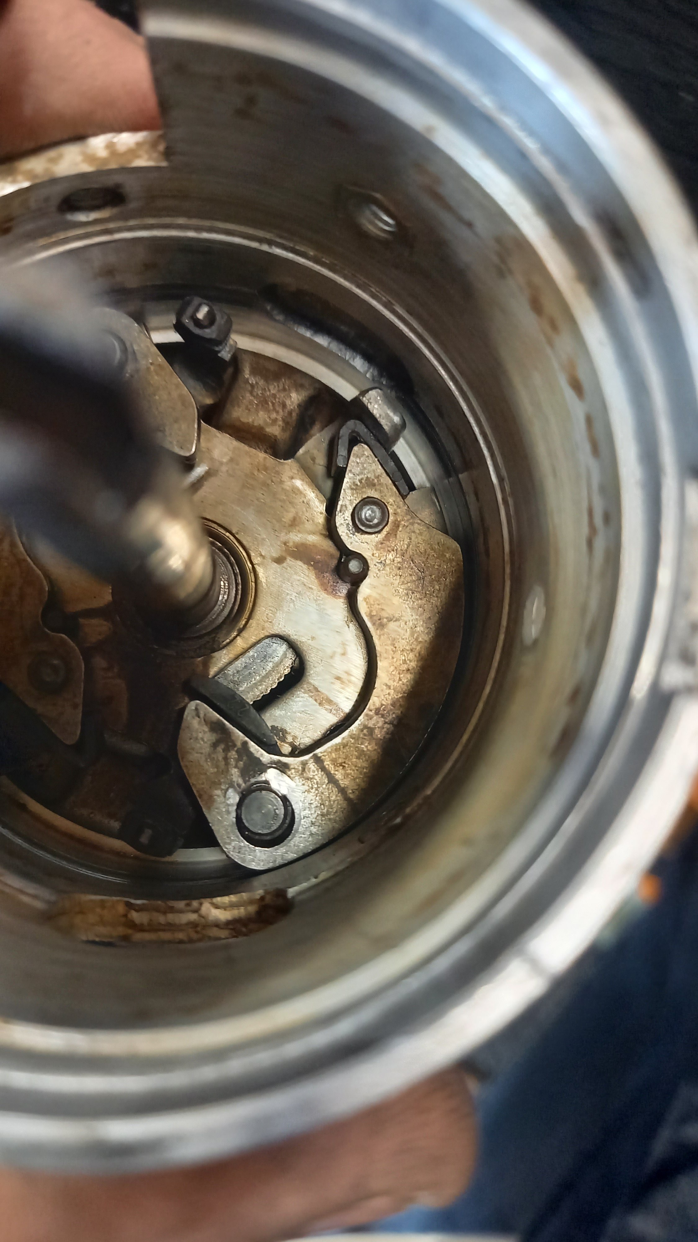

I took apart a spare 063 i had it ran notably worse than the one fitted now. The bob weight pin had worn oval and looks like been rubbing the inner wall. I'll get intouch with H&H. And send them the one fitted.  This looks like it coukd be scrap.
DamirGTI
Yup that's it !
I've taken apart a few Bosch ones too , say 3 out of 5 had loose weights as such .. needs not full disassemble either just a poke with a screwdriver will do to check if there's a slack ..
This makes timing/advance jump around , no good needs to be fixed .
And then recurved for the engine spec and fuel octane grade .
Top service from H&H I've used them myself too .
