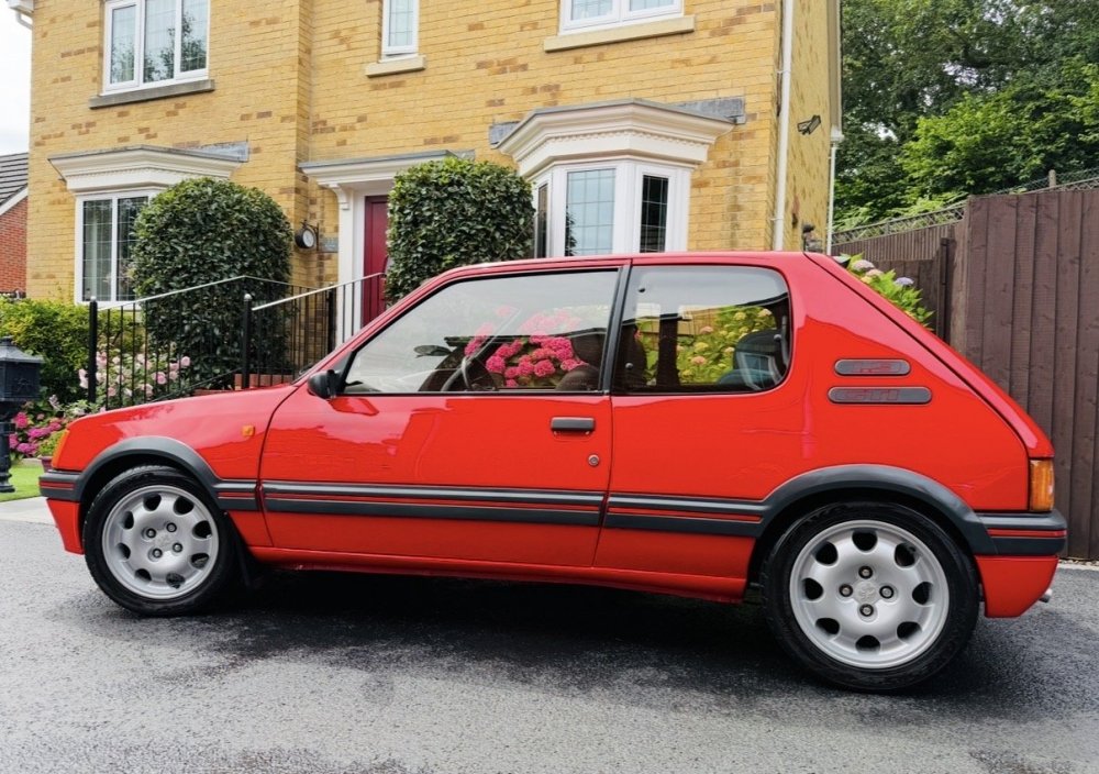

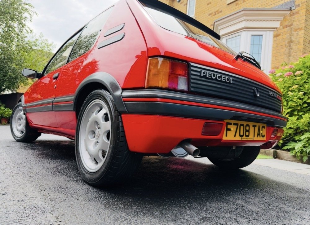

After a bit of deliberation I sold H853 DBD on Thursday last week. Essentially my ultimate spec 205 has been a cherry red non sunroof 1.9, Phase 1.5. One of these came on the market recently and I put up a  tenantive advert for my existing steel grey 1.9.  Within a day a local guy came and viewed it and bought it for my asking price and I did a good deal on the cherry red, so it was all systems go - very bittersweet after 12 years and a labour of love, but time to move it on as it was getting a bit leggy and needed some work doing to it in the not too distant (front end mainly) and I didn't want to go down the full resto route.
H853 DBD was collected Thursday night last week after my new cherry red F708 TAC arrived with me in the morning!
it's a lovely looking thing and has had alot spent on it over the last few years inc a full exterior respray, new sills and countless new parts. Ironically it's had the exact same bodywork done that I had done to my old one (rear bumper mounts and full sills), as well as alot of the same engine and running gear parts changed.

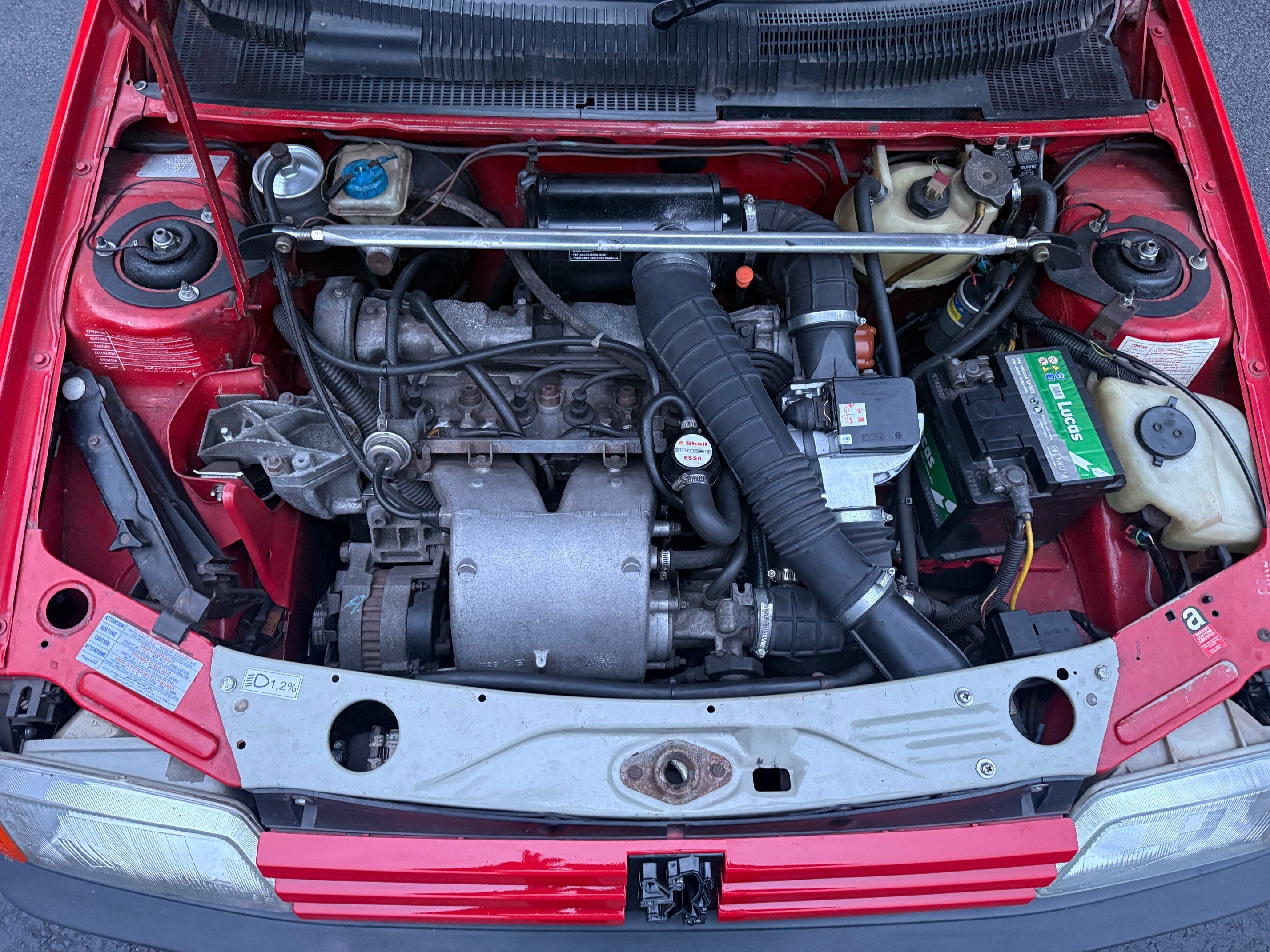

Immediate plans for it are:
- Passenger side inner wing repair as it's just starting to split, so want to nip it in the bud before it starts.
- Rear axle needs raising a touch as it's too low.
- Rear bump stops are missing so those will be replaced.
- New clutch and linkage set.
- Remove stainless exhaust and fit standard one - stainless is way too loud at my age!
- Remove strut brace
Really chuffed with this one so far - it's all complete and hasn't been messed with and has been well looked after.

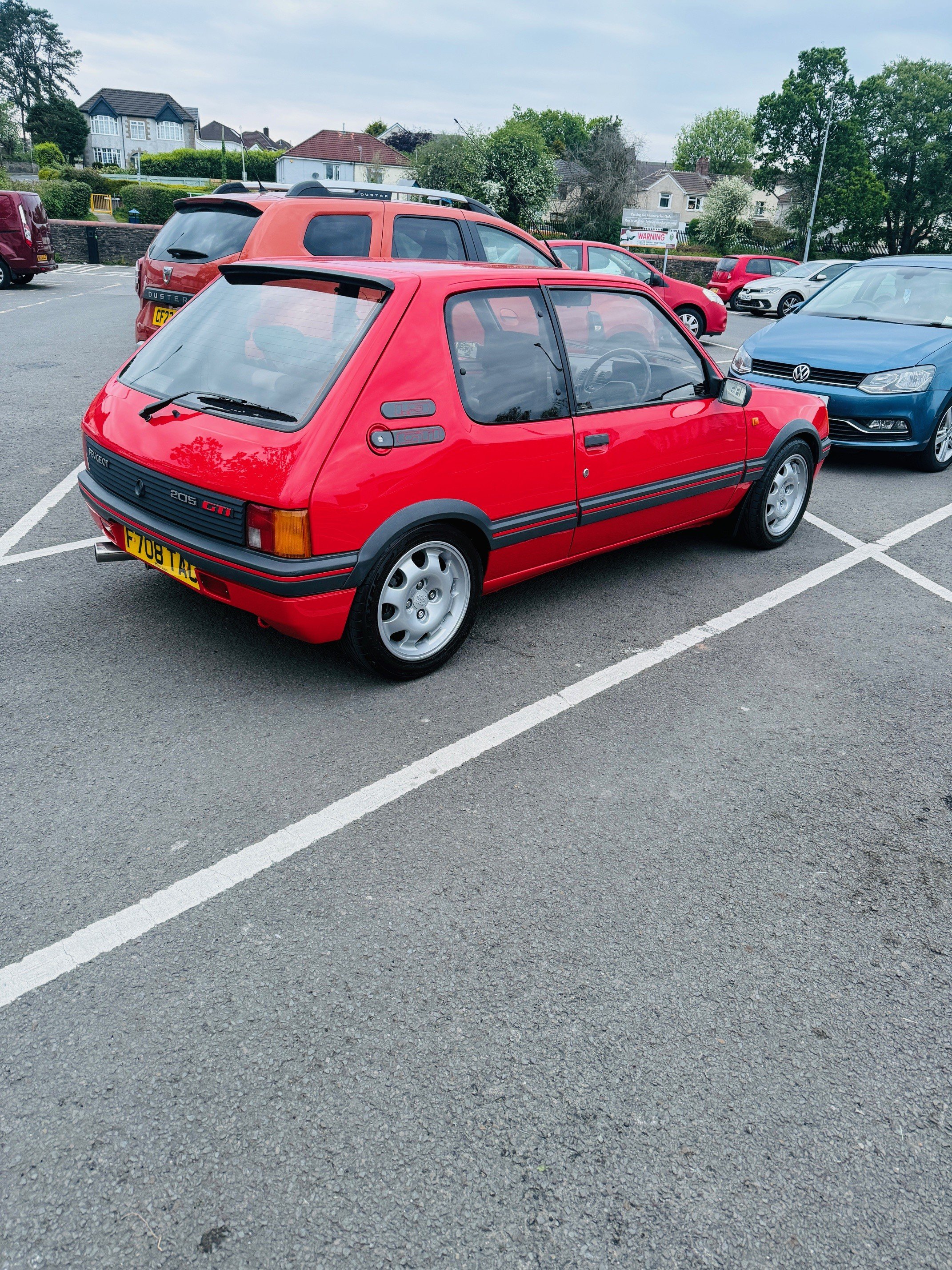

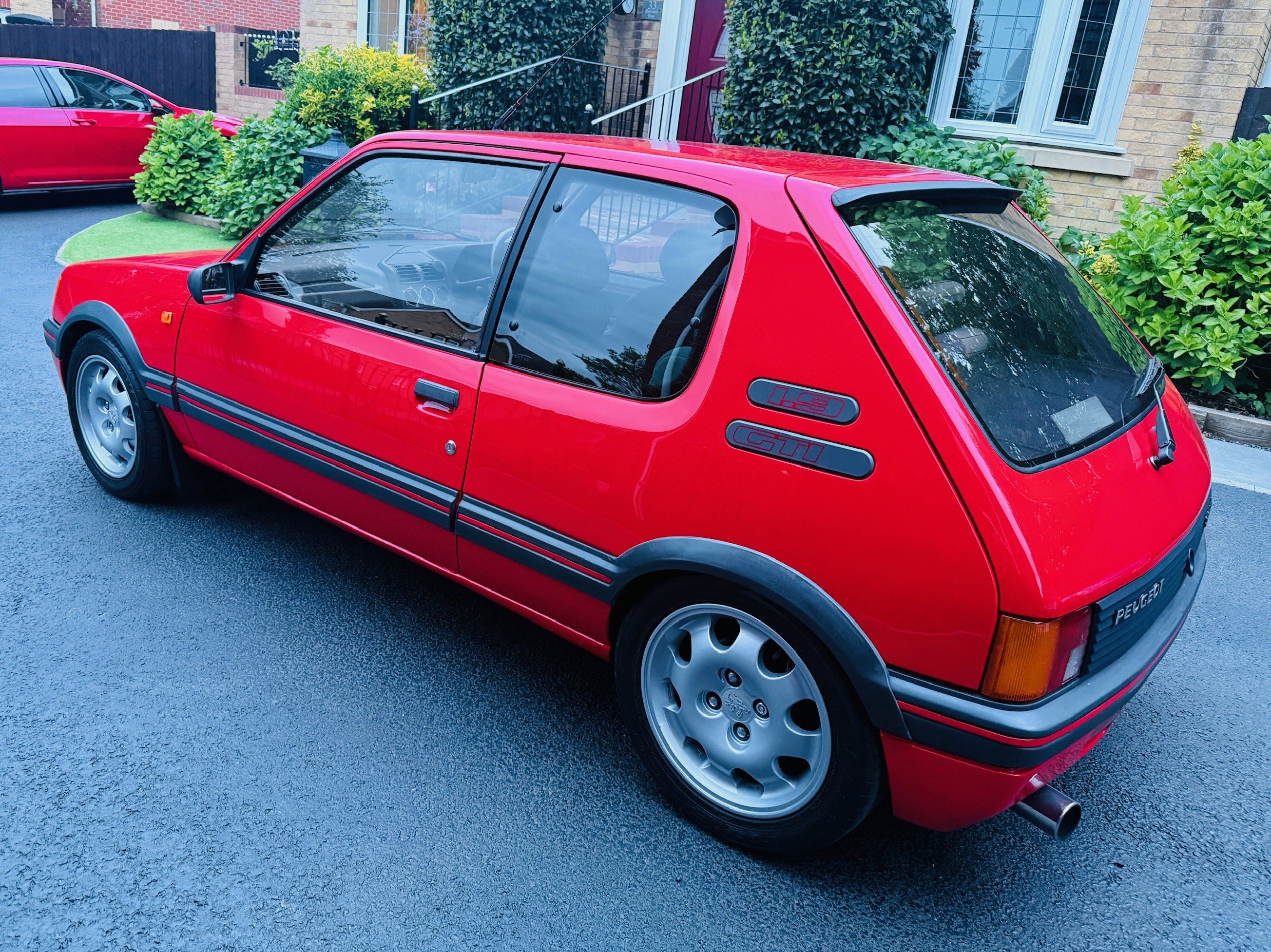

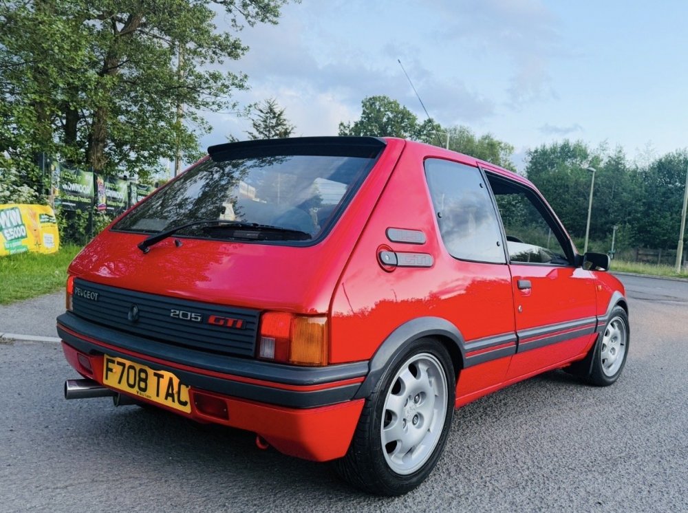

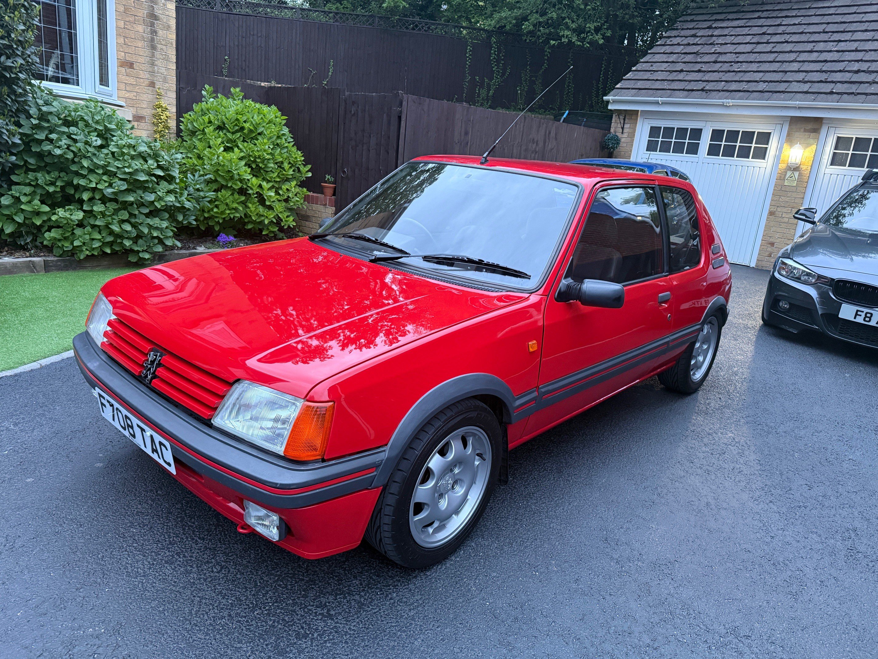

Before H853 DBD was collected:
ATK
Pics:
ATK
Few more:

The rear does want to come up a bit, but I would drive it before and after the strut brace before making your mind up, they do drive better with one fitted to be honest.

Also need to fit a new alternator as it doesn't appear to be charging the battery (battery remains at 12.5v whether enging running or not - I also have a dim battery light when the fans are on, and the battery died getting home last night after using the headlights etc in the dark) and I also have a cracked exhaust manifold which has been poorly welded before, so need to sort that too!

Did some testing last night on the alternator, had 12v at the exciter wire and grounding it caused battery light on dash to light up - so figured wiring was all good.
Old alternator removed last night and new one fitted tonight - normal service resumed - alternator was broken!

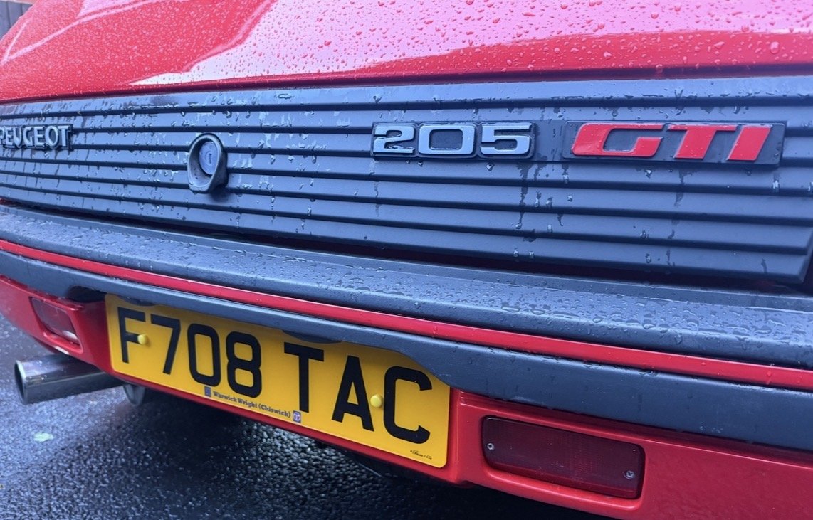

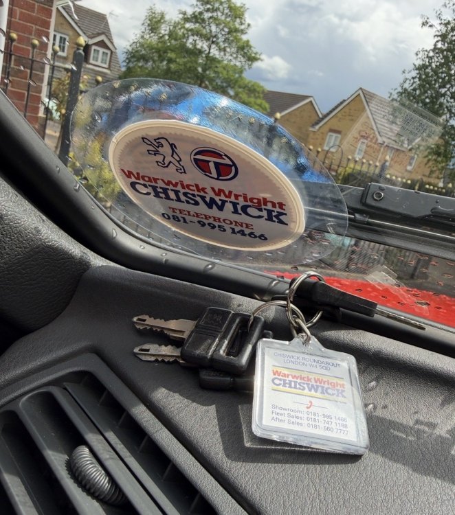

Period dealer plates, tax disc holder and window sticker fitted this week - I like geeky details like this! :)

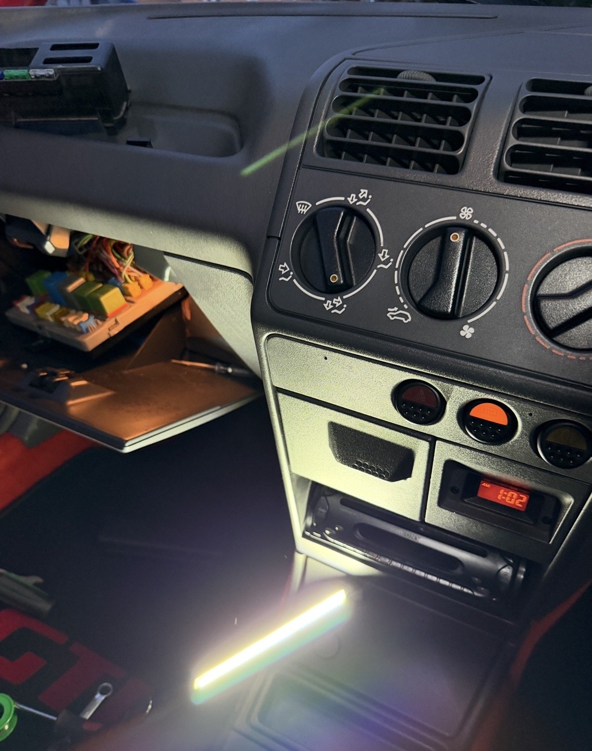

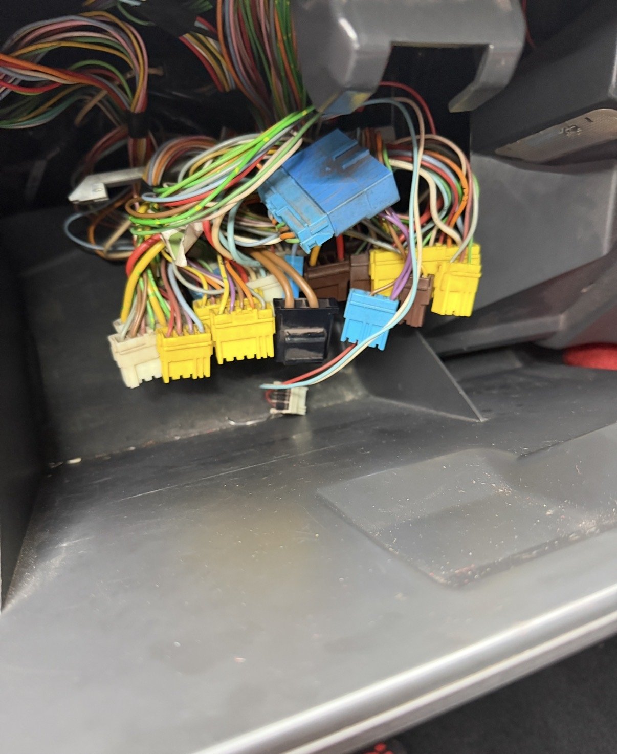

Horn then decided to stop workint - after some testing I bridged fuse 8 to the horn/rear demister relay with some wire and the horn starter working - which led me to conclude it was the fuse board itself that was faulty…
ATK
Battery powered mini soldering iron in hand, cracked off the fuse box bottom cover and resoldered the dry joint…success! Demister and horn now working!
SRDT
Did you solder it in place? When I tried that the repair didn't last long.
ATK
Yep did it in place with a mini battery powered soldering iron. Works for now, see how long it lasts - if it fails I’ll take the board out next time!

So my fix to the horn & demister lasted all of a few days! Bought a good used fuseboard and swapped it in - now all working fine again.

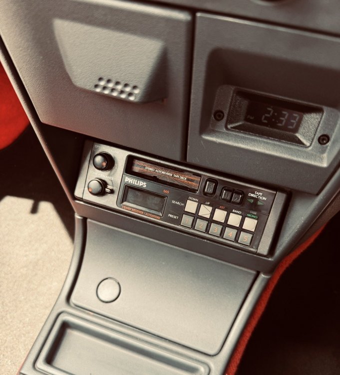

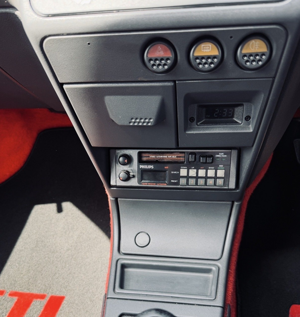

New correct aerial base fitted today, and an original fully working Philips radio cassette which I bought from someone in Lithuania on a retro audio facebook group. Looks awesome, even if the sound ain’t great!
SRDT
Once the fuse box is out of the car you can flip it over and solder it correctly. When done this way it will last years if not decades.
ATK
Difficulty I saw in this was you'd have to break through the board plastic to do this
Swapped in a good used board for now - hopefully it lasts!
SRDT
You don't have to damage the board at all, I only did it once on a test board to see what was going on with the inner solder joint. The fuseboard that I did repair and then used for years wasn't this one.
Once the board is upside down on the bench you just slide solder wire between the plates and put your soldering iron on the outer joint, the inner joint is close enough to the edge that you can see when the solder melts and once you've filled the little square it won't fail anytime soon.

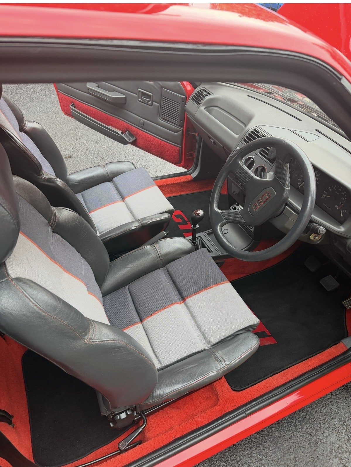

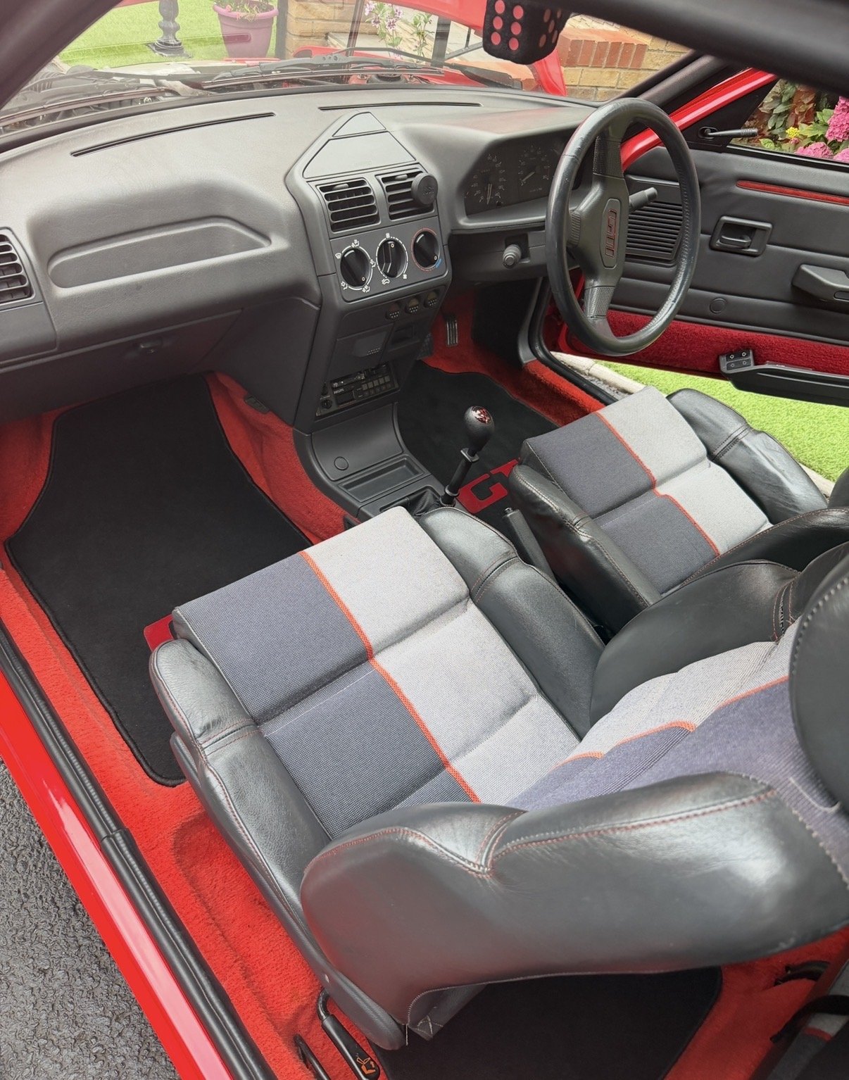

I then spent the weekend giving it a good detail and did some easy bits:
- Replaced drivers side headlight with correct Valeo item
- Replaced all wiper blades
- Replaced dash coin tray, dash trim and ashtray with near mint ones
- Replaced boot lock gasket
- Sealed rear washer jet
- Dyed all bumper trim with Wurth dye - came out great
- Touched up various interior trim parts with Wurth dye
- Replaced rear speakers with some jvc’s
- Full detail
- Replaced front grill with brand new backing and freshly repainted front section, and new badge
Very happy with how it is at the moment and time to get it on daily duties!

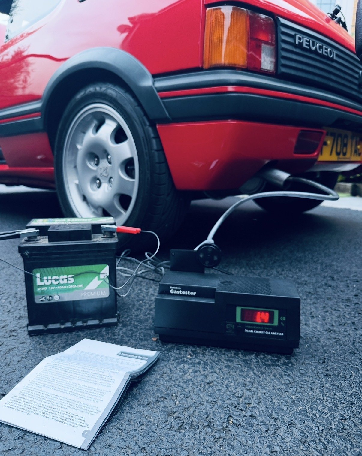

- Did a full setup as per Haynes manual and idle is now spot on, also set mixture to 1.5% with a Gunson gastester, running great now
