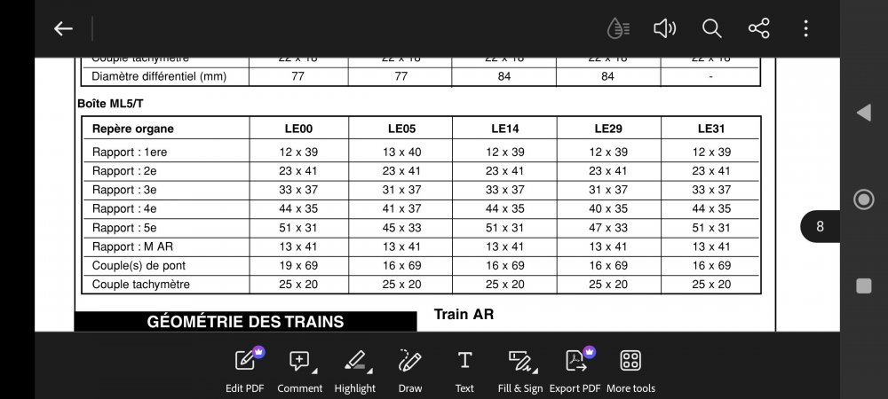

Does anyone know if there's an list of ML5 geabox ratios like we had for BE1/3 ?
I have two gearboxes for 2.0T engine , one with the 20LE29 and another with the 20LE46 code .
Found some info for the 20LE29 on the list down below , but none for the 20LE46 .
Thus curious what's the difference between them , as it seems there is some gearing variations .

It's a 406 2.0T gearbox and the same that the LE29 in term of ratios and final drive.
A) JUSQU'A O 8000, PRENDRE 2151 95 (01) + 2449 82 (01)
B ) JUSQU'A O 8420, PRENDRE 2257 40 (01)
01
2222 10
01
BTE-PONT MEC NE CP 16X69 - CT 20X25
REPERE (LE88) - LE07 - LE29
            LE46 - LE61 - LE88
   VOIR A) B )
01
2201 NR
01
BTE-PONT MEC ES CP 16X69 - CT 20X25
REPERE (LEK7) - LE07 - LEK7
         FIN B 8831000
2223 84
01
CP 16X69 - CT20X25
REPERE (LEH8) - LE29 - LE46
            LE61 - LE88 - LEB9
            LED6 - LEF1 - LEH8
   VOIR A) B )
         DEBUT B 8831001
2202 AY
01
PROVISION BVM
02
9736 41
01
HUILE 75W80W-EZL848-2L
