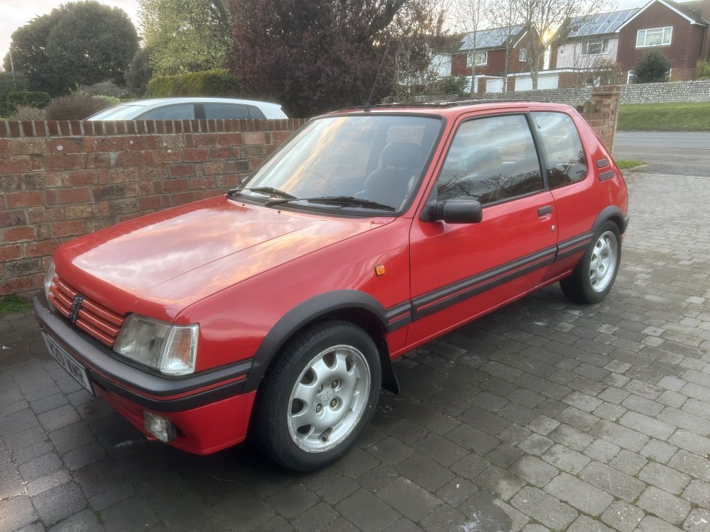

Dazie00 4 2 Cars Posted April 6 Hi guys Bought this Off Scott last week , 90 H phase 2 ,gonna be my little project , i'm no mechanic so will be asking lots of dumbo questions , apologies in advance for that . Been stood for many years , only going to the mot station by the look of things . It's not got a garage to live in , gonna use it for a weekend toy , so it's not gotta be perfect but very useable . Going in for full service / cam belt and clutch this week so see where we are from there . A few small niggles to sort out . Jobs i'd like to get done Want to get the sunroof vacum working , not to sure what the problem is here atm, also get the surround trim back on Wheels refurbed, new tyres New stereo/speakers I'm sure in time will have to sort brakes, suspension and a respray Are most parts available new still ? Dazza 57,(mid life crisis again!) 2 Share this post Link to post Share on other sites

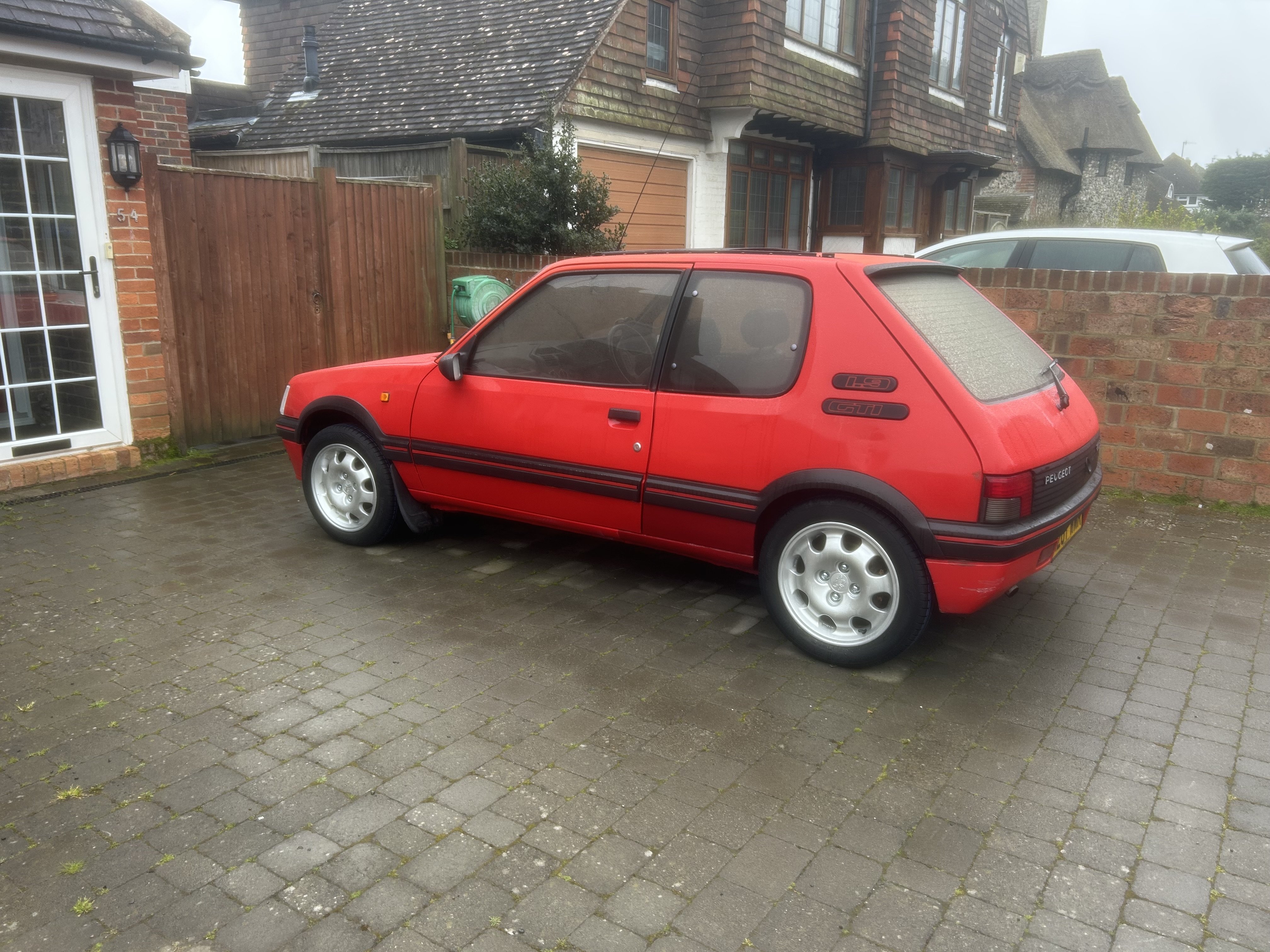

Dazie00 4 2 Cars Posted April 19 A few jobs done since my last post, Speedline wheels refurbed and new Conti tyres Full service, cam belt , thermostat , wheel bearing , clutch , Plenty to do on this little money pit!!! Share this post Link to post Share on other sites

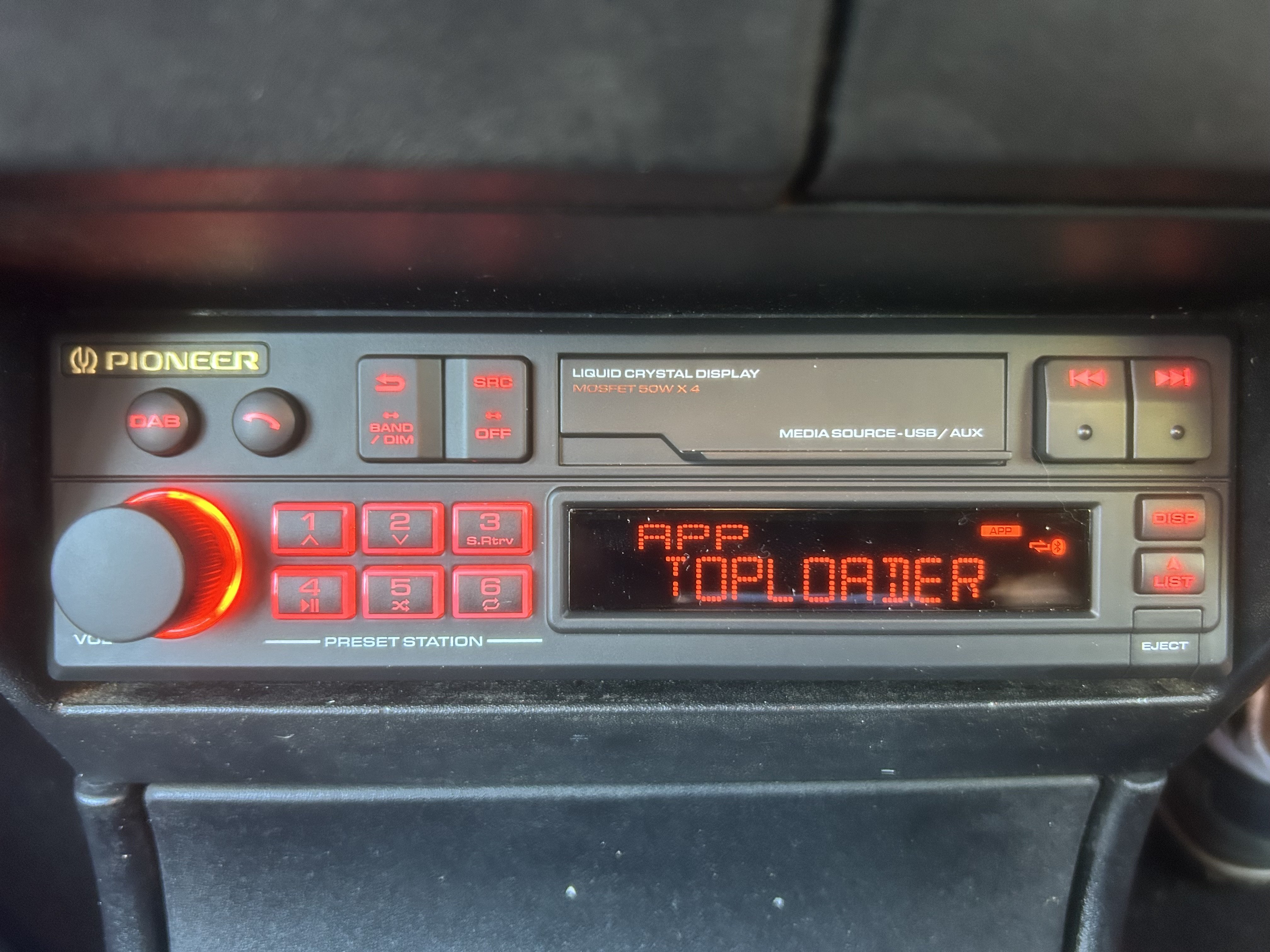

Dazie00 4 2 Cars Posted April 23 Grill painted and a new badge , new retro Pioneer which is quite cool IMO and new Pioneer speakers in doors and also filling the holes in the rear shelf which is what i did have in my first GTI back in the day . 1 Share this post Link to post Share on other sites

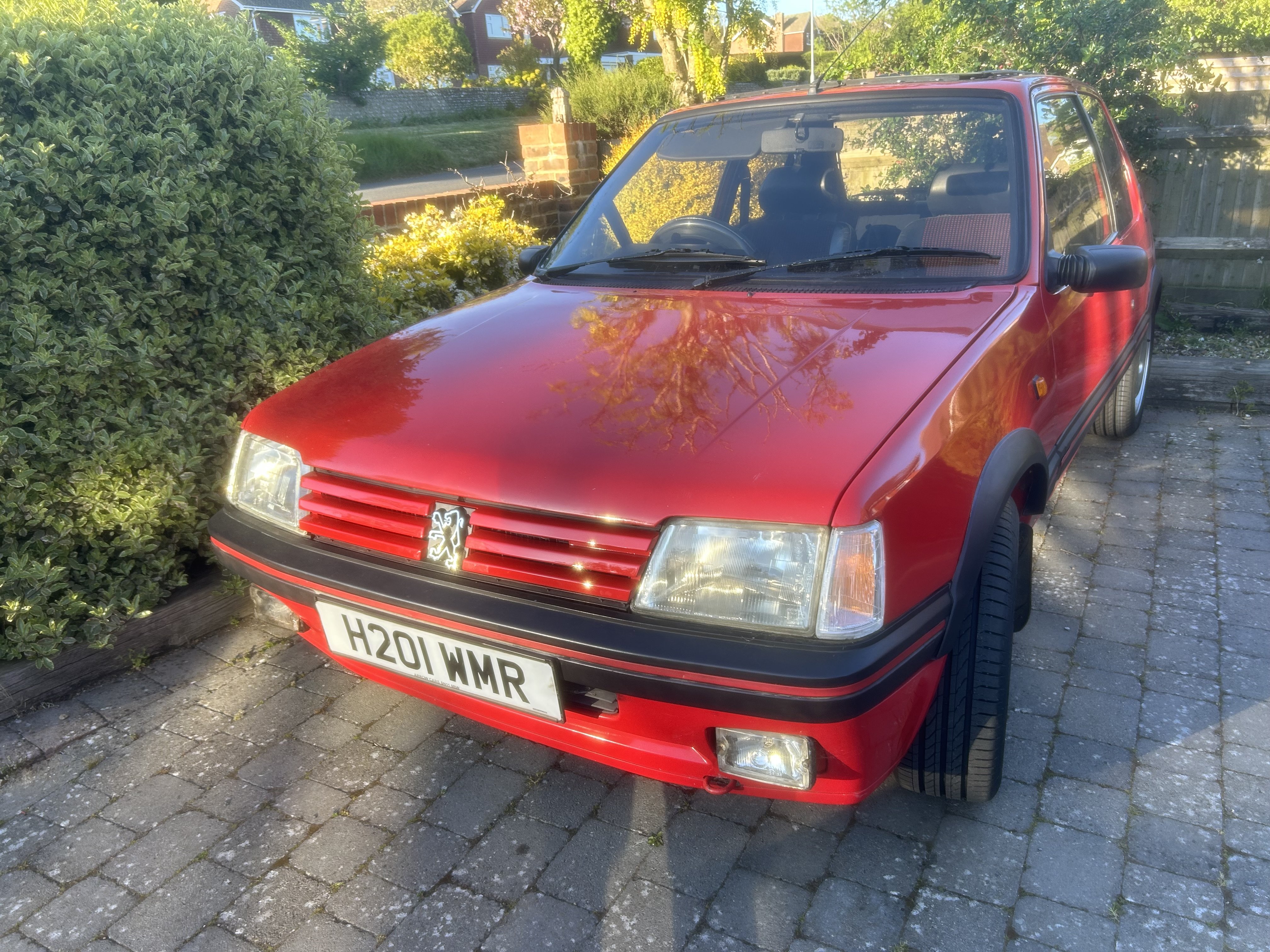

Dazie00 4 2 Cars Posted July 4 3 Month catch up , Well after buying this very late March i thought i'd log a progress report! Full service , Cam Belt , Clutch , Thermostat and wheel bearing Wheels refurbed and new Conti Ultra tyres 185s Sunroof bolts , trim replaced and vacum sorted Seat bases repaired or replaced Petrol cap replaced New Rear beam (Andy Williams ) 24mm ARB New Bilstein B4 s and Eibach springs , new top mounts ,bump stops/cups, drop links OMP strut brace Pioneer SXT-C10 stereo + Speakers + Vibe Subwoofer Grill resprayed + new badge New Gear Knob , window scrapers Getting there , yes it needs some paint sometime over the winter , plenty to do but it's getting there Share this post Link to post Share on other sites

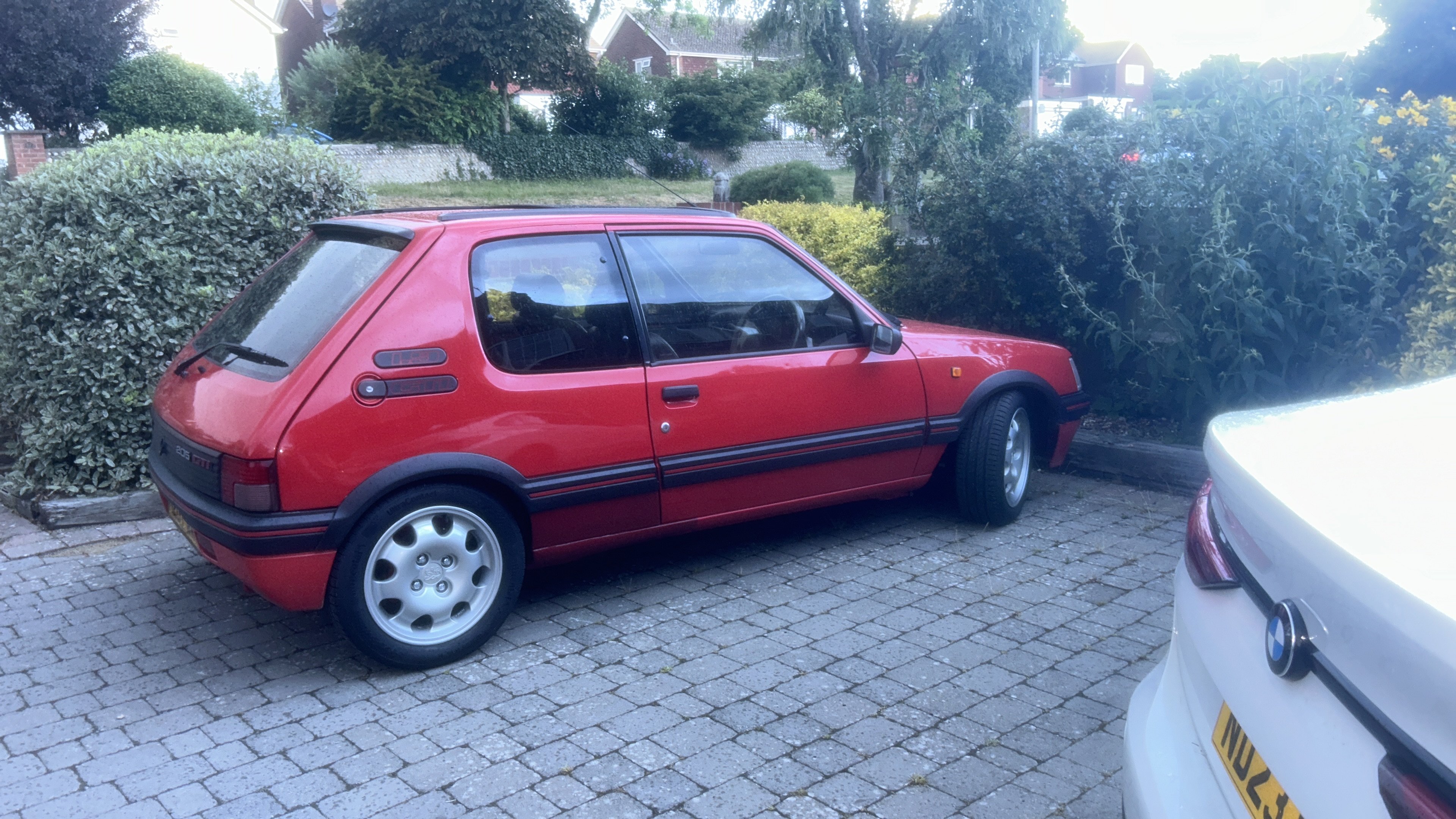

Dazie00 4 2 Cars Posted August 29 Latest Newer clocks/speedo cable Matching locks now all round New Discs and pads and braided hoses New driving lamps new leads, engine tune up PAS cylinder Sunroof deflector New red 205 gti mats Door window and hatch rubber seals Share this post Link to post Share on other sites
