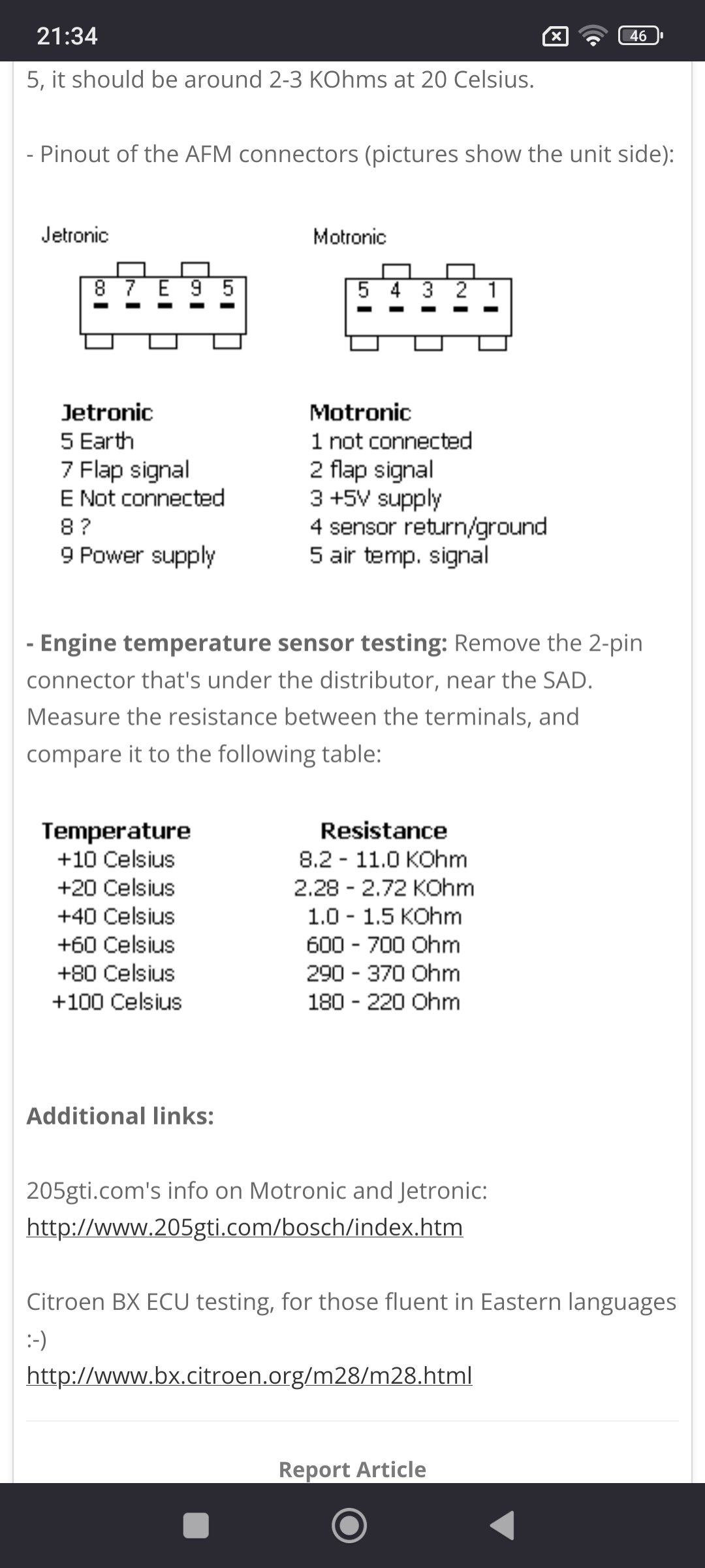

On 3/23/2026 at 9:47 AM, ALEX said:
Could someone confirm my AFM connector is wired correct.
It is not !
Brown weire is +12v
Green/yellow is earth
You've mixed up these two , pin 4 and 5 .
Switch over :
Pin 5 - earth , green/yellow
Pin 4 - +12v , brown
And that'll be it .

Ok,
So I switched the wires (the brown wire is actually mucky white, the photo is making it look brown.) and wouldn't even start.
It turns out I did such a sterling job at originally fitting my immobiliser I'd not noticed it was still wired in to the fuel pump!
I wired the alarm / immobiliser back together and it fired straight up. even idle, buttery smooth. I even tested the AFM by unplugging it, and result, lumpy rich idle! Perfect.
Turns out the Haynes Manual is wrong! When I re-pinned  the connector I used the the Photo and description 26.1b Showing terminals 18A (1) and M18 (2) It should read 18A(2) and M18(1)
Thanks for all your help on this guys, I can finally move forward on this and get it back on the road!
