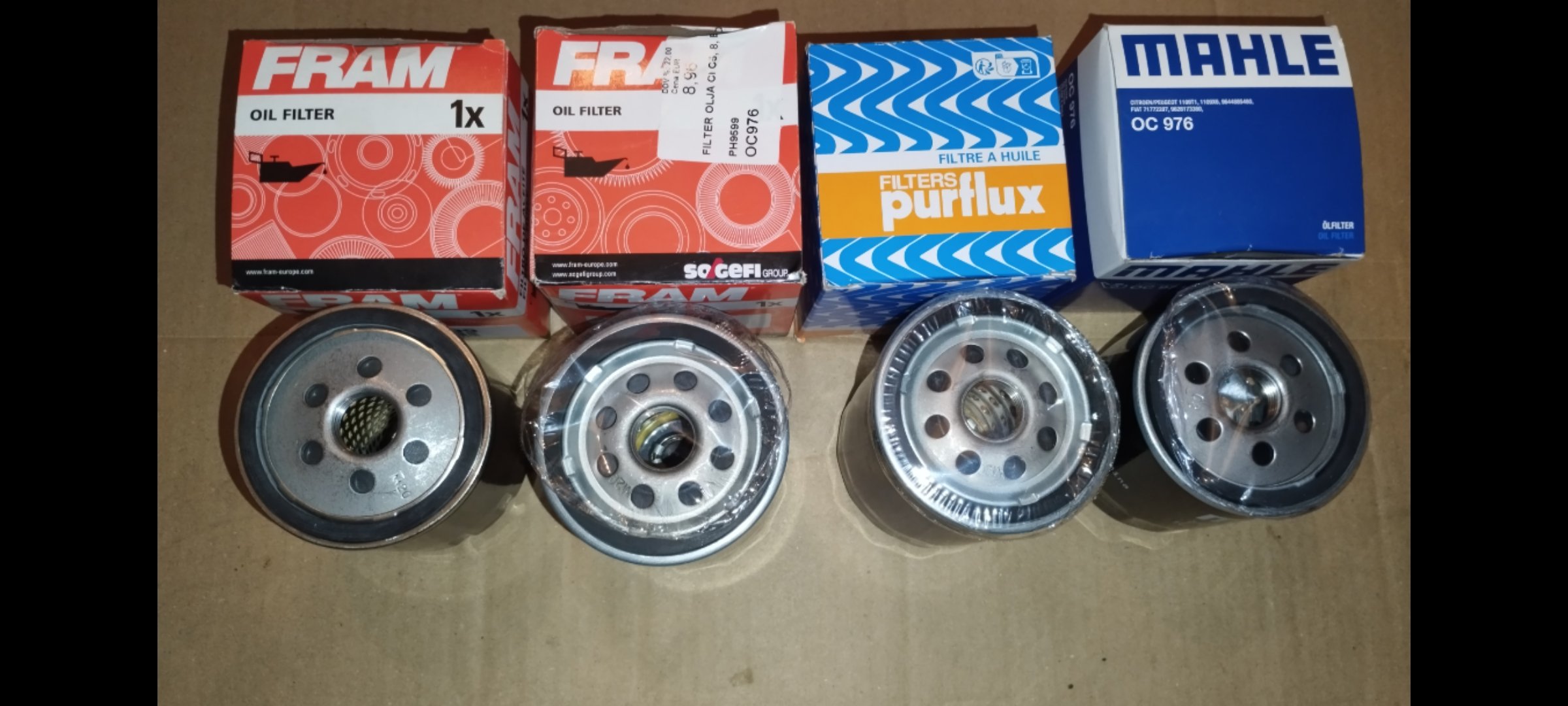

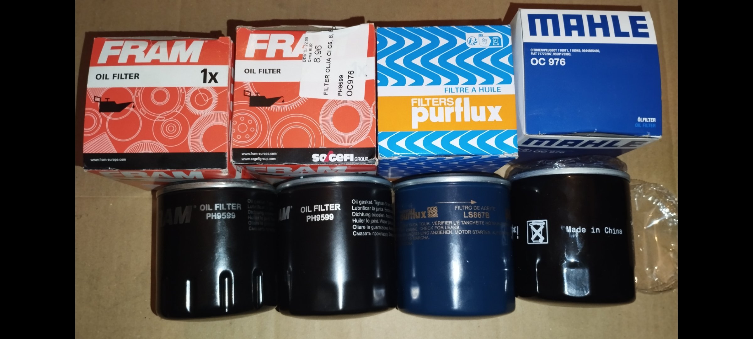

Anyone bought canister oil filters for XU engines lately?
If you go for the Purflux one thinking it will be the best and the OE-type filter — not anymore !
Purflux seems to have started selling some dodgy items.
There is no more “zig-zag” filter paper inside, just straight paper, and an odd-looking plastic bypass valve and central tube .
So either there are a lot of counterfeit filters around, or Purflux quality has seriously gone downhill.
There’s also a plastic protective film on top of the new ones — I’ve never seen that before.
Clearly made in China, and there are loads of identical ones on Alibaba.
The box is also a bit different — colours and font size differ from the old original box.
So I ordered the Fram variant, because before it used to be the identical Purflux filter just sold under the Fram brand. The Bosch *261 was also the same before — Purflux inside the box and made in France.
I ordered two Fram filters. One came exactly like the old made-in-France version with the “zig-zag” paper, while the other one was different — the Chinese one.
Same story with the box: the made-in-France filter came in an orange box, while the Chinese one came in a more orange/red box, with different font as well.
I tried Mahle too, as I remember them being very good for years and made in Austria. Not anymore — the same Chinese stuff.
It also seems like OE filters are no longer coming from Purflux. I’ve seen a lot of boxes marked “Made in TN (Tunisia)” and some Renault ones with the same marking.
So it looks like PSA switched to Mecafilter and Misfat, since those are made in Tunisia along with Valeo. Most likely reboxed Mecafilter/Misfat.
A few pics of wasted money (only the first Fram on the left is the correct Purflux-type filter) :

Seems like it'll be hard to find genuine Puflux nowadays , here in EU they all seem to be the "counterfit Chinese type" at least the canister spin on filters for older engines .
We do not have Rayco brand filters here , so i think i'll switch to Mecafilter as it's what PSA uses now as OE supplier .
Seen some tests and filter cut outs , and Mecafilter brand looks promising .
Oil filters contain double the size/lenght of the filtration paper compared to Purflux and other known brands , paper quality is said to be better too .
This Chinese Purflux version failed miserably on filter tests , it's on top 5 price wise expensive filters but nearly on the bottom filtration and quality wise !

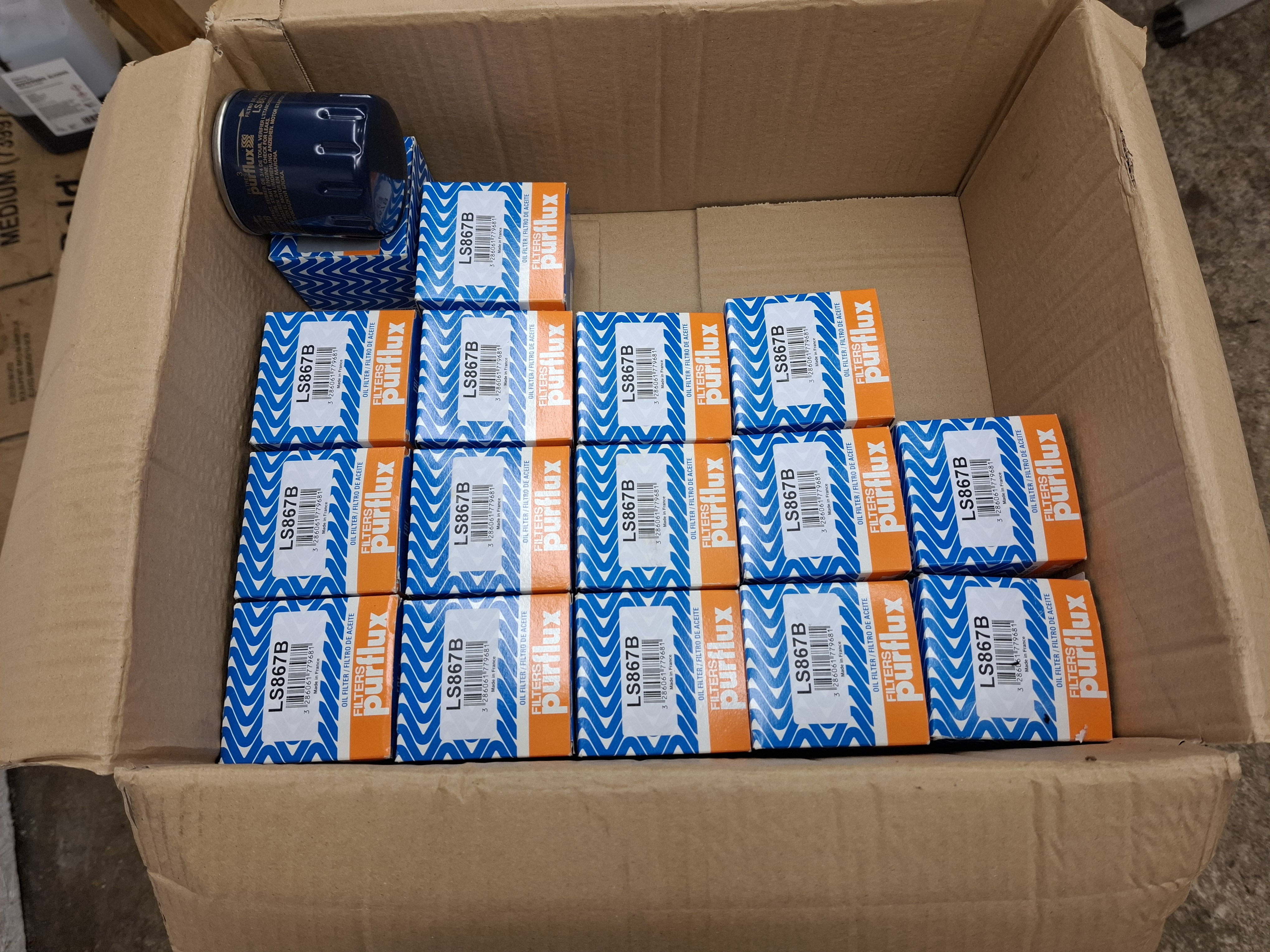

I got 20 from Autodoc approx a month ago they are all the zig zag type, I tend to use the later LS923, but they were low on stock of those hence these earlier types.
Maybe Your local shop is not getting them through official supply channels and is being scammed?
I decided not to use Mahle oil filters mebbe 20 yrs ago, a quick suck and blow on a new filter showed the valving was useless back then, nothing to do with China they were European crap back then.
If I cant get Purflux I use Mann as a second choice.
Peugeot have been supplying Tunisian filters for a goodly number of Years, when the Tunisian ones showed up in the bulk packs we sent em back and have been getting Purflux from Autodoc since.

Holly c**p ! you bought the lot of them that's the reason we can't get them anymore !!
I tried odering from the three different local parts suppliers , one of them being quite big Eastern EU supplier which does direct import and wholesale too .
And they all shift the same Chinese Purflux  with the condom .
Most of the spare parts here arrives imported from the Poland , maybe they have few variants od the same aka grade 1 , 2 , 3 to pick & chose at the warehouse i really don't know ?!
Only managed to get one real Purflux in that second Fram PH9599 box .. so seems like a gamble ..
Apart from the Fram , Bosch 0451103261 and CoopersFiaam FT5656 where also identical Purflux LS876B filters , haven't tried to order those two .
I agree , some of the filters from Mahle are crap but people stick with them cause they used to the brand .
Why sent back the Tunisian ones ?
No good or ?
