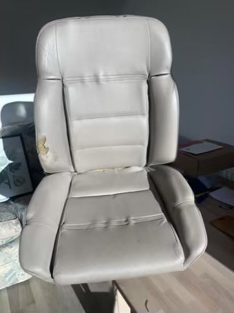

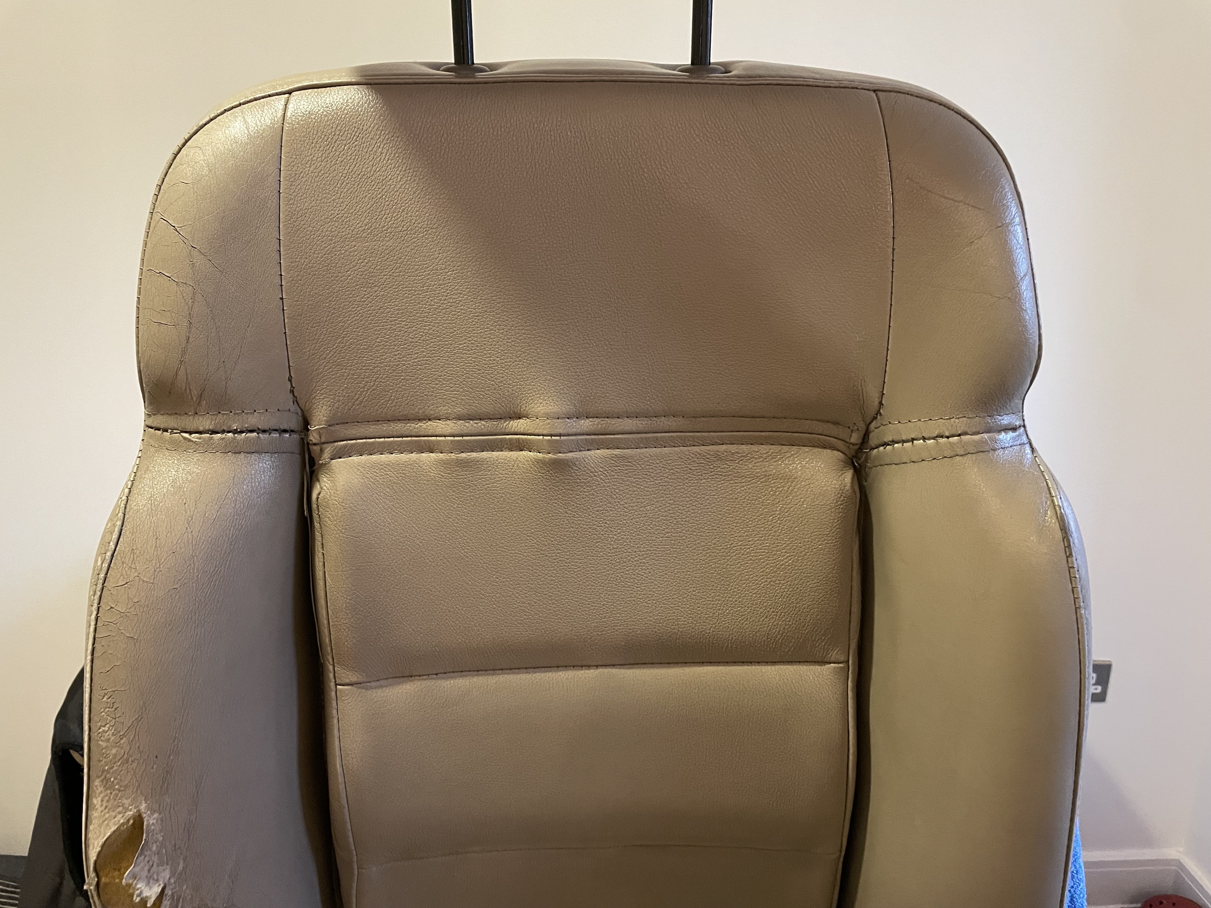

Bremar 7 Posted January 3 Hi, does anyone know where I can find the trim code location in my 1993 Peugeot 205 Gentry so that I can get the correct leather dye or paint for the seats. Also any recommendations for a repair kit? For the hole in the bolster? The drivers leather seat is a bit damaged and I want to have a go at repairing it and painting/dyeing the cracks in the worst areas. Never tried this before so a learning curve for me. I’ve been looking for 12 months for 205 Gentry seats but nothing has turned up yet. Mine look a sort of light grey colour tho someone suggested they should be tan?? Thank you Brett Share this post Link to post Share on other sites

Bremar 7 Posted January 8 Hi Leslie, my leather isn’t hard so I think I will give up on trying to find a replacement seat/ leather from an unwanted seat. I have re-sown the split sown joints in the seat side squabs with a light grey Marlow no4 Whipping Twine that I’ve had around. Not brilliant but ok. I think I’ll try the “hot gun” approach ( if that’s a real thing) to remove the puckering on the seat. Thanks Brett 1 Share this post Link to post Share on other sites

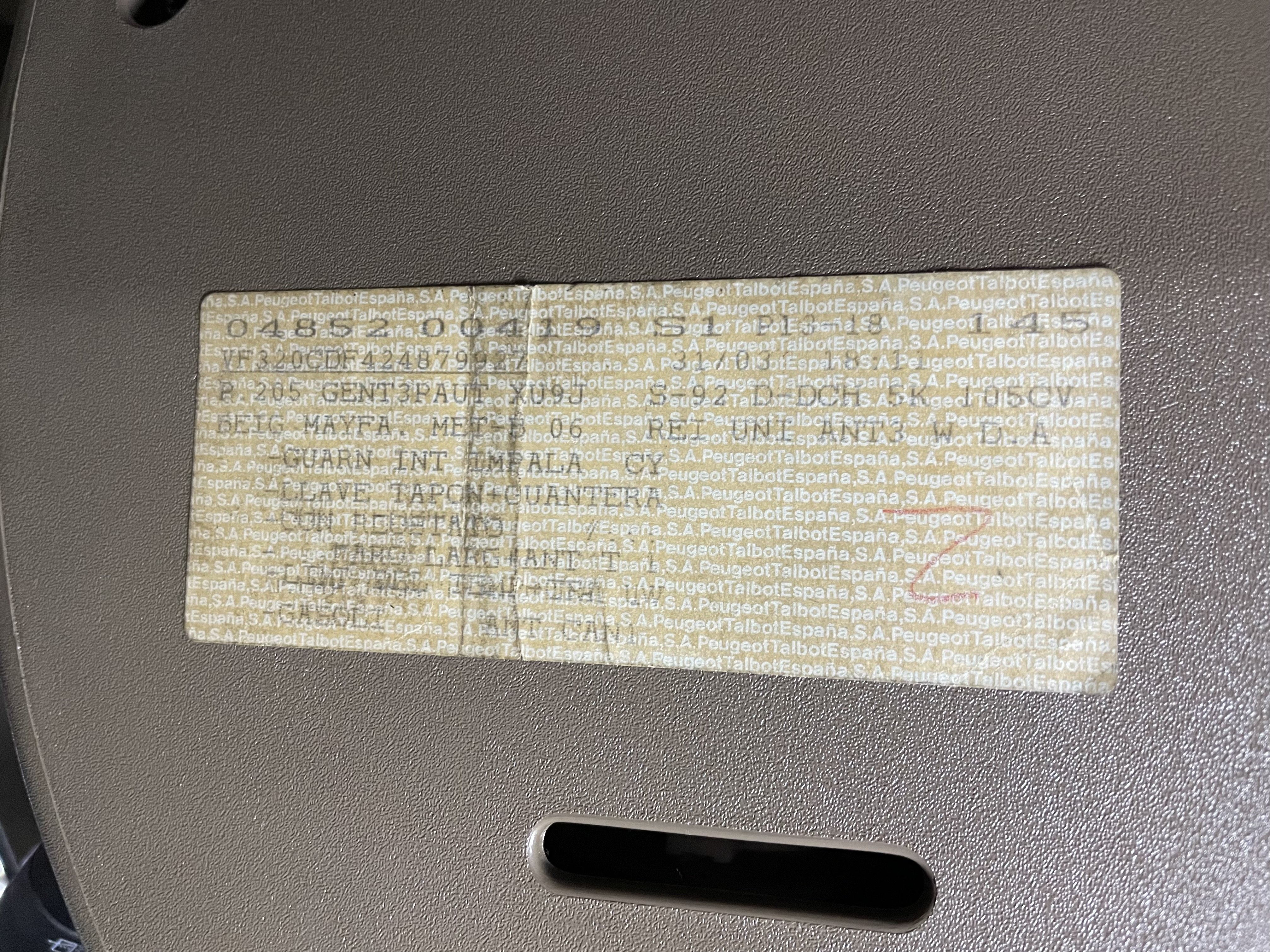

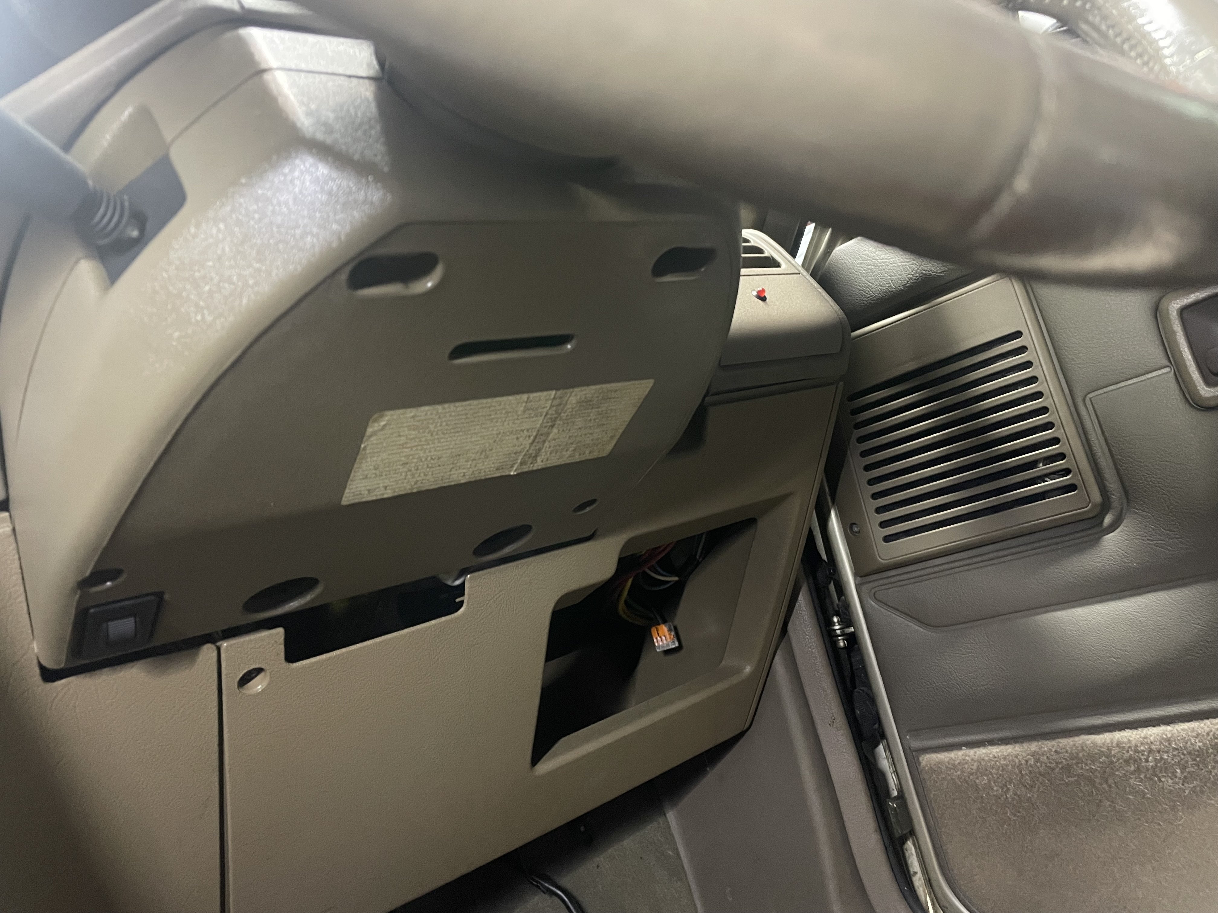

Bremar 7 Posted January 11 (edited) Finally just out of interest I found the following label under the steering column. I can not read French but I’m sure it’s saying amongst other things that the interior trim colour of my Gentry is IMPALA CY. The label also shows my vin number which corresponds to the rest of the car. if anyone fancies interpreting the rest of the label that would be great. once again this forum is streets ahead of anything similar. Thanks Brett Edited January 11 by Bremar Share this post Link to post Share on other sites
SRDT 233 Posted January 11 You don't need to speak french, that's spanish. I've never seen a PeugeotTalbotEspaña,S.A sticker like that before, once the car was finished it was probably removed for it's original spot then stuck there upside down. FCZ is the code for Impala beige plastic parts bdw. Share this post Link to post Share on other sites
