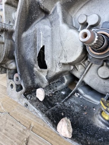

ArthurH 12 Posted December 1, 2025 Just now, ArthurH said: How we got to this point is in this topic here: I need to change the casing of our BE3 gearbox We re-shelled the race car over the last winter. The donor car was a 1994 INCA diesel (1.8 n/A). Although the engine was of no use to us, I noticed the gearbox looked a lot like our BE3, so I hung onto it, just in case... Now I need it, I see it does indeed have the same 'BE3 XU' emossed into the casing - I am hoping that will make it suitable as a replacement casing - obviously all the ratios will be wrong, so I need to move the gear clusters from one to the other. (I will refer to them as the GTI and Diesel boxes) I have very little knowledge of gearboxes; the last one I stripped would have been a Ford 2000E from my Mexico in the early '80s - 40 odd years ago! So apologies for silly questions. I have found on this site these two articles: https://www.eastment.net/BE3 Gearbox Strip.htm https://www.rallyparts.co.uk/cwp_change/ And I am trying to amalgamate the information/method. Neither goes as far as stripping out the casing completely, which I guess I will need to do. I want to give the Diesel casing a really good clean when it is 'bare'. Are there any other resources I should be looking at? I haven't got very far and could already do with some advice. I'm struggling to remove the 5th gear from the output shaft. I am aware it is very easy to chip the teeth. Is there a 'safe' method? Share this post Link to post Share on other sites

Tom Fenton 1,650 Posted December 1, 2025 If the only damage is the hole, I’d consider getting it welded up. You will spend a lot of time and effort building into another casing, all new bearings for a start, and then all the fun of buying and selecting shims to set end float. Repair your existing casing and you don’t need to do any of that. 1 Share this post Link to post Share on other sites
ArthurH 12 Posted December 2, 2025 Thanks Tom, as well as the obvious hole, other cracks are surrounding it. I know each one could be welded up, but I'm concerned that we would miss something. There is also some minor damage to the main cluster housing from before this race, so while acknowledging your suggestion, I think I will press on. Share this post Link to post Share on other sites

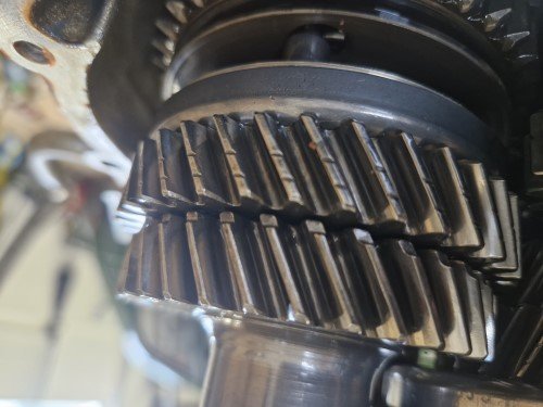

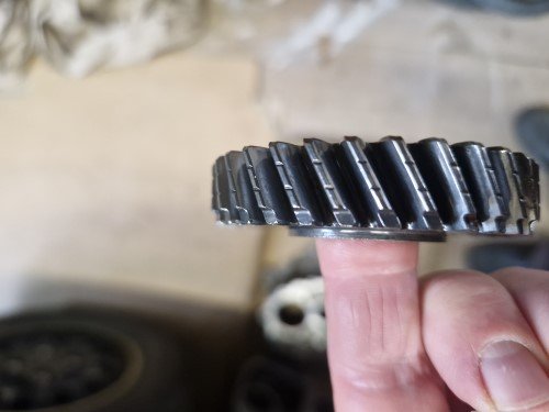

ArthurH 12 Posted December 4, 2025 The 5th gear in question is the one in the diesel gearbox, which I decided to strip down first. I have removed the whole gear cluster with 5th still attached. I can probably leave it like that unless I decide to swap any of the synchro parts (see below). I have now started to strip the GTI gearbox. Would I be correct in thinking that all the parts, except for the different-ratio 'drive' gears, are interchangeable? I ask, as if they are, I may as well use the best bits from each gearbox. The most obvious difference I have spotted so far, is that the selector forks are 'bronze' coloured in the diesel and black in the GTI. Also, at least 2 of the drive gears, 3 & 5th have the edges of the teeth deliberately relieved on the GTI box but not on the diesel box. Is this somehow because of the larger diameter necessary for those specific ratios? As the bearings on the GTI box are very good (I believe they were changed just before James bought the car), I wasn't going to dismantle the clusters; however, I may be missing an opportunity to inspect the synchro parts. Is that at all possible with the bearings still on the cluster? Share this post Link to post Share on other sites

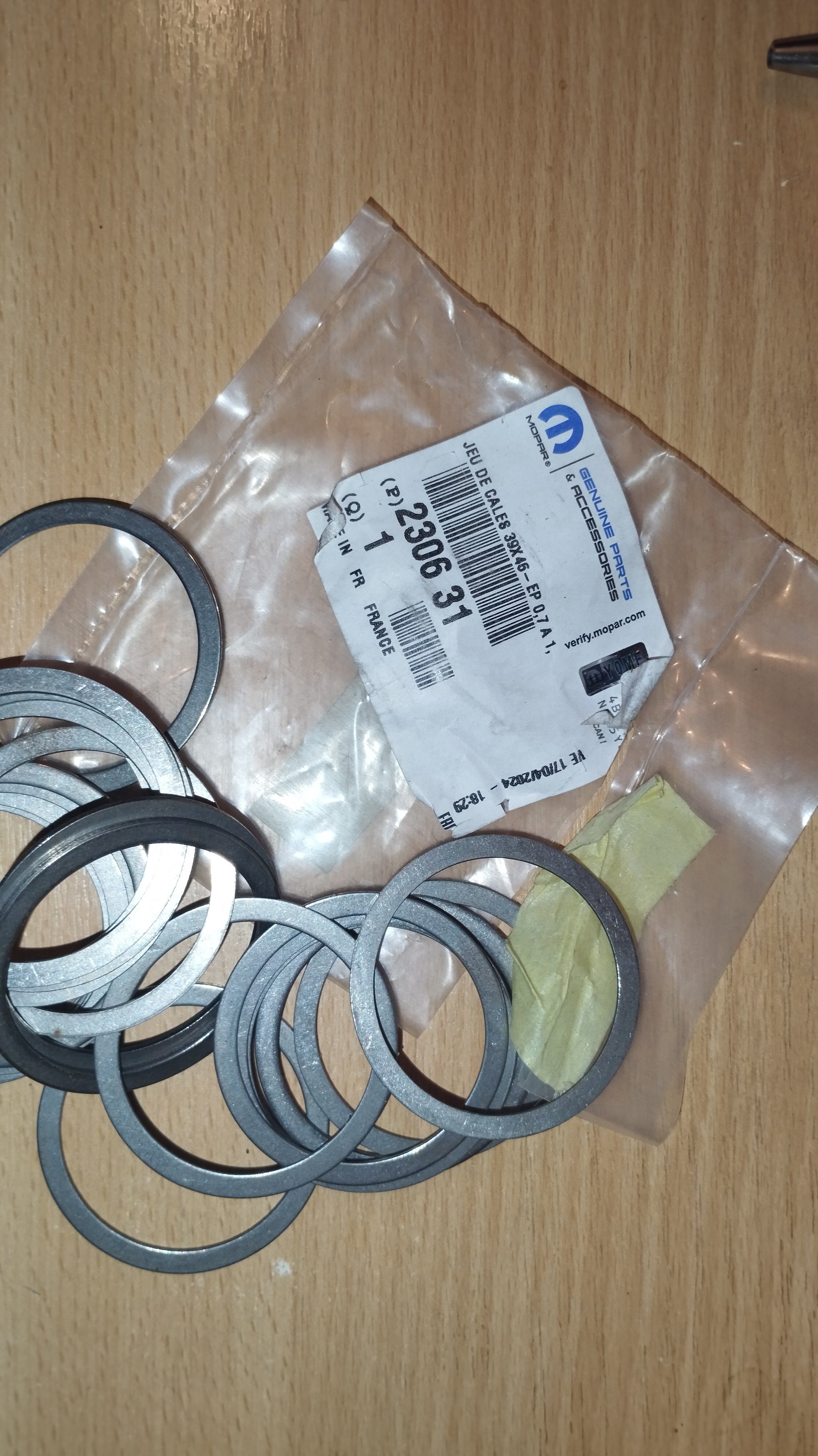

ArthurH 12 Posted December 9, 2025 For the benefit of anyone reading this thread in the future, I've changed my view on the orientation of the stepped washer. I have fitted it with the flat side towards the bearing - I think it is supposed to clamp the inner race as opposed to giving clearance to the bearing as I first thought. I am setting the input bearing preload. I have two spacers, one from each of the GTI and diesel gearboxes. As I am measuring with a combination of imperial micrometer and digital metric vernier, I am being realistic about the accuracy of my measurements. If I fit the diesel spacer, it will give a negative gap of 0.276mm (I assume that to be synonymous with 'preload'). What would be the symptoms of too much or too little preload? I'd guess too much would heat the bearings and waste power...? Too little - would that be noise and vibration? How much out would be an issue? Share this post Link to post Share on other sites

DamirGTI 366 Posted December 19, 2025 Setting input shaft preload is really dicky !! At least was for me , built three with some "general purpose" industrial shims and neither was good/quiet .. third one though was less noisy , but still a bit noisy when cold . So i came to the conclusion that the shims i've been using are no good , too thin and soft .. Recommend buying OE pack of shims , they,re around 80 $ , 24 different shims inside .. It wont go bang if you set it loose , been driving mine for 6 years , hasn't gone neither better nor worse just the noise irritates .. 1 Share this post Link to post Share on other sites
