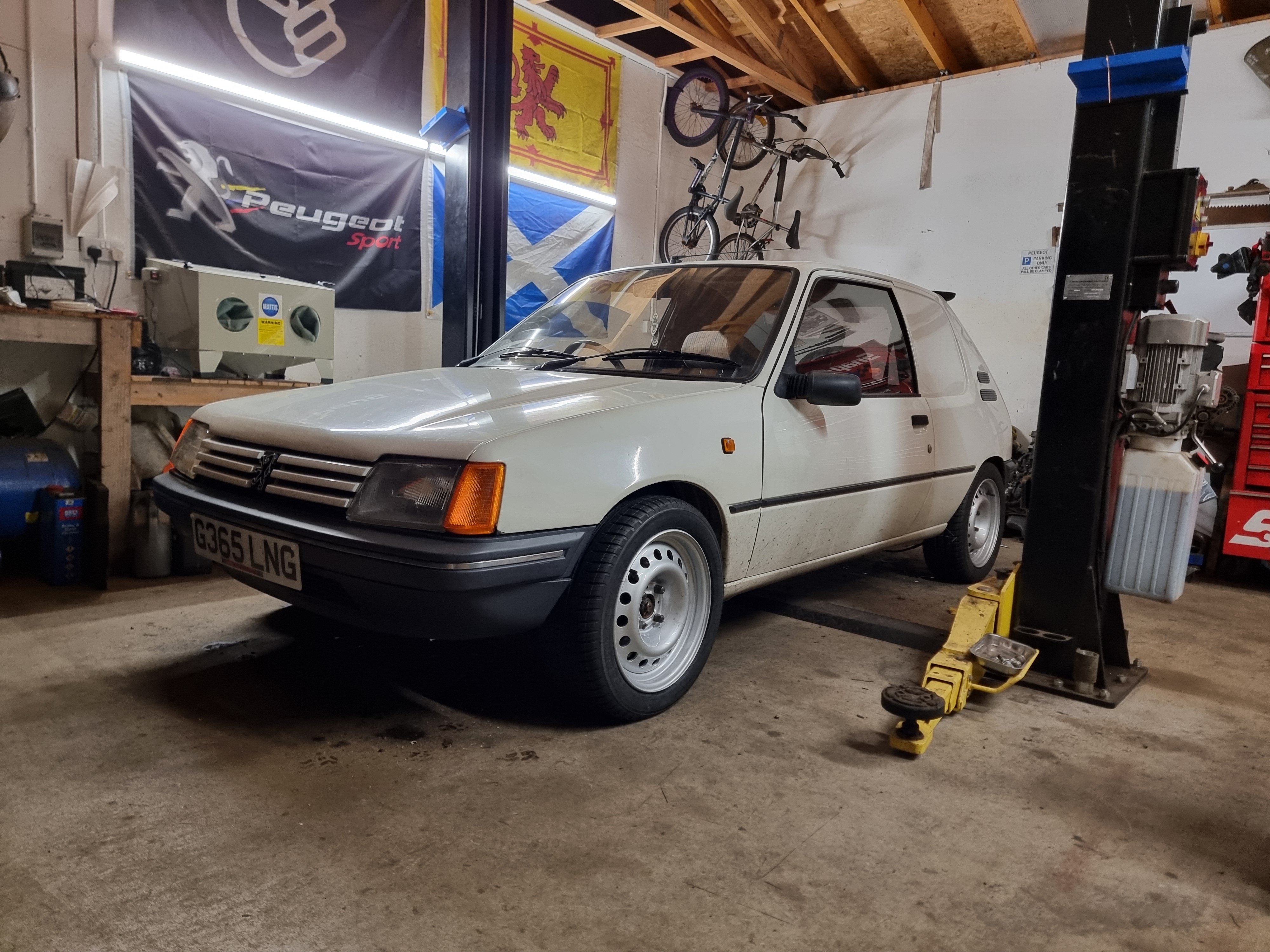

Hello, I've just got my old 205 xrad van back and looking to do some maintenance on it before putting it back on the road.
I've been looking to try and find out which coolant hoses would've been used for the engine conversion as the lower hose from the heater matrix is split - would any of the BakerBM reproduced ones work for this?
Also, it has one of the chinese aluminum rads from ebay but is weeping slightly between the fins near the top so I'd like to replace it, I've seen reviews from others saying they've also had leaks from the chinese ones too. A few people run the standard width radiators on their dturbos - what's your guys thoughts on this?
Cheers,
Gohn

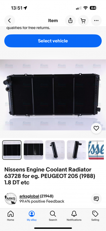

Last year the radiator went on my dturbo xud7te, looked allover for a replacement.
I even had the spare off my gti which was in good condition but when you start looking at fitting it the pipes and mounting locations are all wrong.
in the end bit the bullet and found a company to import me a genuine Nissens one, this wasn’t cheap at all but fit back perfectly and hasn’t missed a beat since.
Depends what you want to spend, this was what I bought and who from
