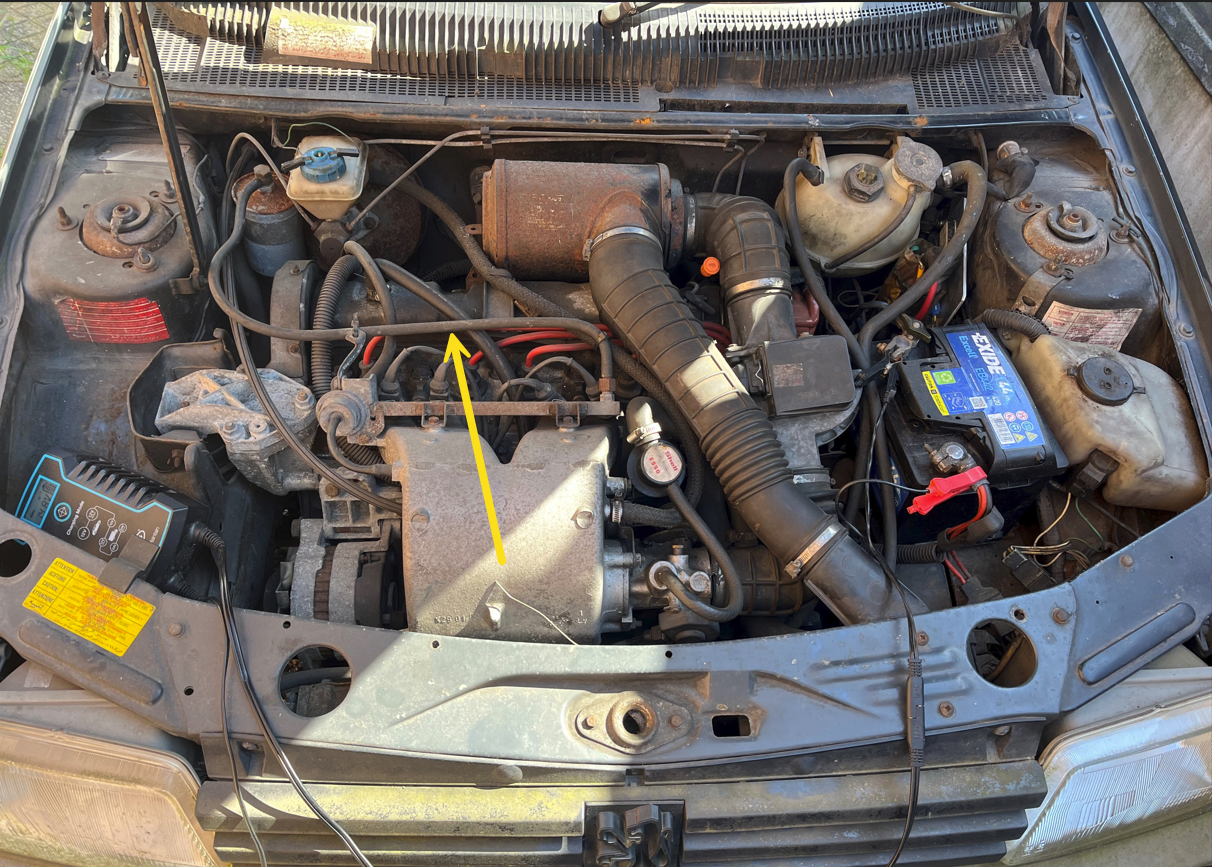

Thanks for the advice guys. I will sort a fuel pump gauge out and maybe replace the fuel filter as well. The fuel filter was replaced when i put it back on the road in 2015ish cars probably done around 3k miles from then (if that but it may be ropey) and i was thinking of getting another fuel line off Baker anyway and fitting a gauge permanently within the line across the top of the engine where the yellow arrow is.

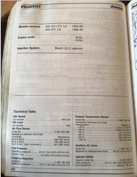

I have also tested the AFM as the Autodata manual says and that appears to be a bit iffy. I have a video on that which i will try and upload. Hopefully its not that as they appear to be a bit spenny as well. Like i say dont want to start firing the parts cannon at it so will check fuel pressure and status (whether tacho relay is working properly or not) and go from there.

This is when i took the AFM out and tested it against known good measurements out of Auto data manual. Will try everything before getting the platinum card out!!!!!1
I would have expected a nice linear resistance from closed to fully open or visa versa but appears to be all over the place (between terminals 5 & 7) - note i am pushing the flap with a bic pen!!
SRDT
It's normal, output resistance isn't linear in relation with flap angle. It directly represent the airflow that is pushing the flap. The L-Jetronic ECU is full analog and can't convert flap angle into airflow so the AFM does it and has to be fine tuned for pretty much each engine.

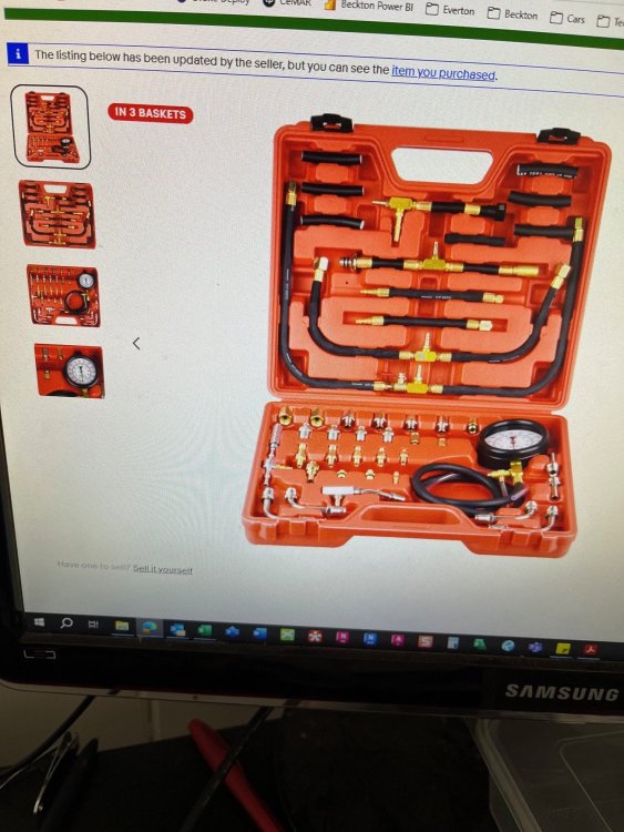

I have just ordered a fuel pressure testing kit with a bazillion attachments - i was hoping to dab onto just before the fuel rail so as not to disturb the pipes on the pump!

I'm hoping there should be enough gender benders in this kit to get me in line with the fuel rail  due for delivery today
The union at the fuel rail is 14x1.5 male with a taper seat. Not sure what is in that kit.
