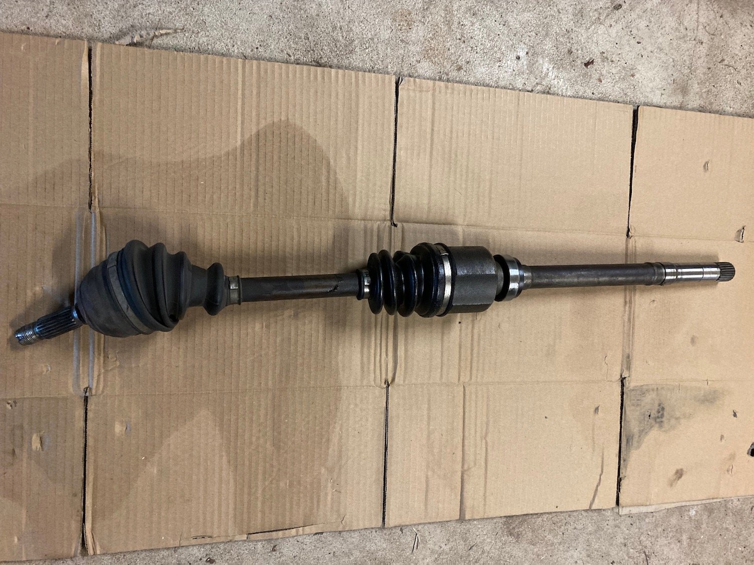

I've noticed a line of grease flung out of my inner CV boot on my RF driveshaft
(driveshafts are Meyle non-Gti, 21 Spline, M20x1.5thread, M30 hub nut staked, about 5 years old now, they've been good)
 inspected it on the car a few times but could not find a hole anywhere

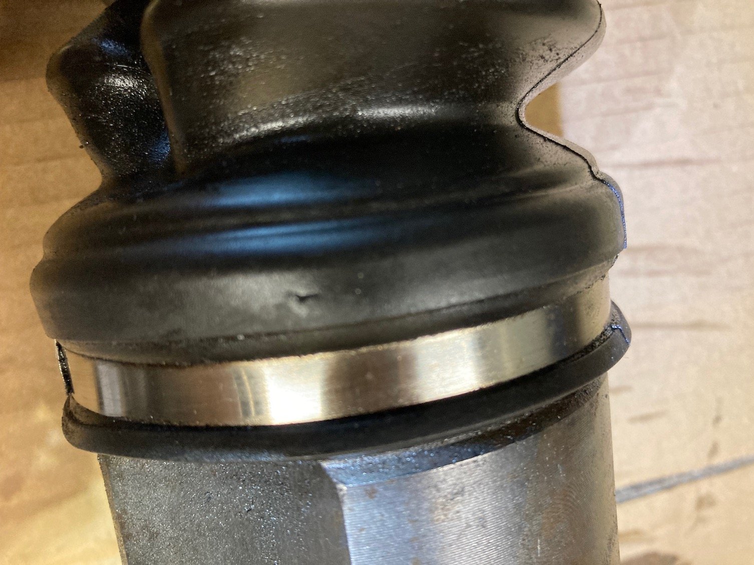

got it out for closer inspection found a very small hole next to the cv boot clamp, probably copped a stone
have not replaced a boot before and don't have the spreader tool
- will it keep spraying grease until dry and then wreck the CV joint ?
- do I tap the driveshaft apart or get a boot spreader and do it that way ?

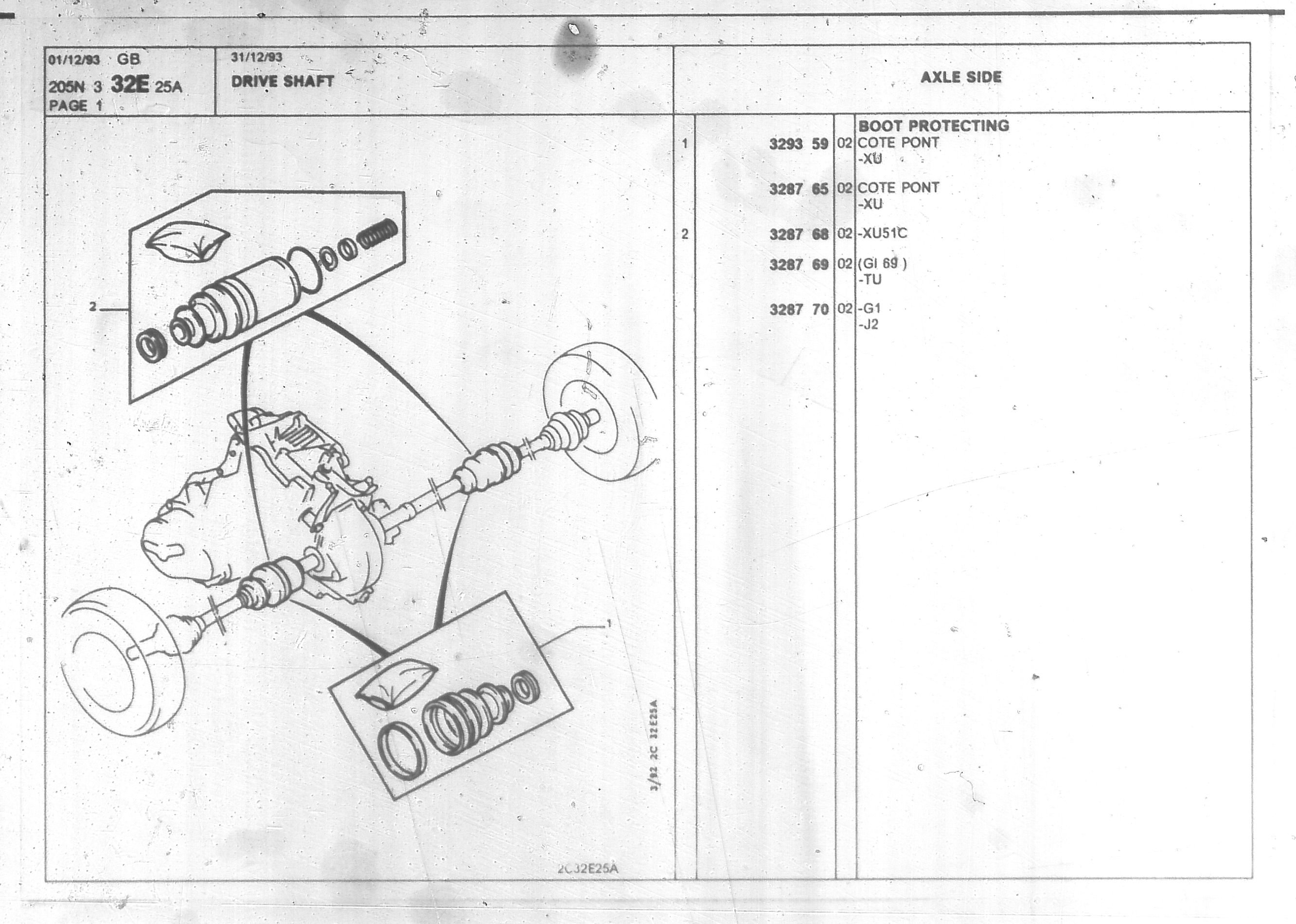

- and which boot do I get, looks like there's a heap of different part numbers ? the catalog is confusing
Luckily you have the easier type, the only tools you will need is a circlip plier, hammer and drift, and some kind of tool to tighten the new clips.
All will become quite evident when you remove the clips and lift off the inner joint cup.
To get the right boot measure the shaft and the cup o.d, that is more of a 1.9 style boot on the inner.

Degrease with solvent, dry, superglue it, wipe silicone sealer over the top, it will do another few years.

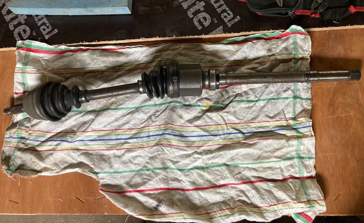

shafts out , shaft dimensions
RIGHT
Inner CV - Large End (Elliptical) 74.5mm, Small End 23mm
Outer CV - Large End 78.5mm, Small End 24mm
LEFT
Inner CV - Large End 82mm, Small End 23mm
Outer CV - Large End 81mm, Small End 24mm
Do I order smaller diameter boots for a snug fit ?? (for a 23mm shaft do I get a 21mm boot ?)

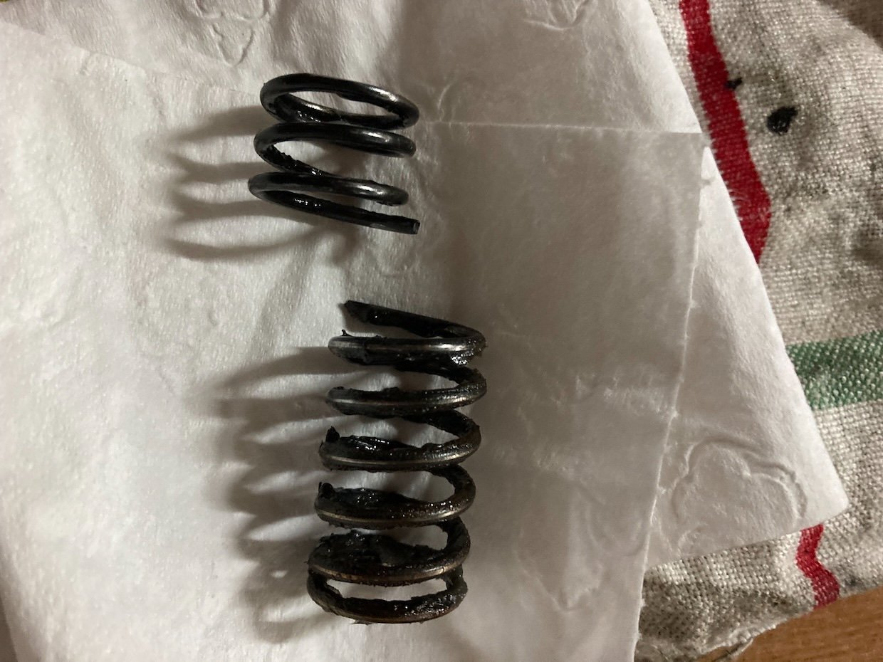

the Right Inner CV has a busted spring , 21mm OD. Do I have to throw away the whole shaft ?
any suggestions appreciated

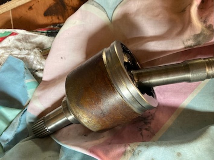

replacing my CV boots
its not obvious how to do these things, where and how they come apart, how to do the steel clamps, etc

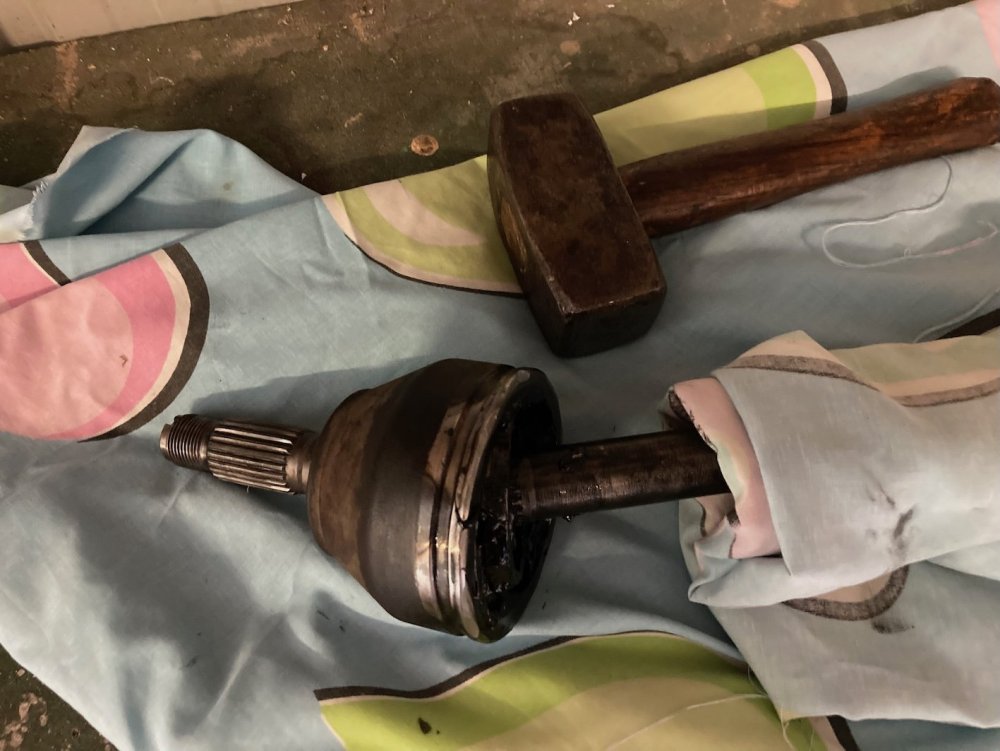

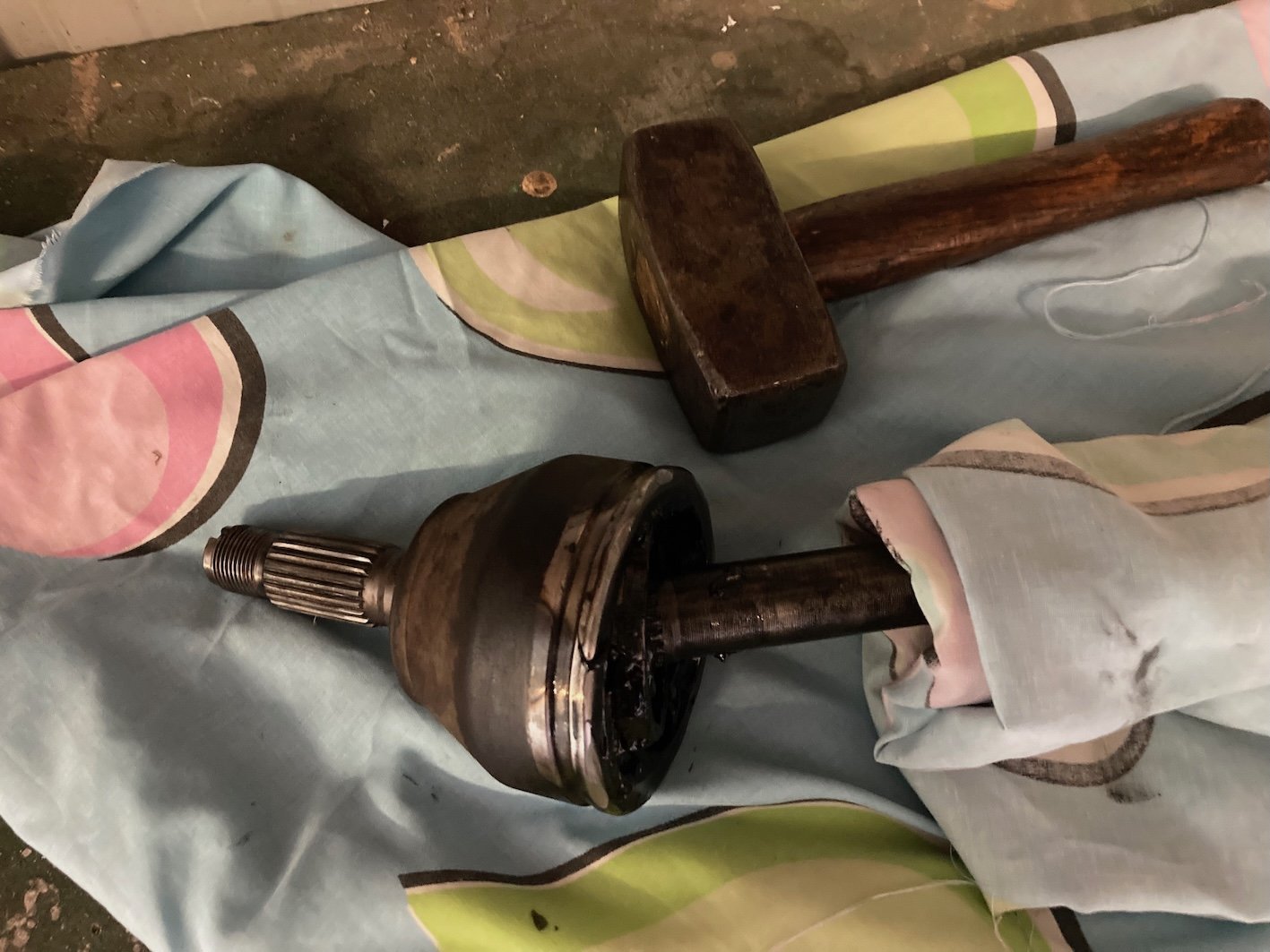

cannot get my left outer CV off the shaft !
I've thumped it with the lump hammer on the outer rim lots, wont come off
is there any other way ??
I don't have a replacement CV just the boot so if it gets damaged I'll be going backwards

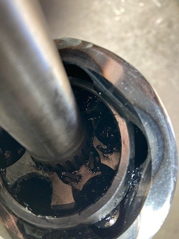

Clean the grease a bit and check if there ins't a weird circlip :
file.php?id=10899
don't hammer the outer, get a good sized drift on the inner part, worth tapping the joint on and rotating the haft a little, as some portions of the clip are tougher to make the CV slide over when they don't drop into the groove.
a little late now by the look of it, but I find its sometimes easier with stubborn ones to slide the boot on from the inner end if you are replacing both boots,
I have not had a Peugeot shaft not want to come apart but did recently have an SKF vw transporter shaft I just couldn't get apart, just replaced the whole shaft in the end, they really have gone downhill on some stuff recently.
SRDT
The circlip that seats on grooves on the shaft and the inner part won't bulge even with a big hammer and using a puller tool will only damage the joint.
never seen that style before, only the round wire clip inside.
SRDT
It's hard to notice when it's full of grease and after using the puller it's usually too late.
At least it's not crimped so you can take it apart if you know about it or spot it by chance.

The spring on the long shaft did bugger all, its fine to bin it, the short shaft needs its spring and thrust cup to stop the inner joint pulling out of the final drive as the shaft increases and decreases in length.
I am, and I would obviously, but it wont come off either and I'm not hitting it with a lump hammer
nailed it SRDT ! mine's got one of these, although its almost impossible to see even with the grease cleaned away
will spread the clip and remove with finesse this time

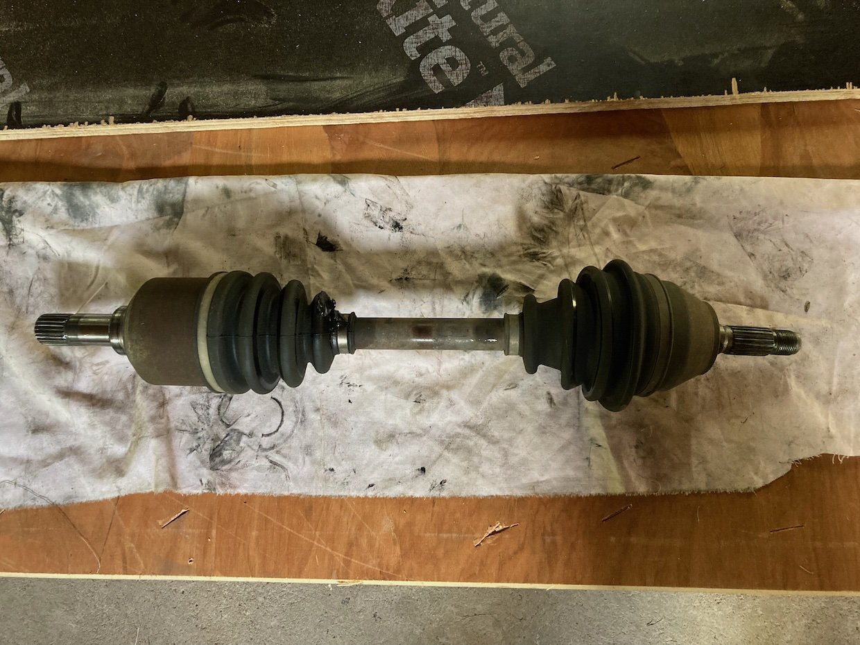

after a month off the road :
don't have the correct parts, (that actually fit)
Meyle STILL won't give me the correct part numbers
don't know how to get the driveshafts dismantled
don't know how to get them back together
don't know how to clamp the metal clips, so I use zip ties
one boot out of four replaced so far...and it could be wrong
and this topic does not show up on here, have to go and search for it to find it
so if you have to do this job, if you get nothing else from this topic
you can take it from me:
1. it is difficult
2. nothing about it will be obvious
so baptiste, if I spread the circlip and hit with a drift on the inner part of the cv joint it should come apart right
how tf do I get it back together ?
or if I can't get the outer cv off or on, how tf do I get the inner cv off the shaft ?
Edited by Gohn
spread the clip with internal circlip pliers and knock it off with a drift and a lump hammer.
fitting is easy, make sure the clip is sitting central in the groove, push the cv against the end of the shaft then tap it on (fit the nut on the end to protect the threads)
SRDT
Mei is right, once spread the clip can fit entirely in the outer groove and just clears the splines so that the shaft can pass freely. There should be no big chamfers so you can tap with a drift and a hammer to help parts get in place but a big wack won't get everything lined up forcefully.
For reassembly on the other hand there should be a big chamfer at the end of the shaft so the clip will be pushed/spread further inside the outer groove then ride on top of the shaft splines until it fall into the inner groove.
Gohn
the shaft numbers above are wrong.
L (short) is 40-14 498 0038
R (long) is 40-14 498 0035
the spring clip on mine was more difficult to spread out because the ends weren't parallel like the baptiste version
the boots are not meyle so the L inner ID seems too tight and it seems too short too
same for the R outer boot
I think I didn't put the R outer CV properly back on the shaft, its full of grease and you don't know when to stop hitting it
so the R outer's probably f***ed (CV not on shaft)
the R inner has the original boot which probably wont last long (the new boot was way too small ID)
the L inner potentially f***ed (boot feels too small and will probably work its way off)
the L outer is ok
