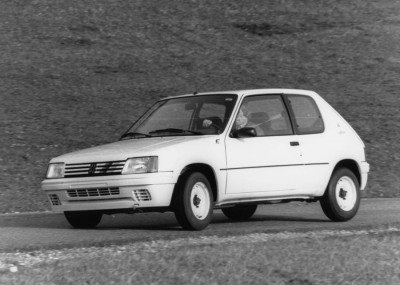

Hello all, I'm doing some research into my next project. I'd really like a Euro Rallye, the most simple thing to do would be to just buy one but I'm not sure if I could live with a LHD car, although I have no experience actually driving a LHD car. What is your guys experience on this?
I recently bought a UK Rallye project with the intetions of building it as a Euro Rallye, installing a tu24, gti running gear, going as far as sourcing the dash blank, mirror blank, deleting side repeaters, getting the correct clocks etc. I'm second guessing that decision now - although it would be a great project, and sometimes half the fun is sourcing all these rare parts, there would be far too much time, effort and money spent trying to achieve this.
I could just get a basemodel 205 and get a nice built Tu3 with carbs/itbs for it but I don't think I'd be happy with the end product as it would just be a modded basemodel and not a proper Rallye, in my opinion.
Keen to hear what you guys think, has anyone built a similar car or know of any that are similar spec that would possibly be for sale?
Or any contacts in UK for Euro Rallye parts?

It doesn't take long to get used to LHD over here. As a daily driver then yes it can be tiresome with things like car parks, drive thrus etc. But realistically you probably wouldn't use that car for those uses.
Wallby
I think what your trying to build is my car! I've got a UK Rallye, but with all the good bits of the Euro Rallye - Tu24, Webers, gti subframes etc. It really is a great package.
I think you might be overcomplicating things by trying to source a tu24 and things like that, as in I'm not sure you'd notice a massive difference between a spicy tu3 and a tu24 - just make sure you keep the alloy block. The original DCOMs are also a bit of a pain to find anyone who knows anything about them, DCOEs would be much easier.
Your UK rallye project with a hotted up tu, gti front and rear subframes and some Bilstiens would be amazing. You can get the interior pretty close too, gti red carpet, red seatbelts - dash blanks are easy to come by, I have one!
