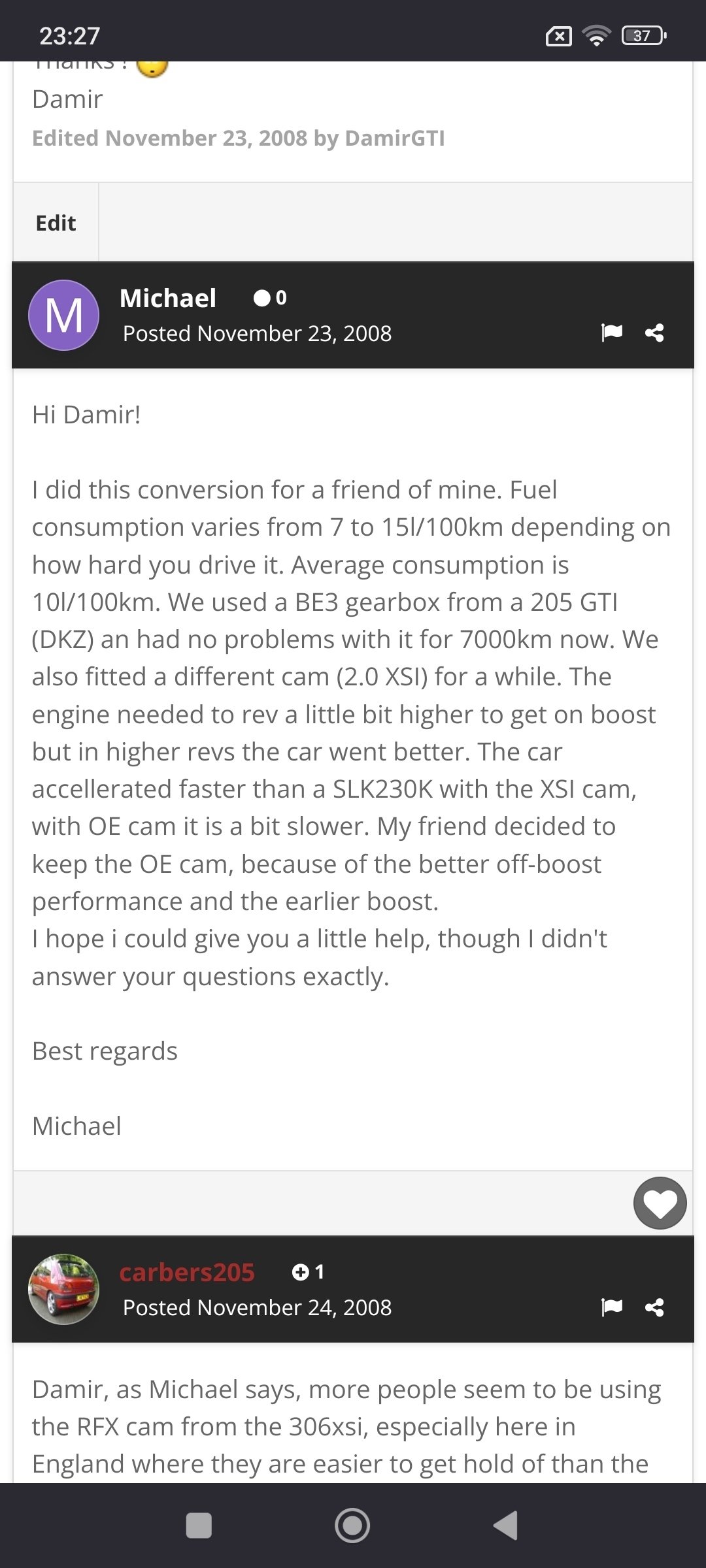

I found some old forum posts where people said the engine would rev higher with the DKZ cam but also that the turbo would  start spooling later in the rev range too .

Post with regards to DKZ/RFX cam instead OE , says as suspected shifts boost upper in the rev range .. not sure Id like that on heavy car such as 406 :

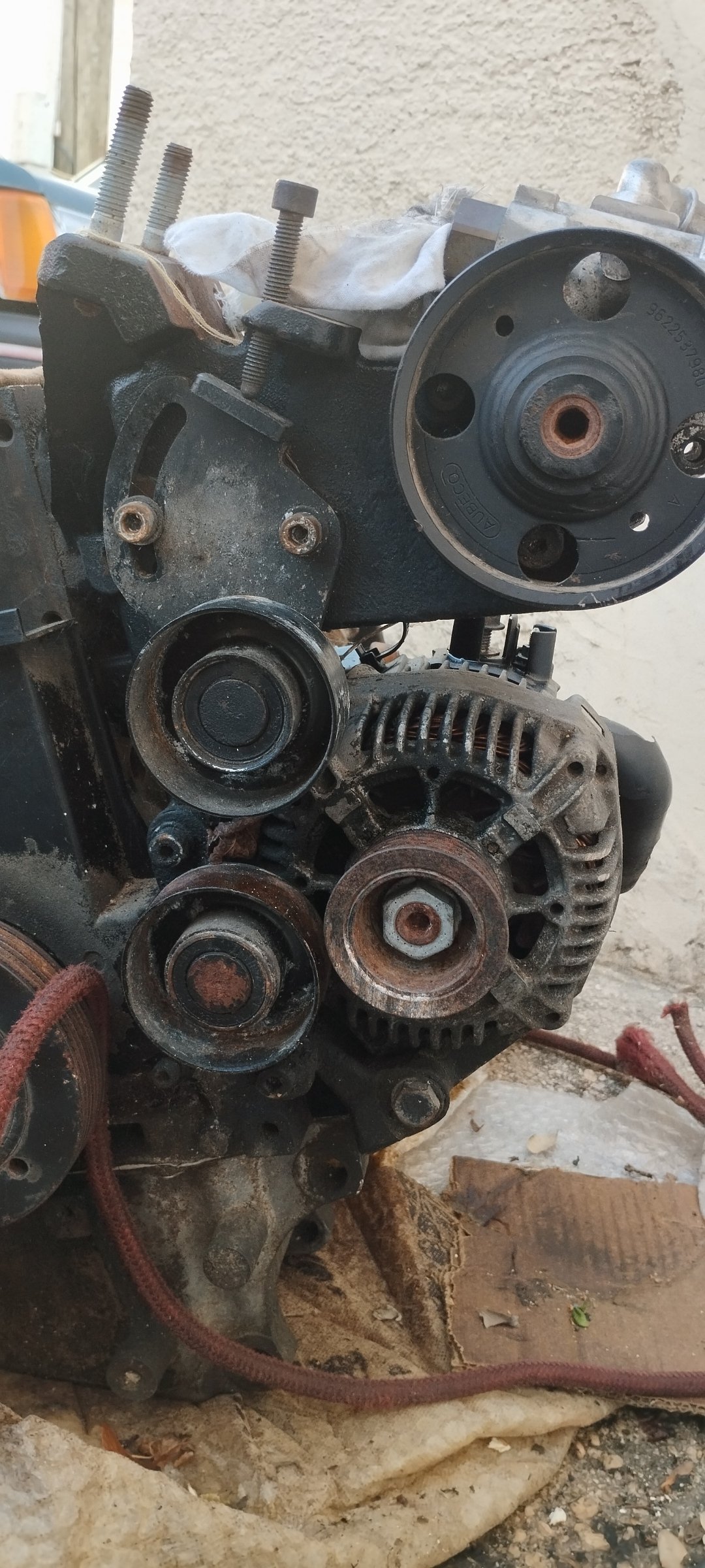

Serpentine belt tensioner/pulley layout on that RGX engine with which i got *813 ECU :
Edited by DamirGTI
thats a non ac setup, also used on the 306 rallye,    ac engines would have used a sprung tensioner attached to the side of the sump with the ac pump on the front.
