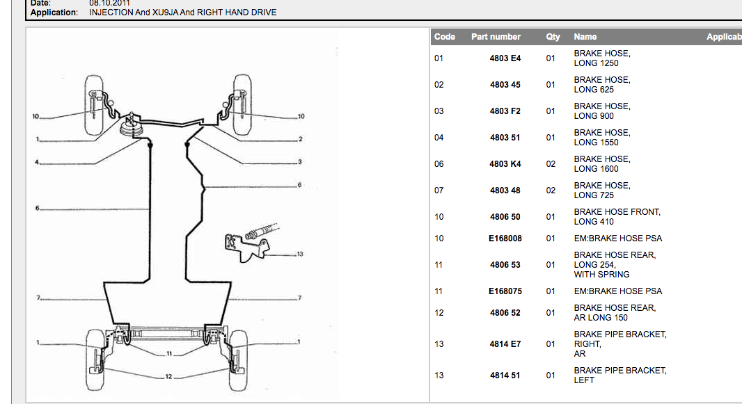

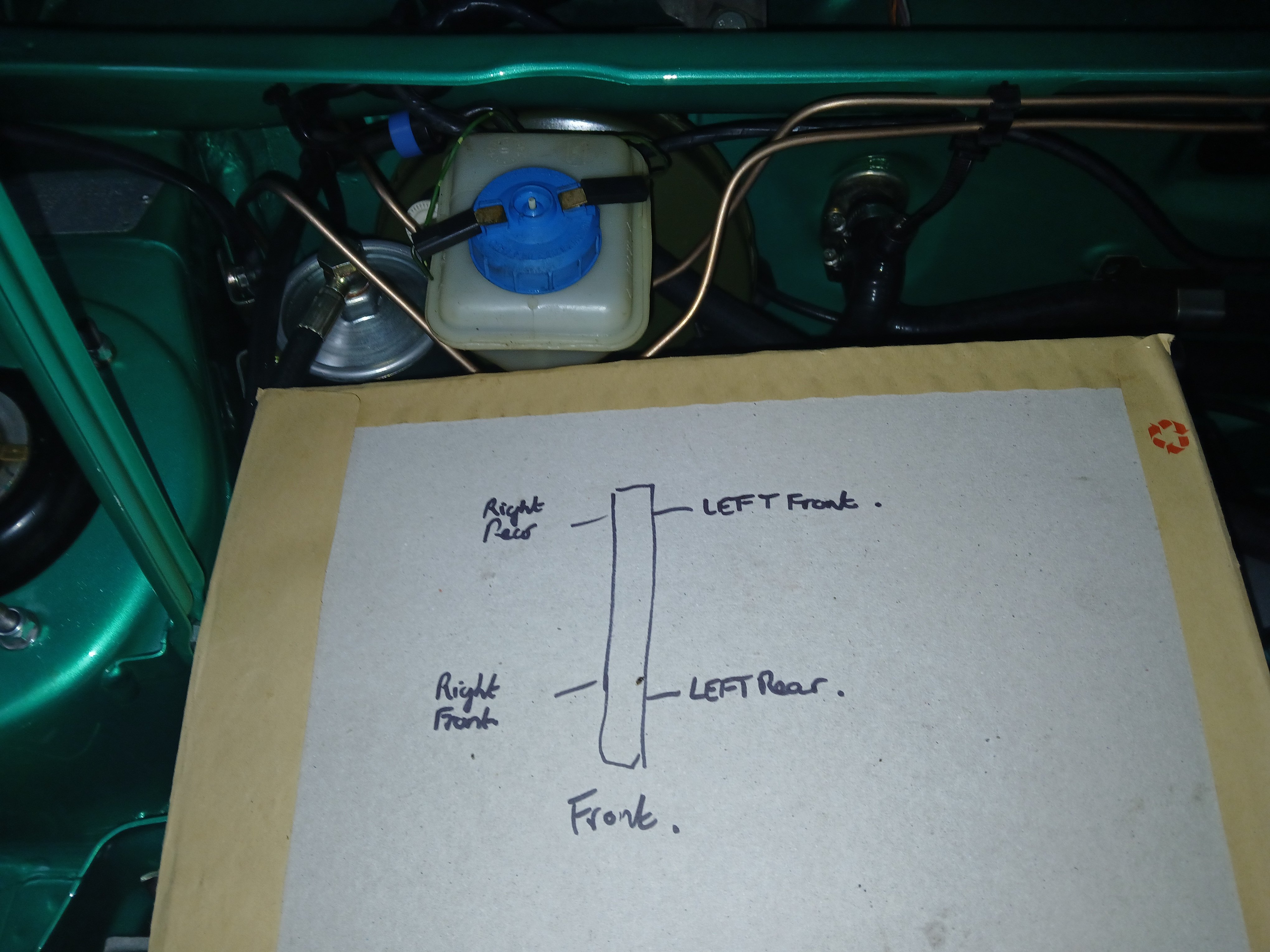

Ronan B 1 Posted January 31, 2025 Hi I’m restoring a ‘92 1.9 Gti from a bare shell, just getting around to brake lines. What way are they split from the master cylinder? Is it front right and rear left, front left and rear left ? thanks in advance Share this post Link to post Share on other sites
Gohn 73 Posted January 31, 2025 the catalog pic attached is for 1.9GTi , Right Hand Drive as yours is but it actually looks wrong the brake booster should be on the Right side for RHD surely ? or am I misreading the diagram ? Share this post Link to post Share on other sites
Ronan B 1 Posted February 1, 2025 Thanks mate, much appreciated Share this post Link to post Share on other sites
