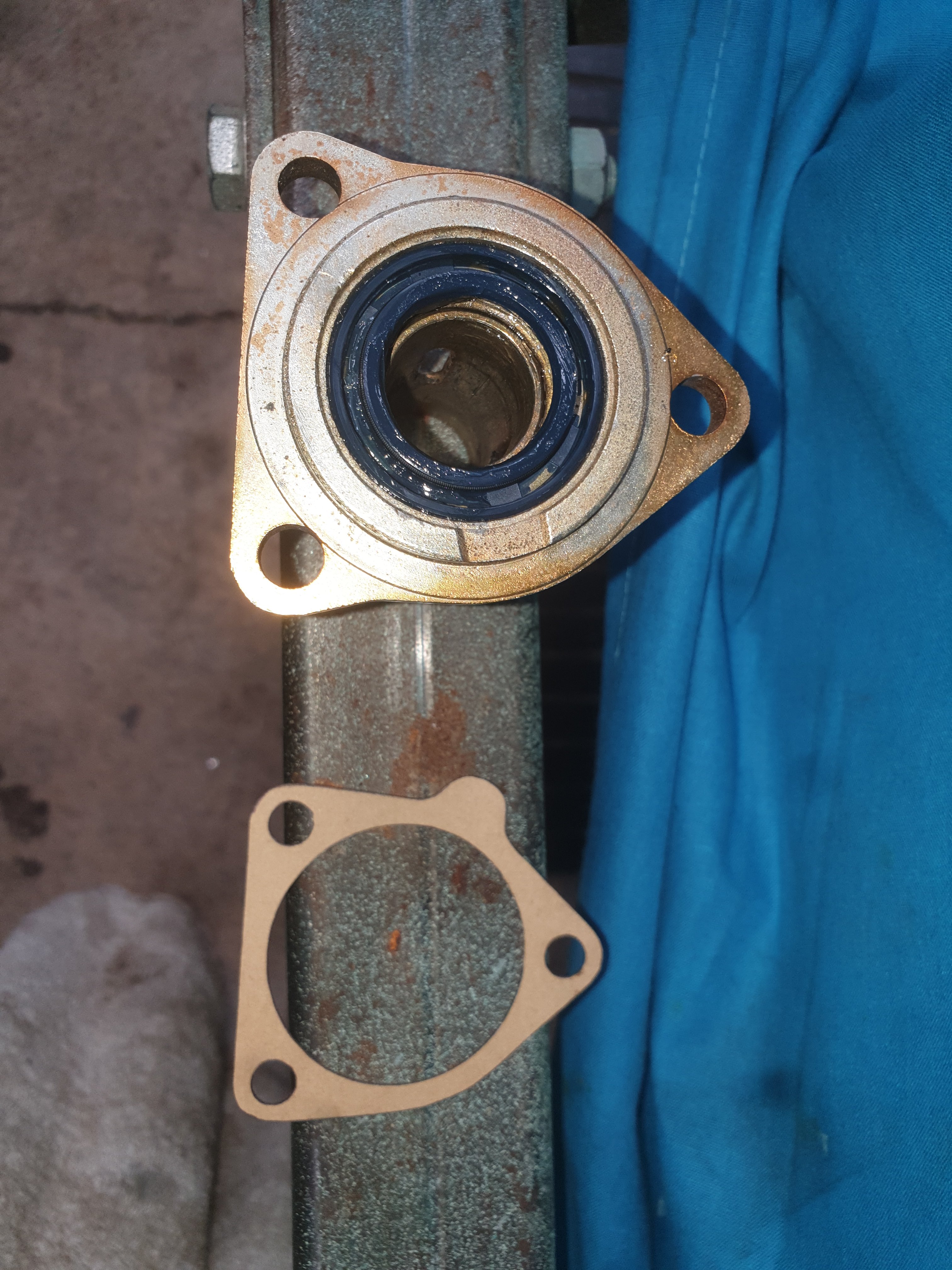

I´m doing some service on be3 from mi16. Box is stamped -91.
I will replace the sleeve on inputshaft.
i have the earlytype 2105 17 . Its sealed with thin paper gasket. Cant find it on sites like autodoc/mister auto
i see the later box has part-number 210535 and that is available aftermarket. it has some preapplied rubbergasket according to pictures.
Are these numbers/variants interchangeable?
The basic design looks very similar. Maybe someone has practical info.
Yes they are interchangeable, you will need to check the bearing preload.
Leslie green
You just replace the rubber seal inside it and the paper gasket no need to replace the whole thing
