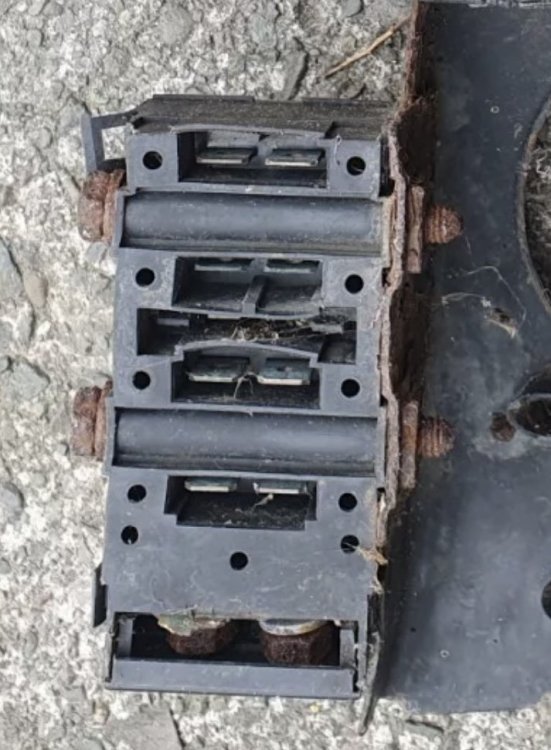

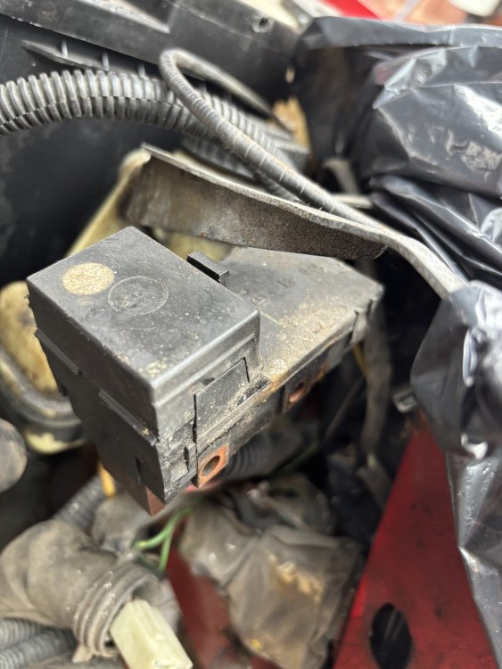

Hi, could anyone tell me what this is called please, I’m after the fixings that connect it to the passenger side of the slam panel.
TIA
Leslie green
2 long m6 or m7 bolts , width of the fuse box plus about 10mm extra screw into 2 captive nuts in the slam panel ,on cars without the captive nuts there is a bracket
jord294
M6 by 50mm iirc
