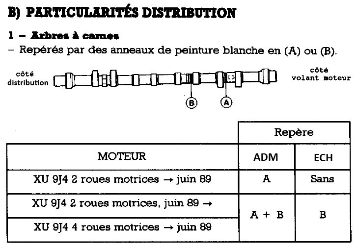

Found it, the way to tell older and newer camshafts appart. A white paint ring on (B), that is cylinder 2 starting from the flywheel.
