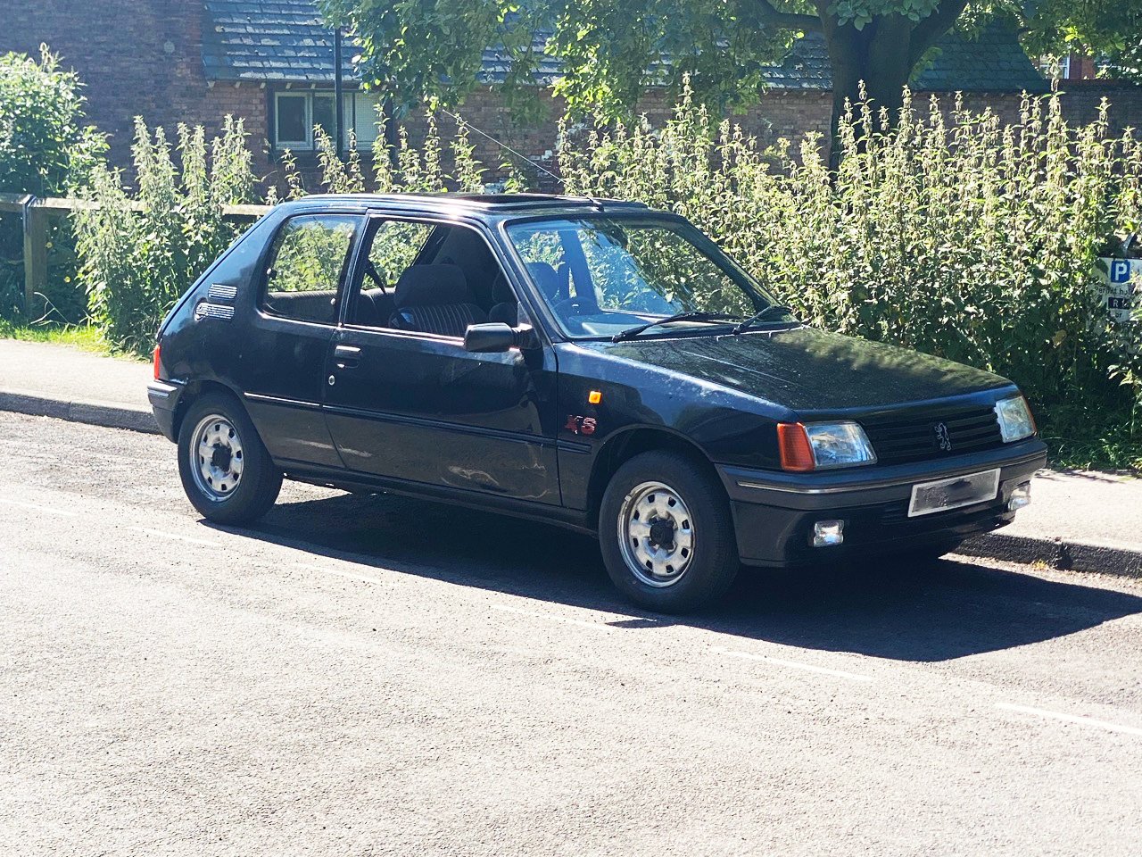

Tesseractoid 3 1 Cars Posted July 9, 2024 Hi all I rescued a G reg XS a while back, it's my first Pug! though I always loved them back in the day. I had an AX GT late 90s, unbelievable car to have back then at 18 years old, my mate had the XS and we'd stick to each other like glue on the backroads! Long story short I've been nursing an XS back to health after being sat for 10 years, as you can imagine the to-do list is seemingly endless, but thankfully rust isn't a big part of it. Just recently did enough to get it through the MOT, and it's starting to take shape into a pretty lively thing, taking it easy for now as suspension needs work, but it want's to live! and the TU3s / solex twin choke is still a total hoot to play with, even 20+ years later! I thought I'd start a thread here in the hopes I can get some help ID-ing various issues, a few concerning noises coming from underneath at the moment.. if anyone fancies helping me spend some money I'd appreciate your input sourcing the right bits etc.. Cheers! Joel 2 Share this post Link to post Share on other sites

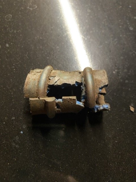

Tesseractoid 3 1 Cars Posted July 15, 2024 Reckon the old roll bar bushes were past their best! Share this post Link to post Share on other sites
