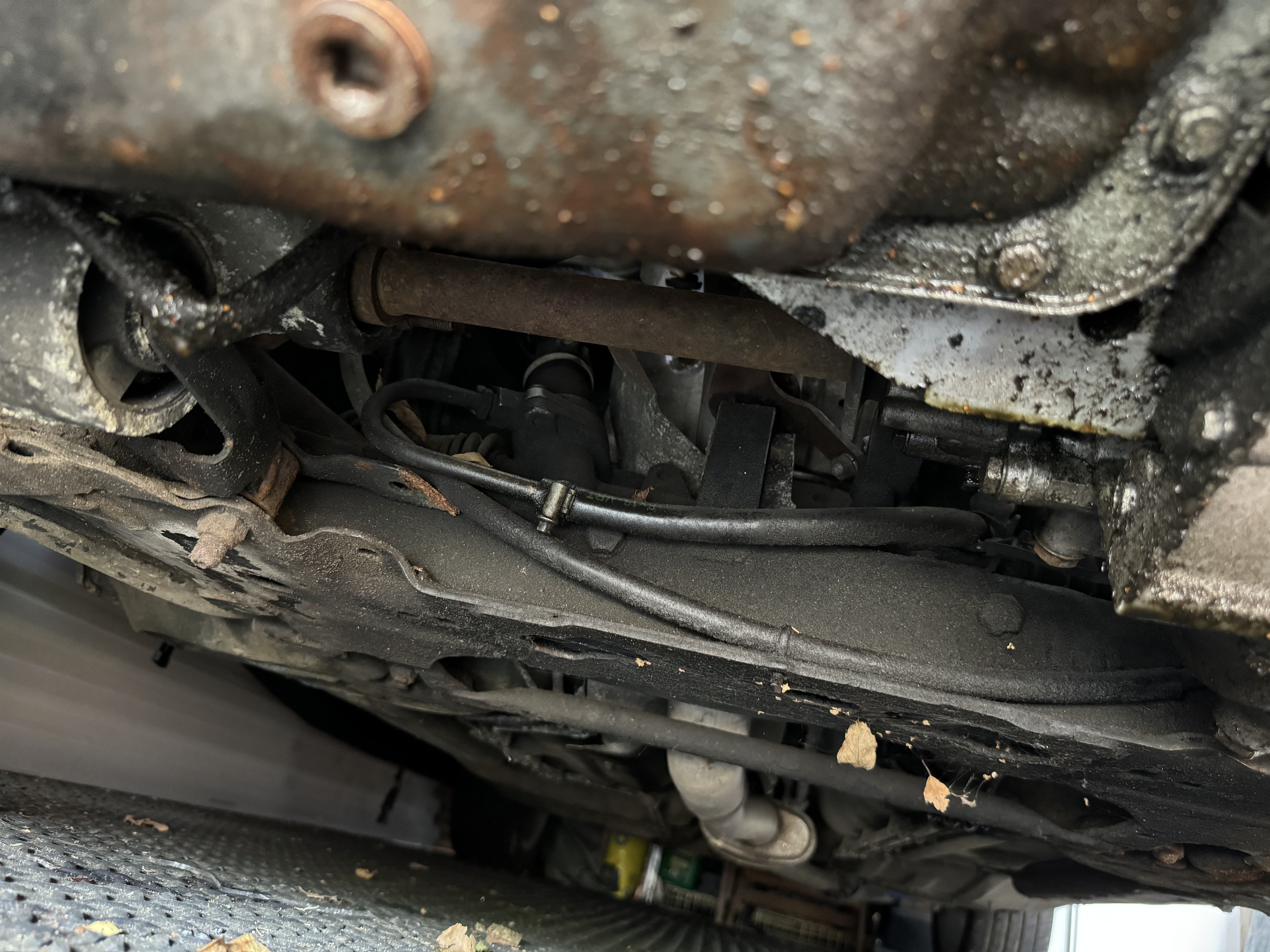

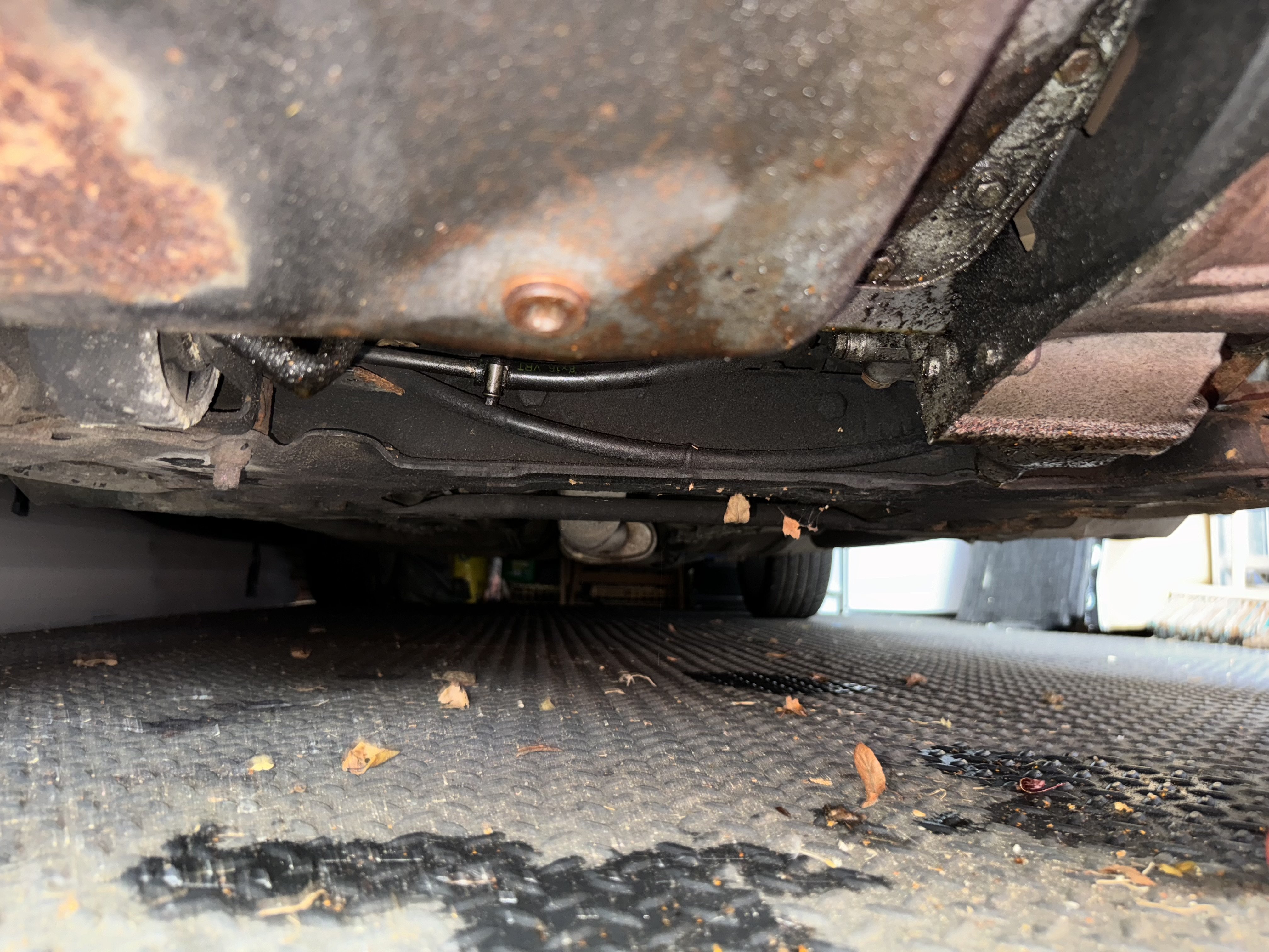

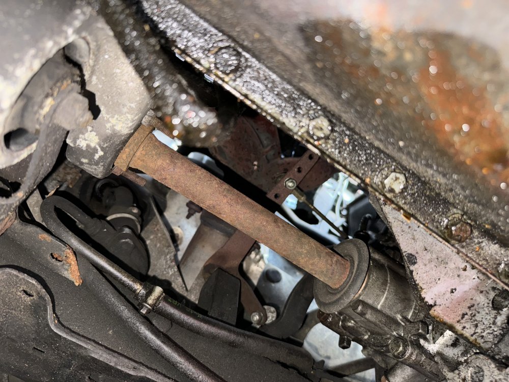

however there’s a few little puddles of oil I couldn’t see where it was coming from, looks to be from a location above the back of the sump. The cable hanging down just behind the sump is very wet, with noticeable drips on it. The oil level is still full so it’s not a big leak.  Any thoughts on where I might look once I can get under it in a few weeks…?

Possiblly sump gasket, check if any oil above the sump/block joint.

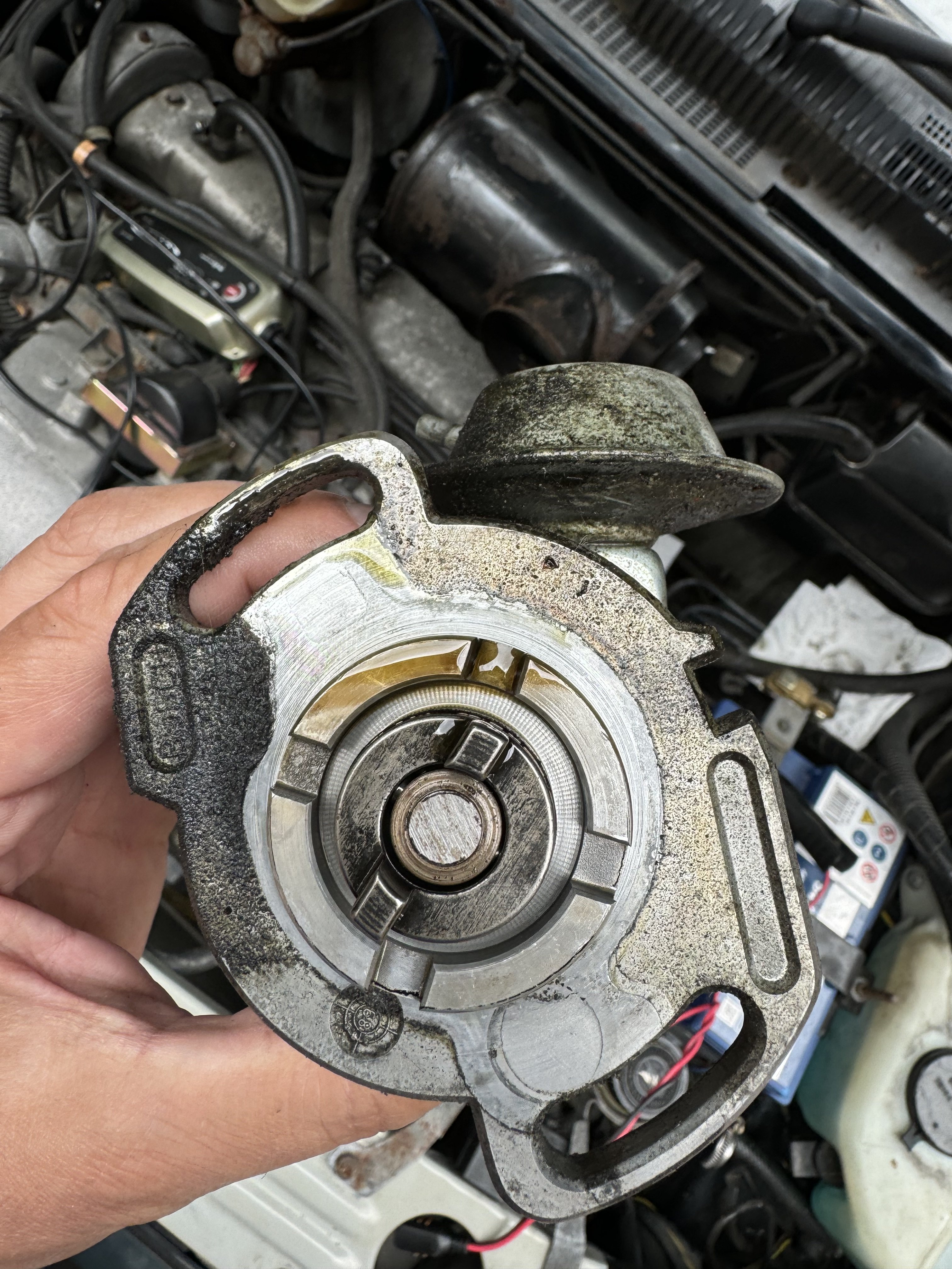

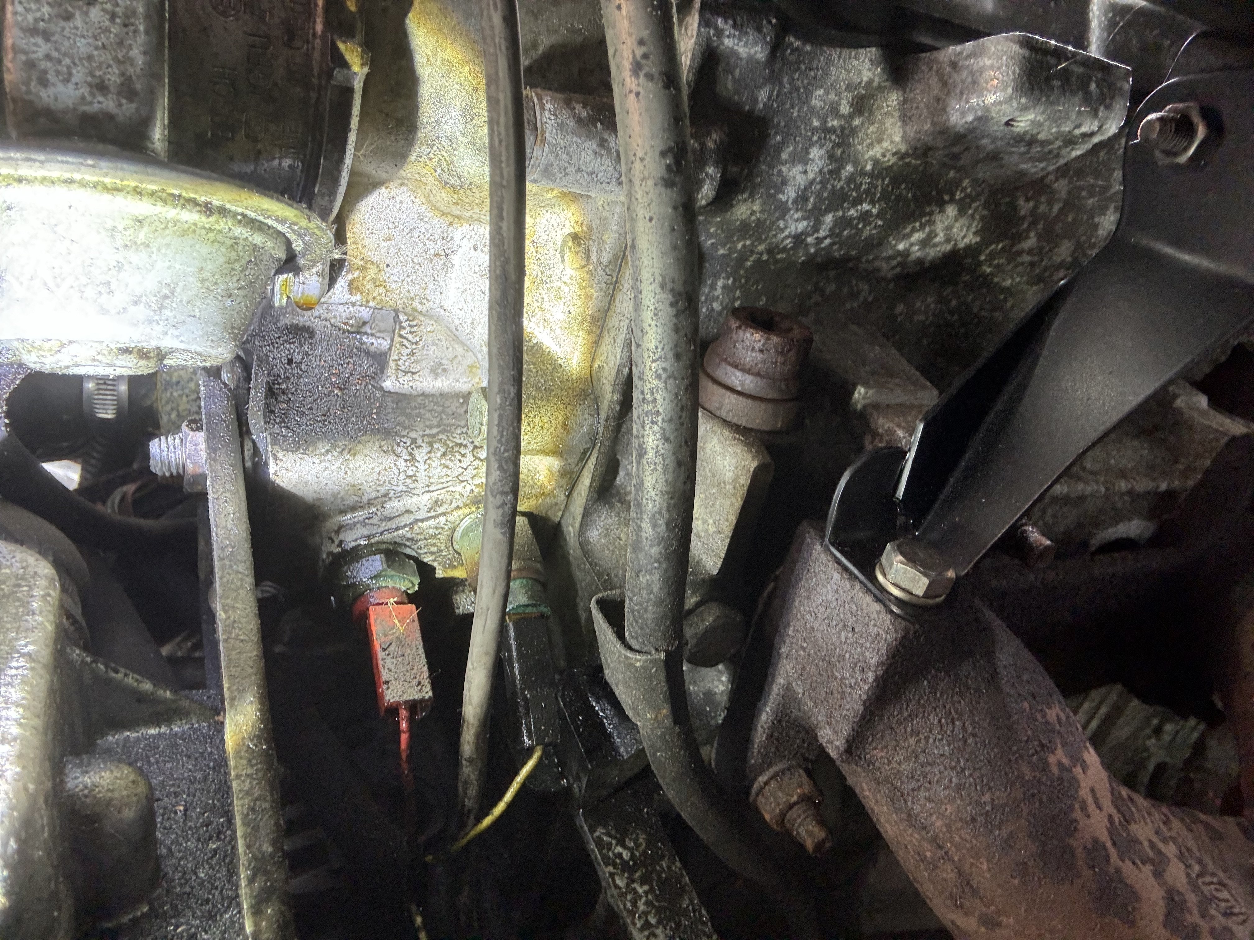

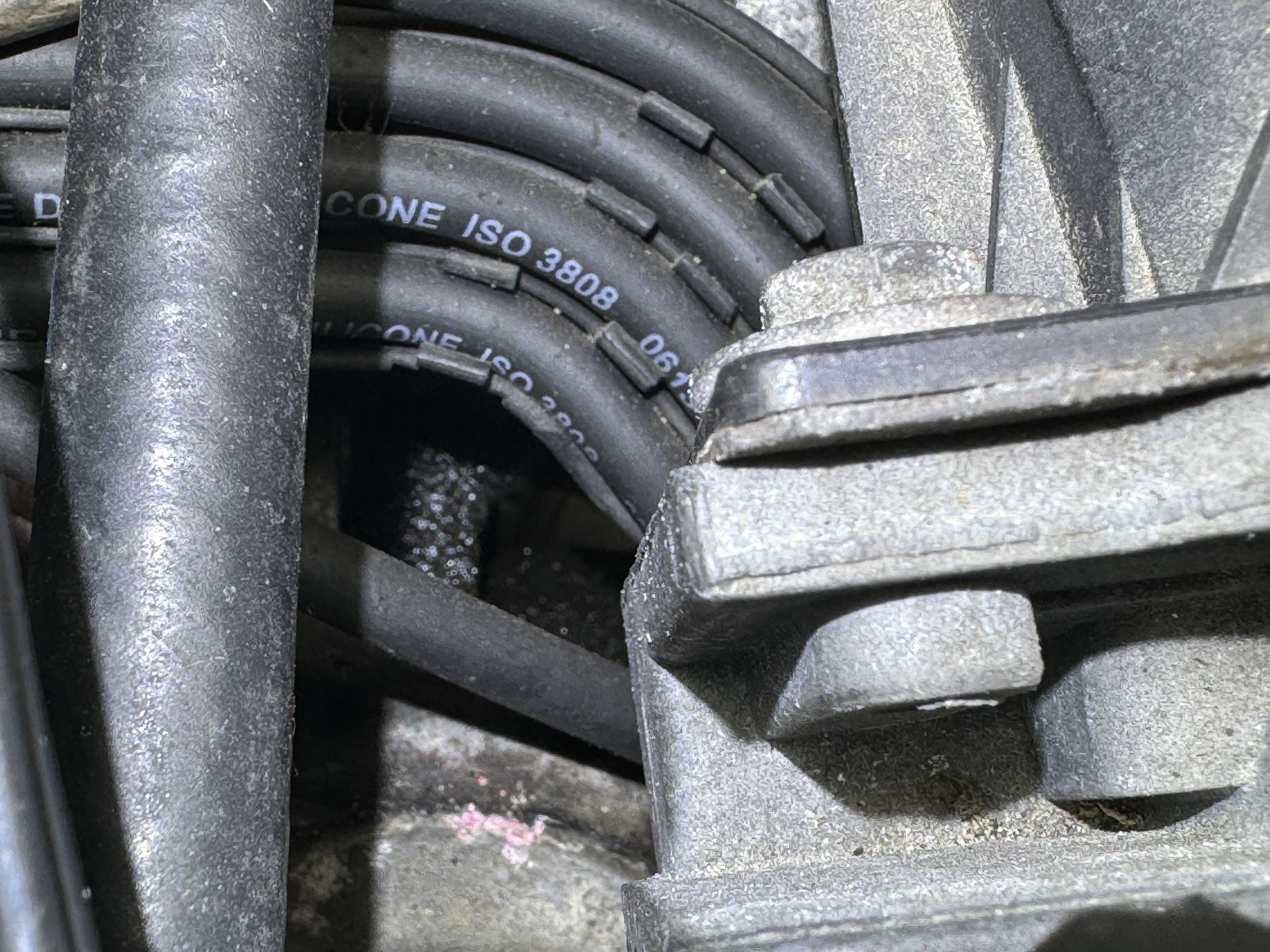

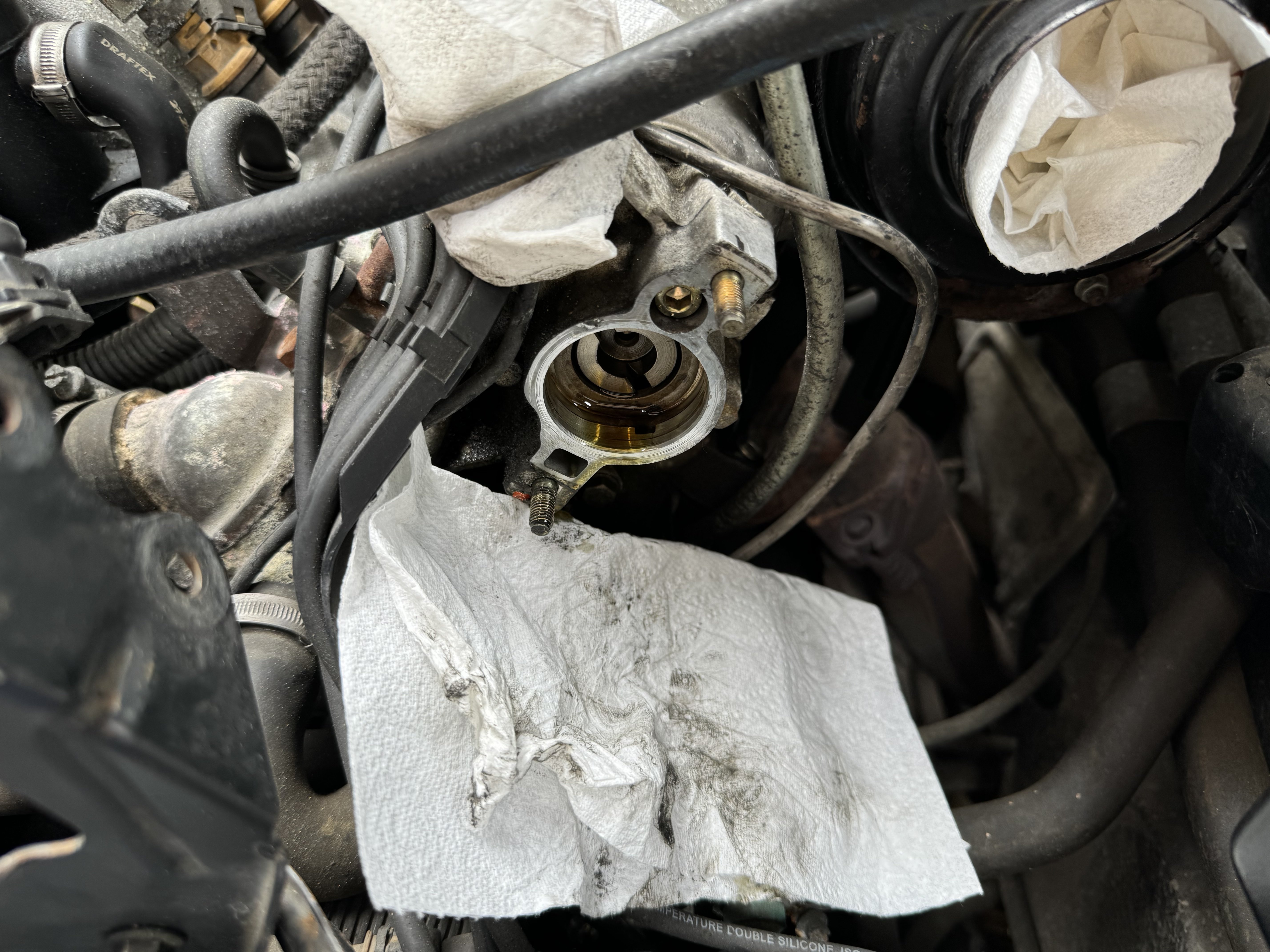

Had a look and I am leaning to the sump gasket needing doing, however the shiny stuff goes all the way up the back of the drivers/gearbox side of the engine and can be seen under the HT Lead organiser. A little investigation today showed what looks like oil droplets on the SAD, possibly coming from the dizzy mount?  Any thoughts?

There is a dissy o ring I see listed on ebay as the dissy goes in the end of the cam and comes through the water thermostat block pictured there .
ScoobyJawa
Nice one Leslie, I reckon that must be what it is, ordered one from Miles, fingers crossed!

 I had a leak from the distributer: the o ring is a good place to start but mine still leaked after the o ring was changed. I believe there is a 2nd seal inside which wears with play in the shaft: sorted with a refurb.
It's surprising how much oil gets chucked out of the distributer and because its high up it gets everywhere.
ScoobyJawa
Well the o ring was defo an issue, there was certainly oil coming out from there and dripping all the way down the engine.
Hopefully that’s the only culprit, but will be keeping an eye out with the other suggestions mentioned above in mind.
