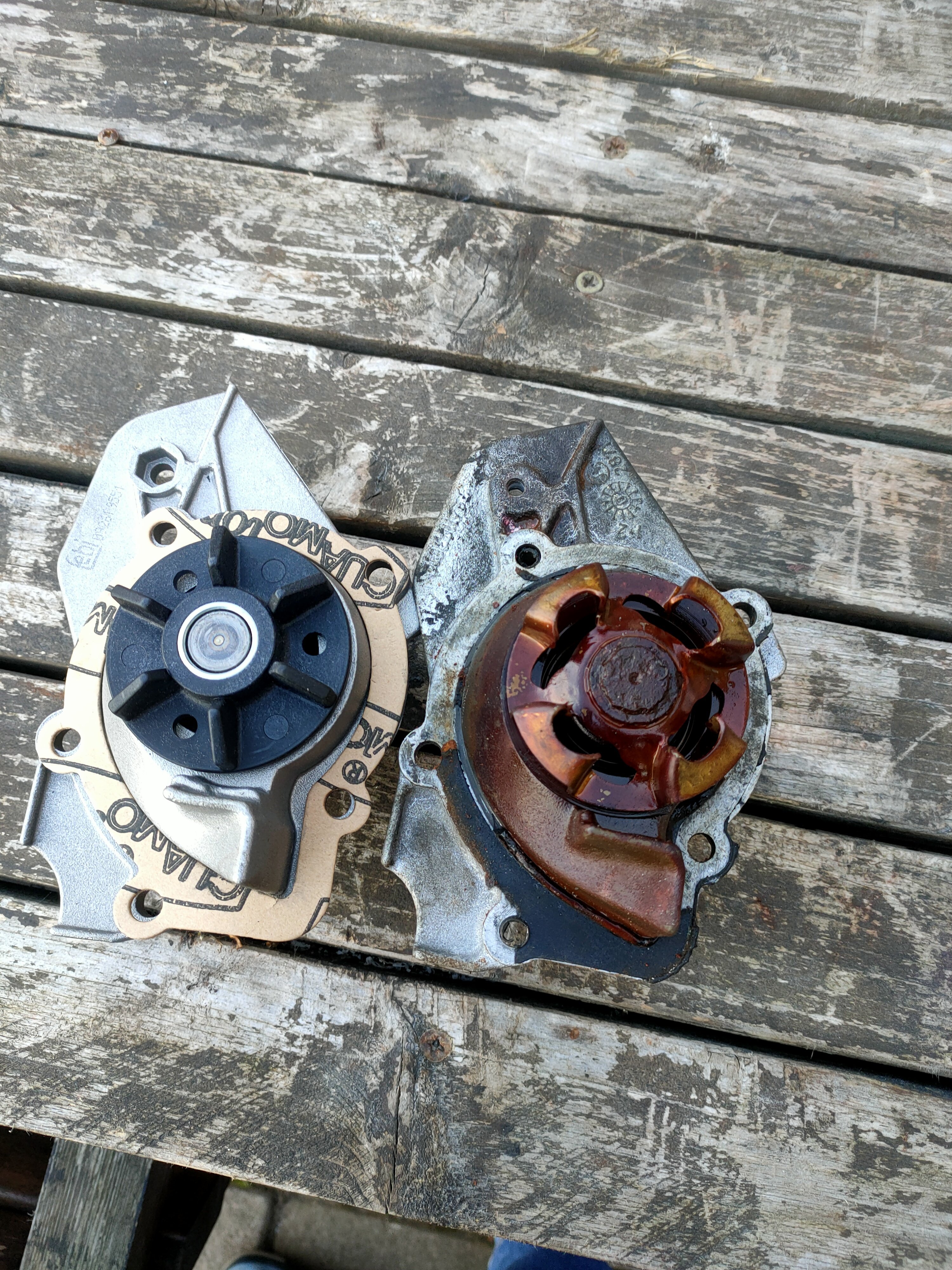

Richie-Van-GTi
Old pump, new pump.
I believe the metal impeller is the OE style pump, but are they better, worse or the same?
Certainly not slipping and no signs of it having any issues.
fitted loads of the type on the left without issue.

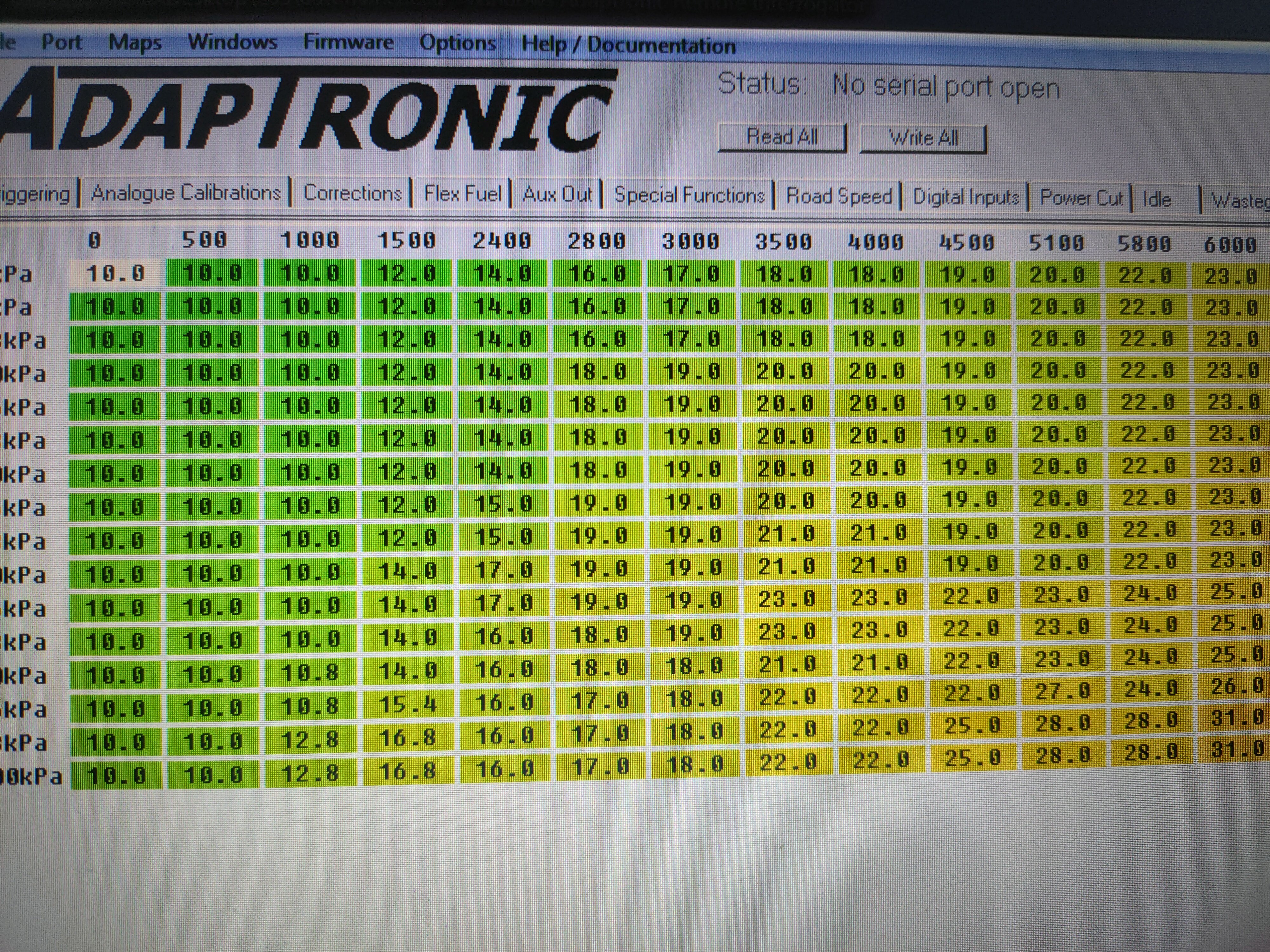

Sorry hope this photo shows clear enough as my mapping laptop doesnt do internet things.
Left column in kpa is 6,13,20,26,33,40,46,53,60,66,73,80,86,93,100
Edited by Richie-Van-GTi
Definitely not enough light load advance, although I'm not sure that would make it overheat. Cruising along at 80-110km/h, ie 2500-3300 RPM, it should have around 36-38º. ie replicating the 9º of advance the vacuum module pulls on. I'll find a table as an example.

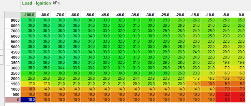

Did you ever find a table Peter?
Thanks
Sorry, I forgot for a while. The map says 205, but it's actually from my XU10J4 race car. An 8V will probably need 2-3 degrees more at full load. Obviously the axis differ between ECU's. In my case, 0kPa equals wide open throttle, ie atmospheric pressure. I'm sure you'll work it out.
