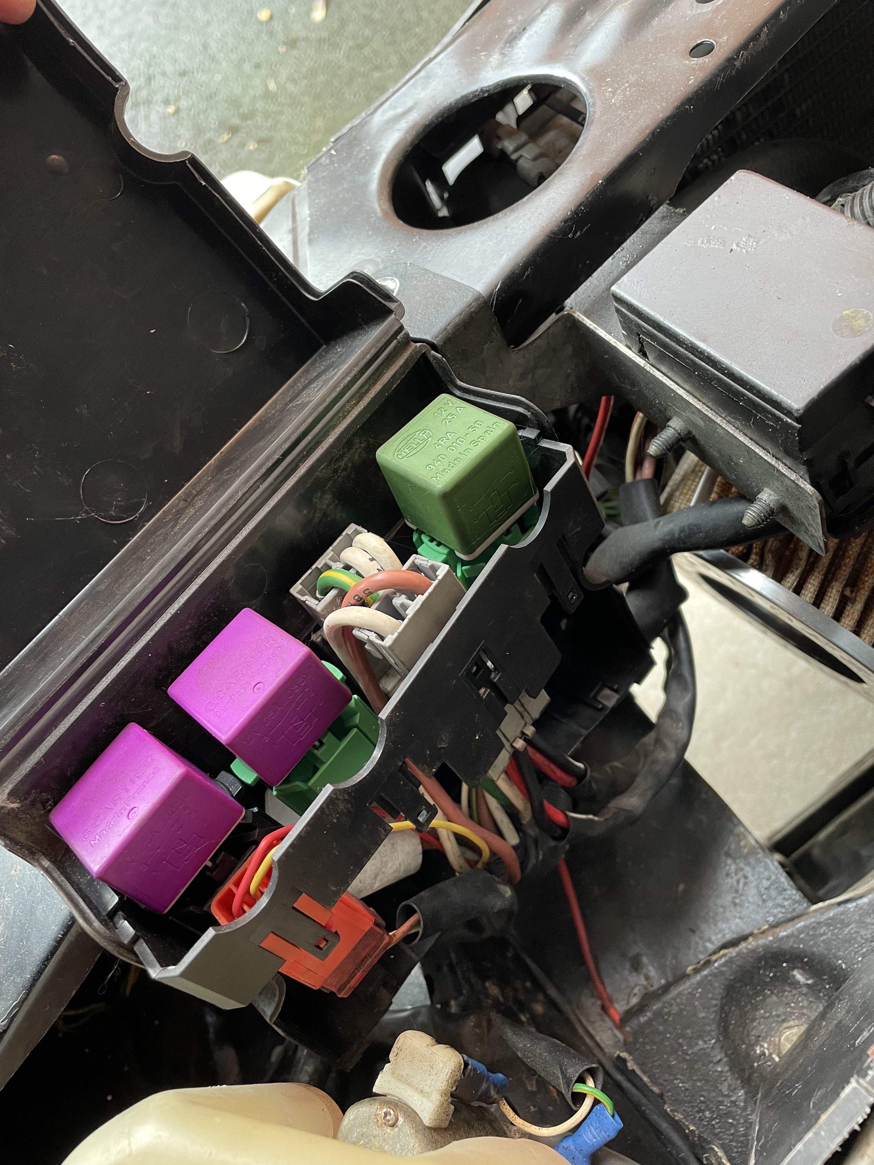

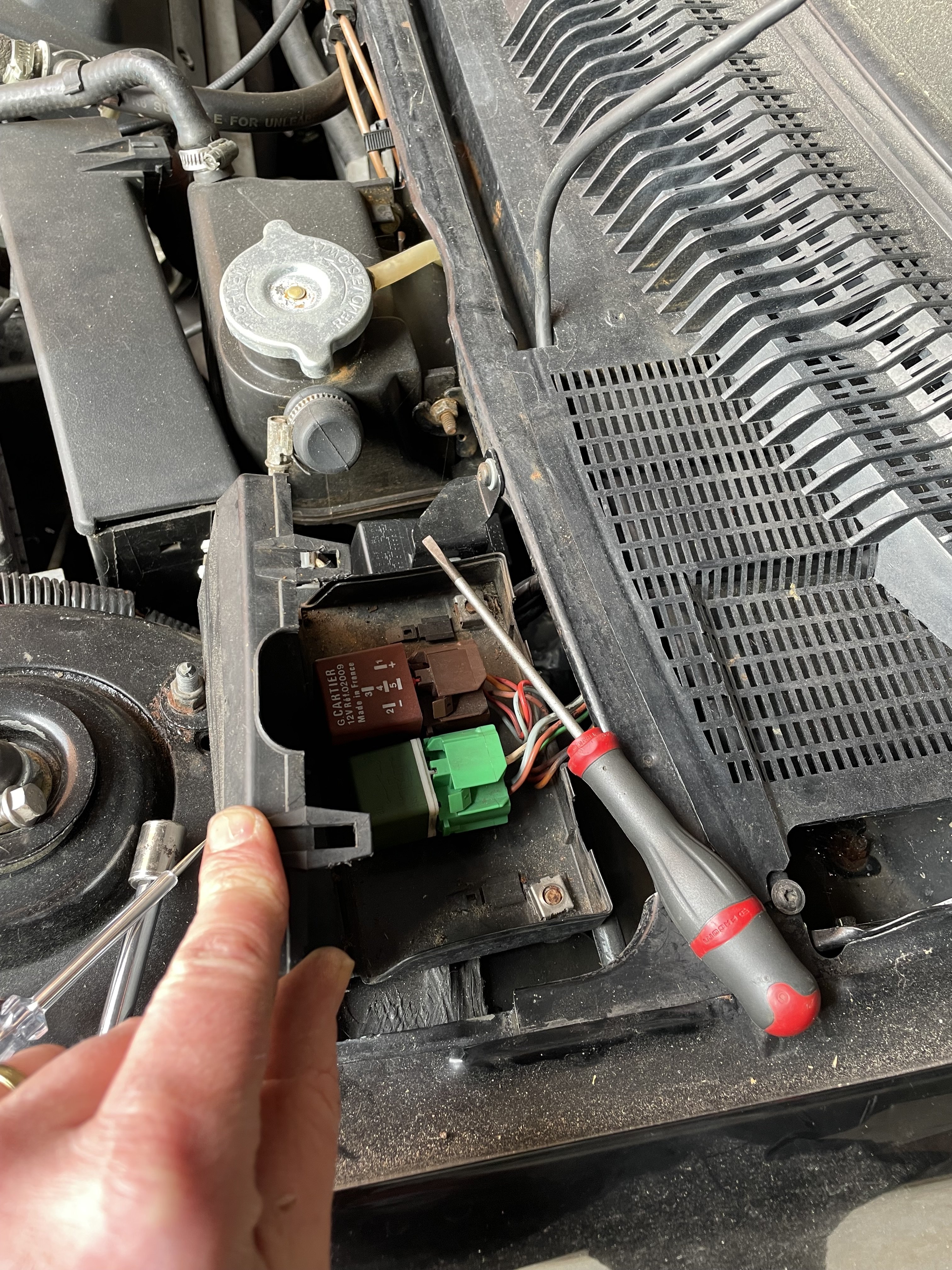

ORB 227 1 Cars Posted March 12, 2024 Morning people, my memory has faded a lot since I swapped my engine for a GTI6 and I’m struggling with starter feed. can anyone help with what these relay boxes are for? I can get it to crank if I send a signal to the starter from the battery but not from the key so I’m just chasing stuff down Share this post Link to post Share on other sites
welshpug 1,736 Posted March 12, 2024 None of those are engine related, the gti6 double relay is on the back of the ecu box. Share this post Link to post Share on other sites
ORB 227 1 Cars Posted March 12, 2024 Thanks mate. I’ll have a ratch. Share this post Link to post Share on other sites
welshpug 1,736 Posted March 12, 2024 Typically there isnt a relay for the starter unless someone has added one in, the gti6 looms dont tend to give issues on the starter circuit like the 205's did. Share this post Link to post Share on other sites
ORB 227 1 Cars Posted March 12, 2024 Yeah, thought as much. I’m getting 12v at the brown plugs when I turn the key, but nothing at the starter. I can start it by spiking live to the solenoid. I assume it’s crappy wiring somewhere in the loom? Share this post Link to post Share on other sites
