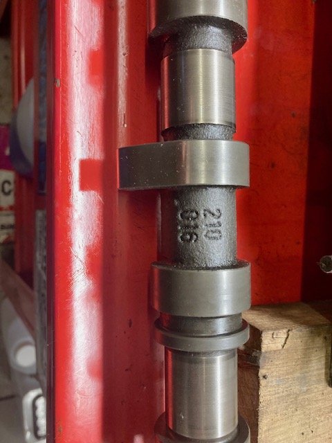

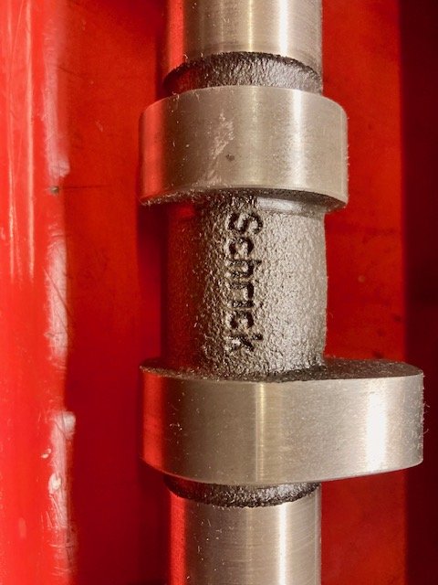

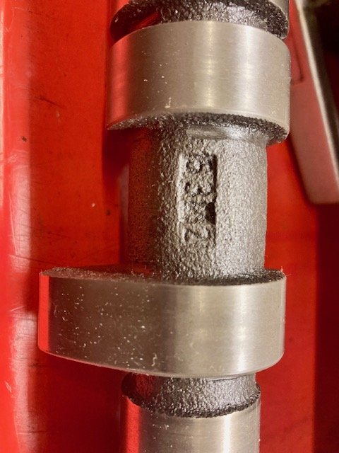

Afternoon all...
I've recently acquired a used Schrick camshaft for an XU 8 valve and wondered if anyone might know any more details and ultimately the correct setup for it in a 1.9 D6B ;)
Below are only identifications I can see on the actual camshaft, so if anyone has any further info and able to share please...that would be most appreciated
Thanks :P

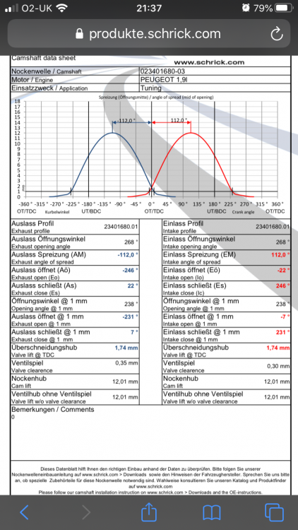

This is the cam I’ve got in mine but I’ve not got any photos of the part numbers on the cam.
Is there any other markings on the end of the cam?
