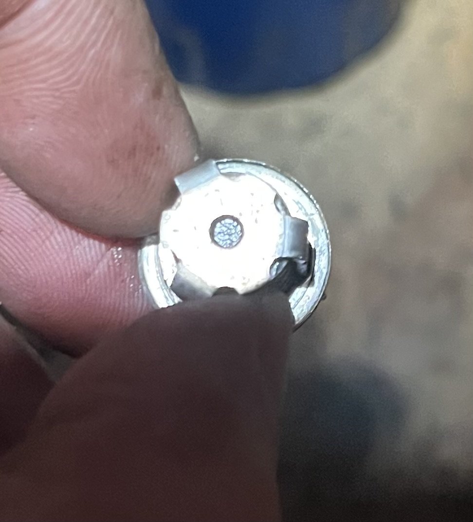

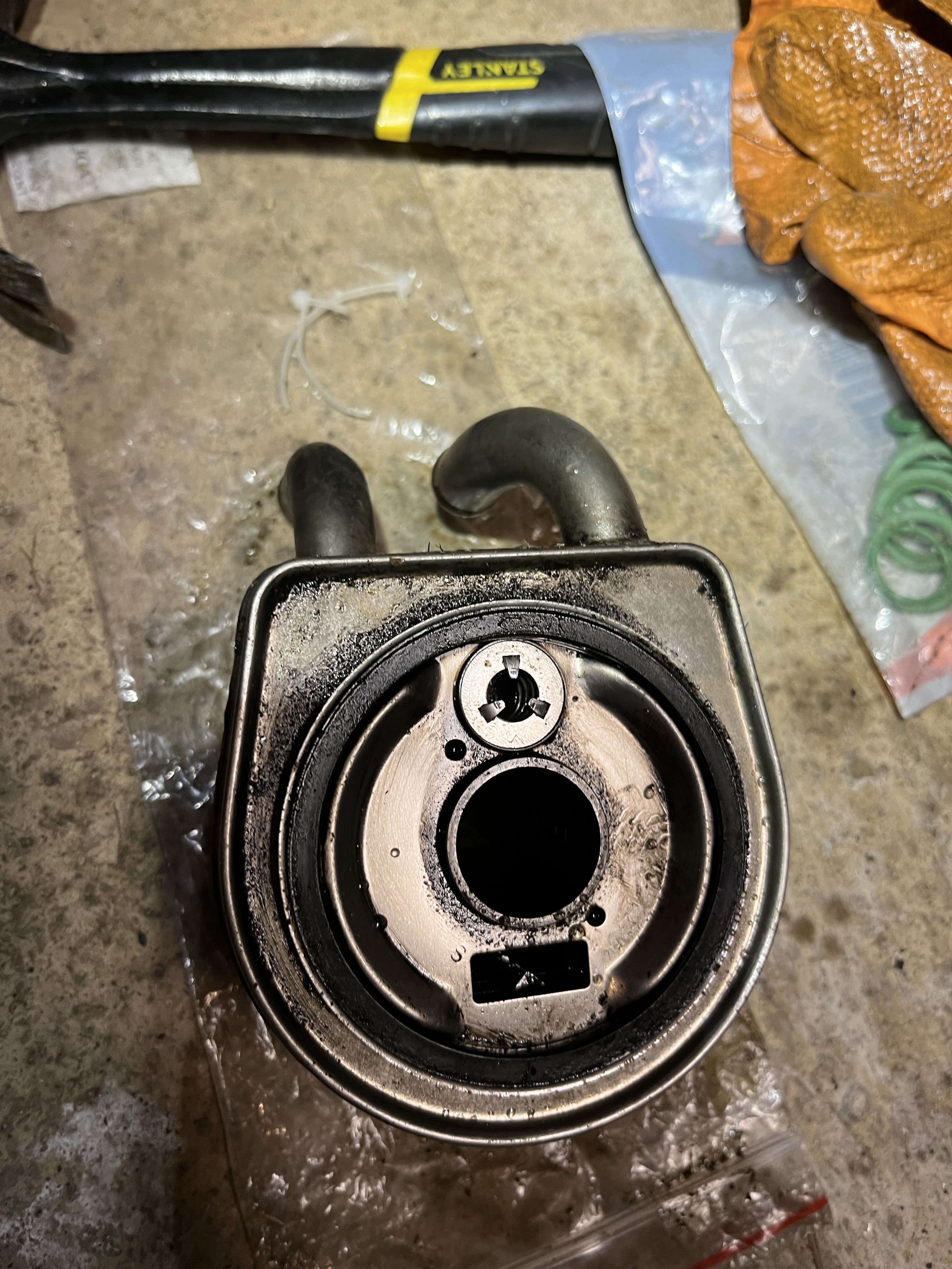

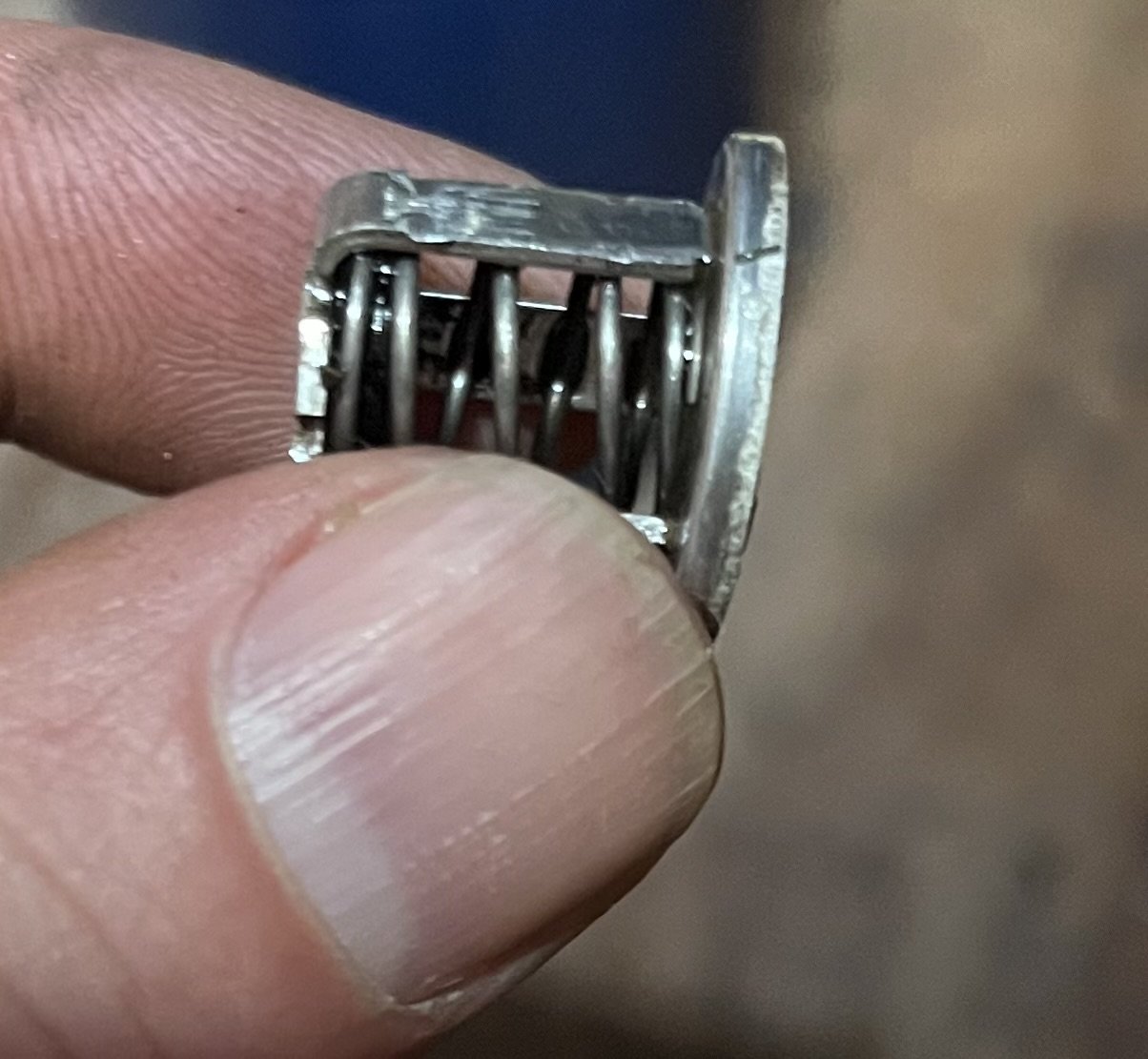

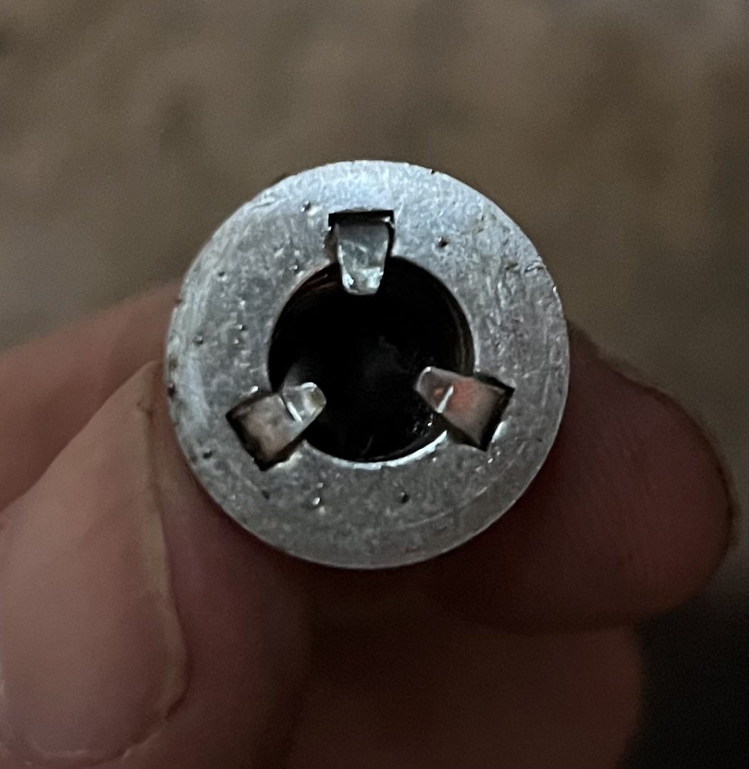

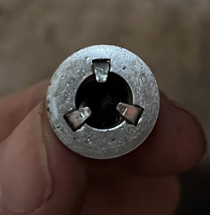

I need some help. I have found a non return valve in the bottom of the container I used to catch the oil when I removed the heat exchanger.
IMG_9372.thumb.jpeg.b949ef4c170912807b7353d78a8510e7.jpegIMG_9373.thumb.jpeg.a01e01f658b6b9b56804cd170f06d900.jpegIMG_9374.thumb.jpeg.43fc83efa957213ea7322d9e8c05f571.jpeg
it either fell out of the heat exchanger or the mounting casting, but I’m pretty sure it was out of the heat exchanger.
Should it sit in the feed or return line? (I assume return??)
Is the return the centre hole or the outside holes on the filter? (I think centre??)
if it fell out of the 205 heat exchanger, I will have to work out if it is needed in the replacement 206 one.
brian j
I have gone back out to look at it again and I can reduce all of those questions to just one. How important is that non-return (bypass?) valve?
it went here:
And there is no provision for it in either the 206 gti 180 heat exchanger or in the mounting block for it, so it can’t be refitted.

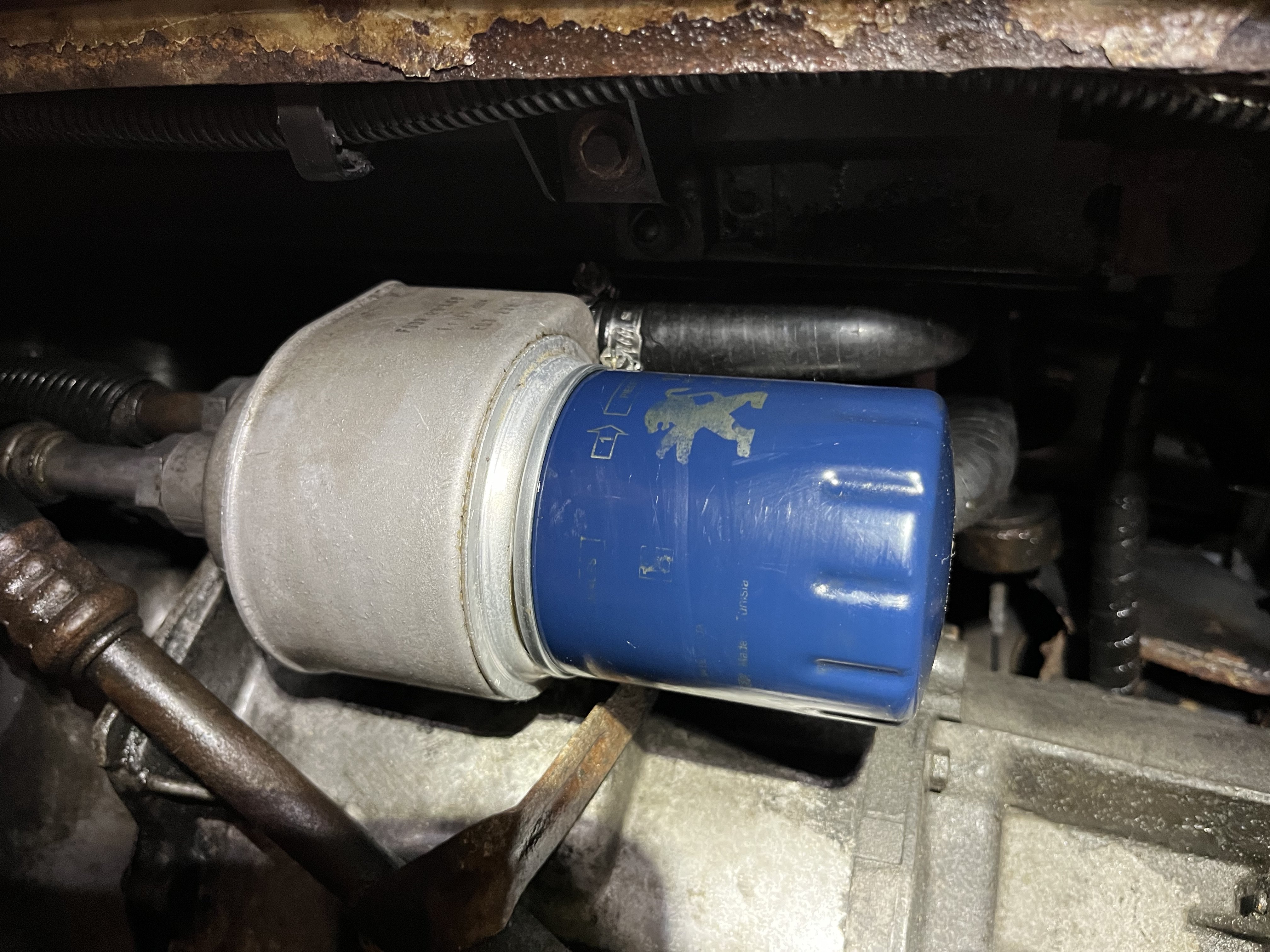

on the other hand, assuming I am ok without, I am really happy with this:
IMG_9375.thumb.jpeg.9bbd037274e5647996f53445f84bdb17.jpegIMG_9376.thumb.jpeg.f18cdbc9334ad3b4239850710aae78da.jpeg
it is 5mm deeper than the original but it fits perfectly and I don’t think anyone would ever spot it is not original.
