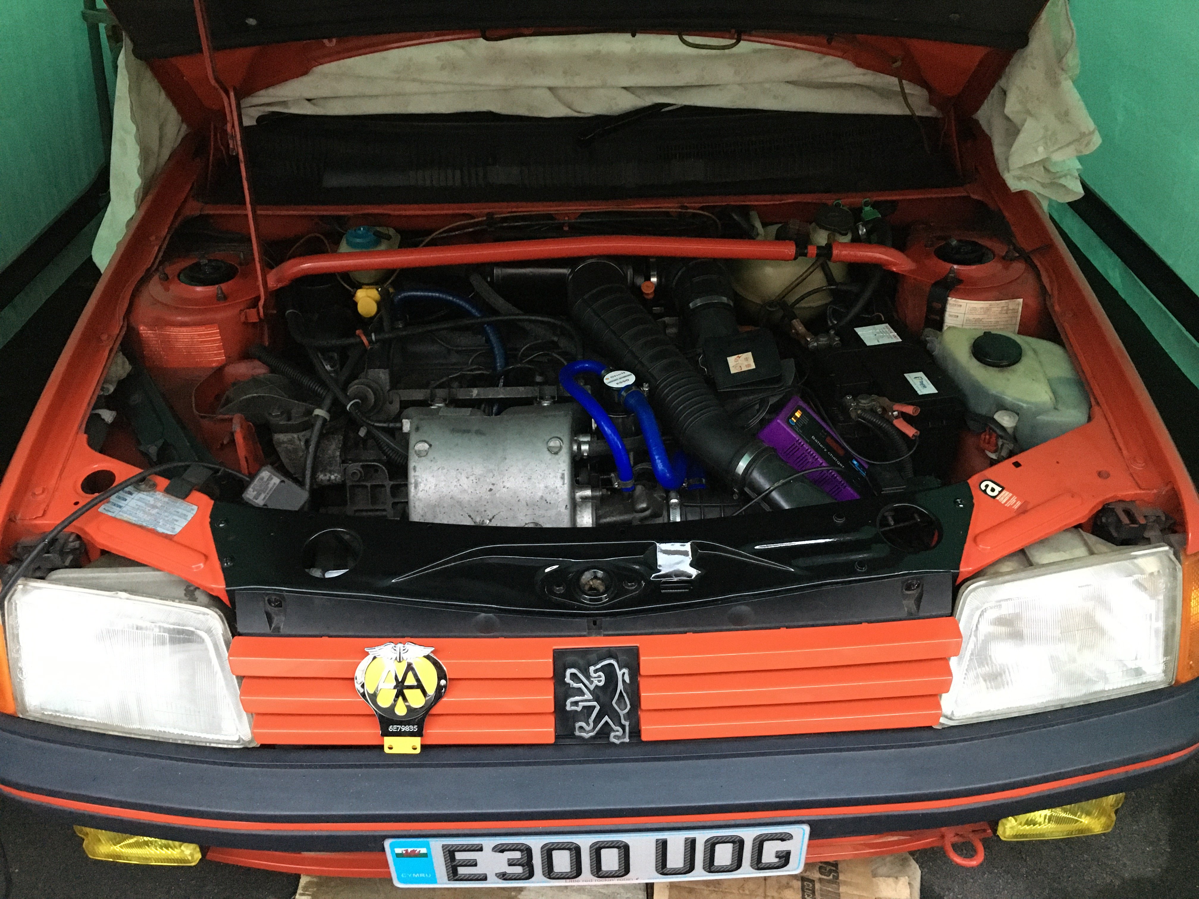

barneys66
Mine shuts fine withouth any mods - pic for lenth of visible thread:
