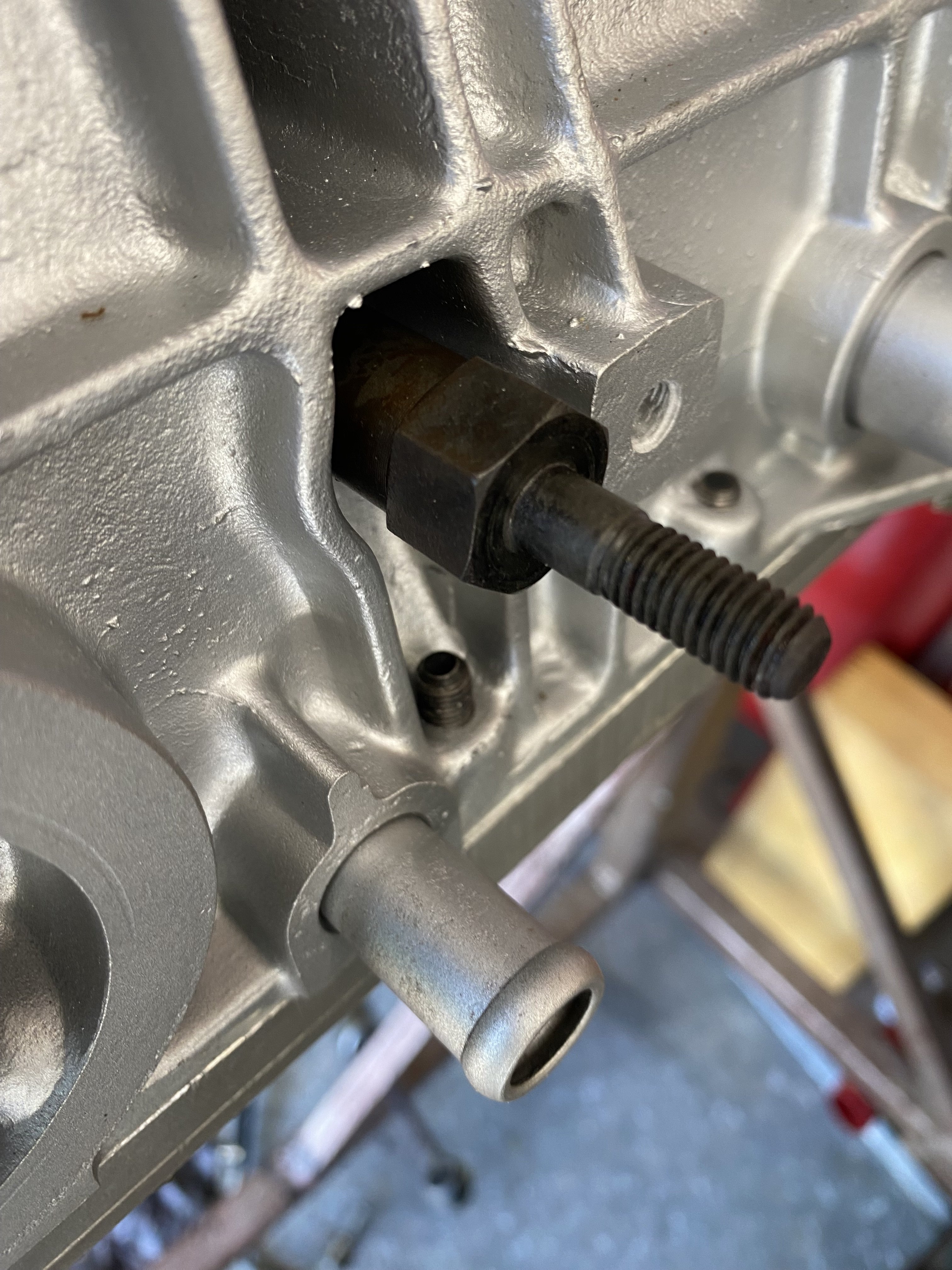

Do you by any chance have a good picture of the standoff the knocksensor is mounted on?
I have d6c block so it doesn't have it and I can't find any good pictures online to replicate it.

SRDT
D6C engines also have the standoff and knock sensor since model year 91 and the transition to ML1.3 Motronic.
I will see if I can find you a rough sketch blueprint.
This.
