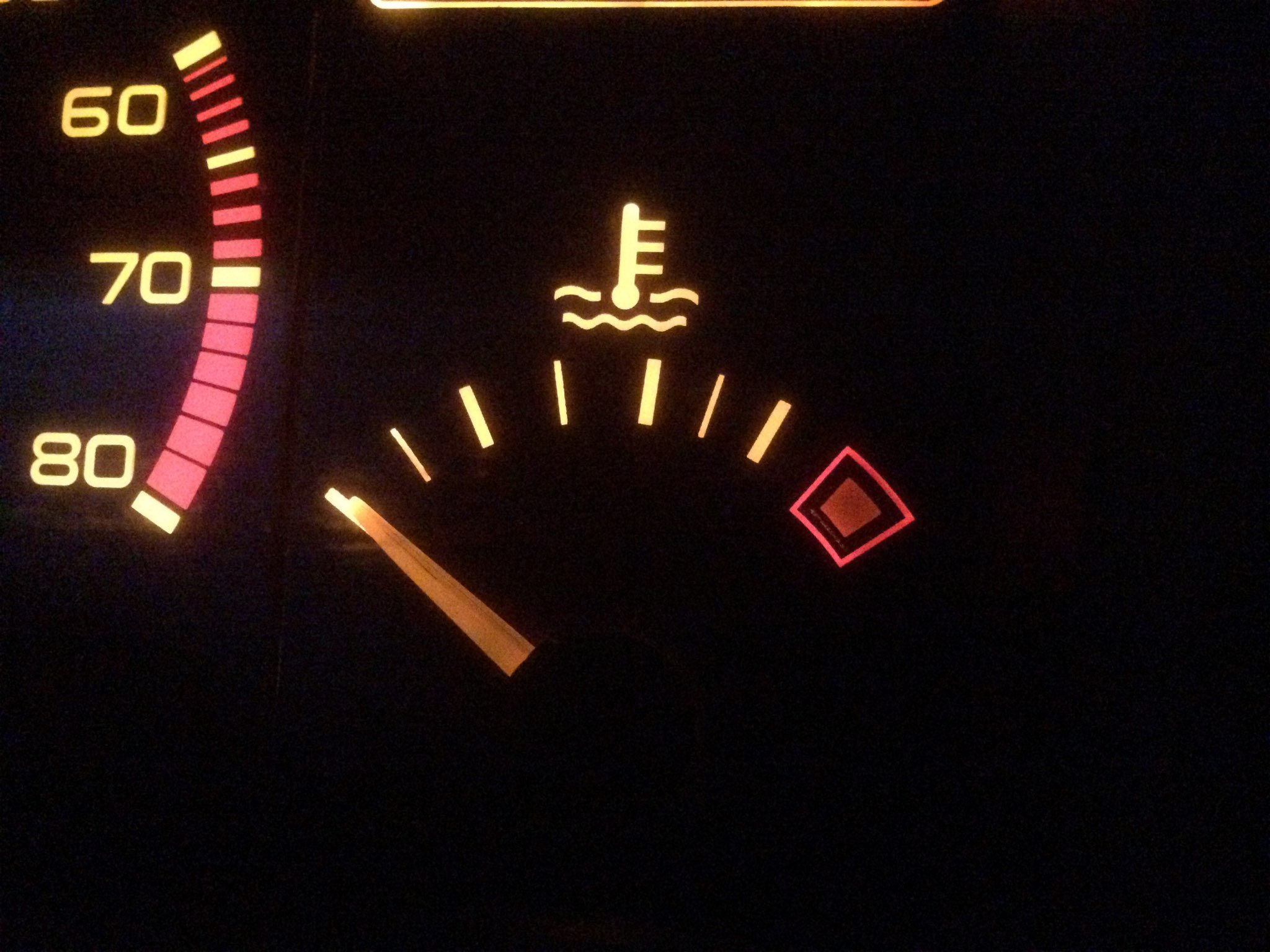

until a few weeks ago the needle would steadily increase until it was nudging the 4th mark from left
so just under it, then it would sit there very consistently
in the last few weeks it sits just over the 3rd mark or at halfway 3rd to 4th mark

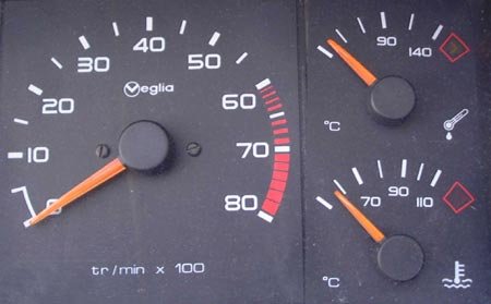

Coolant temp. gauge goes up in 10C increments , starting from 50C to the 110C :

if your guage degrees are accurate to my guage marks then today the operating temp sat mostly about 75deg
and it fluctuates from say 79 down to about 71, in town its lower than highway
the lower temp and the fluctuation are both different to normal

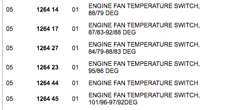

first pic's the petrol fan switch options:
second's the diesel fan switch options:
my guess is 126444 although it doesn't have any temp ratings mentioned
(the XUD7T usually came in a car with air conditioning which would suggest the correct part is 126445
but the Si body its now in has A/C removed and the Si only has a one speed fan anyway so #126444 should match up to the 83deg diesel thermostat and be what I need ?
Si definitely has the two speed fans, identical to Motronic DKZ GTi.
fan thermoswitch 1264 44 is 93/97 -88/92,  post 1990 style blue plug with purple ring,    1264 45 is the red ring post 90 sensor, standard on the single fan two speed gti.

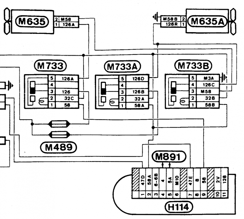

From my experience, all Aust delivered 205’s had AC. Thus all 205’s had two fans and three relays, to give either slow (fans in series) or fast (fans in parallel). Jetronic models had positive controlled relays, Motronic had negative controlled relays. If your car isn’t as described, it’s been butchered.
The fans have nothing to do with the temp sender or temp gauge. They’re totally independent systems. However, if the thermostat and radiator fan switch don’t match, the engine might never get to operating temp, because the fans are always running.
Attached is the wiring diagram for Mi16. The Si (and Motronic GTi with A/C) is basically identical, except that the relays are earthed via 58 and 58A via the radiator switch, rather than H114 (the Bitron controller).

basically my dash needle temp is about 10deg short of reality
thermostat's working well, engine operating temp is good
temp just isn't making it thru from sensor to the dash needle, not sure why ?
