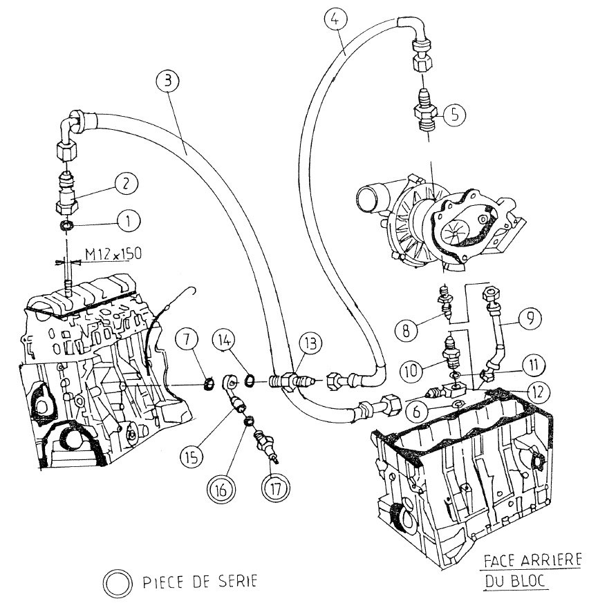

This is how Peugeot took oil for the turbo on the race engine, the PCV system isn't the same than the street engine.

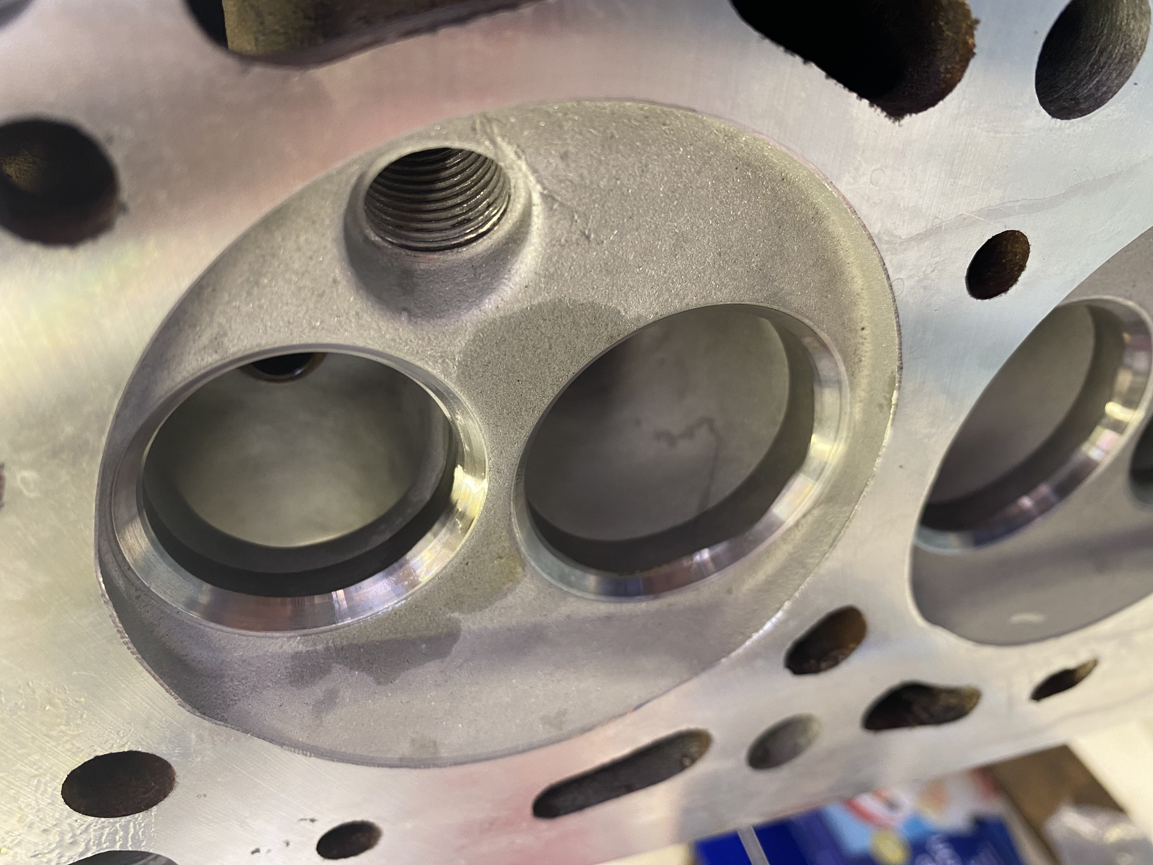

I personally wouldn't do the 3 angle valve seat. The turbo will make the valves run hotter, you want a nice wide seat to help take the heat away. On a NA engine all the flow you can get helps, on a turbo engine of course it helps, but its not as critical as you have the boost pushing charge in and to some degree out. Easier performance is increase boost pressure say 1 psi than the effort of 3 angle seats.
An interesting point of view when you can make the seat as wide as you want with a modern CNC single point seat cutter, which cleans up into the bowl as well. I'd much prefer to make the hp with volumetric efficiency rather than winding up the boost and making unnecessary heat. Effort? If your head place is cutting seats by hand, you're at the wrong place. CNC seat cutting is fast and efficient. My place stores my favourite profiles as a CAD file and just calls up what I want.
As with anything context is important, in context of you building a race engine wanting every last hp with assumedly a good budget to do so then of course you'd do all of the above. In the context of me strapping a turbo on an otherwise standard internally XU5 engine, no I didn't have the seats modified as for a car to mess about with on the road I didn't forsee the bang for the buck that would be required.
Maybe best summed up as the difference between the best it can be, versus good enough for the job.
This is great, thanks dude. Saved!

So I may be messaging petert about a bit of light head work! The shop over used before is very good, but properly old fashioned.
I fitted my first 205 race car with a DFZ (1.9L, small valves). You could definitely tell the difference between tractor seats and 3 angle seats, with no other mods. I wouldn't hesitate to run the small valve head. I'd also make sure it has at least 90lbs on the seat, if boosting. This can usually be accomplished by adding a 2nd shim under the valve spring.
