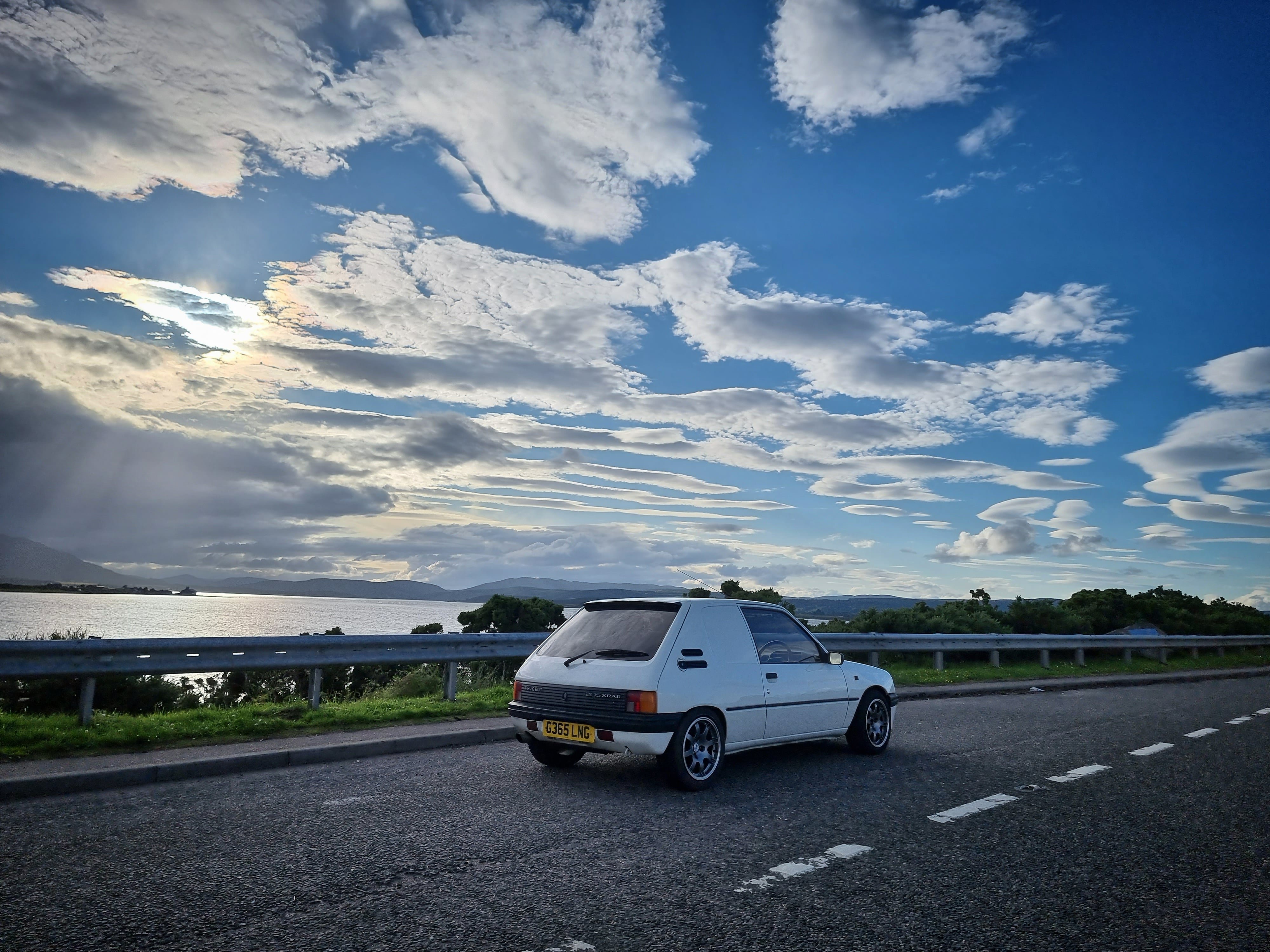

Here's the xrad in all of its glory
shes had some winter prep mods after this photo was taken - raised rear axle, swapped coilovers & gti6 front calipers swapped for some bilstein b4s and lighter 205 gti front calipers, sl434s swapped for some rallye steelies
All that's left to do is sort out the reek
