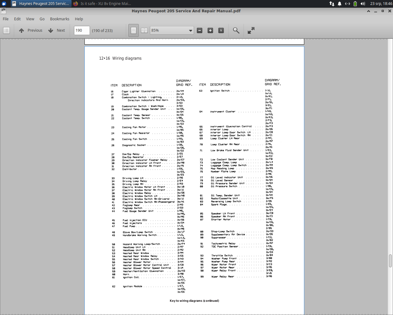

Is the conversion just a case of extending the wiring loom and connecting it to the correct terminals?
Thanks for your advice.

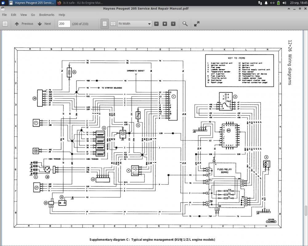

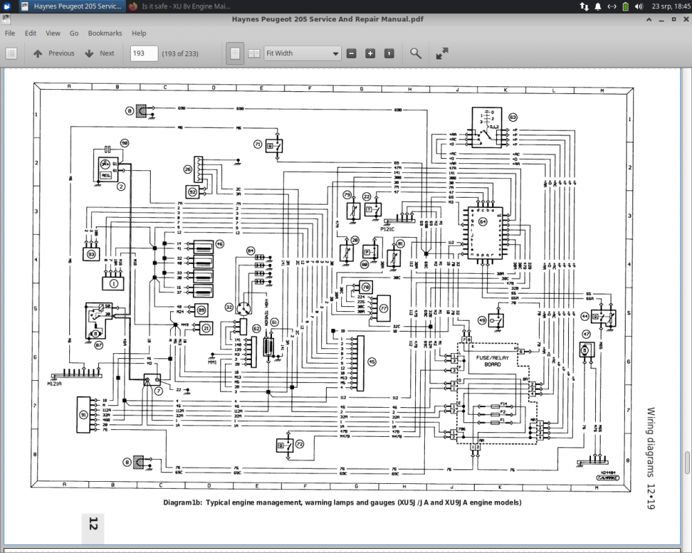

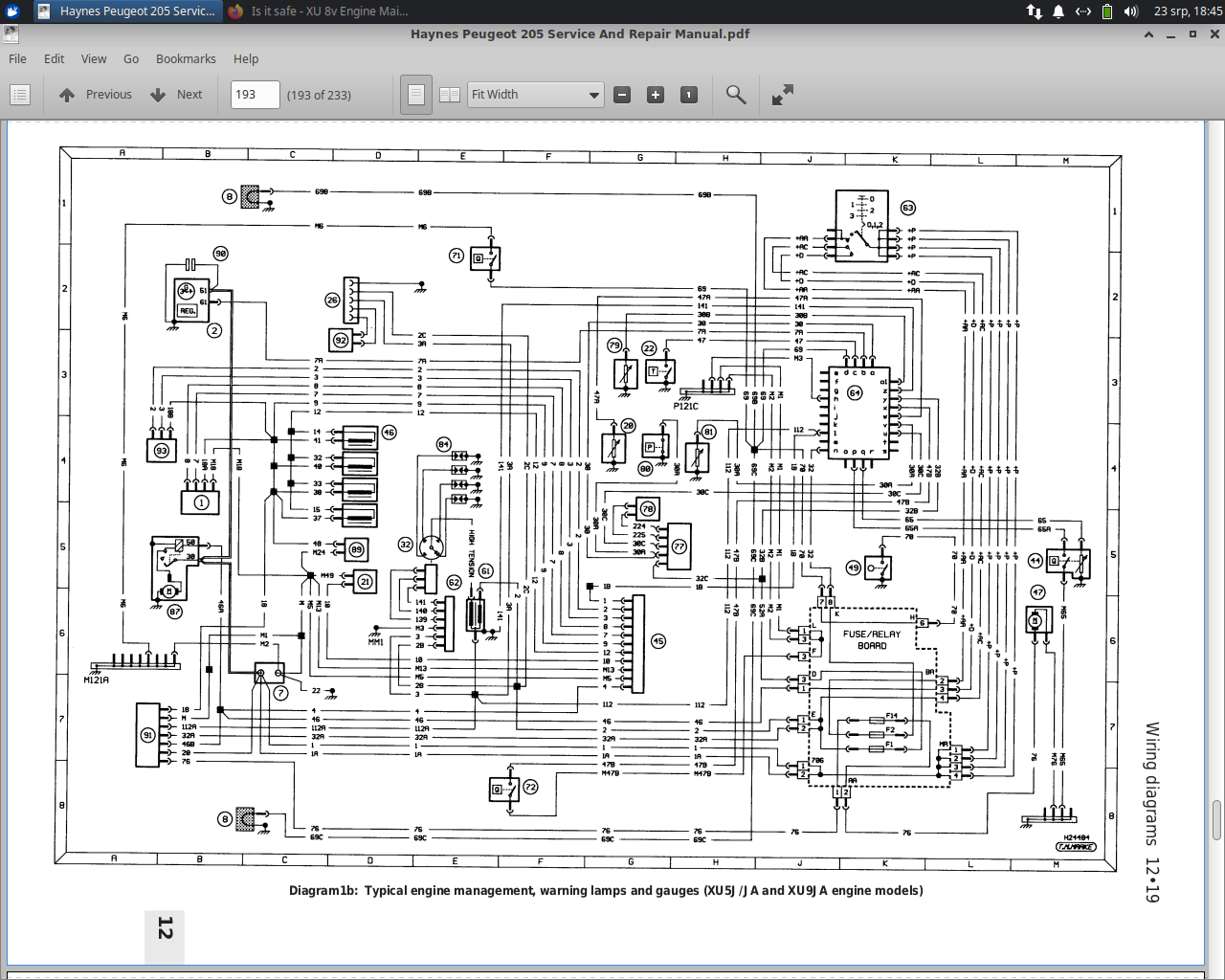

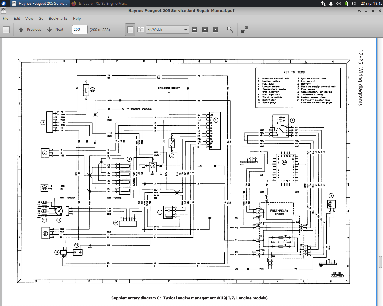

Yes , +12v switched positive , earth and signal for the tacho ing. module and tachimetric relay .
Follow wiring diagram and it'll be fine .
If you're unsure "how to" with regards to electrics , call mobile mechanic/electrician it'll be 15min. job for him .
