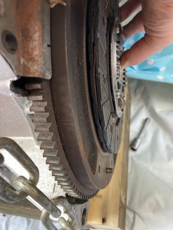

Hi. Need help again. I’ve just tried fitting a new driven plate to my engine and think that the springs are rubbing on the flywheel bolts. It’s a Valeo 193443. It only seems to go one way, as the higher side obviously goes in the pressure plate side. There seems to be evidence of rubbing on the bolts previously, but I bet it isn’t normal. Does anyone know which driven plate is the right one?  Looking on line, the one I have is meant to fit a be1 and be3 box. My box is a be3.

It's either wrong clutch disc/plate , or "worn" flywheel ie. it's been heat damaged previously and machined down to the limit , in which case you'll need replacement flywheel (or take the grinder and shave the bolts heads a little bit , but measure first how much is needed as too much it'll weaken the bolts heads ..)

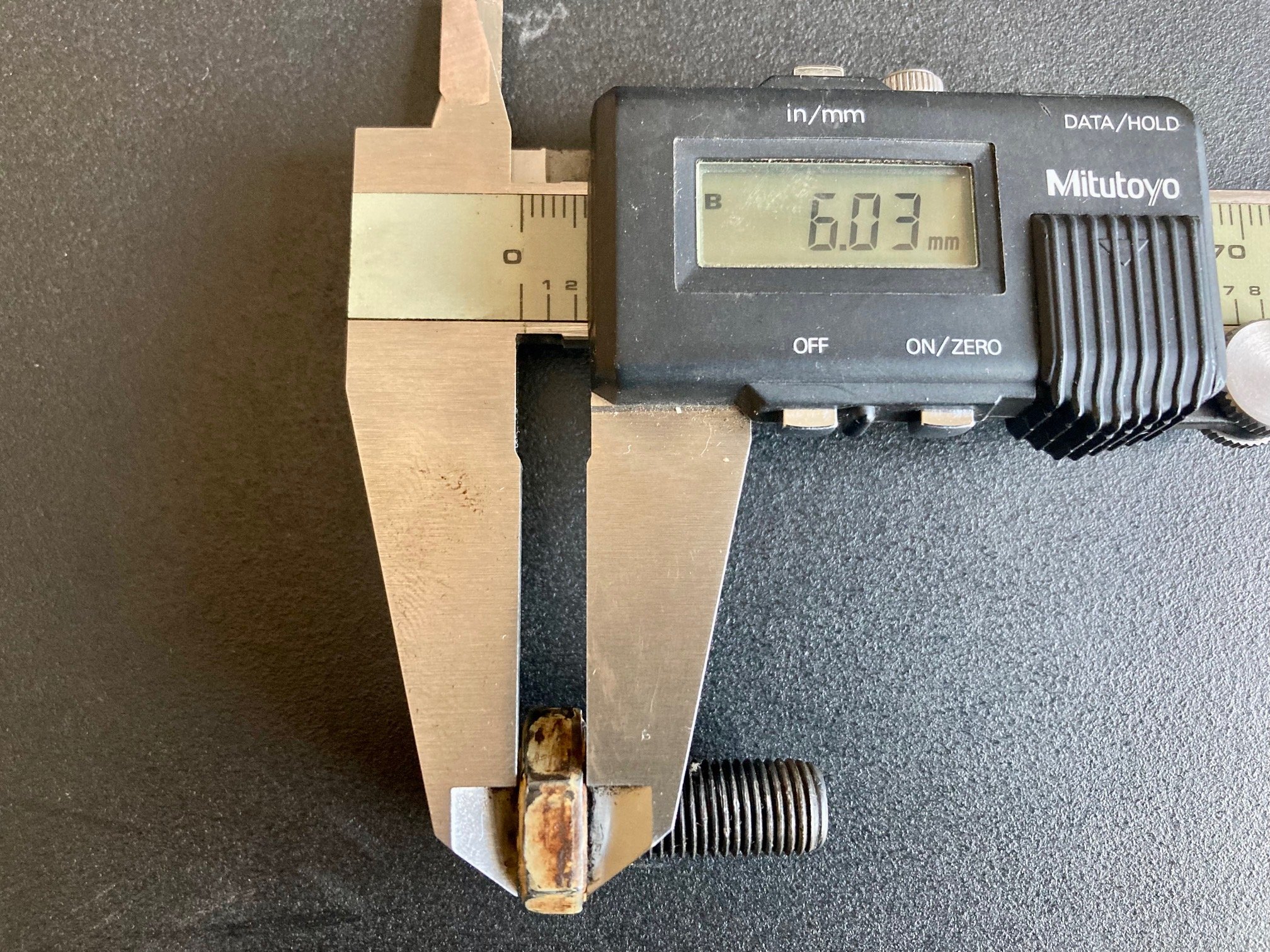

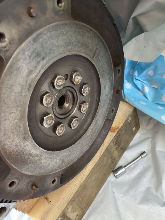

Just read your post fully. Speaking with the guy on eBay (spoox) he is adamant that the clutch plate I have is the right one for the car. Worried now that the flywheel is worn. Do you know, or does anyone know what depth the flywheel bolts should be from the friction plate surface?  I measured it at 0.135”. I guess I could take the bolts out and turn the heads down to provide clearance, but also worried about the reduced strength.

Those bolt heads look rather taller than I recall of original equipment bolts.
Gohn
not sure what 0.135 of an inch is in mm, why convert a metric bolt measurement to decimal inches ??
anyway peugeot flywheel bolt sets are available
the peug part number is 053713
should be a few places in the uk that have them if you go that route
Tideee
Standard Original flywheel bolts from my 1.9....
If i recall , think TU's have shallower bolt heads , these look OE to me for XU ..
No idea about flywheel machining limit specs , will try to look in my pile of books ...
But tbh. , if it's just an millimeter or thereabouts clearance needed , i'd just shave the bolt heads that much .. they're 10.9 grade bolts and there's 8 of them .
Or could be wrong part/clutch disc fitted in the package ... might try and order another one from LUK or Sachs , unpack so you don't tear the labels and compare if it's the same .. if it is return it back and you'll get you're money back , or try at you're local car part shop if they have any in stock to compare the two .

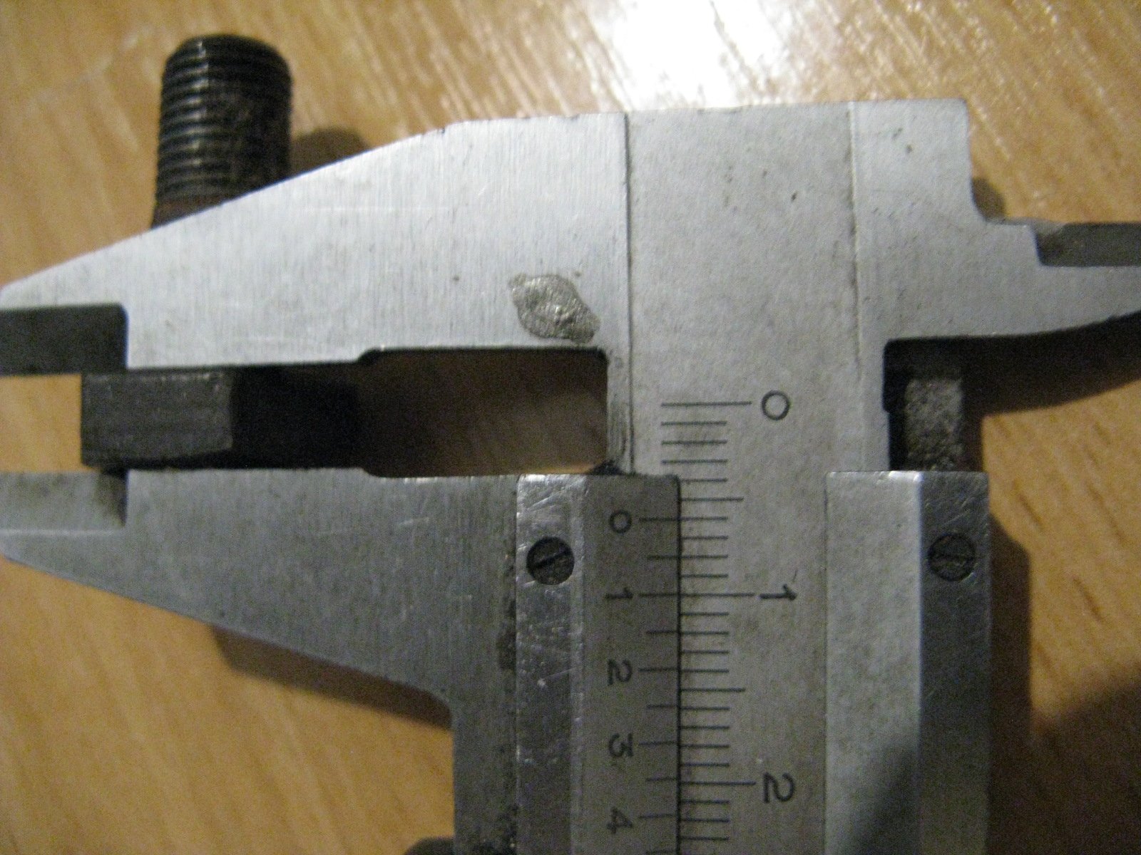

Took one bolt from an S16 block/flywheel , same measurements as posted above :
