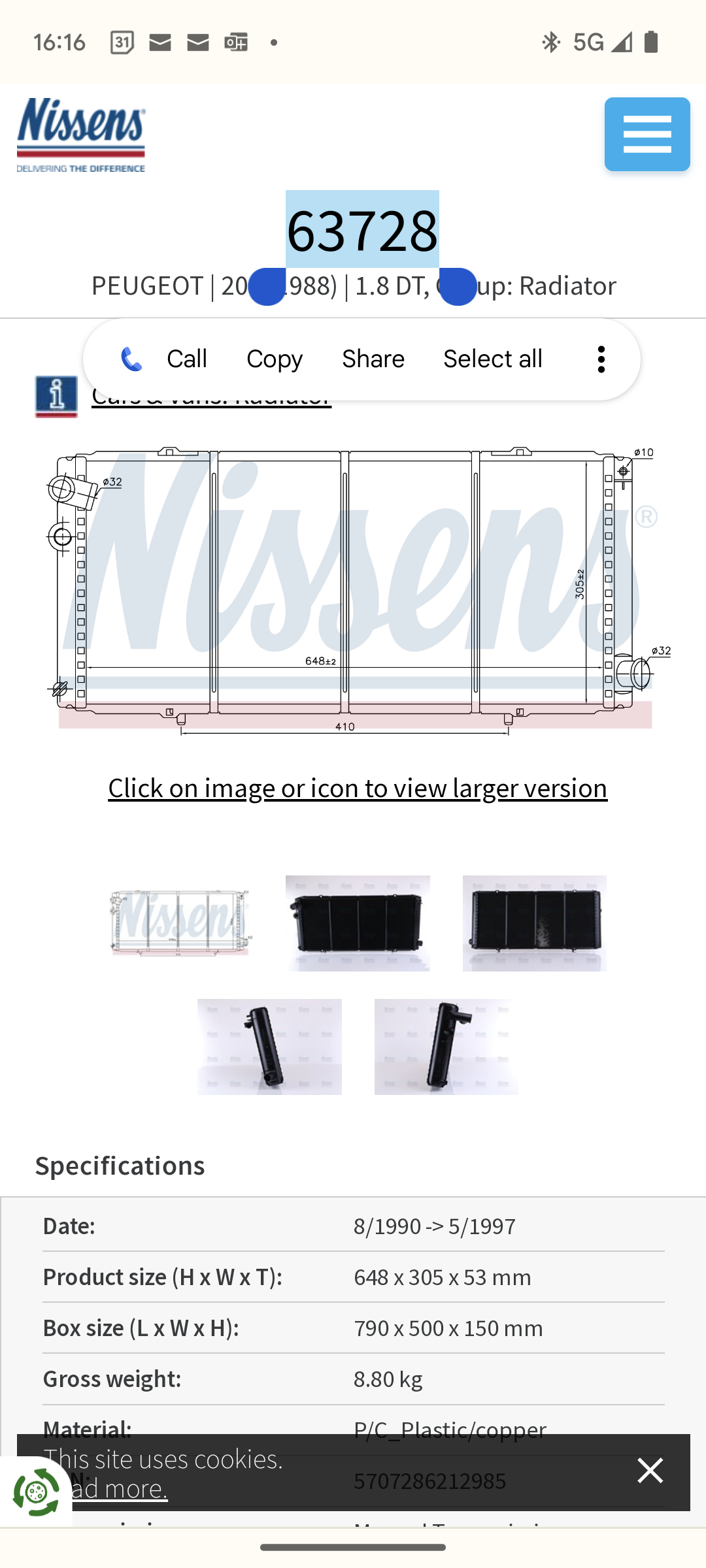

boldy205
boldy205
This is the one I can find, however my current GTi rad is 610X288 (core size, no end tanks inc in that measurement) so this Diesel one I'd too wide.
That looks right, it will fit, but not in the standard cowling, you would have to make some brackets
Thanks for confirming it's the one, Tom.
I've found a supplier, they want £240. Seems hilarious that it's always the expensive one I need!!
To be honest I'm pleasantly surprised that its still available. They were scarce some years ago.

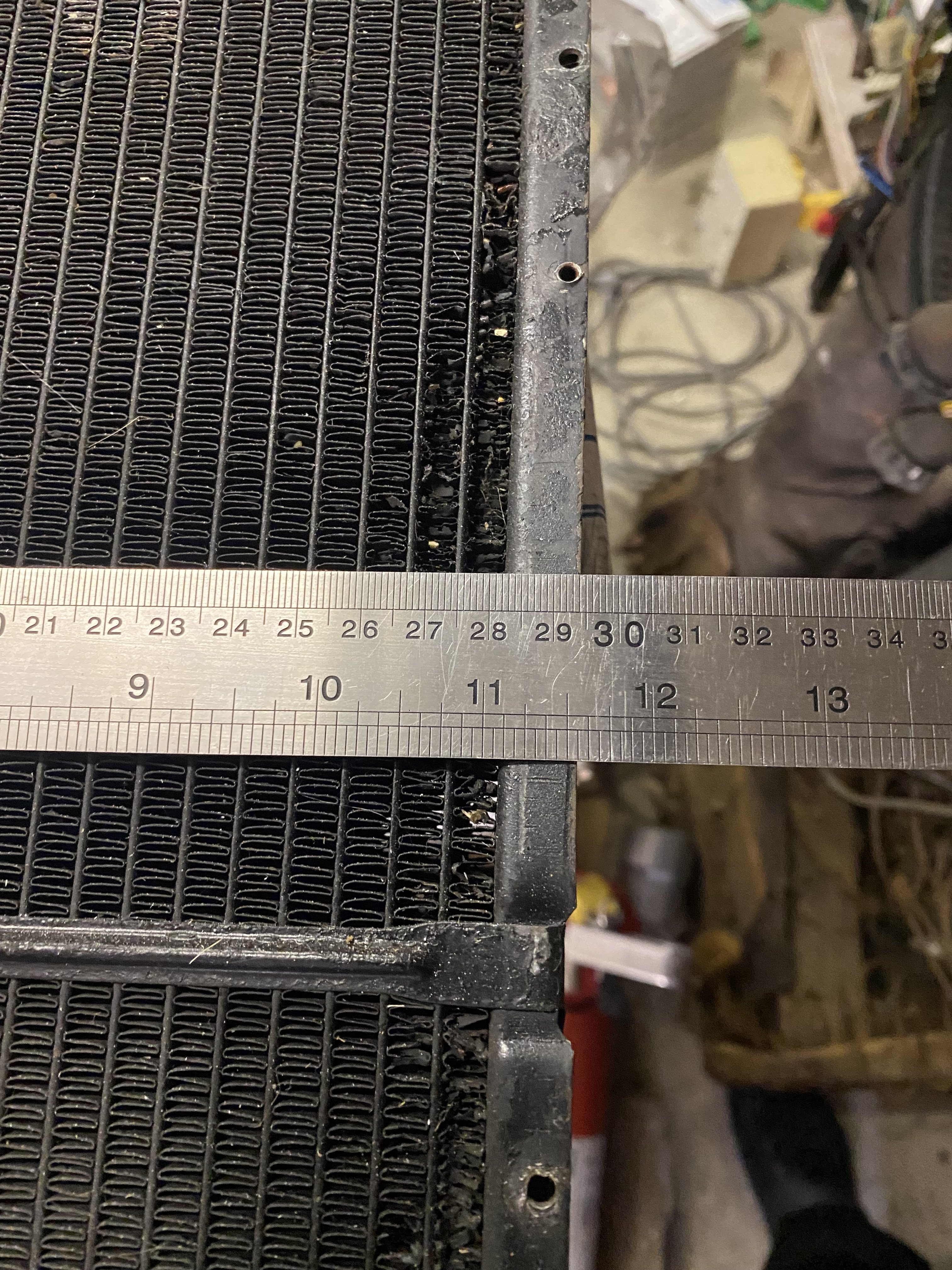

AC radiator is 295 high and 42 thick.
