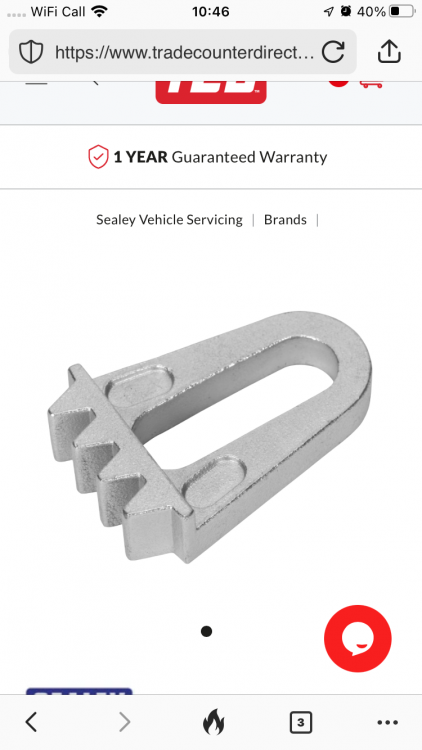

Hi guys, i’m changing timing belt on my ‘88 1.9  and need the tool to lock up the flywheel does anyone one have one or the part number   please?  i’d normally wang a screwdriver in but hav’nt got a helper atm, ps does it look like this?

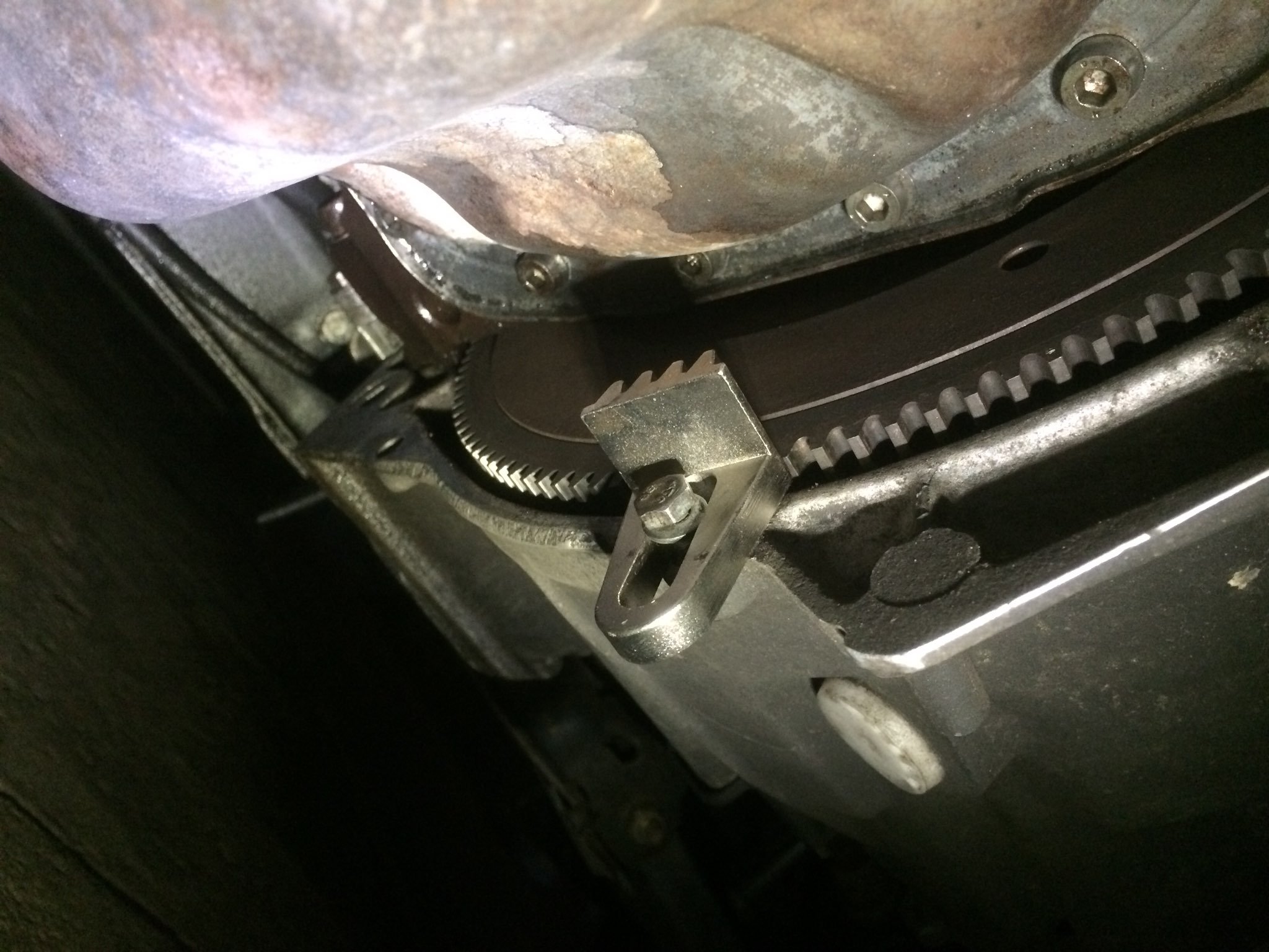

@Tom Fenton the type pictured bolts to the gearbox underneath when you remove the small metal plate / clutch dirt shield using an M6 bolt, although I have used the on the gearbox bolt holes with the engine out of the car.
This is the type I bought / use when I want to lock the flywheel, I've posted a part number long ago but it's eluding me in a search.
There's one Here on ebay

worth a pic of one in use
got one a while back, without any idea how to use it for a while
same as graham's link, think I got it from them too
(the diesel flywheel has a M7 locking hole accessed in under the starter, you can see it in the photo, so the little locker pictured is a backup)

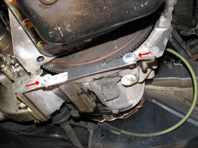

You can make DIY flywheel locking tool ...
Need an piece of iron bar/strip , sheet steel of say 2mm thickness or more .. put an piece of plain white paper on the bottom where the flywheel tin cover bolts on so one piece of paper covers bottom "half moon" of the flywheel ring gear and another piece covers lower gearbox housing end - then just run an dirty/oily glove across the paper an you'll get the imprint of the flywheel bit and gearbox housing on the paper .. cut that paper template with scissors , and transfer it on the iron and mark teeth and holes .
Then cut the flywheel teeth pattern on the iron with the grinder , and drill 2 holes for it to bolt onto the gearbox housing .. so it'll look essentially kinda like an saw blade with which you'll lock the flywheel .
Bit tricky to explain , will post a picture of that DIY locking tool if i can find it ...

I made my own from 3mm mild steel plate, which uses the two holes for the ignition timing plate. ie M7 bolt and the dowel. Sorry, I’m not at home to post a pic.
I use the same tool on iron blocks, but with an M6 bolt.
