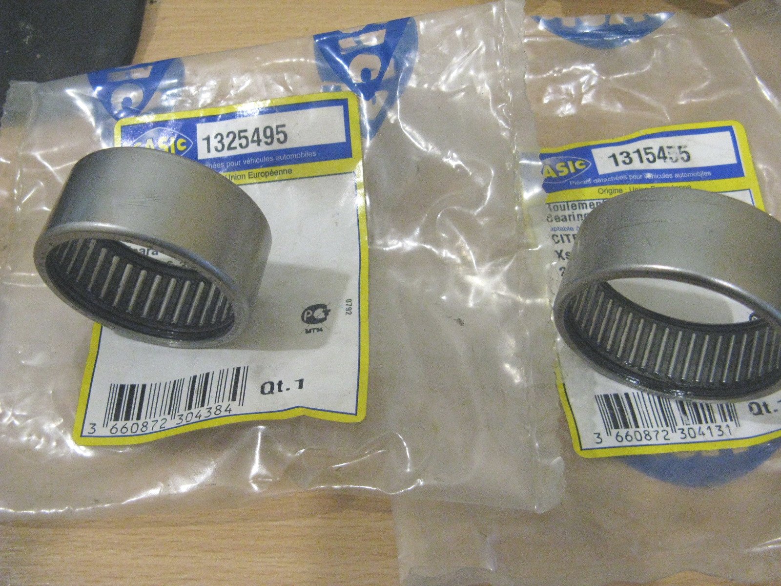

Order Sasic bearings , in single package per piece ie. 1 bearing .
You'll get inside the package either SKF or Timken bearing (same as Nadella) :
Inner bearing sample pic :
https://www.cardon.com.ua/autopart/sasic/1315455
I've some extra spare packs of Sasic bearings , some are Timken , and some are SKF - all the same as Nadella , ie. proper count of needles , robust cage and shell - quality bearing as OE item .
Price wise :
inner 1315455 - 6 EU per piece
outer 1325495 - 8 EU per piece
D

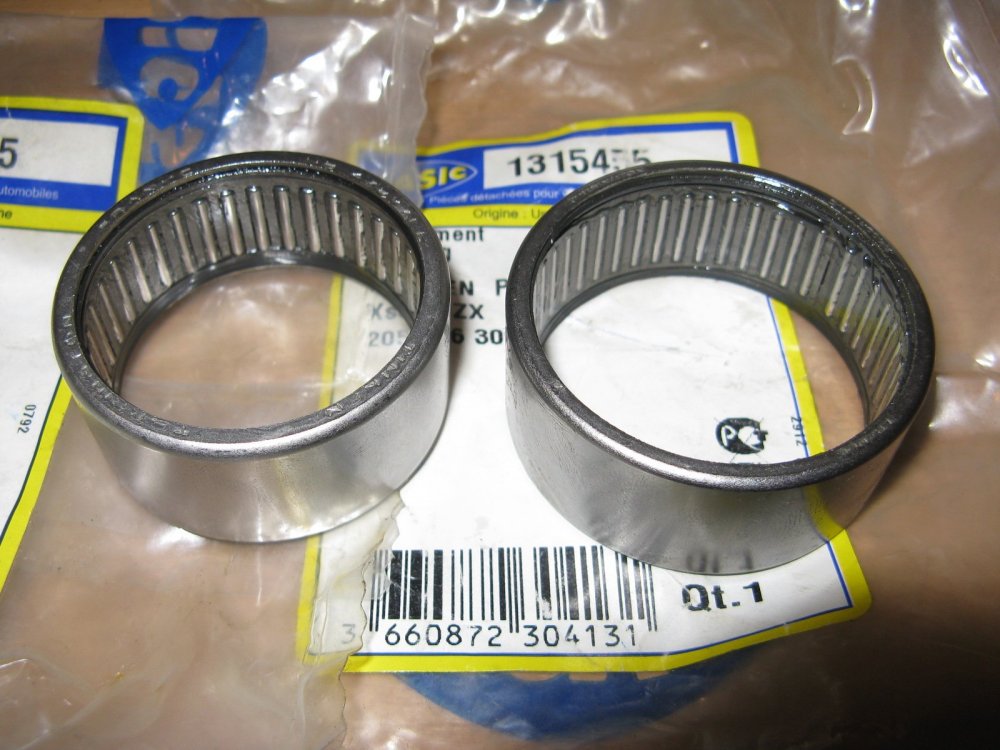

I would not trust the image 100%, autodoc list them also but with the other type of bearing pictured, £4.96 each
DamirGTI
From my personal part stash (Timken variant) :

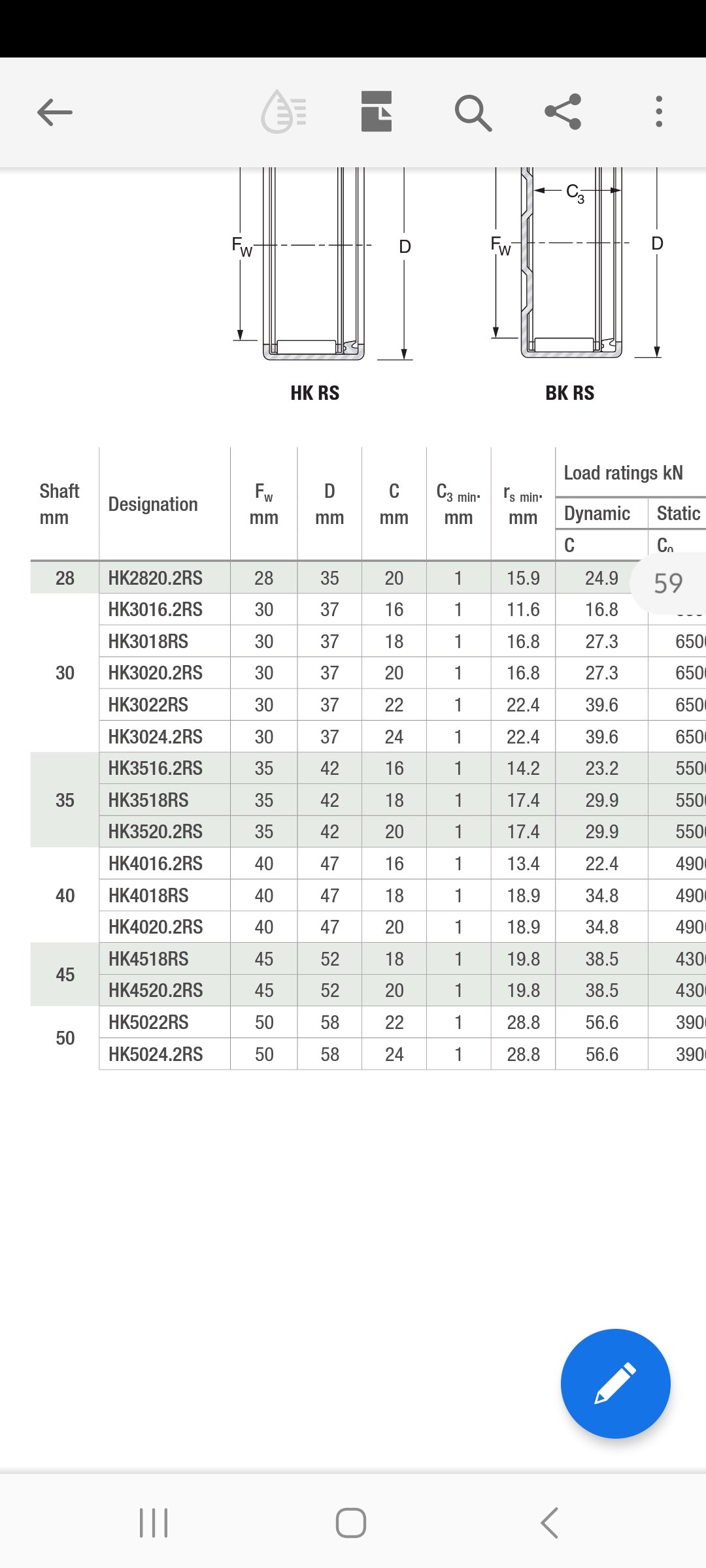

Tha ks i just went onto the nadella site and looked at there catalogue and couldnt seem to find them are they no longer available.

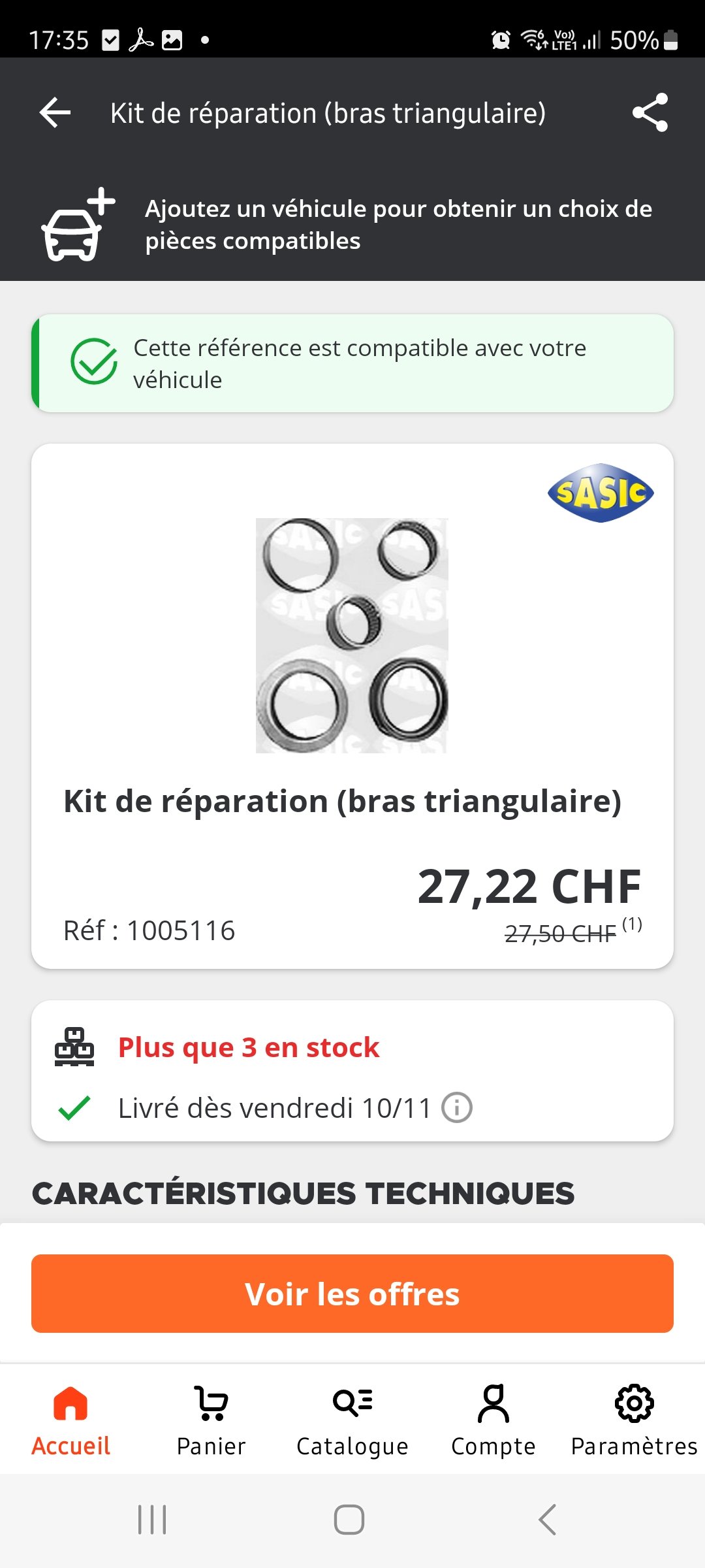

I have orders this kit will see what it brings.

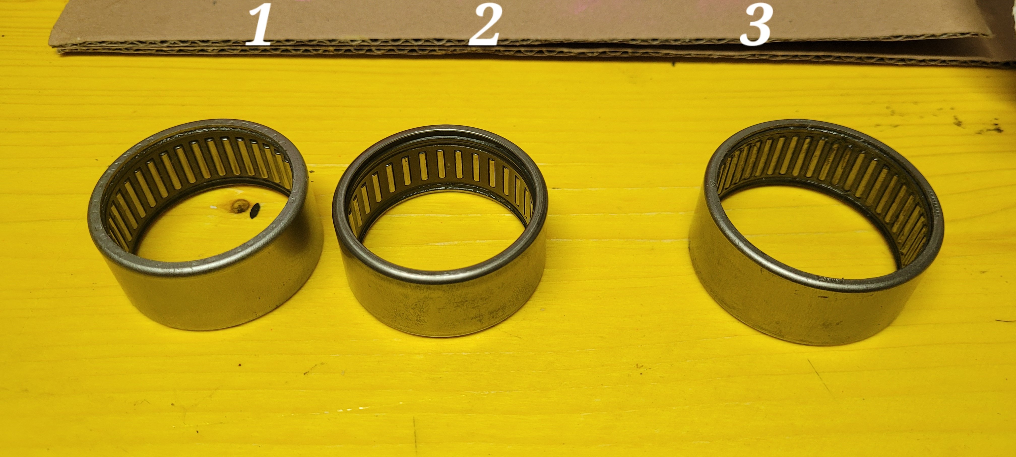

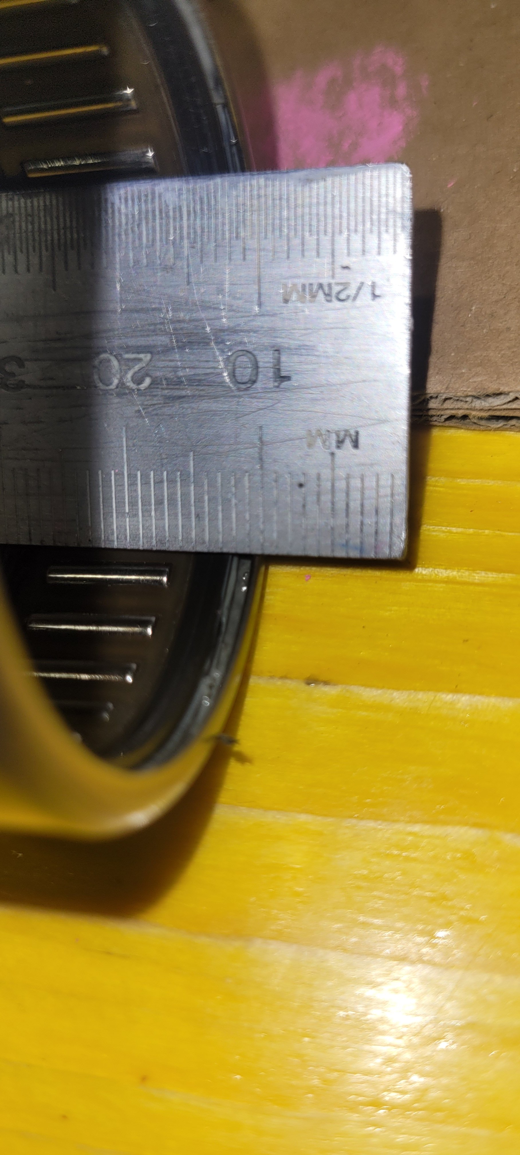

I knocked out the old bearings the outer was an Koyo and the inner was a INA with the lower count and narrow needles. Another thing i saw as well was that the bearing race of the inner bearing could be moved 2mm from side to side ?
I also found a nadella bearing in my stock and like Damir showed in his pic there is a clear differnec in quality.
1= nadella bearing.
2= old INA bearing with play?
3= outer koyo bearing.

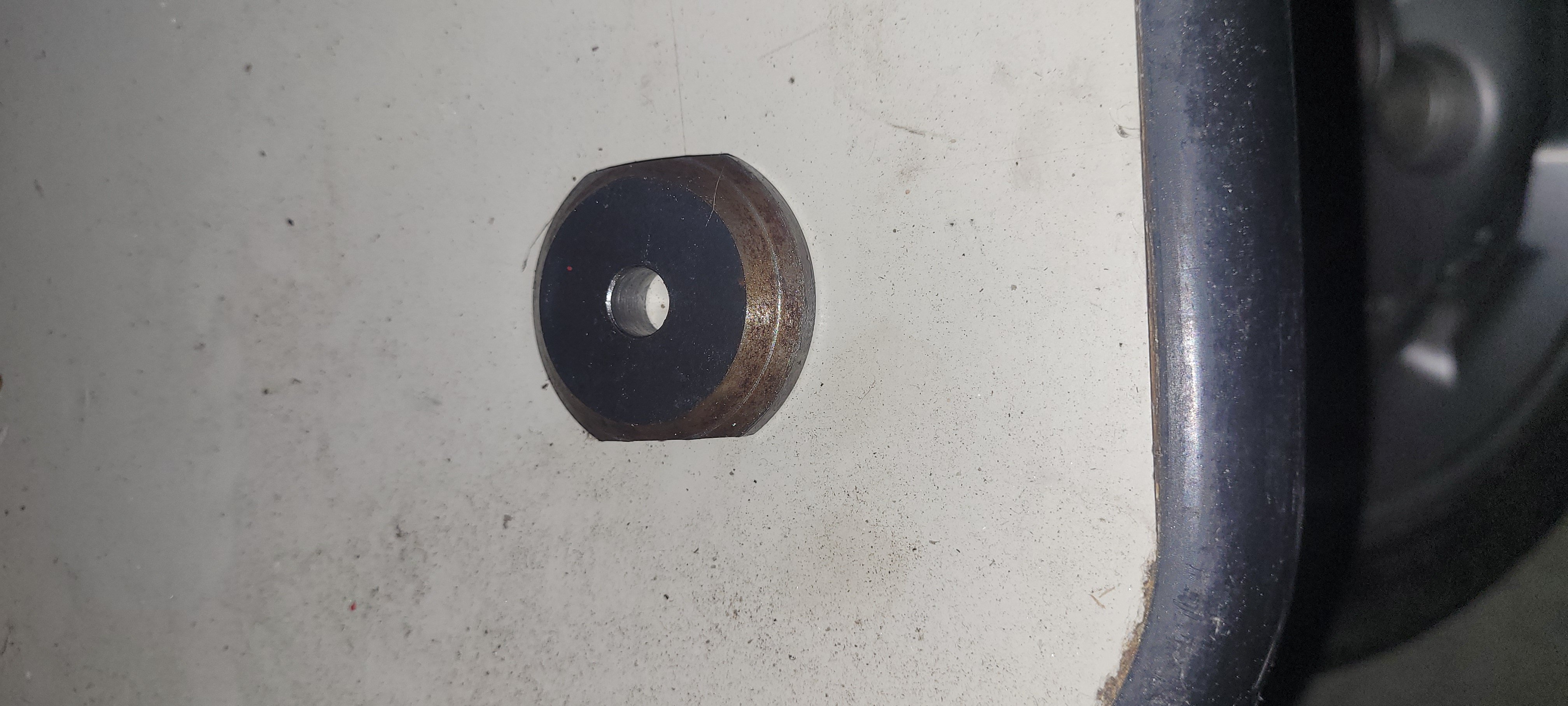

 They were a tight fit i used the tool pictured below to extract them and took a few good hits with the lump.hammer to get them out  oth inner and outer.

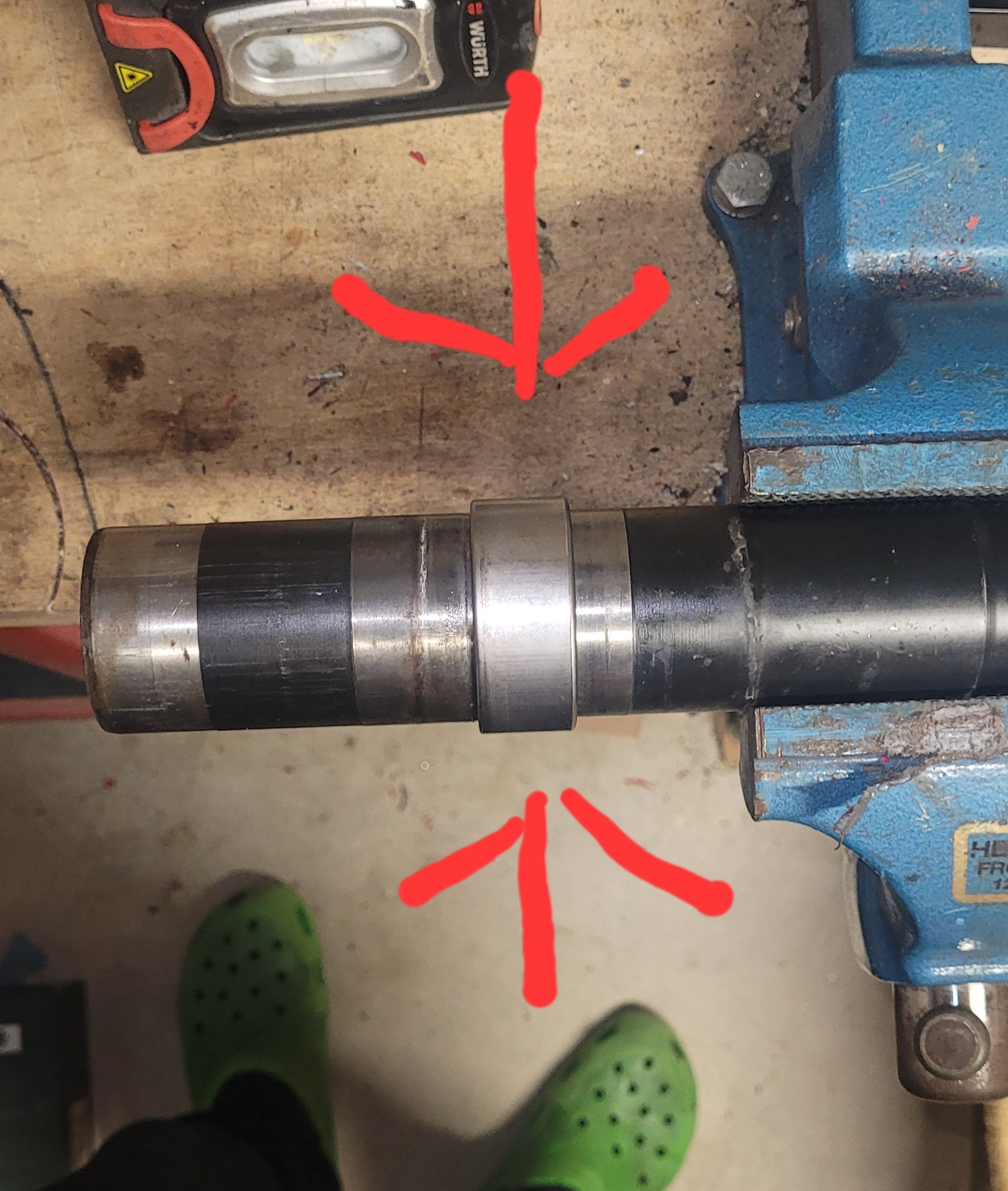

I just put them the old TA shaft i pressed out, whilst holding it in the vice and if i pushed on the outer bearing at the 3 and 9 o'clock position it had play back and forth.
I did the same with the inner bearing and it also had a bit of play.
Where as when i put the nadella bearing on the shaft it had no play

By back and forth you mean along the shaft?
Original question was  - What sort of fit are they on the trailing arm, any play radially at right angles to shaft?
These bearings, as far I understand it, only support the training arm shafts in the tube (so a bit of play back and forth should not matter much), the trailing arms are restrained side to side by the torsion bars.
Gavin Waddell

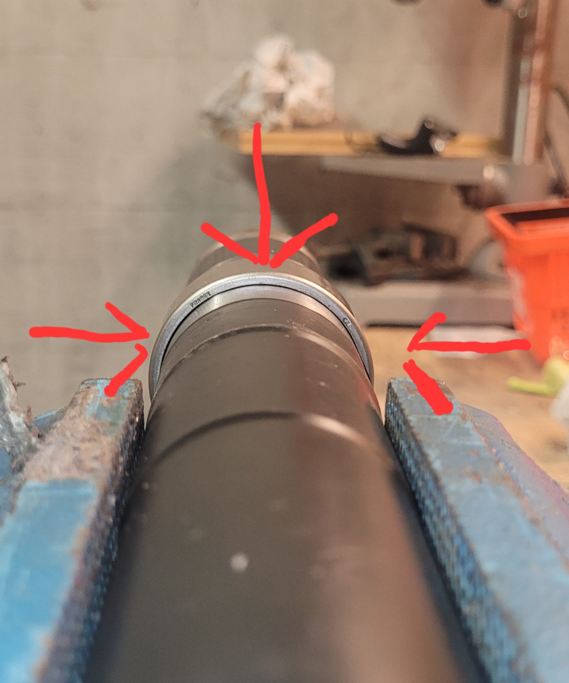

They are a tight snug fit on the trailing arm.  If i apply force at the 9 and 3 or 12 and 6 position i can move the bearing buy abour 0.5-1mm side to side or up and down, as shown by the arrows.
If that is the old bearing, I think that amount of slack indicates where the problem is. There should be no slack for new bearings assuming there are no issues with the axle tube or shaft.

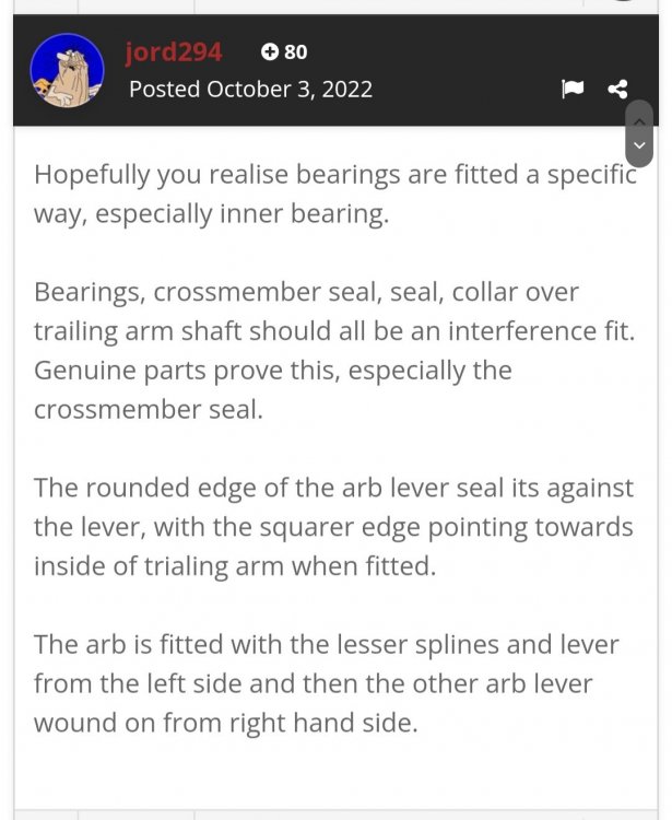

 I was just looking through the article on the website for beam refurbishment, and it says the bearings must be installed with the stamping facing outwards. I think i might have installed mine them wrong  way around. So, won't make that mistake again.
But whats the reason for installing them that way round?

jord294
Common practice for me to always fit bearings with writing so I can read. But as said, the flatter more built up edge should be facing you as it is fitted into tube.
Only recently I've had more axles in with outer bearings fitted incorrectly

On 11/13/2023 at 8:45 PM, SRDT said:
 That part number mentioned (5176.17) still brings up the usual bearings in any kit I've found so far, see the meyle kit pictured below.
Although the outer bearings look good in that kit, not so sure about the inners though.

For Peugeot 5176.17 is just the shaft and not a complete kit, also it's probably a newer part number and not the original. At least it's not for the "needle bearing" arms.
It seems that Peugeot really wanted you to switch to needle bearings, not sure if there is a good reason behind it or if they just didn't want to bother keeping old parts in inventory when they could just force you to buy new shafts on top of bearings.

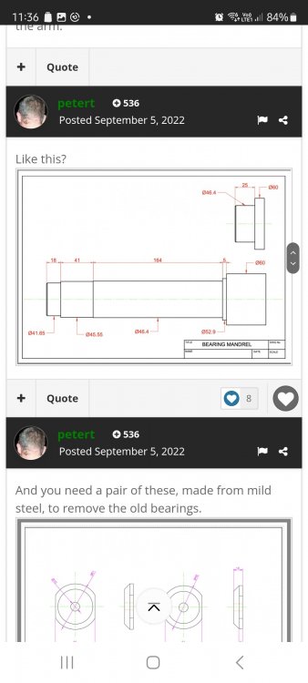

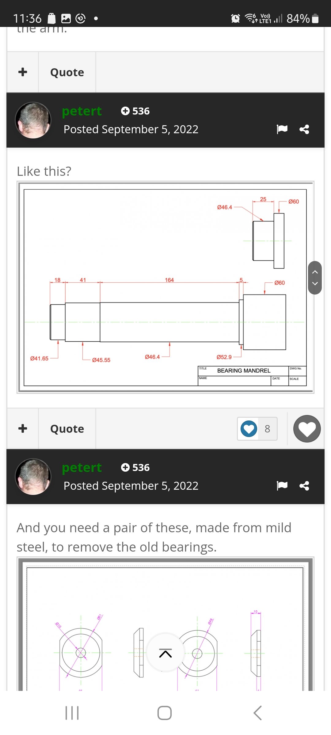

So i installed my new bearings, put the cup and the seal slide the the trailing arm in (with new shaft ),.so now everything is new and i still knocks, arrrrgggggghhhhh now im completely lost as to what it could be. Is it beacause i have seated the bearings to dar in the tube the outer is 5 mm from the.end of thebtube and the inners outer edge is 200 from the end of the tube ? I used a tool like this to install them .
