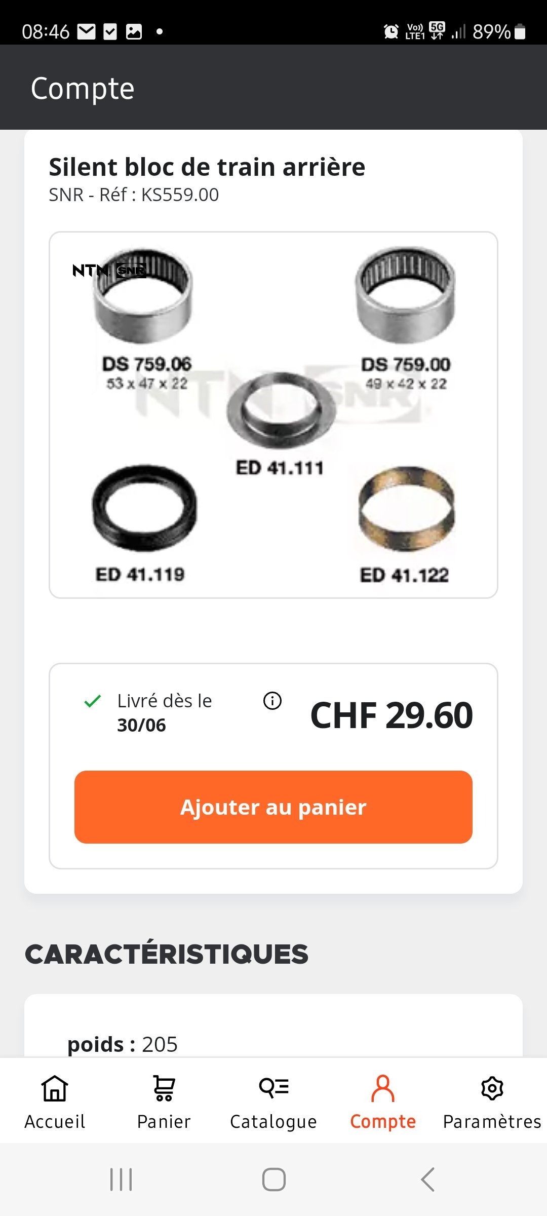

Gavin Waddell
These are the bearings i used

Gavin Waddell
Thats why i was thinkig the bearing was on its way out.
