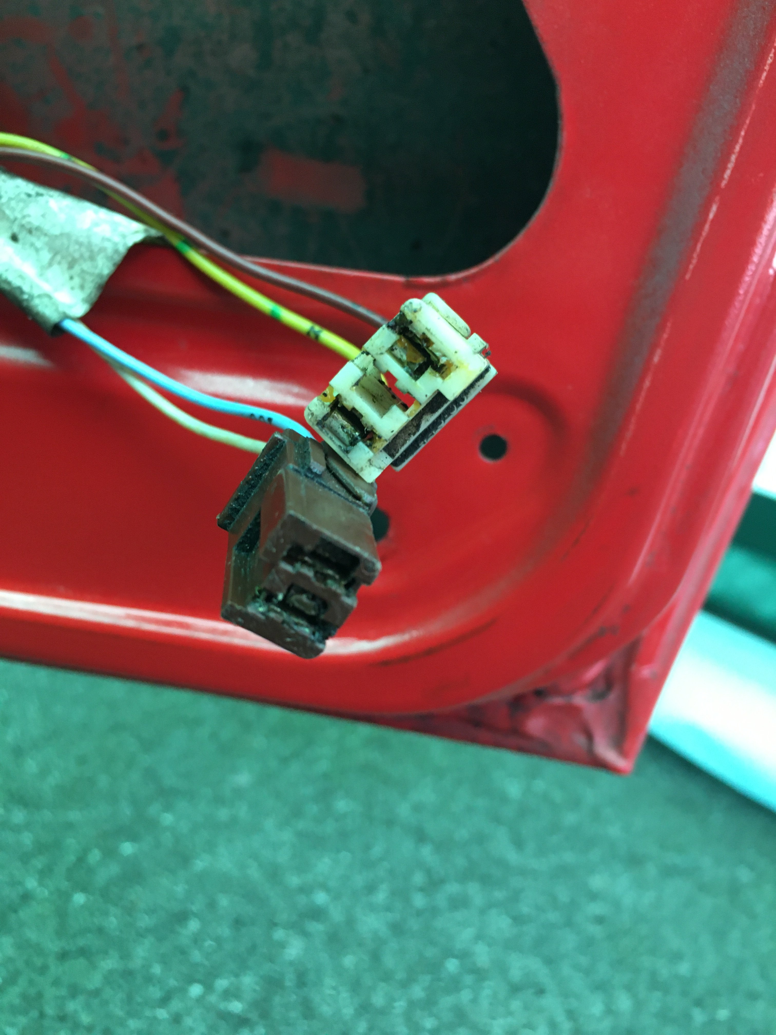

shonkers 6 Posted June 14, 2023 Tom which two wires do you mean? ‘cos the plugs can only go in their respective holes (idiot proof) Share this post Link to post Share on other sites
DamirGTI 366 Posted June 14, 2023 Blue and white on brown connector , they are connected to all the motors/solenoids and trigger lock-unlock .. As Tom said , swap places ie. blue on white connector slot and white on blue slot .. no need to cut the wires , can open up/pry off connector push the wire terminal locking tab and pull out . D Share this post Link to post Share on other sites
shonkers 6 Posted June 14, 2023 Sorted now it was the passenger side i had replaced the dodgy plug and used two spade terminals, glad it was something simple thanks for your replies Share this post Link to post Share on other sites
