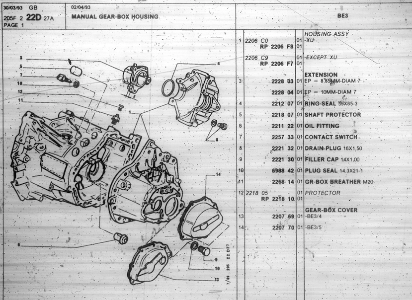

Gohn 62 Posted June 8, 2023 check fuses, bulbs and earths sounds as though you've checked the two former, now check the last your rear lights earth point is a multi earth, located just next to the left rear tail light give it a good inspection, clean out and dialectric grease if you have it (and recommend doing the same to the ones in the engine bay while you're at it, especially those just next to headlights) the reverse light sensor is located in a plug in your gearbox (no 7 in the pic, if yours is a BE3 transmission) at least one of mine has failed in the past but they're easy to source and replace if needed Share this post Link to post Share on other sites
