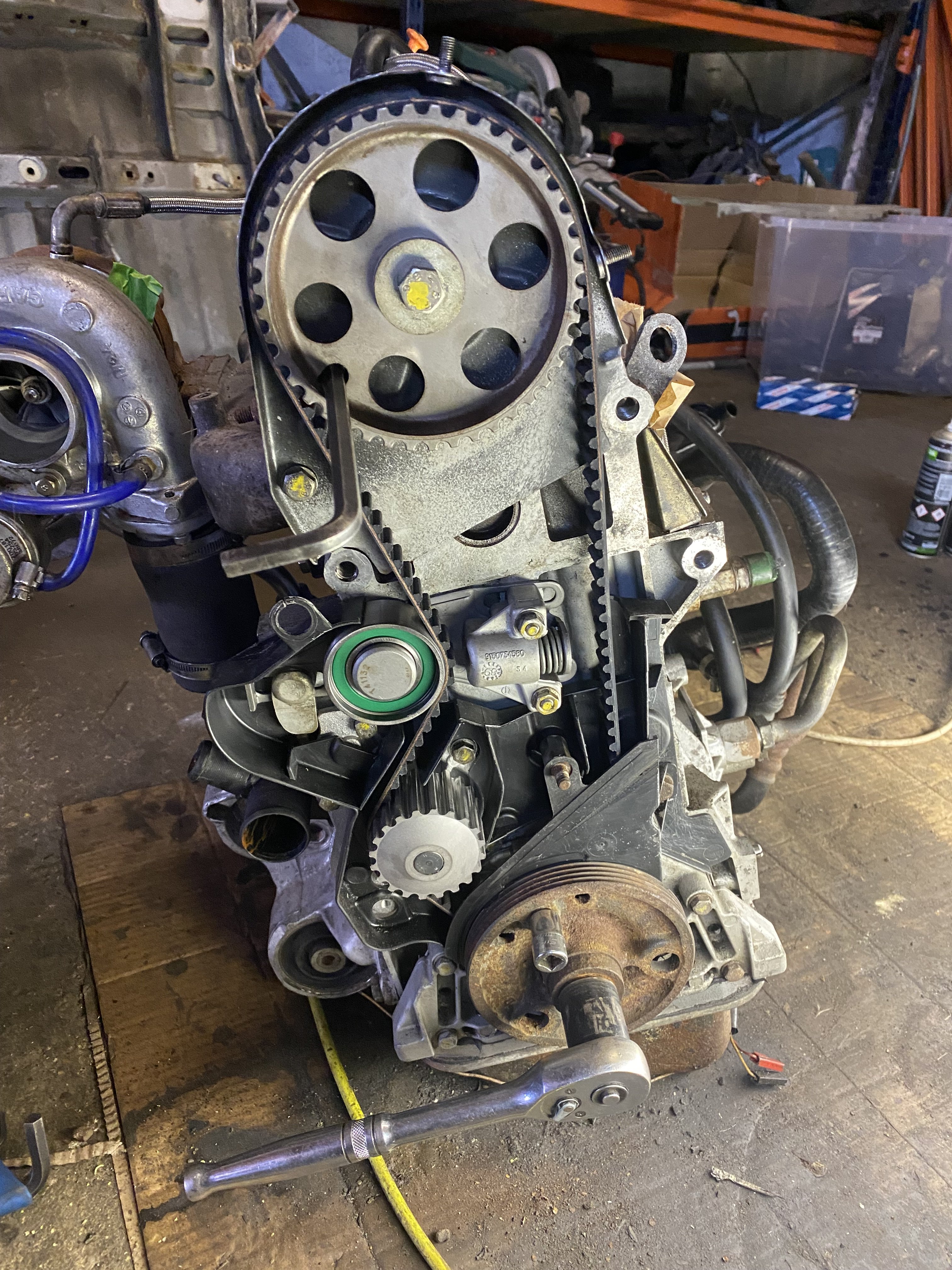

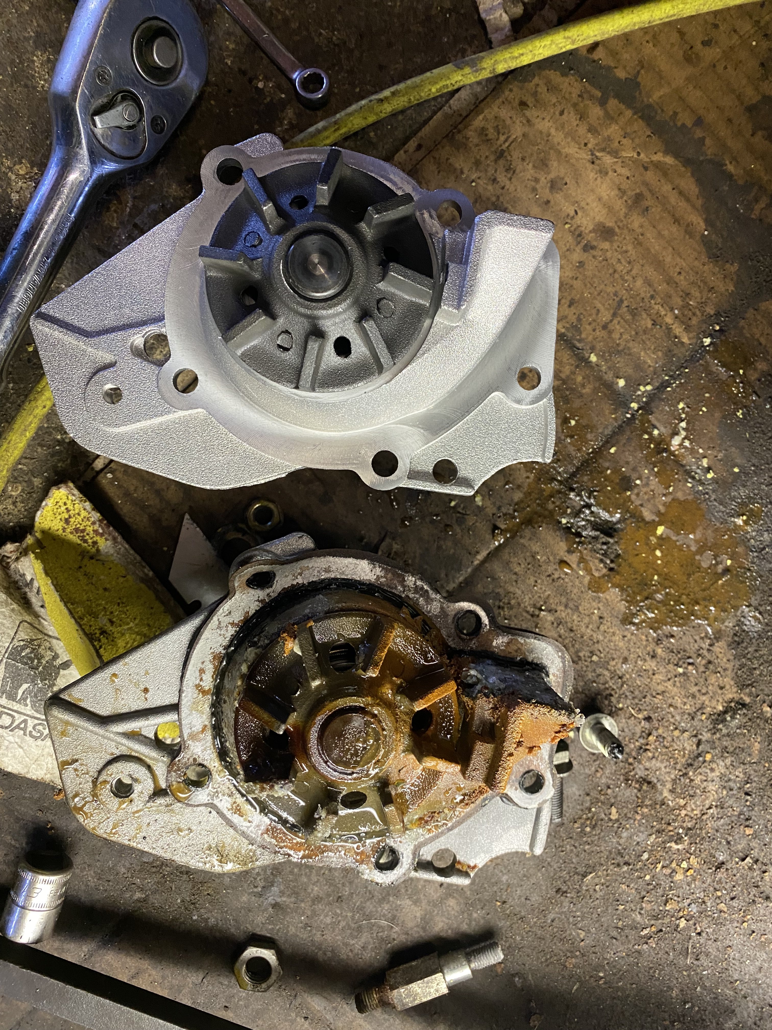

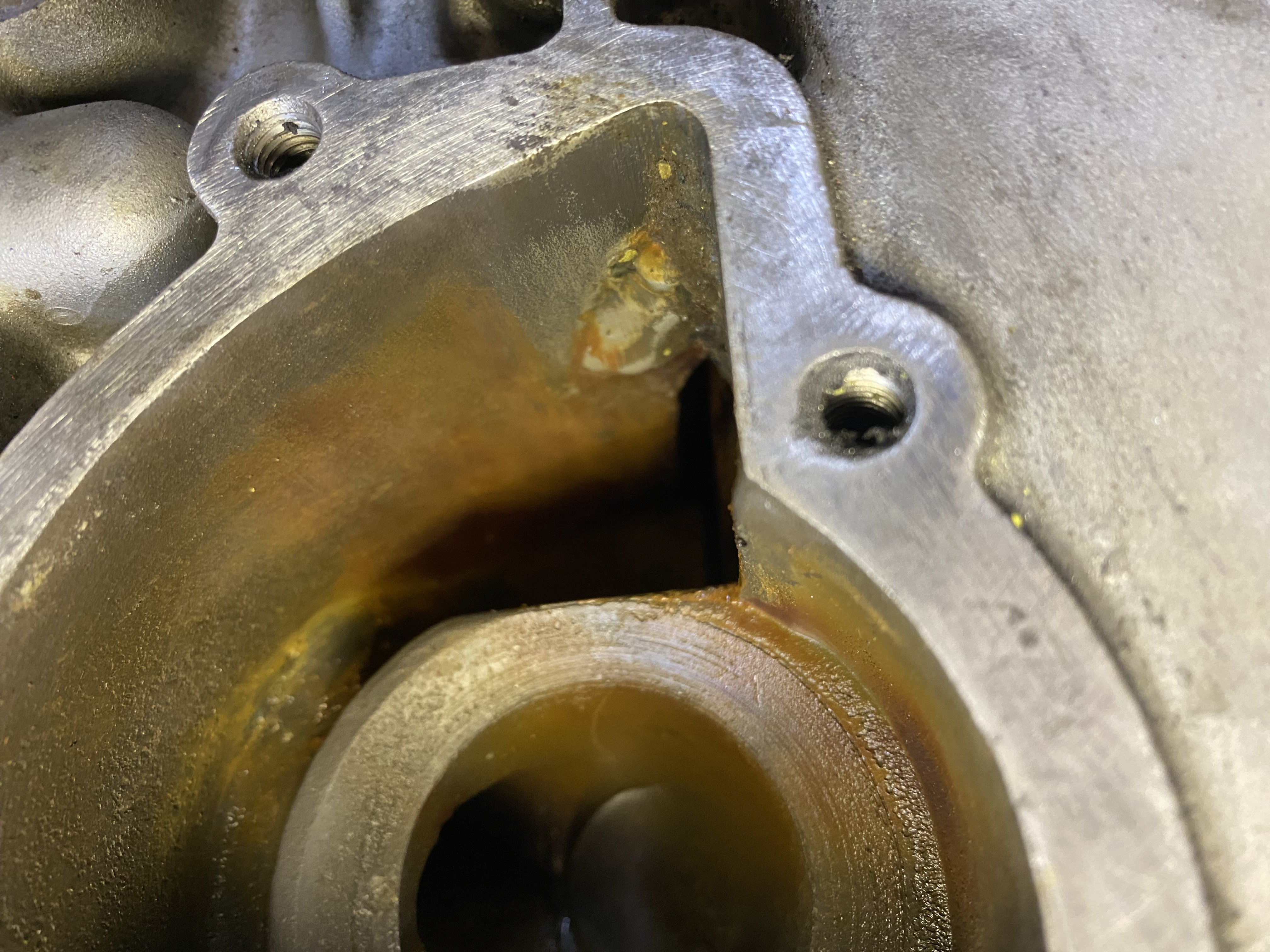

j_turnell 137 3 Cars Posted August 14, 2023 Fitted a new cambelt kit and water pump yesterday. Good job looking at the state of the water pump. Looks like someone missed off the extra head bolt spacer at some point also. Share this post Link to post Share on other sites

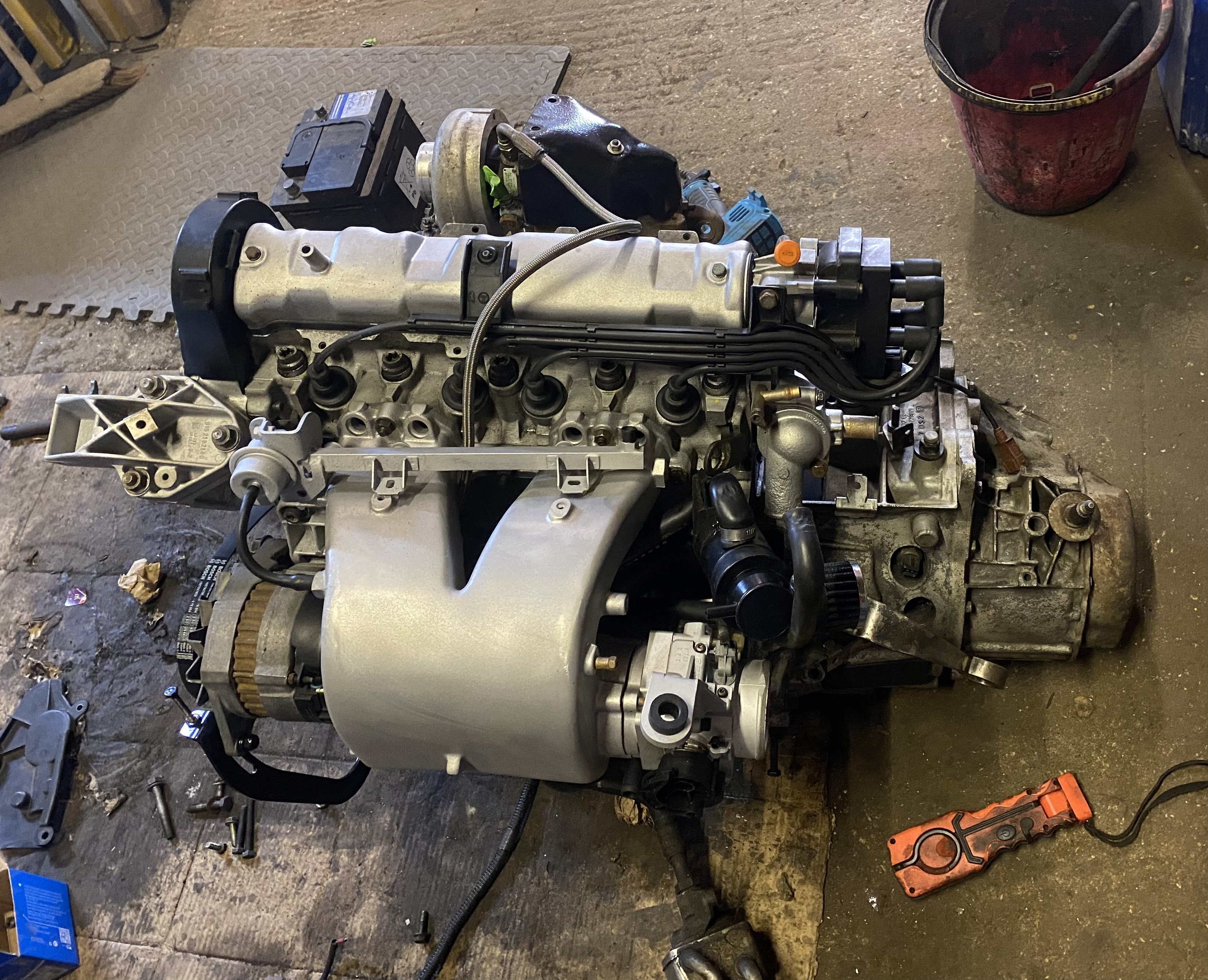

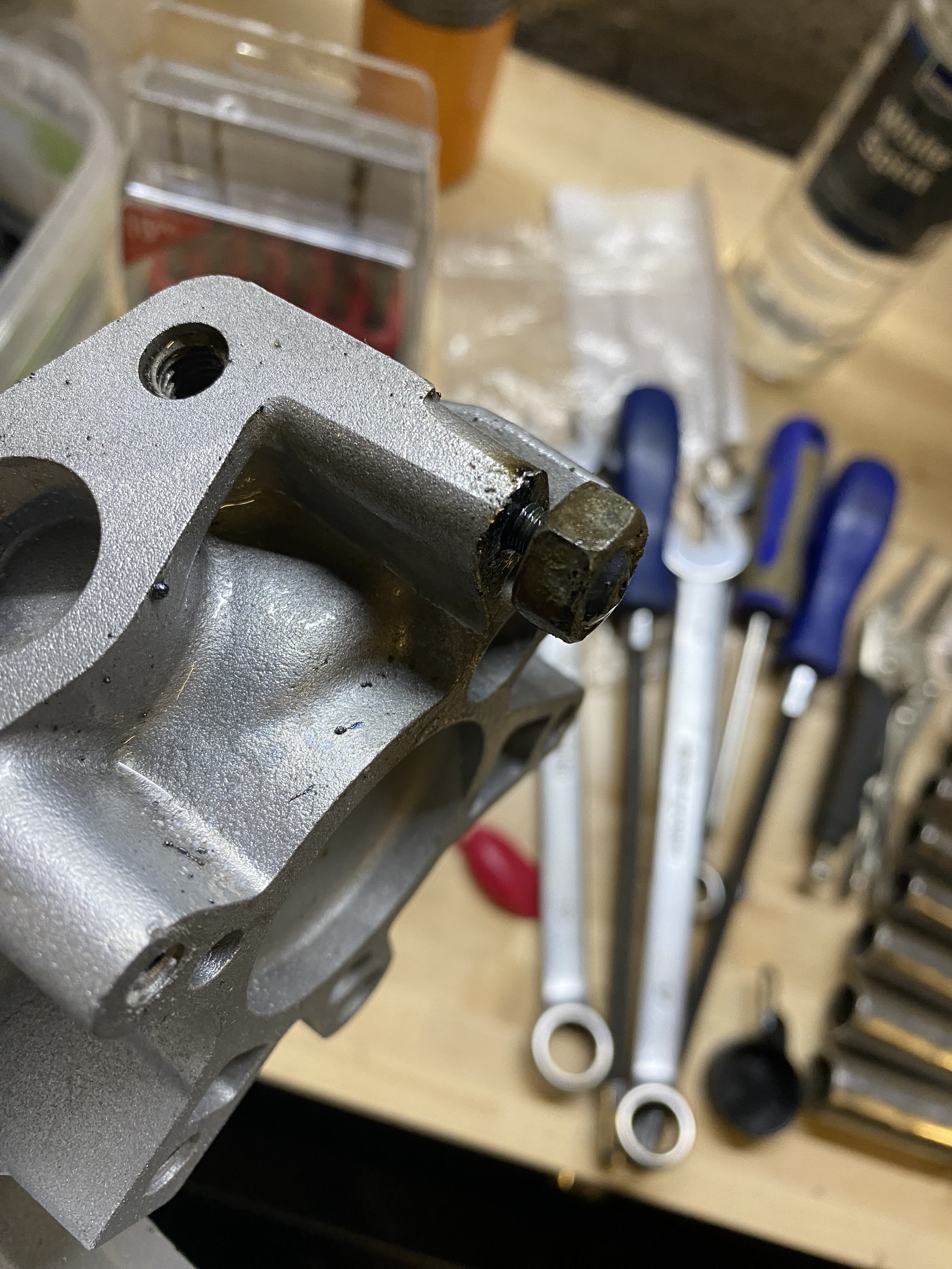

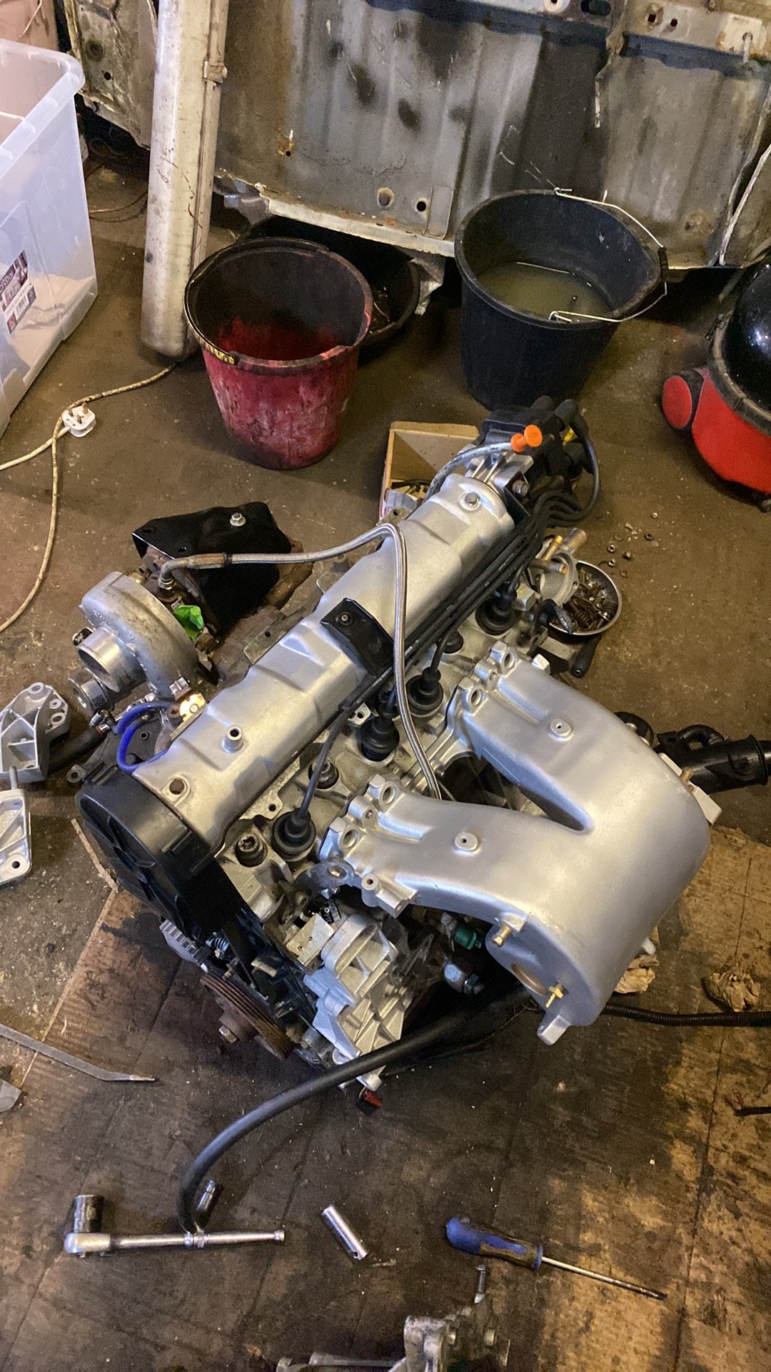

j_turnell 137 3 Cars Posted August 20, 2023 (edited) Parts back from vapour blasting. Also got some parts powder coated. Not a great deal left to do before the engine can go back in. Spark plugs - what do people run in these? Was going to put some ngk 7’s in. Also had a small win welding a nut on a snapped coil pack bolt to get it out. Edited August 20, 2023 by j_turnell Share this post Link to post Share on other sites

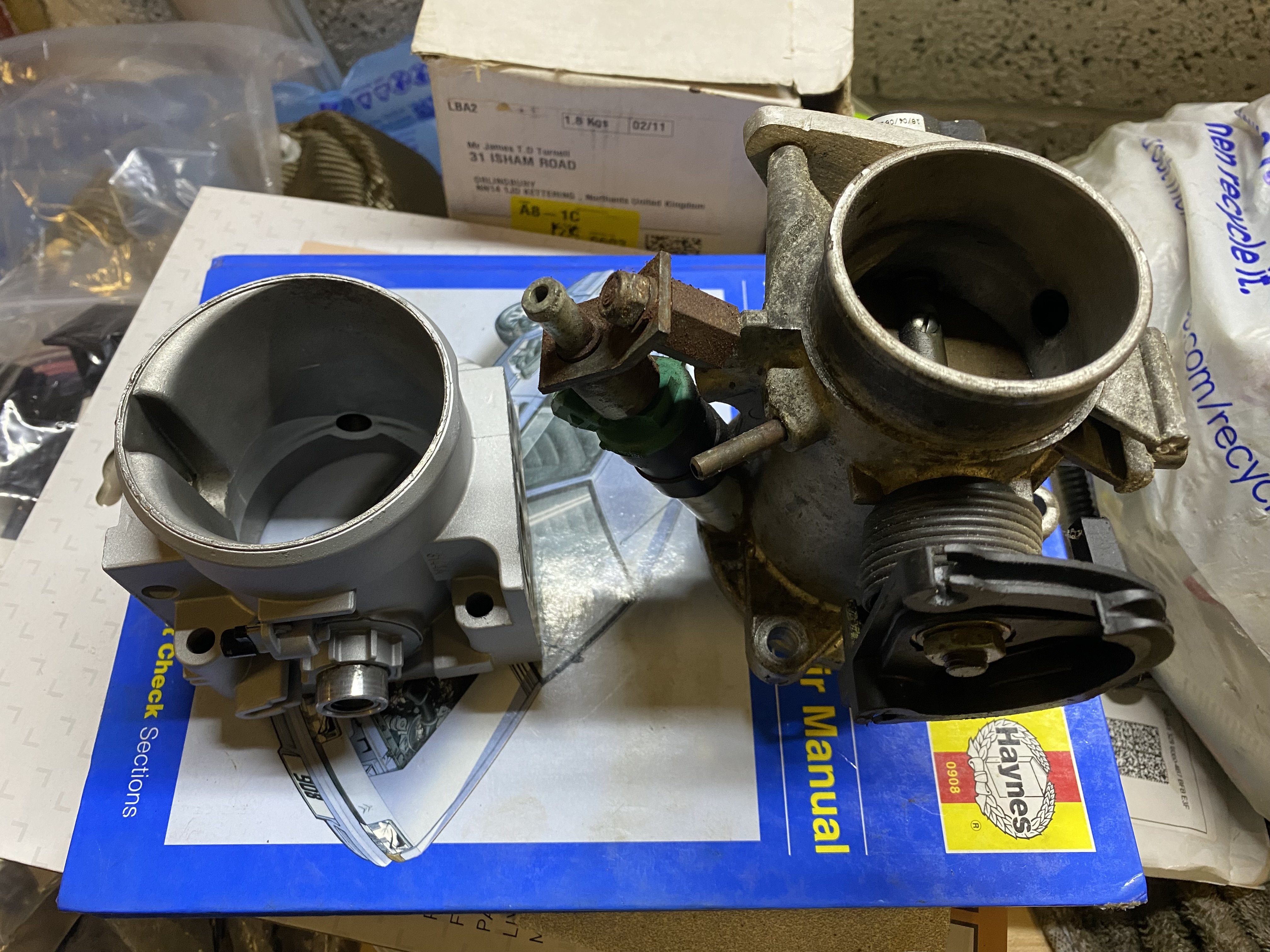

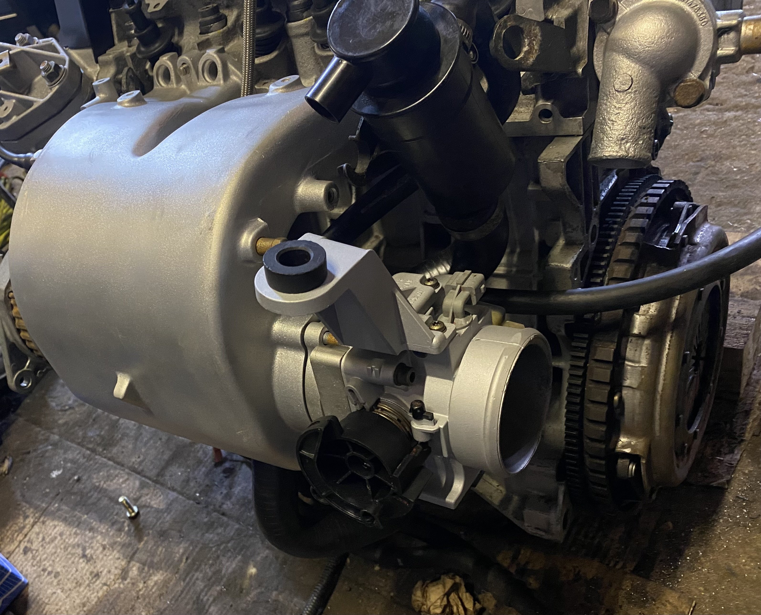

j_turnell 137 3 Cars Posted August 22, 2023 Mocked up the gti6 tb. I already had an adapter for a gutmann inlet for another project so thought I’d use it on this first. it’s around 20mm bigger than the stock 8v one should improve things. I can also use the stock gti6 tps. Stripped it down and cleaned it. Anyone used the gti6 air temp sensor with omex? Was thinking of running a 2 way blow off valve for a bit of fun. Anyone recommend anything? Share this post Link to post Share on other sites
Anthony 1,003 Posted August 22, 2023 1 hour ago, j_turnell said: Anyone used the gti6 air temp sensor with omex? Not on an Omex specifically, but have on a DTA and worked fine on that - it's just a simple 2-pin thermistor so should work on any aftermarket management. Car is looking great so far James and you're progressing this at quite a pace - can't believe that given how rare a 205 TT is nowadays, there's now two within a (literal) stone throws of each other. Share this post Link to post Share on other sites
j_turnell 137 3 Cars Posted August 22, 2023 31 minutes ago, Anthony said: Not on an Omex specifically, but have on a DTA and worked fine on that - it's just a simple 2-pin thermistor so should work on any aftermarket management. Car is looking great so far James and you're progressing this at quite a pace - can't believe that given how rare a 205 TT is nowadays, there's now two within a (literal) stone throws of each other. Thanks Anthony I was hoping that would be the case, makes things a bit easier and for a tidier install. I should be able to check when it’s on the dyno also. It’s been a while since I’ve had a 205 on the road so trying to get this finished. As 205’s go this is a cracking car so want to enjoy it. Yeah it is ironic. Both G plate dealer converted cars! Share this post Link to post Share on other sites
welshpug 1,735 Posted August 22, 2023 Worked on a clio running omex recently, the IAt Sensor on that looked identical to a gti6 unit, I think the calibration was the same or close to the threaded iat that the zx motronic intake had. 1 Share this post Link to post Share on other sites

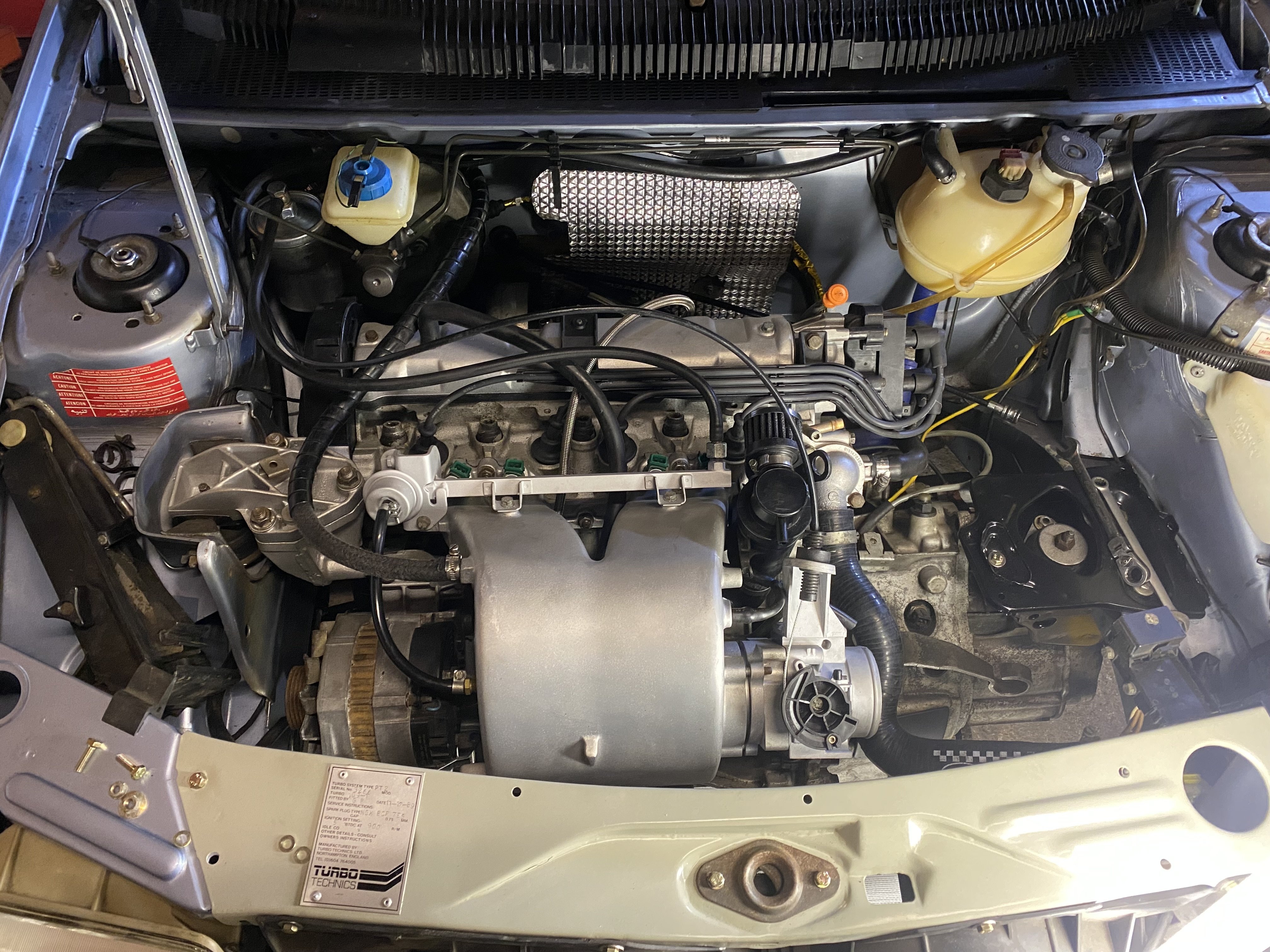

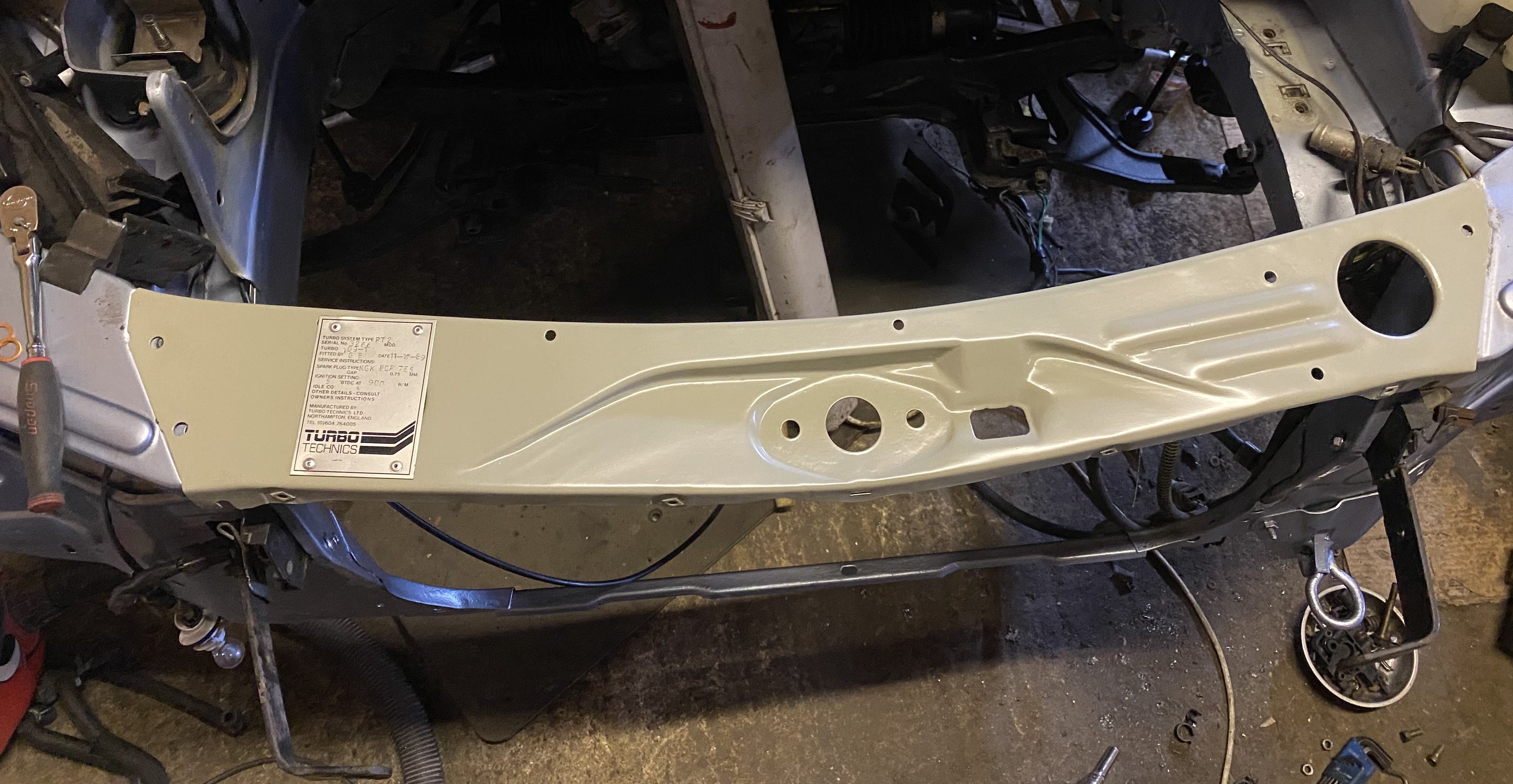

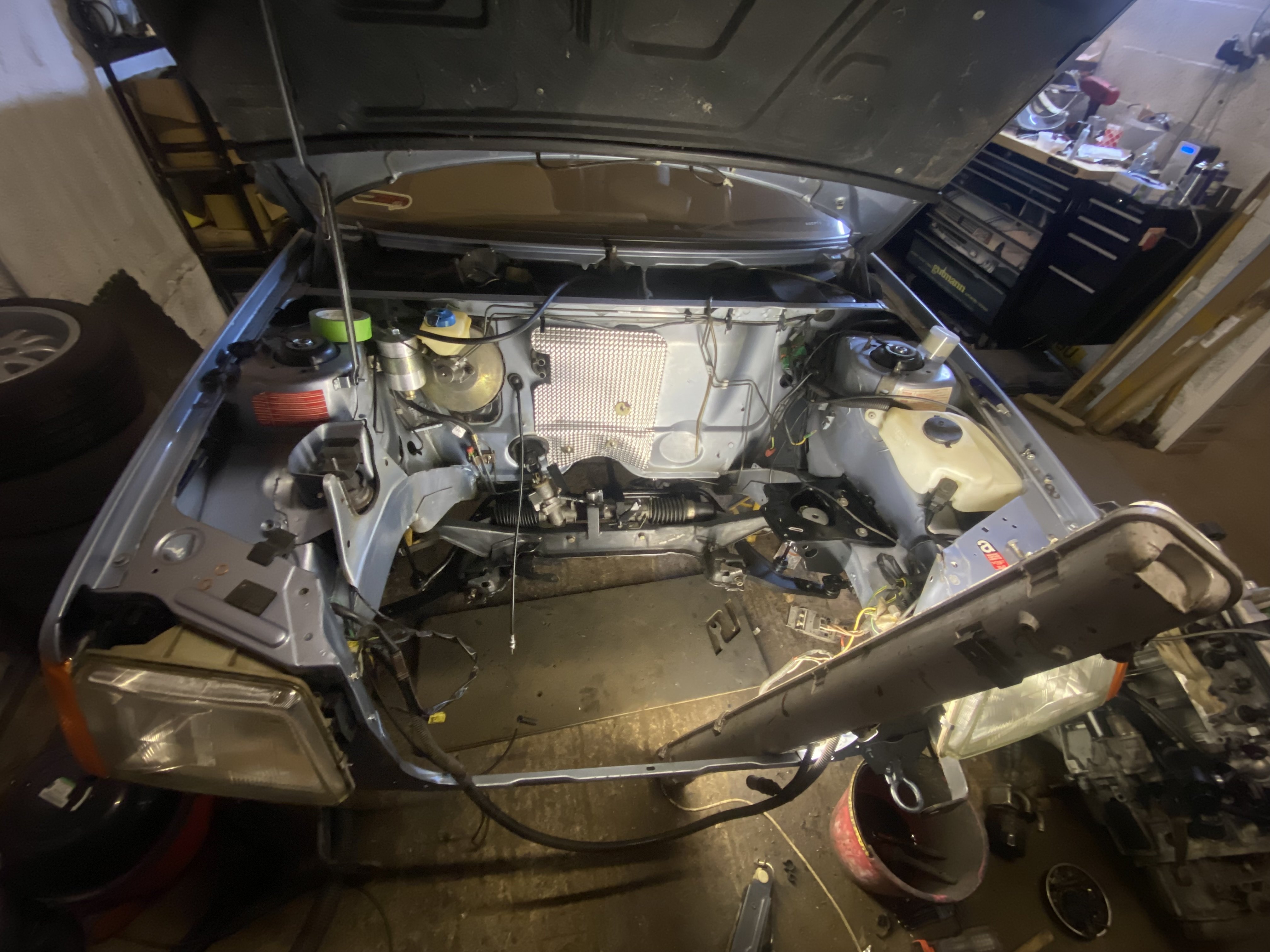

j_turnell 137 3 Cars Posted September 4, 2023 Bit more sorted over the weekend. Replaced the clutch arm and bushes. Gearbox is back on and it’s all ready to go back in. Just some heatshields to make for the bulkhead. Refurbed the slam panel. Not a perfect match but better than the Dove grey that was suggested. Picked up some Bosch greens 440cc to go in. I had the injectors that were fitted tested and they were miles out, sat for 13 years with fuel in. Share this post Link to post Share on other sites

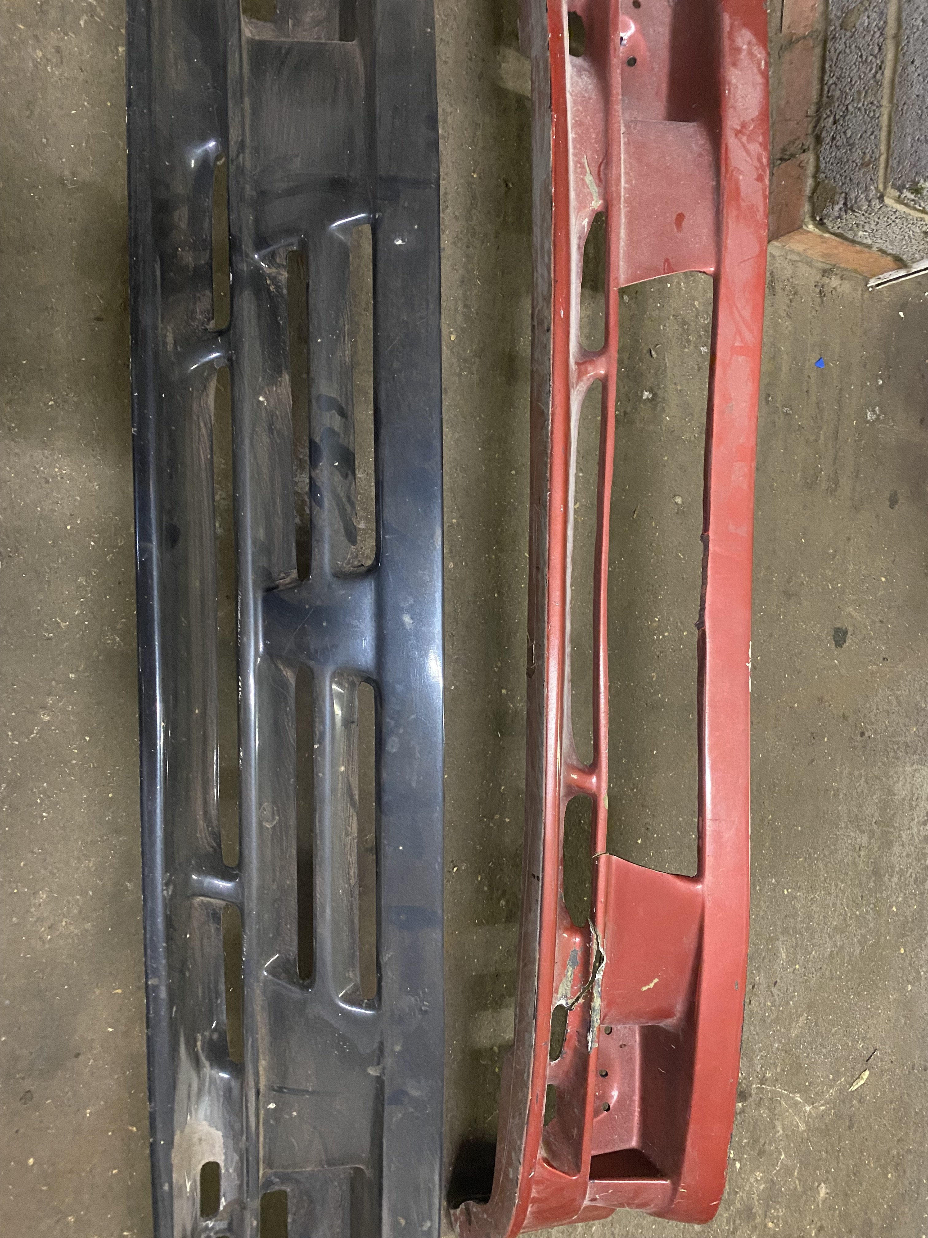

j_turnell 137 3 Cars Posted September 10, 2023 (edited) Made a heat shield for the bulkhead. Engine going back in next week. Anyone good with fibreglass??? Need to copy and make this section on the gutmann valance. Edited September 10, 2023 by j_turnell 1 Share this post Link to post Share on other sites
Henry Yorke 270 3 Cars Posted September 10, 2023 A lot of that is hidden behind the number plate so not that noticeable, but now is the time to fix it.. clingfilm on the original and plaster of Paris to “cast” it to be able to copy? Share this post Link to post Share on other sites
j_turnell 137 3 Cars Posted September 10, 2023 1 hour ago, Henry Yorke said: A lot of that is hidden behind the number plate so not that noticeable, but now is the time to fix it.. clingfilm on the original and plaster of Paris to “cast” it to be able to copy? Not a bad shout mate. Will look into that. Share this post Link to post Share on other sites

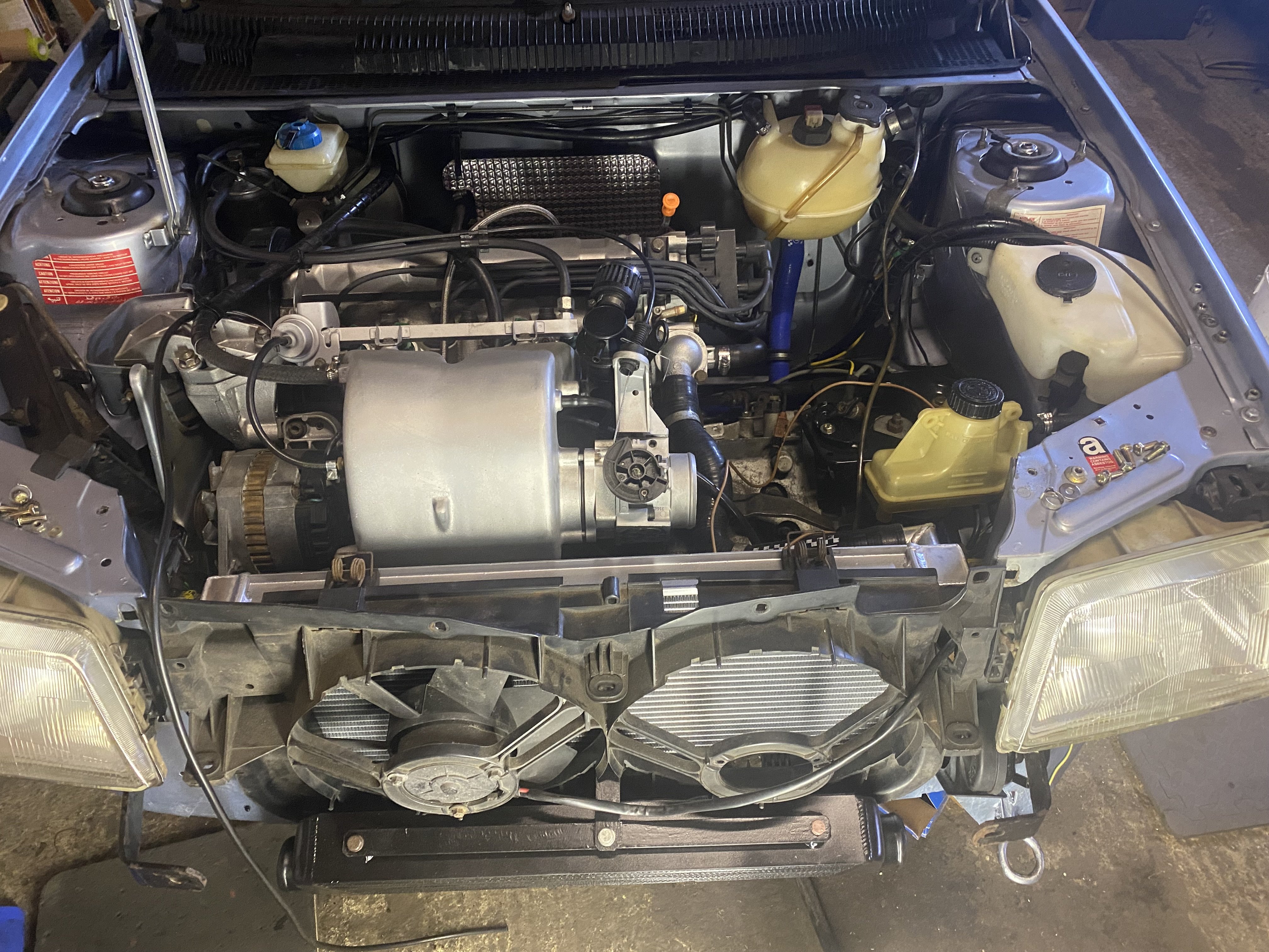

j_turnell 137 3 Cars Posted October 1, 2023 Bit further along with the install. Inlet is now on which meant i could mock up the gti6 tb. After trying various orientations this worked out best. I’ve swapped over some take offs on the inlet to give clearance and it all fits and clears now and throttle cable fitted. I just need to find a spare bracket for the fuel line that fits on the rail to clip everything to. Most of the water pipes are on. Still got feed and returns to do for the turbo. Going from 16ishmm to 10mm is a bit of a pain but hopefully have some reducers arriving. 1 Share this post Link to post Share on other sites
Leslie green 163 Posted October 1, 2023 (edited) Great progress and your slam panel looks an excellent shade of beige Edited October 1, 2023 by Leslie green Share this post Link to post Share on other sites

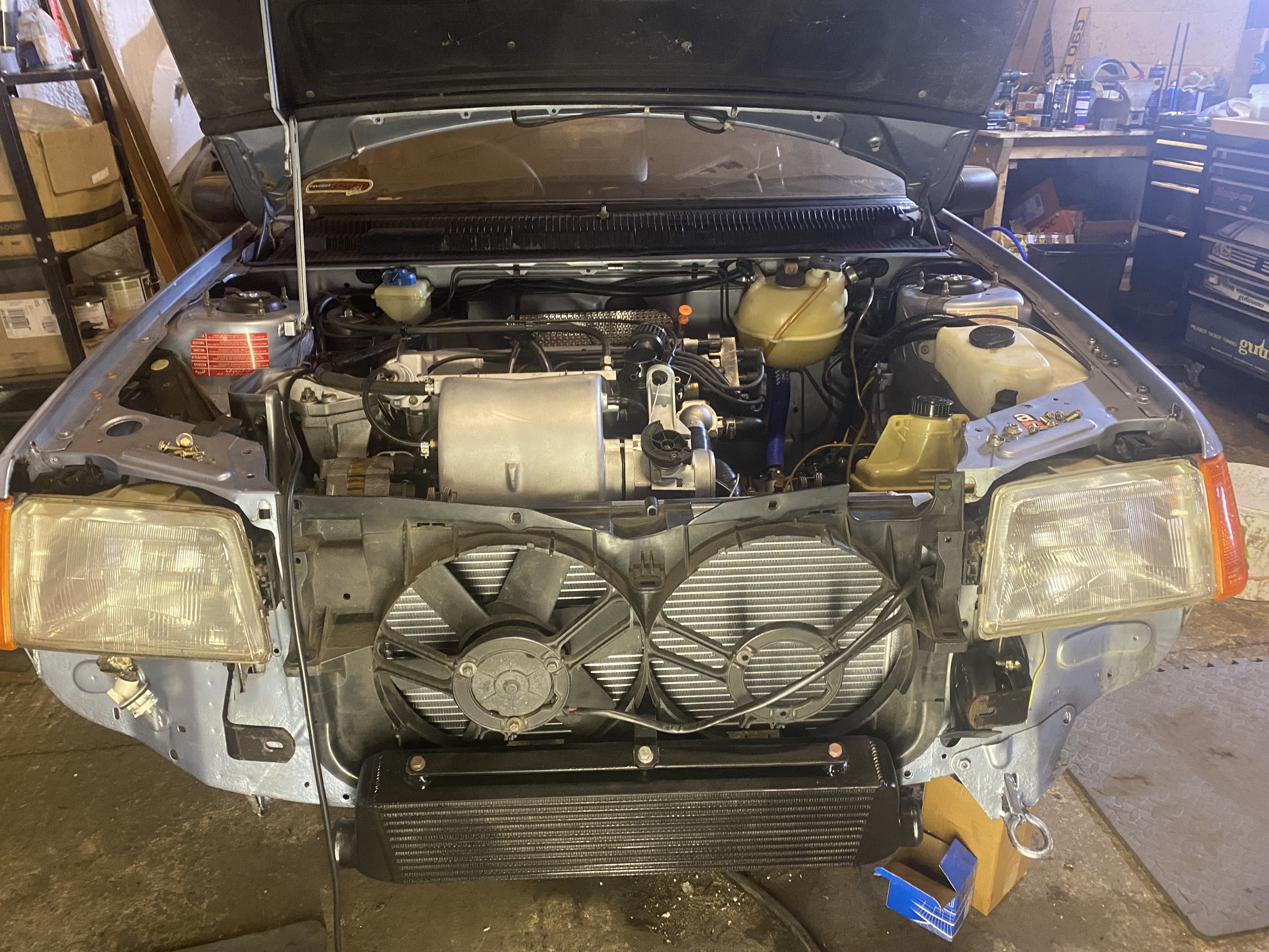

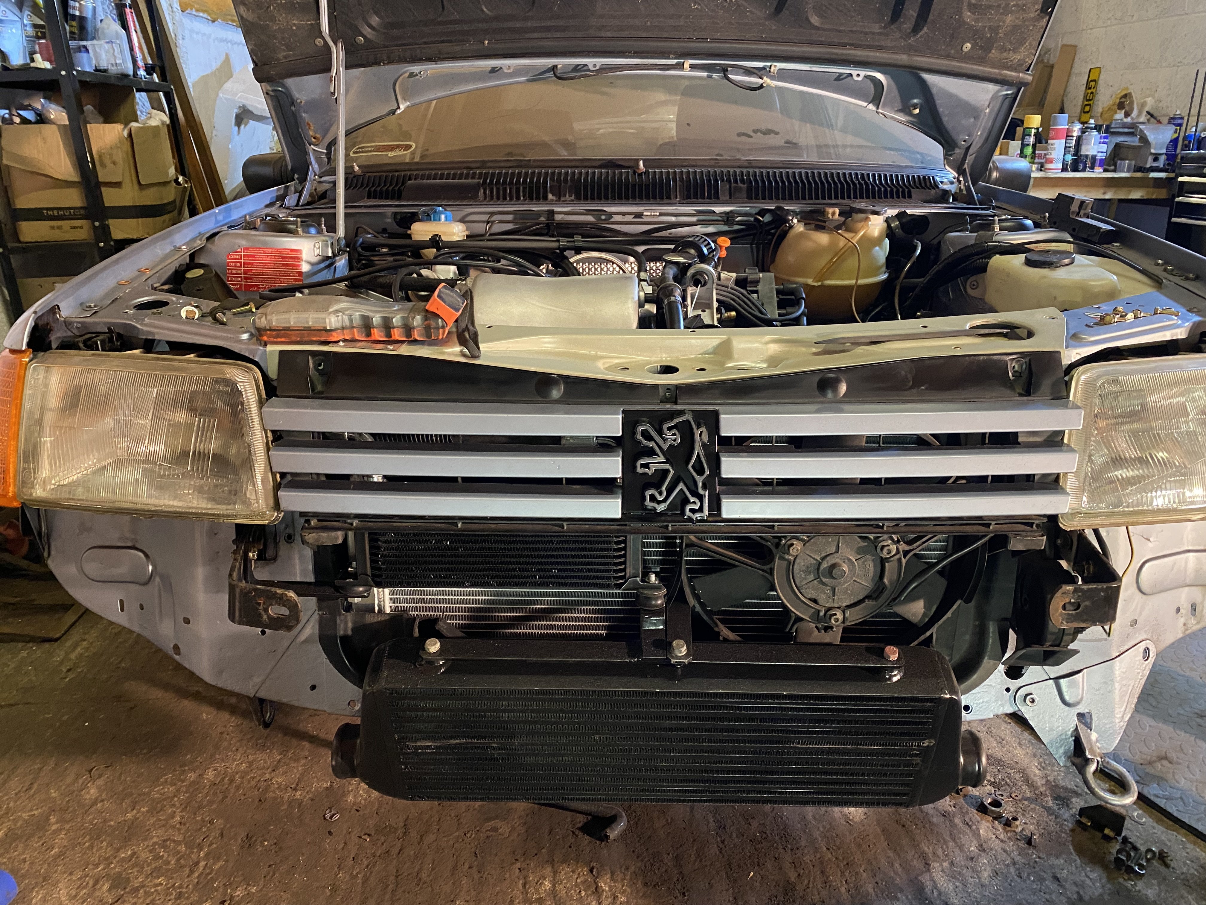

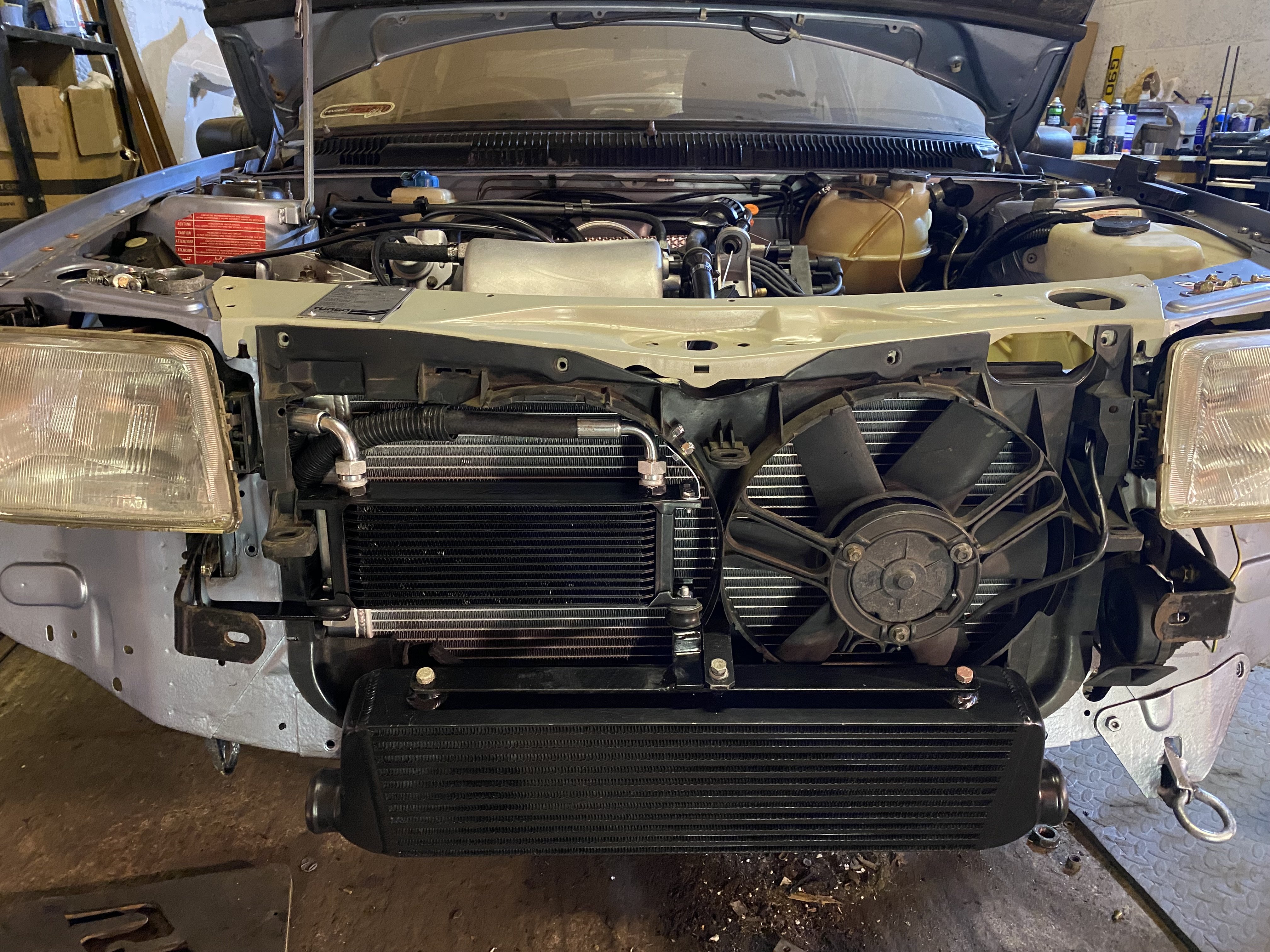

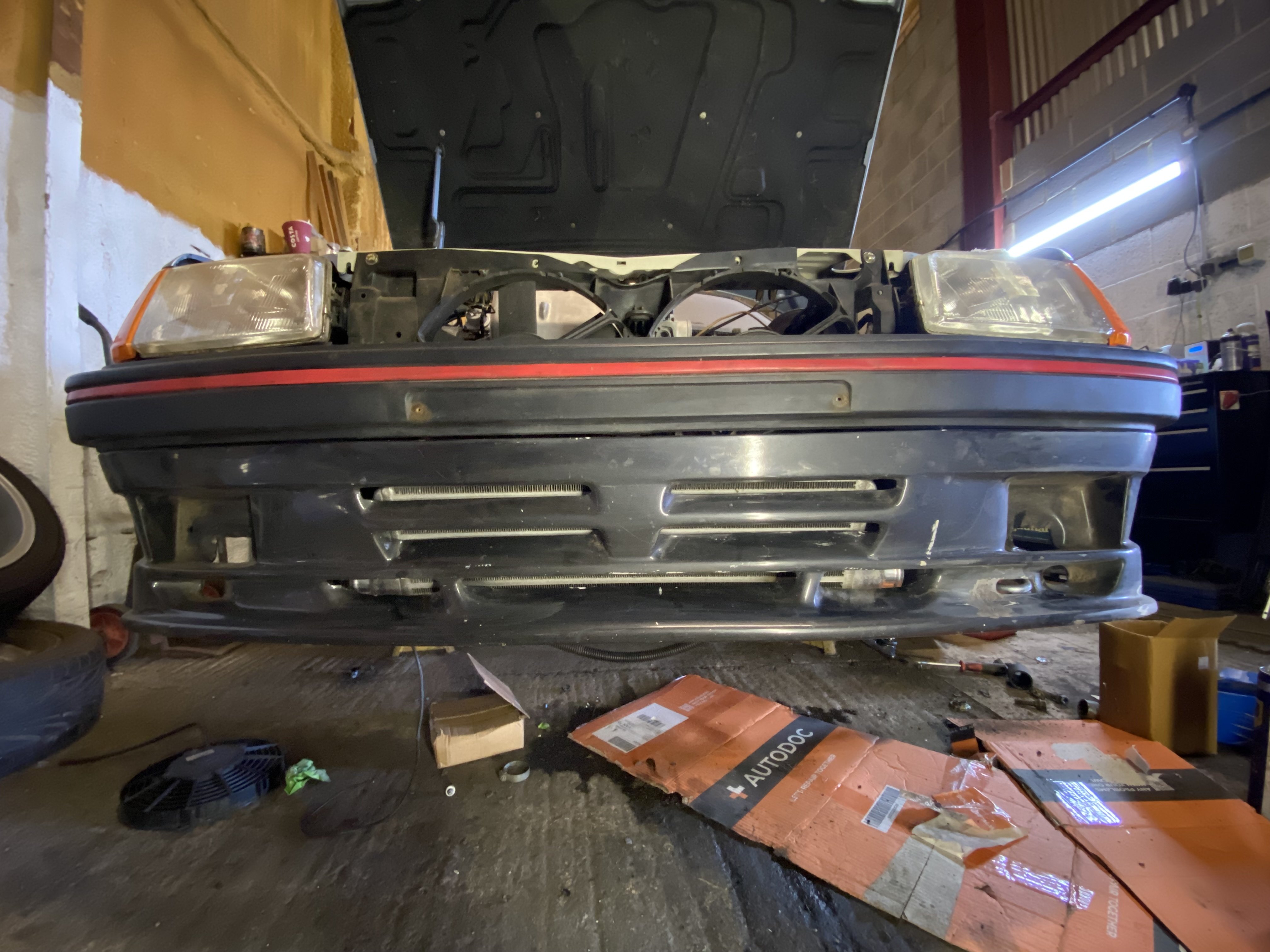

j_turnell 137 3 Cars Posted October 28, 2023 Not had a lot of spare time recently but I’ve got a bit further. Been playing around with routing boost pipes and trying to sort out the water and oil returns for the turbo. Not a lot of room back there so bit of a pain in the arse. Intercooler has been mounted and fits snuggly behind the Gutmann valance. I’ve had a racing look 2 kit in the shelf for a long time so decided to use the front end on this to complement the wheels. It can always be changed if necessary. Now on to boost pipes and Pas. 2 Share this post Link to post Share on other sites
j_turnell 137 3 Cars Posted November 27, 2023 After waiting ages for an oil cooler from Pug1off it finally arrived. I was hoping for a quick install as I bought the complete kit but it was bit of a pita to get it all to fit. I opted for a thermostat in the sandwhich plate. After lots of cutting to the fan cowling and making some brackets it’s all in. Just managed to squeeze the pipes down the side of the rad. Need to crack on with boost pipes. Soon I’ll be thinking about wiring! Share this post Link to post Share on other sites

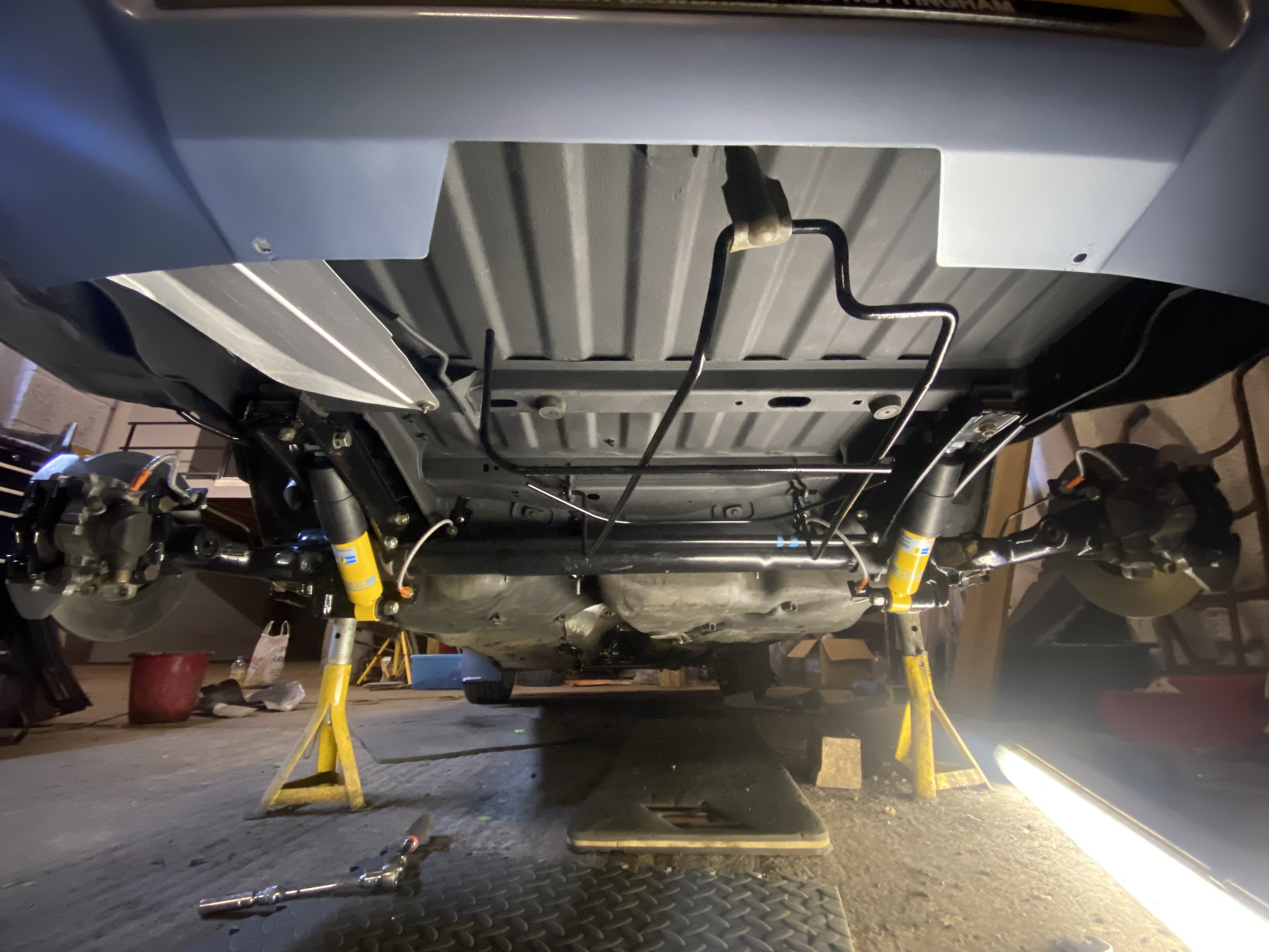

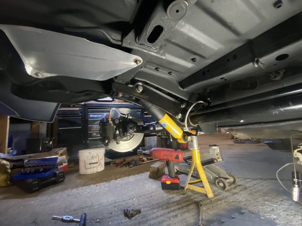

j_turnell 137 3 Cars Posted December 21, 2023 I managed to get some parts back from the powdercoaters. Tank finally back on along with dampers and brake lines with all brackets etc. It’s taken a long time to get to this stage but looks a lot better! Rear disk guards - Are 306 items a different offset? I have a pair but seem to foul on the disk. Share this post Link to post Share on other sites
welshpug 1,735 Posted December 21, 2023 I would have thought the 306 disc protectors would be the same offset, as the caliper is the same, only difference is a hole for the abs sensor. only thing I can think is there's a spacer/washer missing behind the wheel bearing. 1 Share this post Link to post Share on other sites
