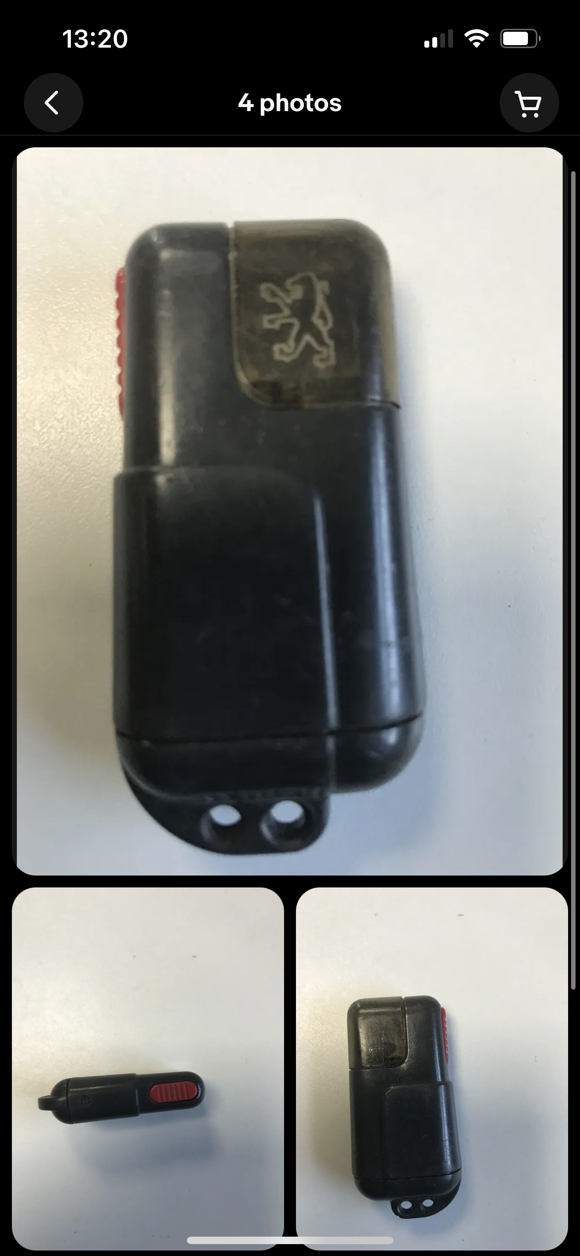

Billy 0 Posted November 15, 2022 Hi guys, when i originally purchased my car it came with central locking but previous owner lost the key fob. If i buy a second hand one am i able to get it programmed? Thanks. Same as pic. Share this post Link to post Share on other sites
SRDT 255 Posted November 15, 2022 If there is "NEIMAN" stamped on it then yes it's easy and you can even do it yourself if you have a small soldering iron. At worst you need a NEIMAN receiver but they are not hard to find. If you have a KIEKERT key fob however I don't know is it's even possible to change the code. https://citroen.tramontana.co.hu/en/bodywork/re-coding-the-remote-plip It's better to work on the receiver, there is more room to solder and if you somehow manage to destroy it it's easy to get another one. 1 Share this post Link to post Share on other sites
