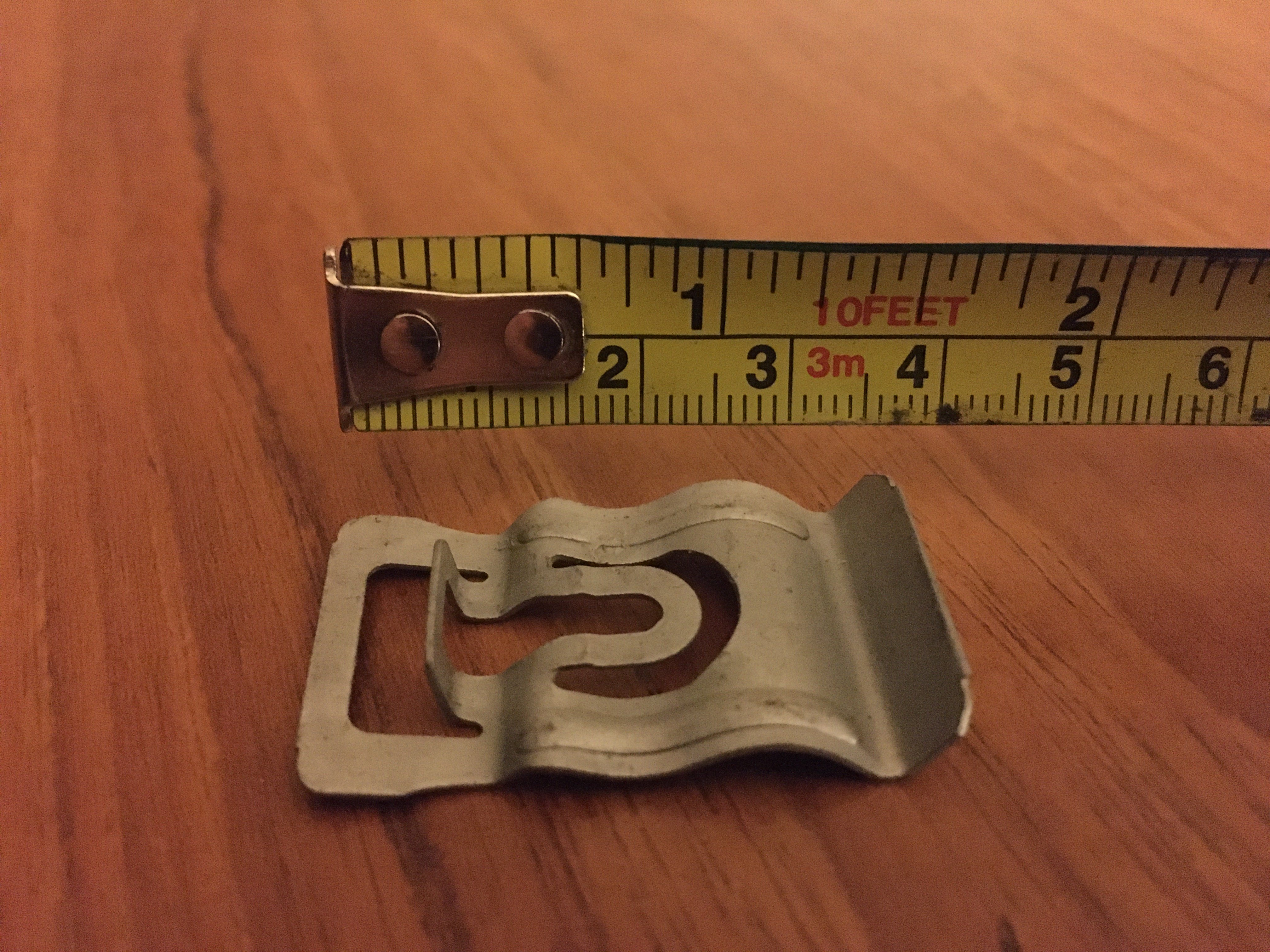

shonkers 6 Posted September 12, 2022 Hi guys, Iv’e had a search through old threads on fitting the door moulding to figure out how to reattach mine, it was taken off a few years ago for respray and iv’e lost or the clips broke so i bought these but i can’t see how they attach, on one post farmer said these metal ones go on the bottom row of rivets and black or white ones on the top row , can anyone explain exactly how they go please, i even tried fitting them on the inside of the moulding but does’nt seem to line up cant work it out Share this post Link to post Share on other sites
Wallby 39 Posted September 13, 2022 I re-fitted mine last week and had 1 left on the car as a reference, but I can understand your pain! These fit on the bottom row of rivets, with the middle hole just being pushed on, so that the bit sticking up on the right of your photo is pointing outwards. The bottom of the moulding then has a flap that slides up into that clip. The top is then held on with some other dark grey plastic clips that slide over the top row of rivets in the gaps in the moulding behind the red trim. Hope this helps, not an easy process to describe! Share this post Link to post Share on other sites
shonkers 6 Posted September 13, 2022 Thank you wallby that does help so much, in my fumbling i did have the clip in the position you describe but could’nt see how the flap fits and i did’nt have the other plastic clips, but once i get those i’m sure i’ll crack it cheers again Share this post Link to post Share on other sites
