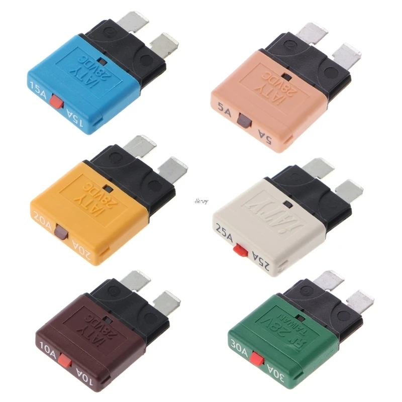

SRDT
You can buy circuit breakers to replace important fuses, this way you don't have to carry tens of spare fuses just in case.
Circuit-Breaker-Blade-Fuse-28V-Resettabl
