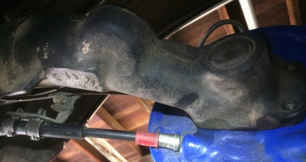

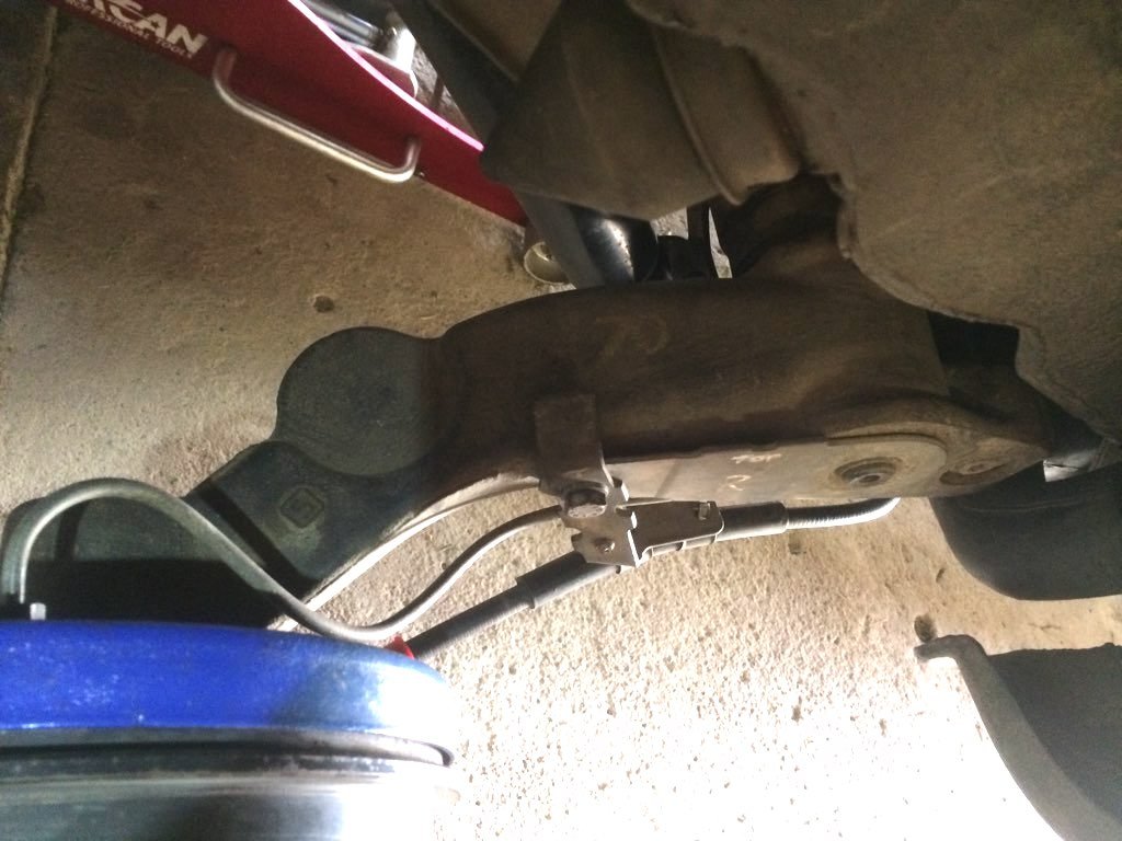

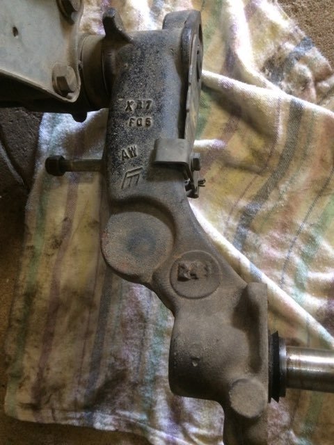

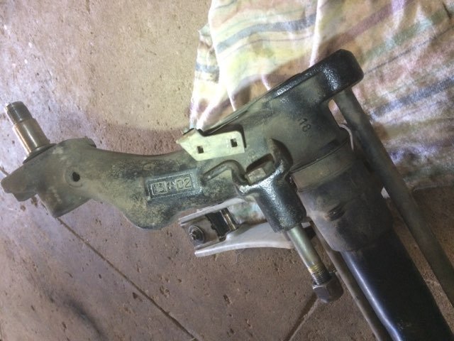

went and measured but still not obvious if the unknown are GTi as both beams are 60mm diametre

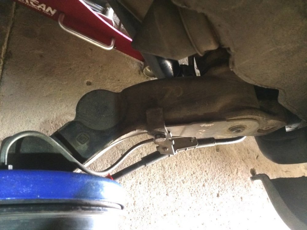

pics 1831509219_GTitop.jpg.8e4e1d5b47d3274facade27f481b5c49.jpg2069799229_GTibottom.jpg1B.jpg.322eec17db133e871fb00a6e91c33929.jpgshow the Si beam top and bottom first,
then the unknown beam second which also noticed is HOLLOW cast with a drain hole and more numbers
its really nice casting so credit to peugeot
Gohn
woops, the pic order got scrambled
the known SI arms are the last two pics (on the car with the blue drum brakes - it was the only colour left in the shop)

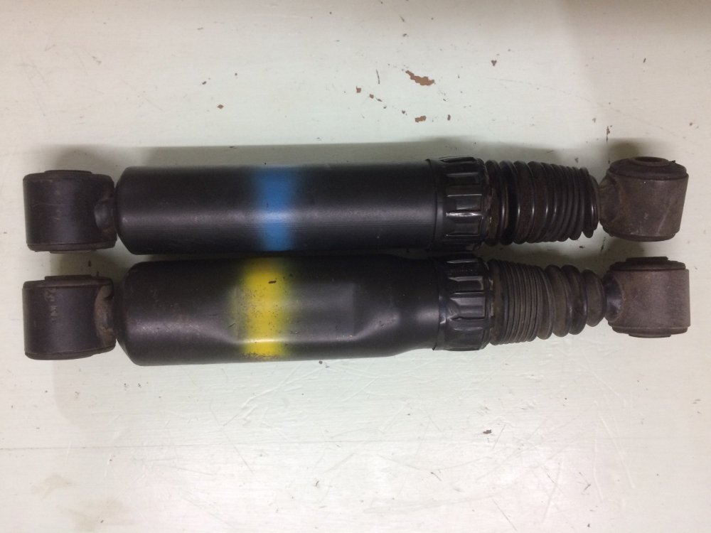

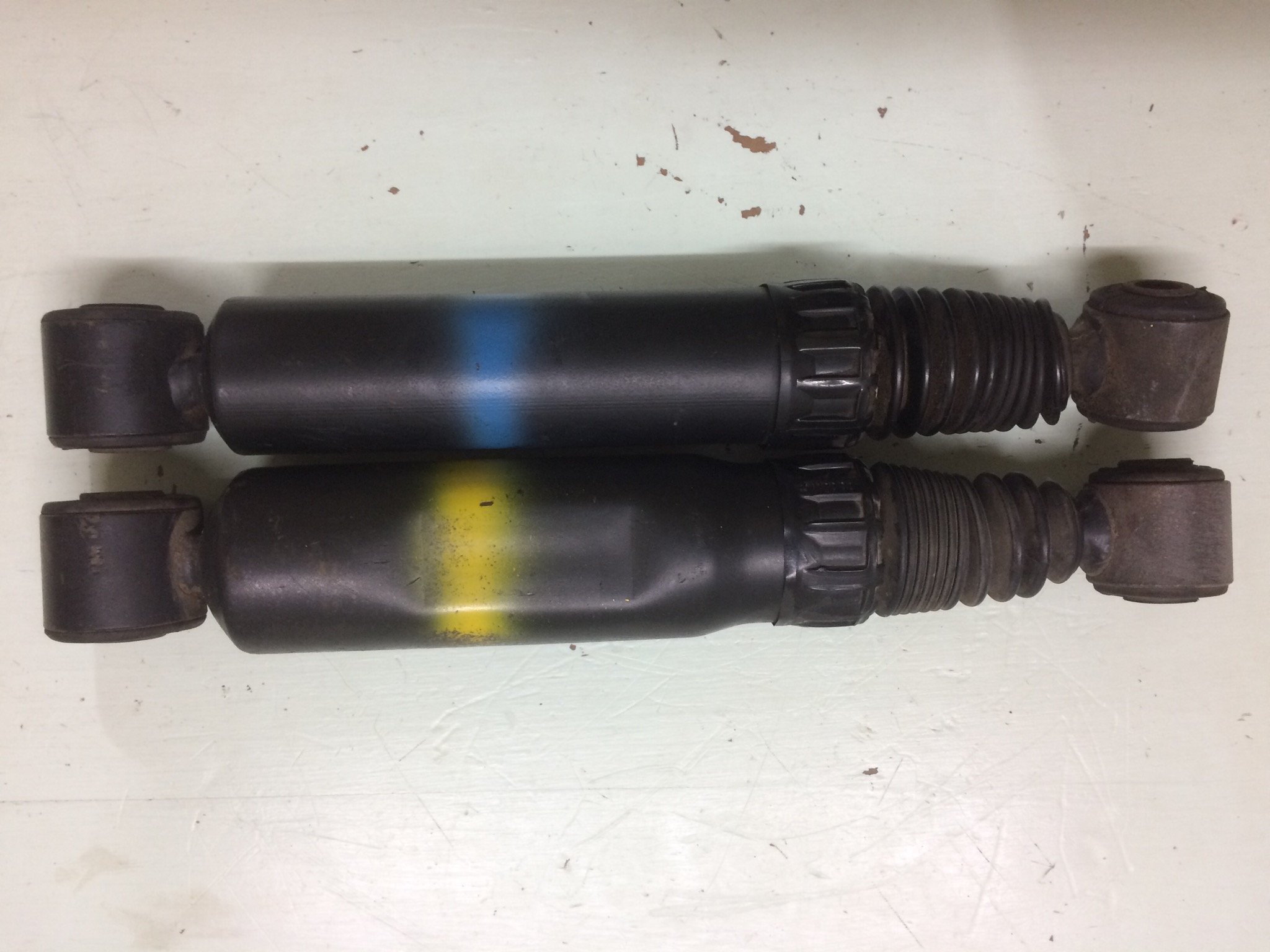

also,  bought 2 sets of 205 rear shocks on their own from a guy that had parts everywhere
both stamped 'Peugeot ULR' with a string of numbers
one set has a blue stripe
the others have a yellow stripe and are a bit beefier
I never owned a GTi so not sure but could the yellow ones be from a GTi ??
DamirGTI
Yes , yellow stripe beefier shocks are deffo GTI item .. blue ones would be some of the base model , but both of them OE Peugeot shocks (Peugeot ULR) .
Unsure about the beams , looks like 309 to me ? as (if original paint) 309's had black colour tubes while 205 ones where mainly yellow .
Also there was a lot more different TB/ARB dimensions/variations on a 309 beams than on the 205's .
Never seen so many stamps on the arms either , they do have some but not as much ... that might even be new aftermarket beam from "IM Axle" or similar , those too are with black tubes .
Measure the length of the tubes .. if 309 item it'll be longer than 205 .

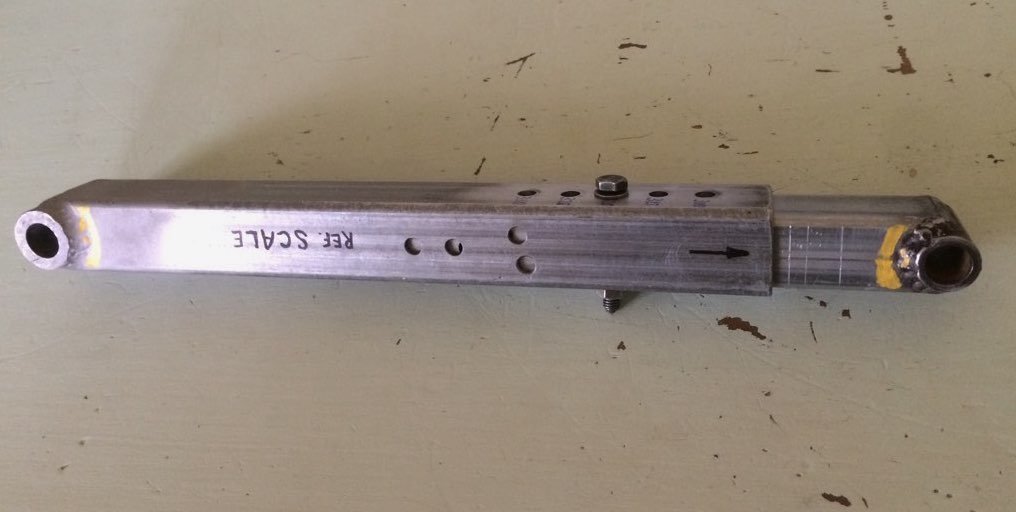

Any pics of your dummy shock looking to make one for myself Gohn
By far the easiest way, should you know what ride height you want, is a piece of 2x3/4” timber with one 12mm hole and one 14mm hole drilled at the appropriate centres.
  • Thanks 1
Gohn
its surprising how often you need wood when working on a car !

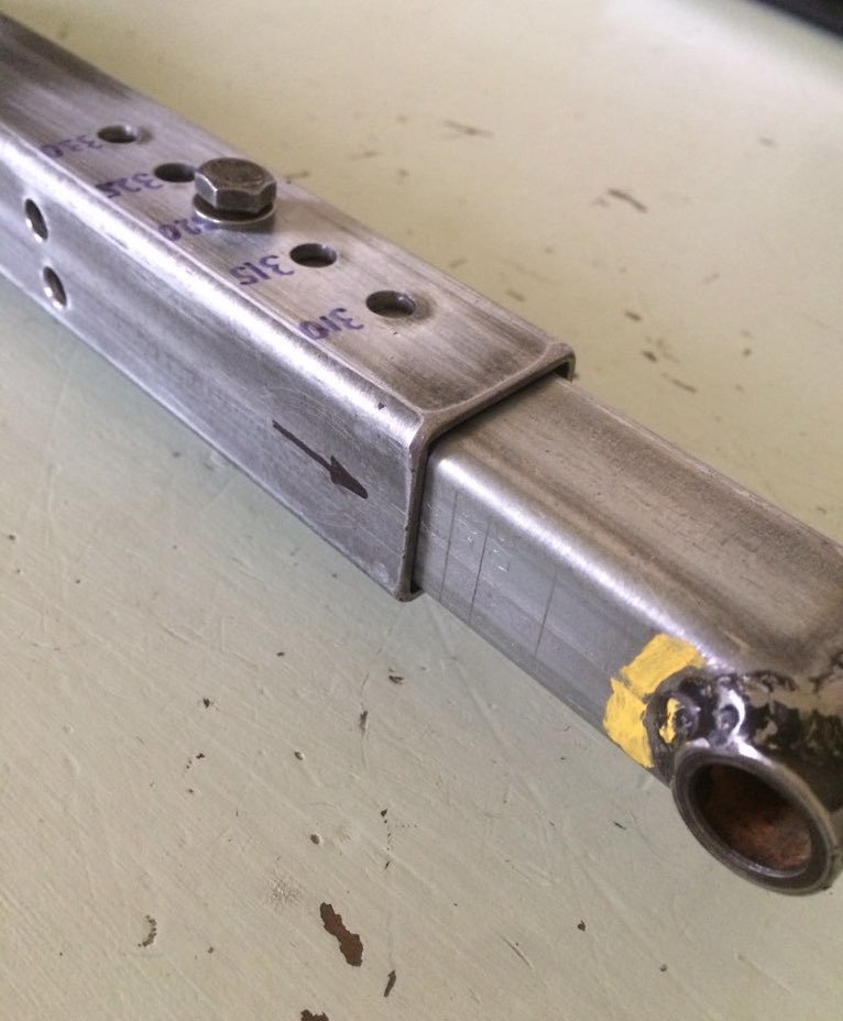

tom's is an easier and cheaper solution as the one below was a bit of faffing
mine's copied from PeterT from an earlier post somewhere
salvaged the shock ends from the local metal scrappy, ID's M14 and M12
larger blank is outside 30mm square, smaller blank 25mm square, both 2mm thick x 280mm long
only marked lengths 330mm to 310mm at 5mm intervals
but its plenty for my use as I like original components and ride height
others have better rigs with one shock end welded onto a threaded bar
that way you can just screw it out or in to the desired length
  • Thanks 1
