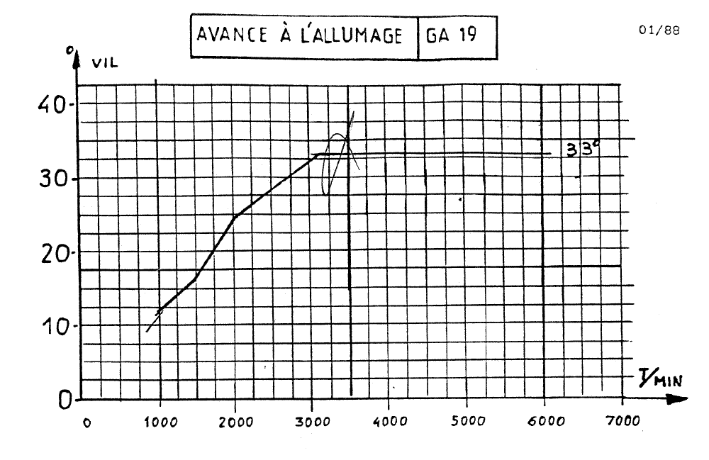

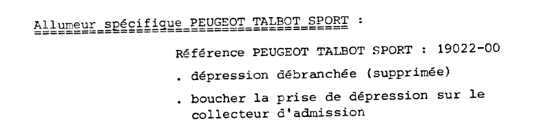

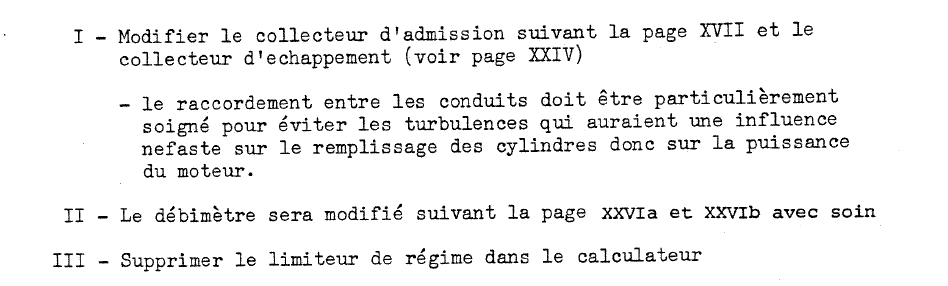

Thijs_Rallye
On 4/30/2023 at 1:10 PM, 309jazzpanda said:
I have always wondered what PTS did to allow it to run on that management with such a big cam.
Why wonder if the information is available :)?
1) Modify the intake and exhaust.
2) Modify the air flow meter. (page 53 in PDF)
3) Remove the rev limiter from the stock ECU.
For the exact details refer to the attached PDF :). From what I read the head work and intake manifold work are key to the performance.
I think the re-curving (aka resetting the clock spring) of the AFM is related to the ram-air. Also there was a specific PTS distributor with the following curve:
205 Gti 1900 GrA (01-88).pdf
I had a Grp A ecu, but sold it. I opened it up and it had some different resistors but I didn't think at the time to record it, as I had access to aftermarket ecu's which did a much better job. My bad. It really was a bit of a dog though and ditching the AFM and changing the ecu transformed it.
