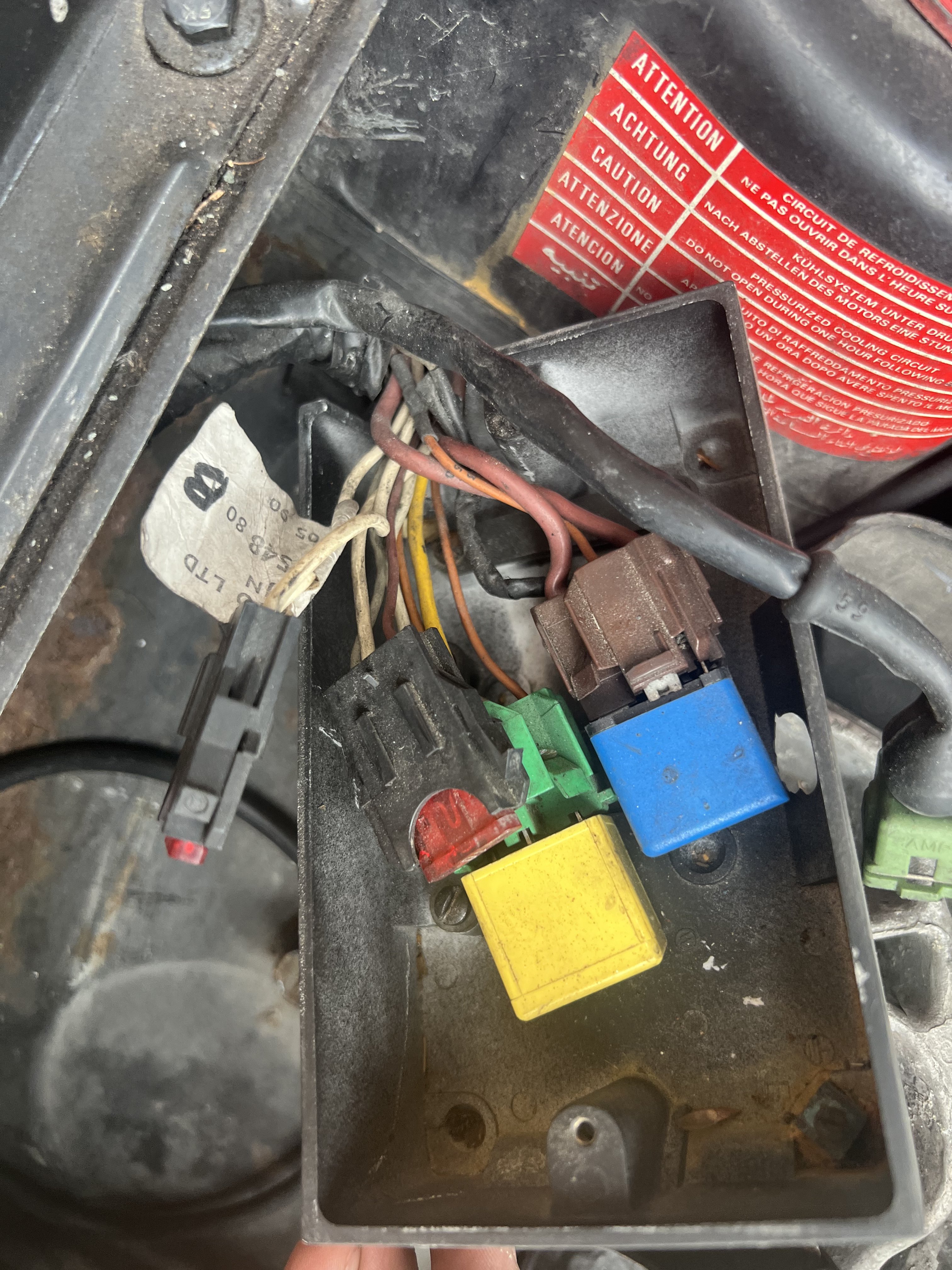

Moby 0 Posted July 20, 2022 Hi guys. I’m trying to locate the fuel pump relay. I’ve looked in the obvious place next to the ecu under the steering column above the throttle pedal , Not there. Looked behind the battery on the body like the 405. my car is a 205 1.9 Mi16. Converted from a 1.6 GTI. Share this post Link to post Share on other sites

Anthony 1,003 Posted July 21, 2022 If it's been converted using a 1.9 Mi16 loom, then the fuel pump relay usually ends up located around the OSF inner wing area near the jack on most 205 Mi16 conversions that I've seen. Share this post Link to post Share on other sites

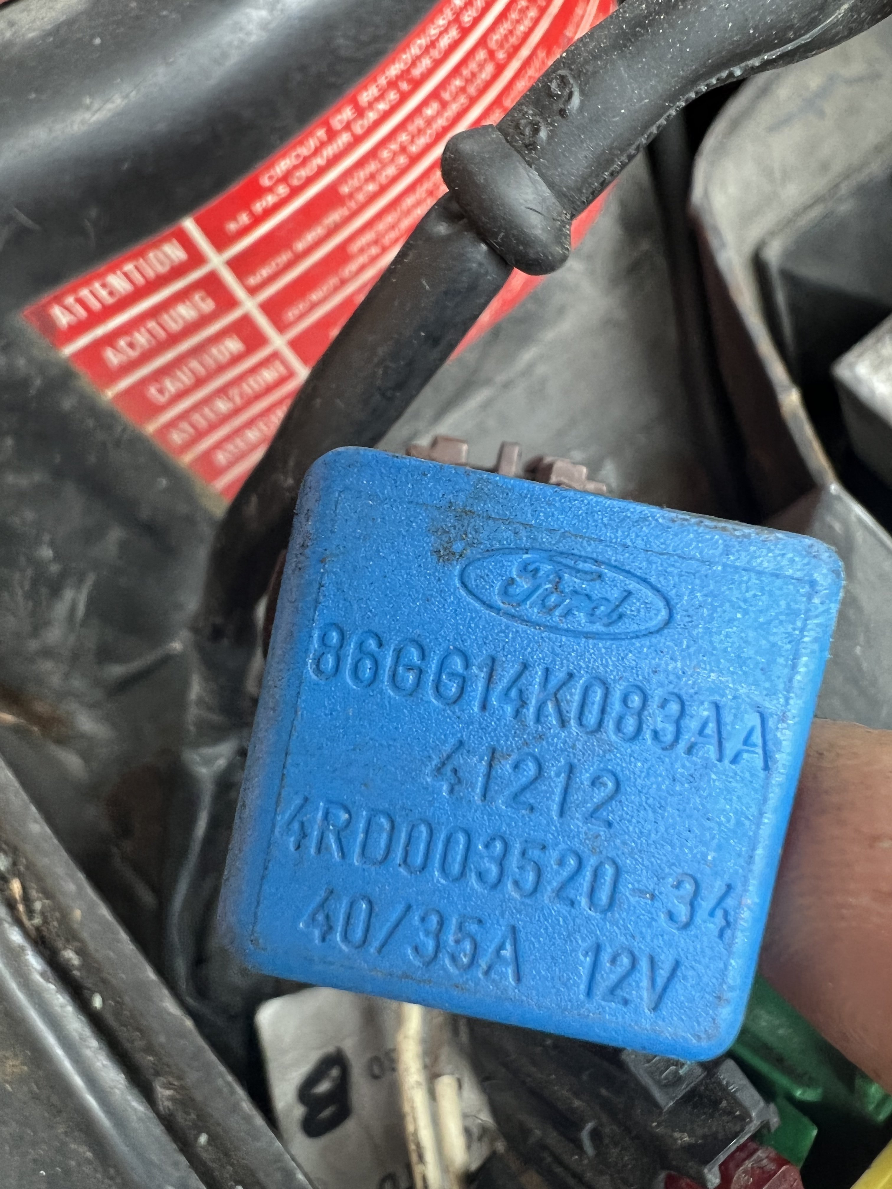

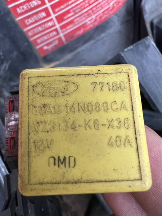

Moby 0 Posted July 21, 2022 I found these in a black box near the n/s headlight. Is it one of these ? Share this post Link to post Share on other sites
Anthony 1,003 Posted July 21, 2022 Yes that's the one - the other switches power to the ECU IIRC when you switch the ignition on. I'm afraid that I can't recall which is which now, but from memory one should click on with ignition and one will only click on when the ECU sees the engine turning over (i.e. cranking or engine running) - it's this latter one that is the fuel pump. Obviously originally they didn't have Ford stamped relays so someone has presumably replaced them before. Worth checking carefully the condition of the loom in that area and for corrosion on the relay holder pins - most Mi looms that I saw even years ago were looking pretty tired or literally fell apart in my hands. Where the smaller gauge wire meets the pin in particular is a prime area for wire corrosion, often so bad that it'll snap off when you move the relay to inspect. Share this post Link to post Share on other sites
