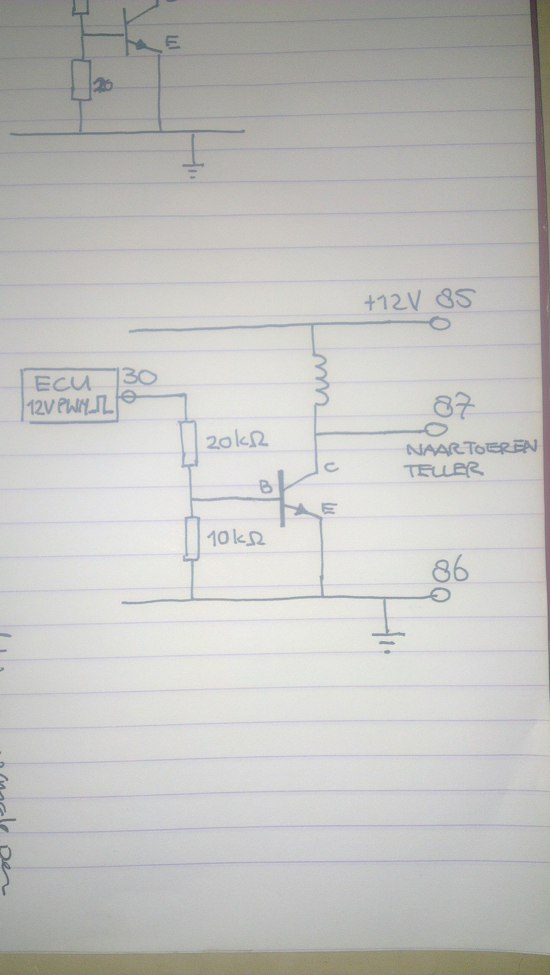

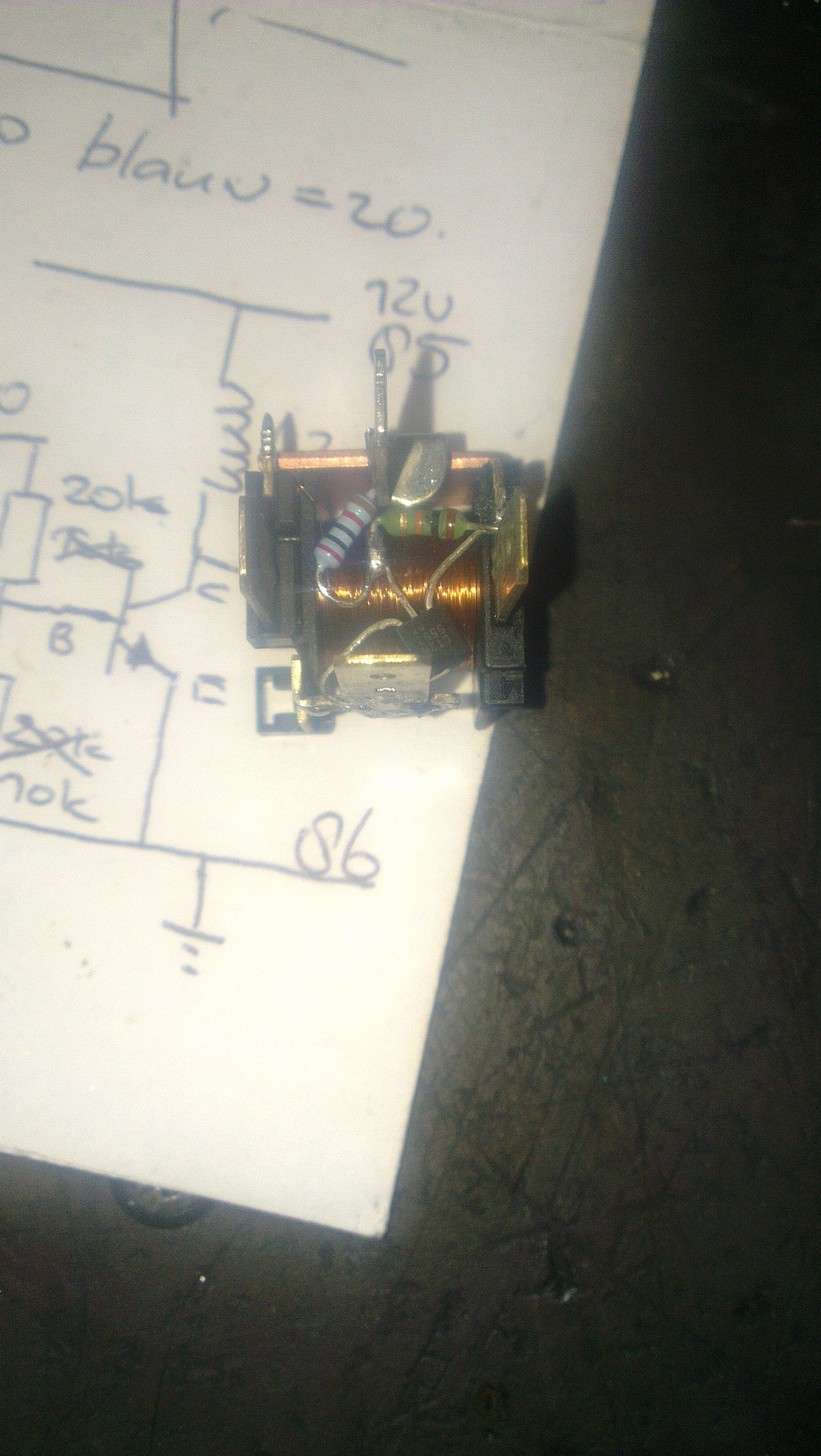

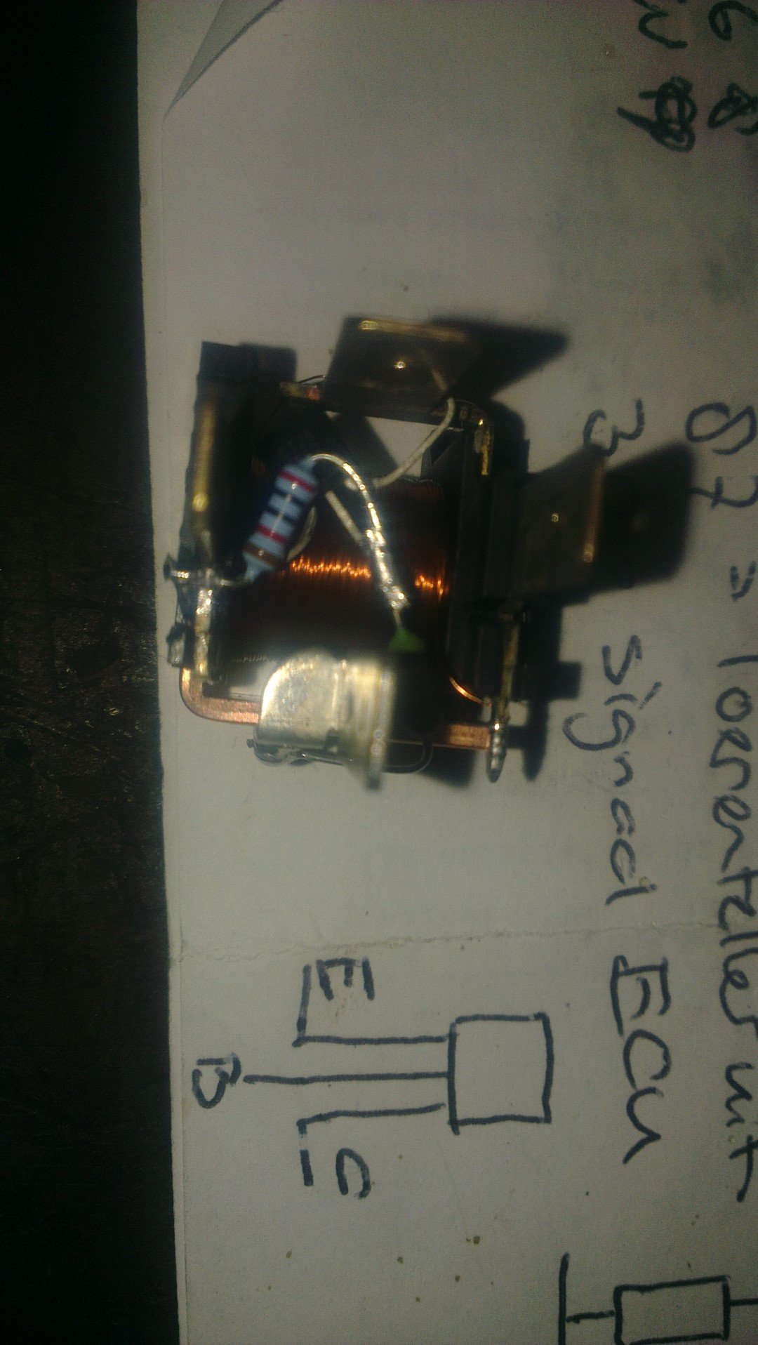

What kind of signal does the ECU provide? I've got it to work with a modified relay and the ECU's PWM signal, using the relays coil as a faux ignition coil.

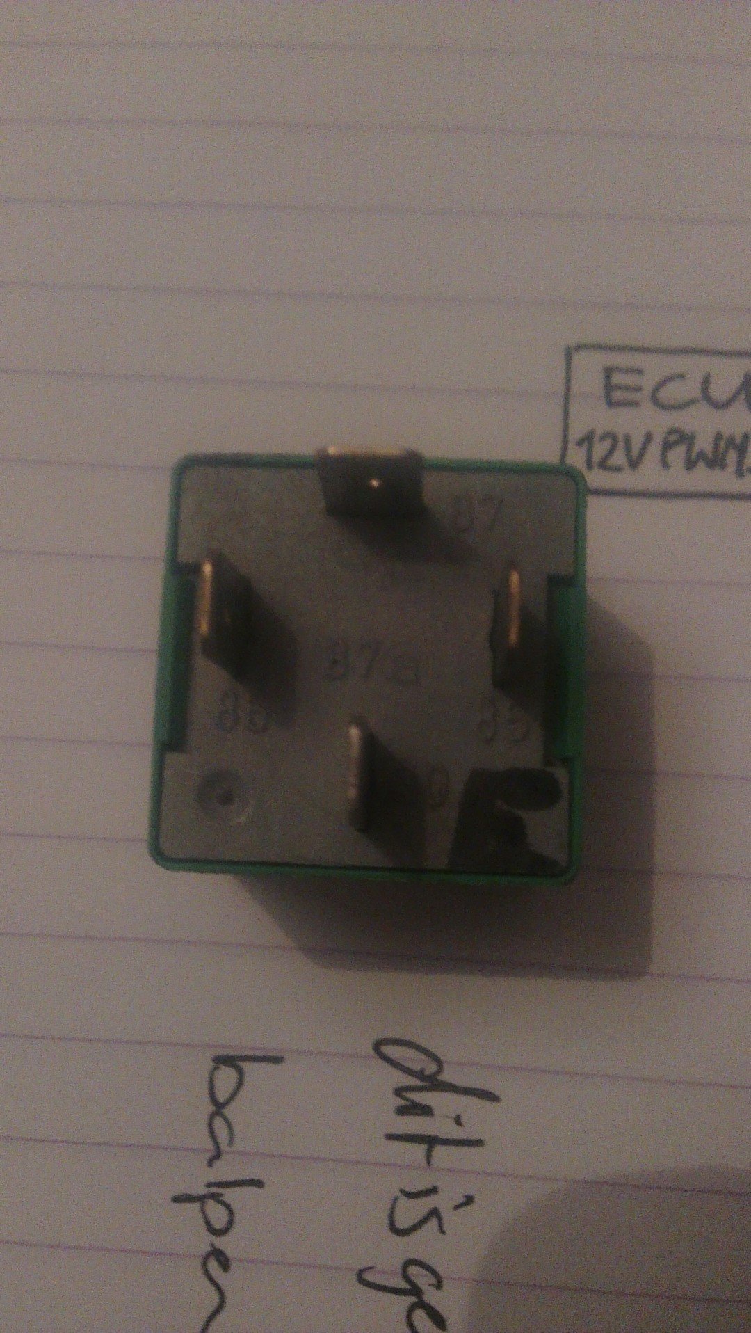

Not until I saw your post :). I've made this relay after the RFS Nodiz conversion in 2014, found the original idea on some obscure Lotus forum if I remember correctly. (who had a 5V PWM to work with, so resistance values and transistor type are different)
It wasn't the most aesthetically pleasing construction but it works and all is confined in the original relay housing :) .

5V or 12V? You could give this relay fix a try, only thing to take into consideration is what voltage the PWM signal is. For 12V the schematic / resistance values are ok, for 5V it needs some tweaking.
